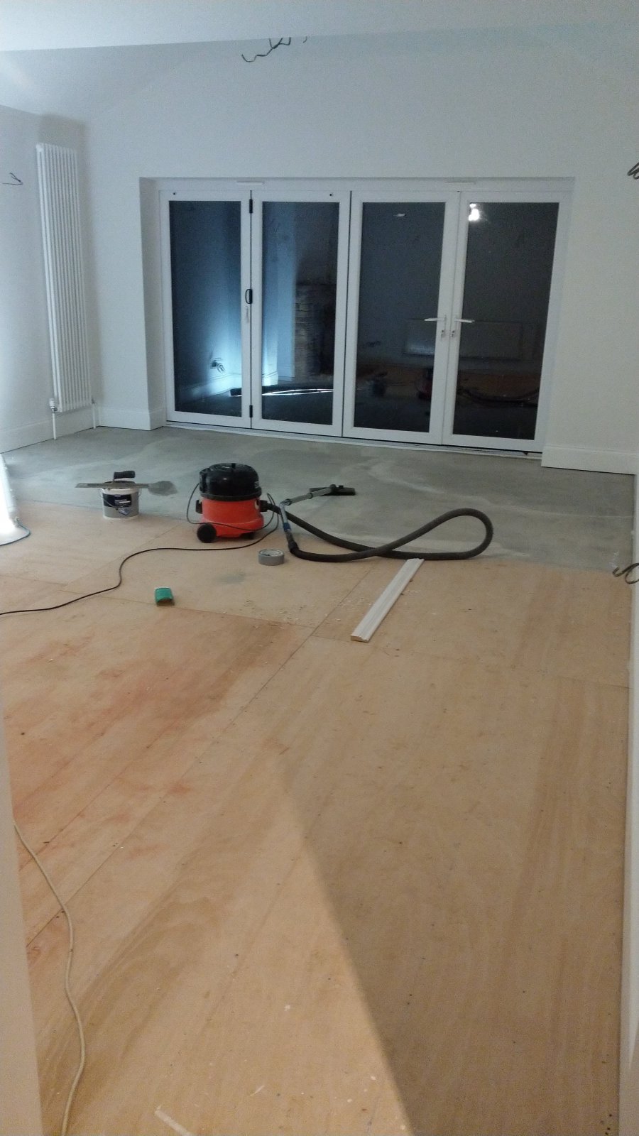

I have to soon lay a large amount of solid oak wood flooring in my house, the problem is I have to span a suspended floor with floorboards and a screed floor. I'm laying ply over the floorboards to give a better flatter surface and the screed has been covered with self leveling compound.
The levels match but I'm not 100% sure on how to fix the new floor down. Can I nail the floor over the wooden flooring using a proper flooring nailer and then glue to rest down on the screed part?
I've glued down a previous solid wood floor using Mapei 2 part adhesive and it was very ggood will it be ok to mix the 2 ways of fixing?
Here's a photo of the lounge before carpeting but it's the same as the kitchen diner.
