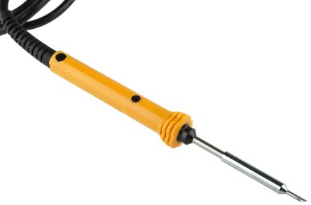

After spending a fortune on all sorts of soldering irons I realised that Antex with their push on collet type tips was the only way to go. Heat transfer is far better - a 25w iron is better than other people's 60w!
Hopefully you are sorted now but I read Fizzy's comments as 'make an adapter to take the slide on Antex tips' which I would have thought, would make the wand a bit too long for your liking.
I read it as buy an Antex.Hopefully you are sorted now but I read Fizzy's comments as 'make an adapter to take the slide on Antex tips' which I would have thought, would make the wand a bit too long for your liking.
So why not make an aluminium adapter threaded to fit Aldi iron and sized to fit antex tips?After spending a fortune on all sorts of soldering irons I realised that Antex with their push on collet type tips was the only way to go. Heat transfer is far better - a 25w iron is better than other people's 60w!

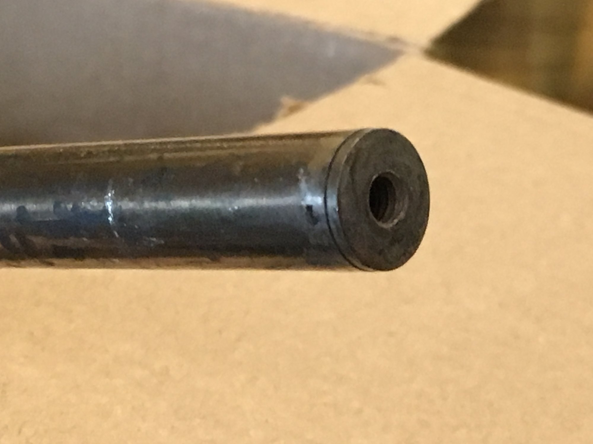

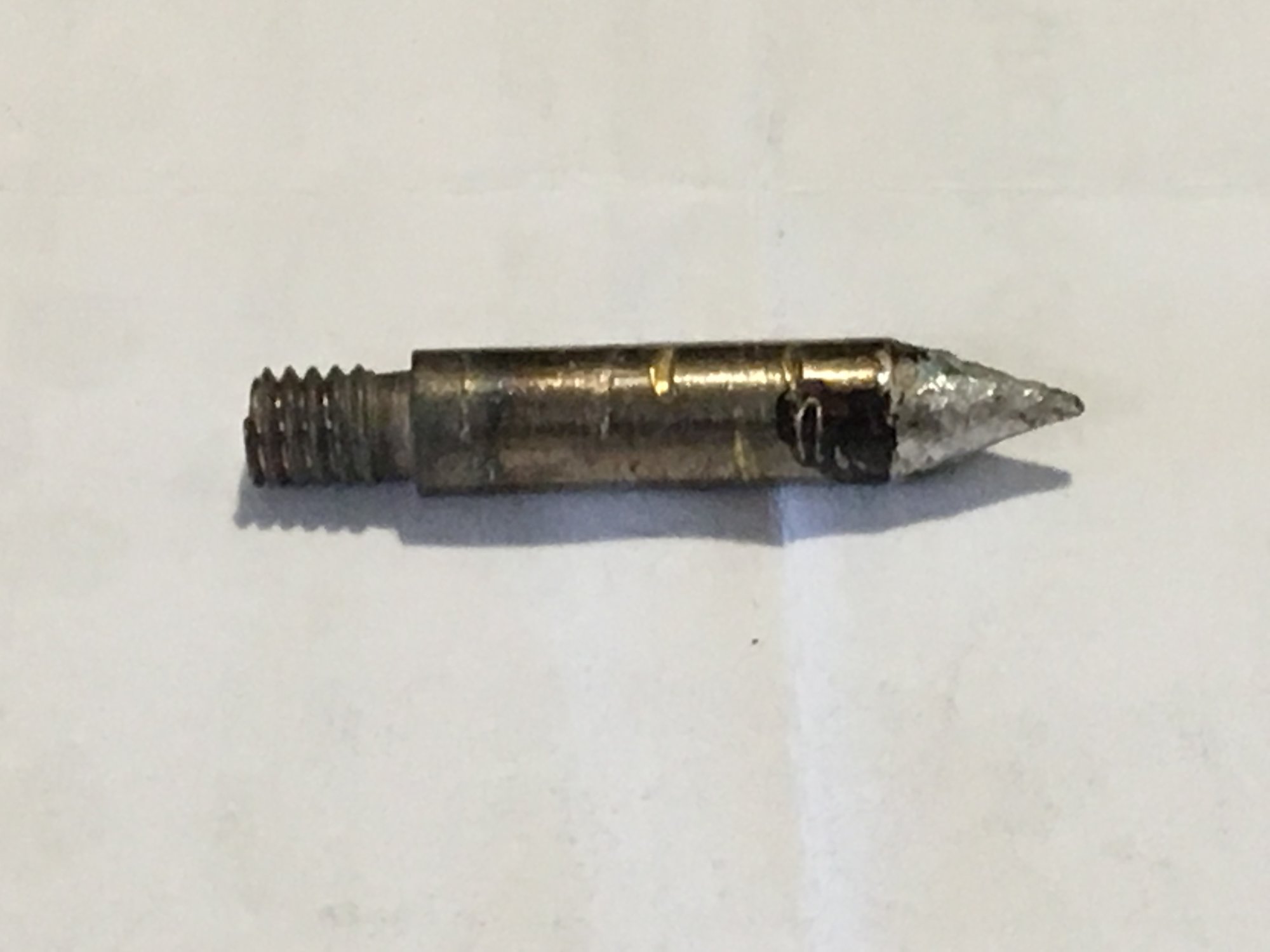

The thread in the Aldi one isn’t too bad, once the tip is screwed in and nipped up it stays secure but I bought a Lidl one a while back and that tip was forever coming loose.I think the screw thread is part of the problem - not a tight enough fit but if you could get a larger tip to slide right over it would be fine. Perhaps a copper adaptor for even better heat transfer?
