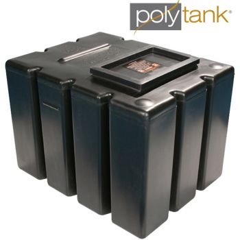

they can go higher than thatA quick Google suggests IBC rating is about 60C. ST panels could happily boil water. For a bulk, low temperature store, great. But needs failsafes to be sure that they can't get too hot if something accidentally got left in the wrong setting while away on holiday for example. If you're limited to under 60C, that's a bit cool as a preheater for tap water but not useless. Could be more useful for space heating but even then, better in a well insulated house with low temperature emmiters/UFH. For most people, where it's going to be retrofitted and space is at a premium, you can maximize kWh/m3 by simply raising the temperature.
Most likely these tanks are made of high-density polyethylene. That type of plastic is good for 150 F continuous. It would start melting at about 250 F. I'm sure that it would be some sagging at 130 F, but since they are caged it should be OK. But any plastic could crack, so if you use them to store water, make sure that the water don't do a lot of damage when it spills.
