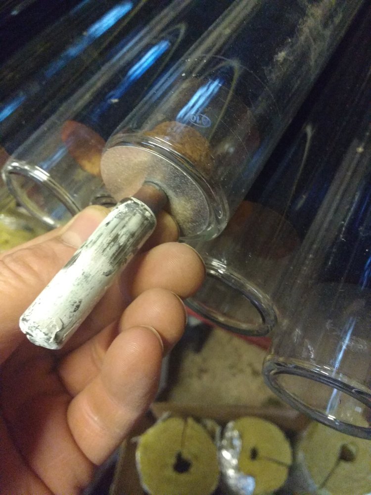

Just reread this. I can't find the corks. These have really shrunk:

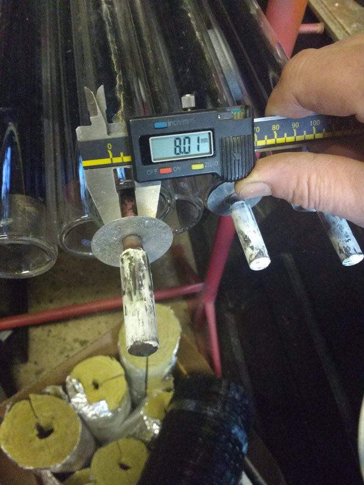

8mm dia copper:

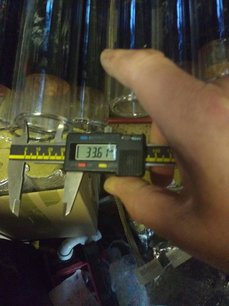

This is the ID of the tubes:

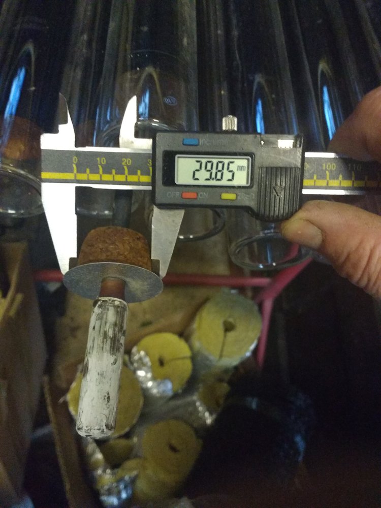

The corks have shrunk:
