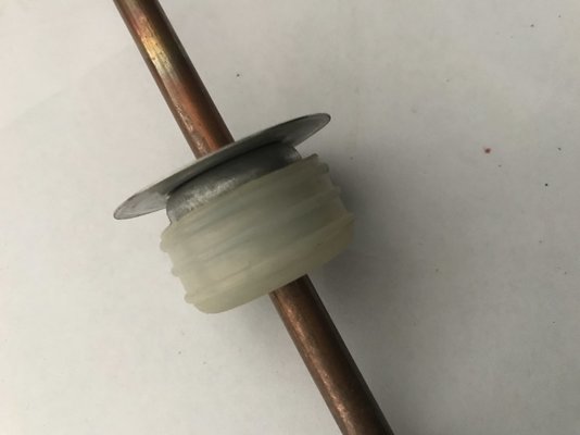

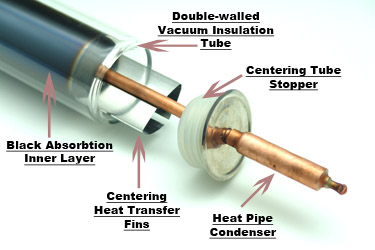

3D print them?
That was a first thought but temperatures I'm guessing will likely be too hot.
3D print them?

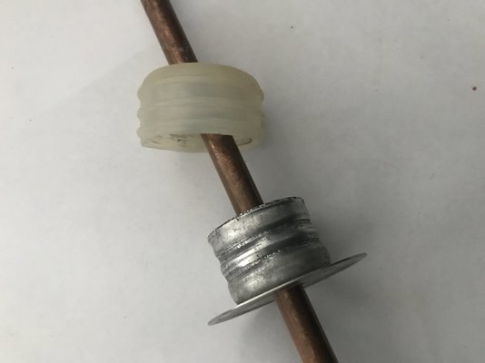

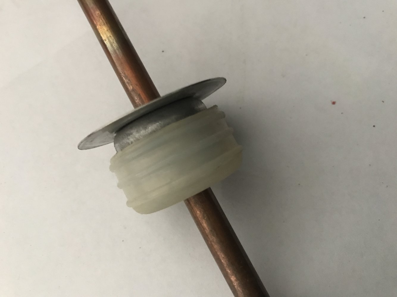

What are the internal & external diameters of the pipe and glass tube as the physical dimension of any stoppers you have ? There's many on here who might have the time to play on the internet & locate them.Anyone know where to get the centering stoppers for solar thermal tubes? All mine are cork and have shrunk!

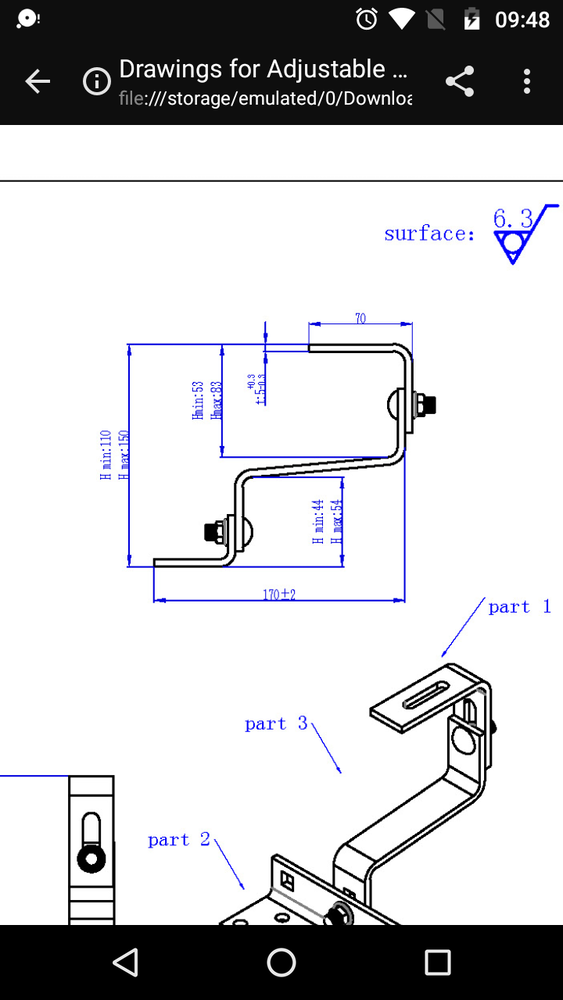

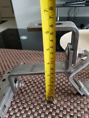

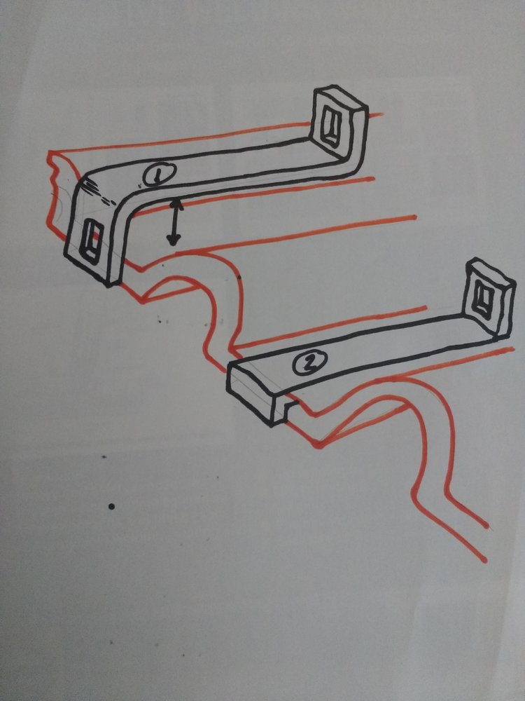

They've kindly given you a dimensioned drawing - few hours work to knock-up 8 of them.Enquire first if buying anything from this seller. I thought I'd just check via email as I wanted to buy 8 of these brackets below. Was told sorry, out of stock, if I place an order I won't get them.
They've just updated the site to show out of stock.
Stainless Steel roof hook for Pantiles
Profiles of 2113 mm for efficient (vertical) transport or every desired length Portrait mounting. With landscape mounting, additional items can be orderedÂcallidus.shop

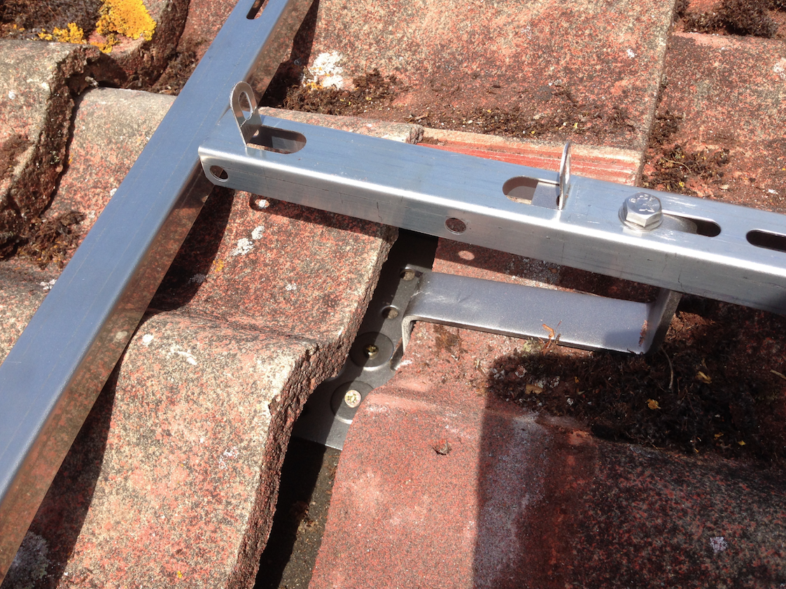

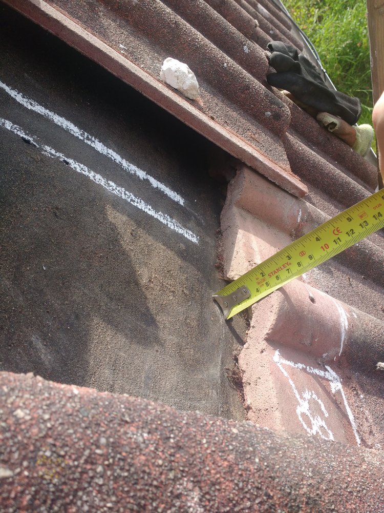

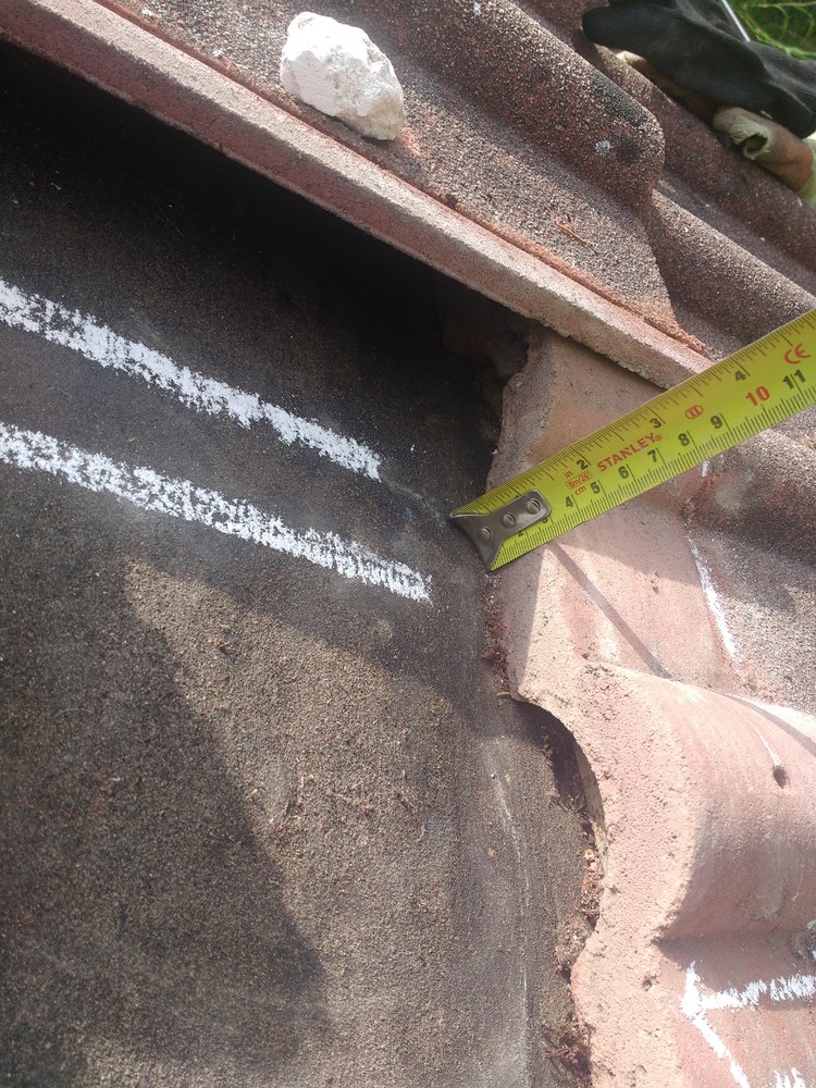

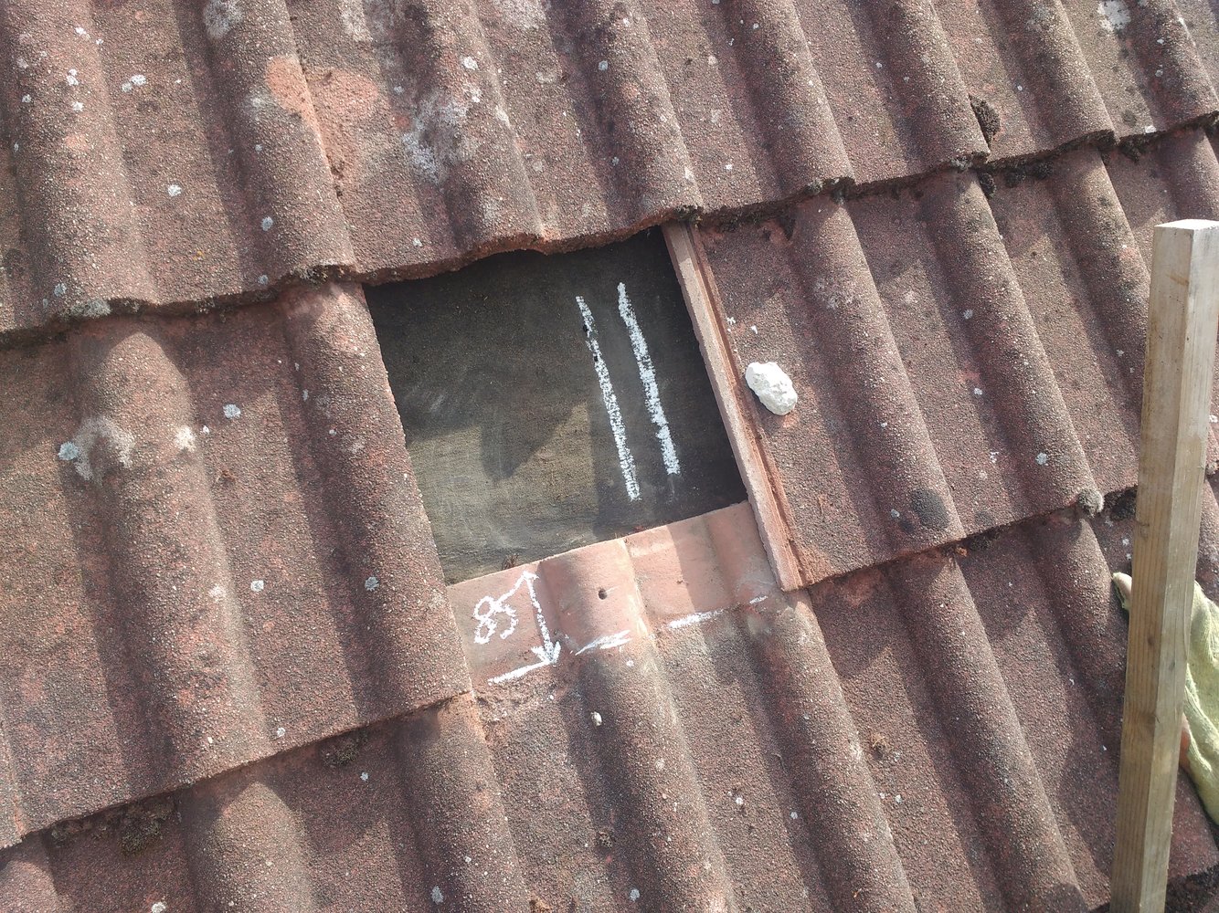

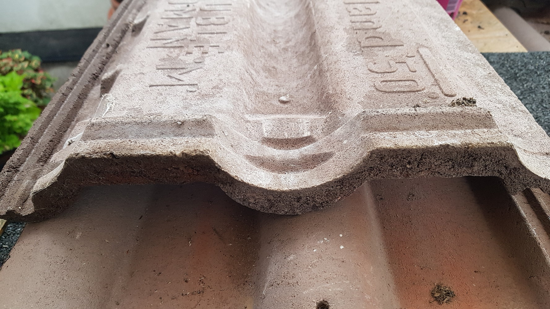

The videos I've seen they groove the underside of the tile that sits on top of the bracket.![]()
No I just sliced off the bottom lip of the tile, you can see the bit above the bracket is flat where I cut it, it was not much maybe 1/4 of an inch?
I think I got the brackets from germany via ebay,
Iirc there are many many varities of brackets to suit all needs.
If none available to fit exactly, I would just cut and shut one to fit, then make the rest the same.
Nothing has been removed from this tile,So you sliced the little nib off of under the humpbacked bridge bit? Therefore the brackets come out there rather than on the flat sectional like @Trevorleach 's?
Try this video. It might not be exactly the same as your tiles but give you an idea. No I didn't realize you have to cut tiles either!
I made a valley out of folded galv sheet thirty years ago with just a bit of paint around the weld joints.Yes I have fitted solar pv to a similar roof
You can buy some as @angellonewolf said that fit under the tile and drop on top of the next one. Some you don't even need to cut the tile you can slide it back down once the bracket is fixed to the rafters. @gaz1 beat me to it! As he says I would reinforce them for the extra weight.
I have used unistrut on our pv and its been fine for over 10 years now with only the odd minor rust mark, I did spray the ends with galv spray.
Aluminum channel is good too and very much lighter to work with on a roof but having fitted pv systems on that I would choose unistrut over it, it just feels more solid!
