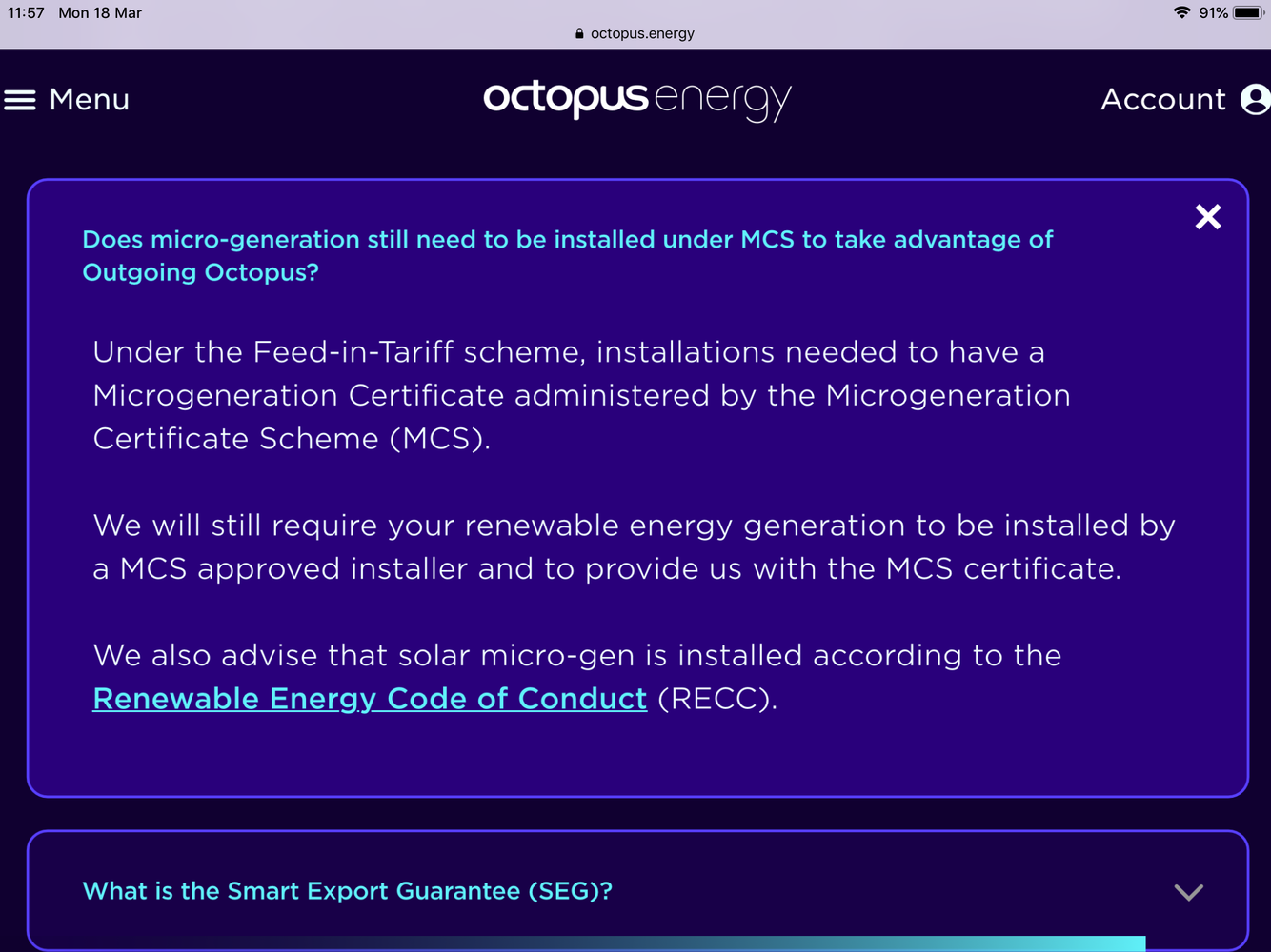

current Octopus faq - the last paragraph being the pertinent one..I was going to post the same.

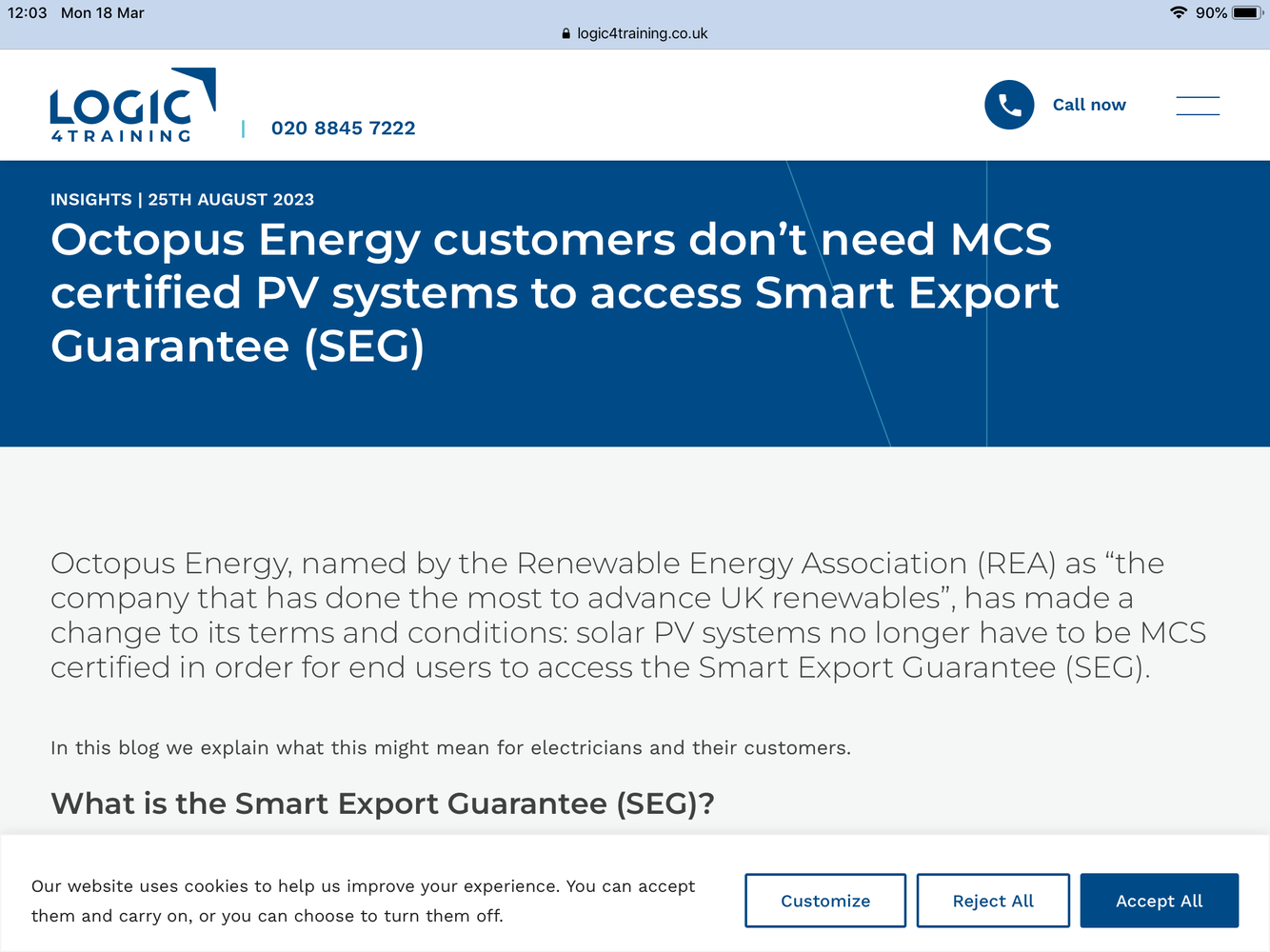

And yet, this page from an independant training provider says:

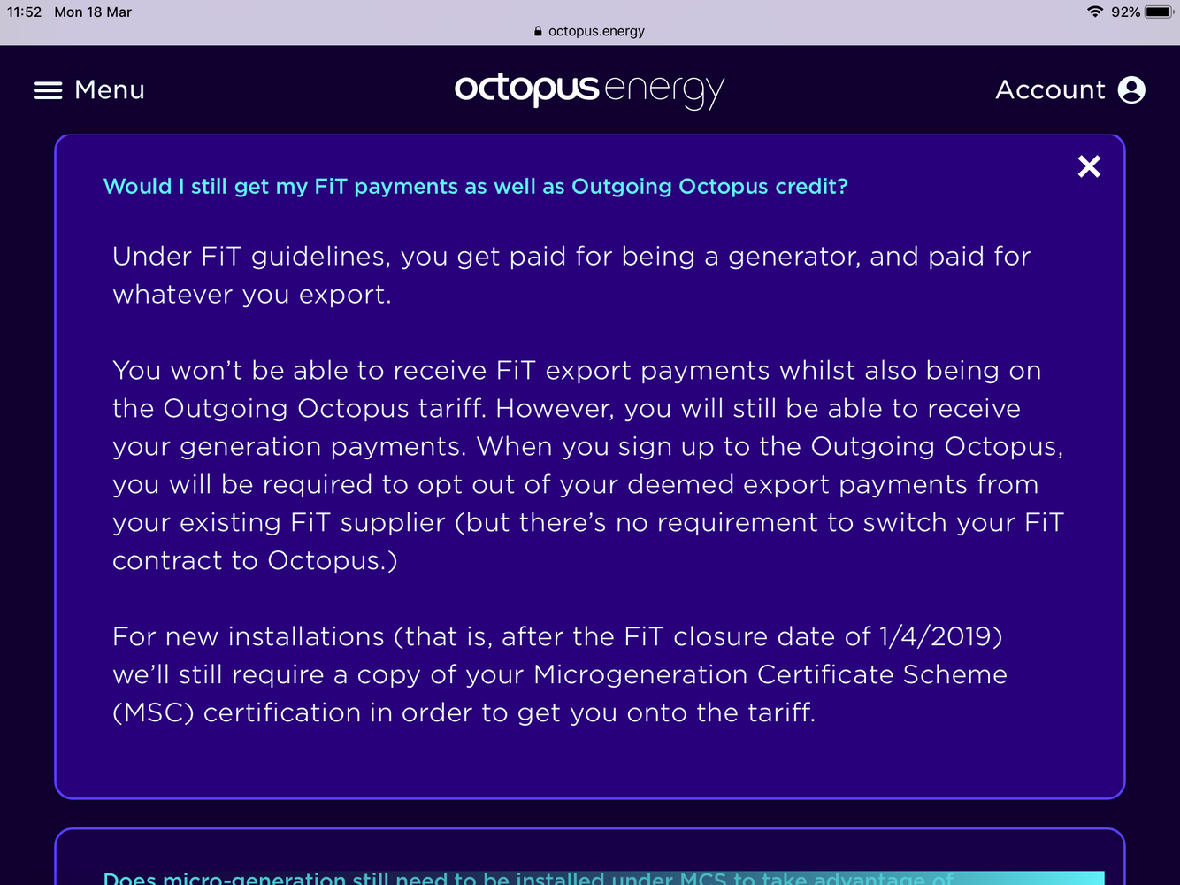

What nonsense - if it was all well defined we wouldn't be discussing it. So do you have to have an MCs certificated scheme to get paid export? Two days ago I thought the answer was yes...There is so much confusion here. And there doesn't need to be. MCS, FiT, SEG, DNO's Gxx certification etc are all well defined and have rules as to what is an isn't allowed.
As a general rule, if you require a certain standard/setup/certificate in order for a company to pay you for something, if you deviate from those rules, the company will be quite happy to legitimately stop paying you and continue to take your generation.
Conjecture about what is and isn't allowed on a forum isn't needed or helpful.
I wouldn’t go as far as far as calling what Gareth said nonsense but I agree with you though, it’s not completely clear cut. It is strange that octopus seem to have a different stance.What nonsense - if it was all well defined we wouldn't be discussing it. So do you have to have an MCs certificated scheme to get paid export? Two days ago I thought the answer was yes...
Sorry, my post wasn't really in response to your queries but other conjecture based posts. There is apparently ambiguity as to whether octopus will sign you up to SEG without an MCS cert. Which is why I suggested emailing them for clarification.What nonsense - if it was all well defined we wouldn't be discussing it. So do you have to have an MCs certificated scheme to get paid export? Two days ago I thought the answer was yes...
