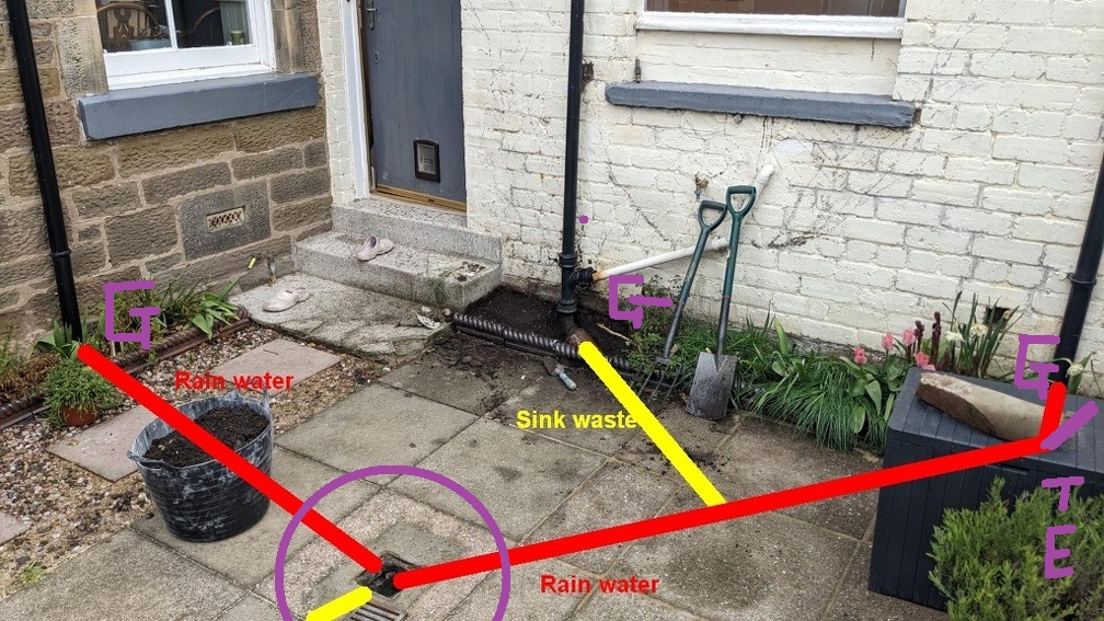

I wouldn't be so quick to do away with a vent pipe in favour of an aav, its not all about air admittance. In a lot of cases there can be a back pressure and that can end up blowing air back through the traps etc if there is no proper vent in the system, happens a lot where sewers get overwhelmed through flooding or loaded up through over development.
