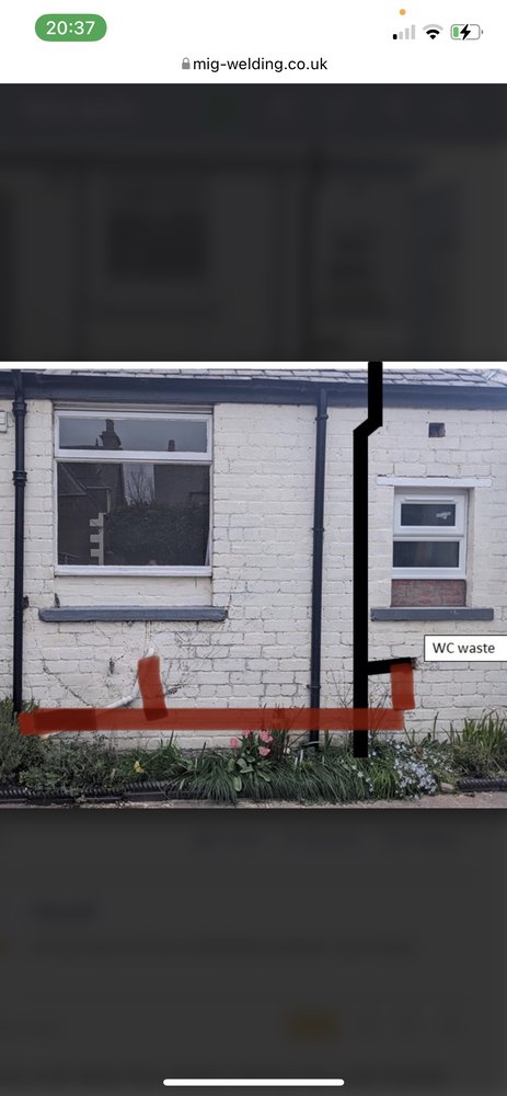

I'm planning to add something like this for my new WC waste but it looks a bit cluttered, any other suggestions.
Don’t bother with the 2nd stack , run the waste accros from existing stack , tee up to kitchen , then along to bathroom , use 4 x 45 degrees bends to sweep around the rain water .. with a tee and rodding point at the top of the run
I drew it horizontals , as easier that including the correct run . But you get the idea

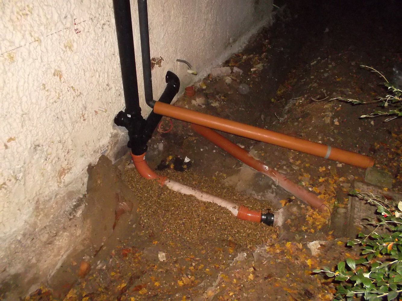

I’d be suprised if the main line , below ground was less that 110 , if you have a careful dig around you’ll probably find the existing cast down pipe just stuck into the 110 and flaunched over .I could also relocate the rainwater pipe to the other side of the window over to the righ to overcome the problem of it being in the way. There will be another issue that the existing sink stack is only about 60mm or so, so will not be big enough for the WC pipe. I expect that the under ground run to the main sewer will also be small bore so would not be suitable.
I could of course dig it all up and change it to 110mm as I need to dig a trench to the sewer anyway.
At the moment the entire back yard is paved over with no sign of a manhole cover or where the sewer run is.
dig and find your pipes before you start planning anything
You can do this but they do wear and sometimes they not only admit air but also emit smells until you help them seal againair admittance valve inside the building beside the WC
It would still need an air admittance valve as the horizontal length is enough the suck the trap out of the sink when flushing the toilet. Also the toilet would probably "glug"
