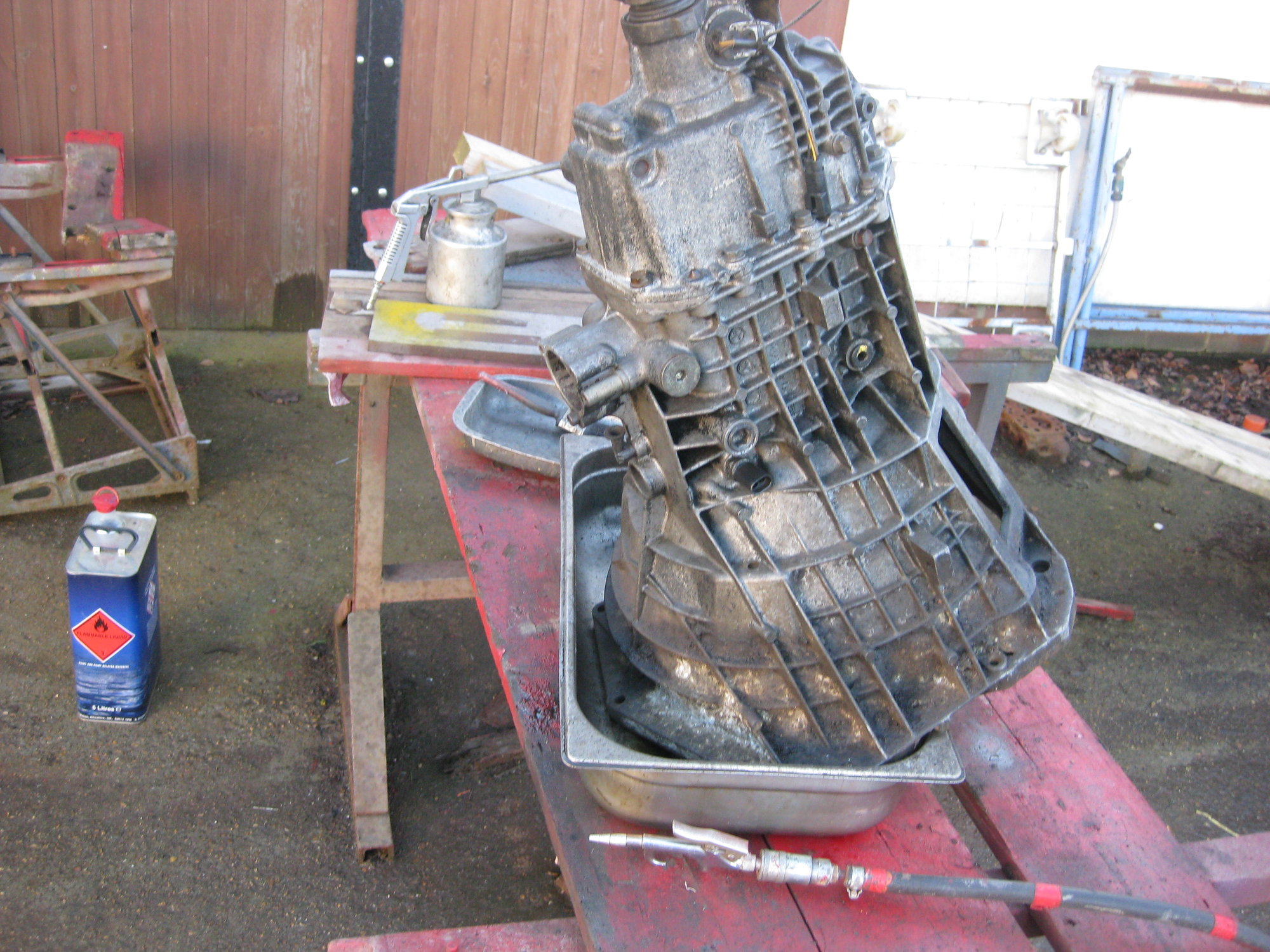

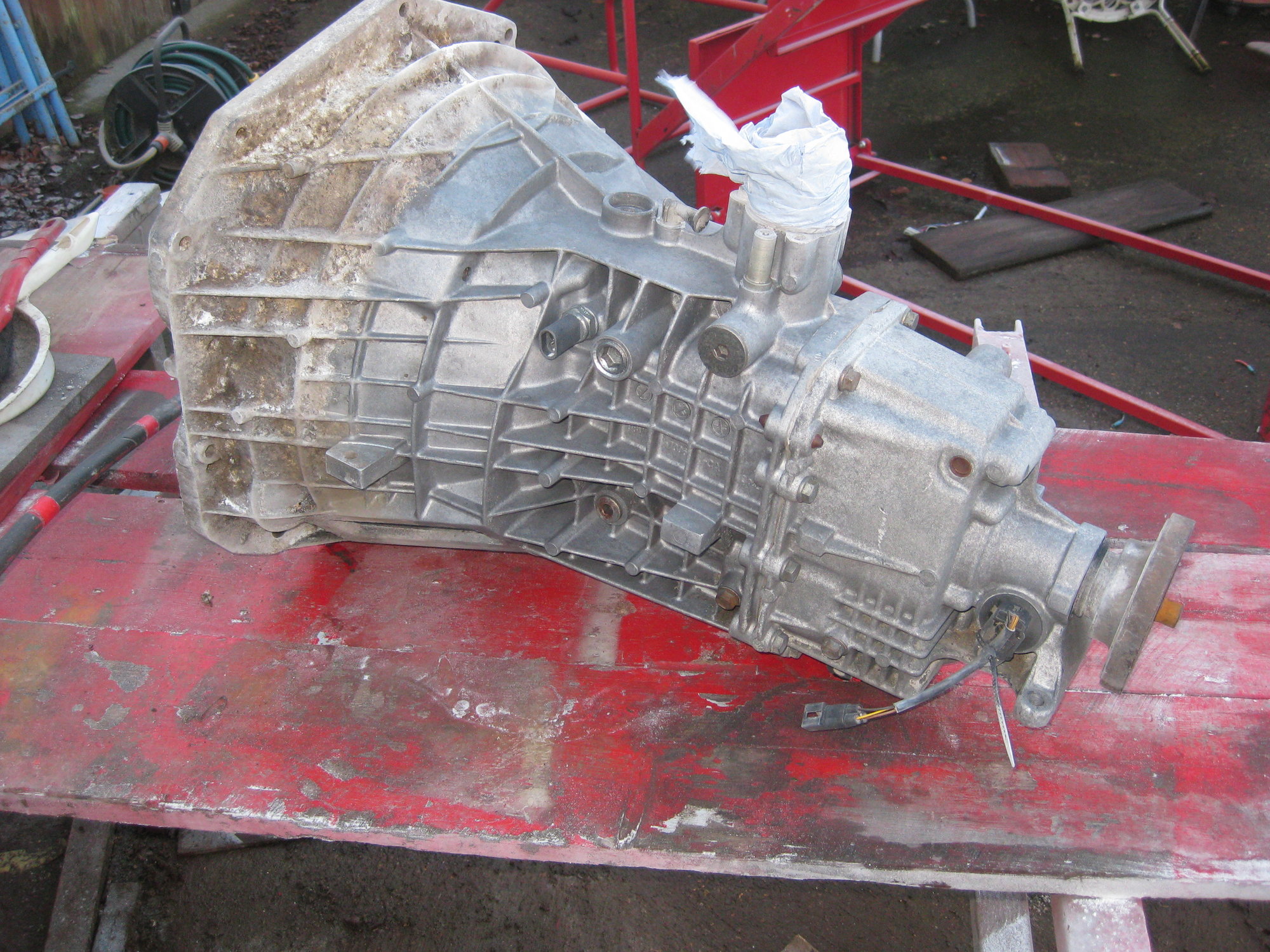

For soda blasting I use a cheapo spotblast gun from Aldi or Lidl. Don't bother with that collection bag thing That it comes with. as I have a reasonable space outside my workshop I just blasted this gearbox out in the open.
Before:
After:
The bellhousing area wasn't blasted as I am going to machine off that part of the box so it can be mounted up to a different bellhousing. Mycompressor has two water traps in series, didn't seem to suffer any problems with clogging of the soda.
