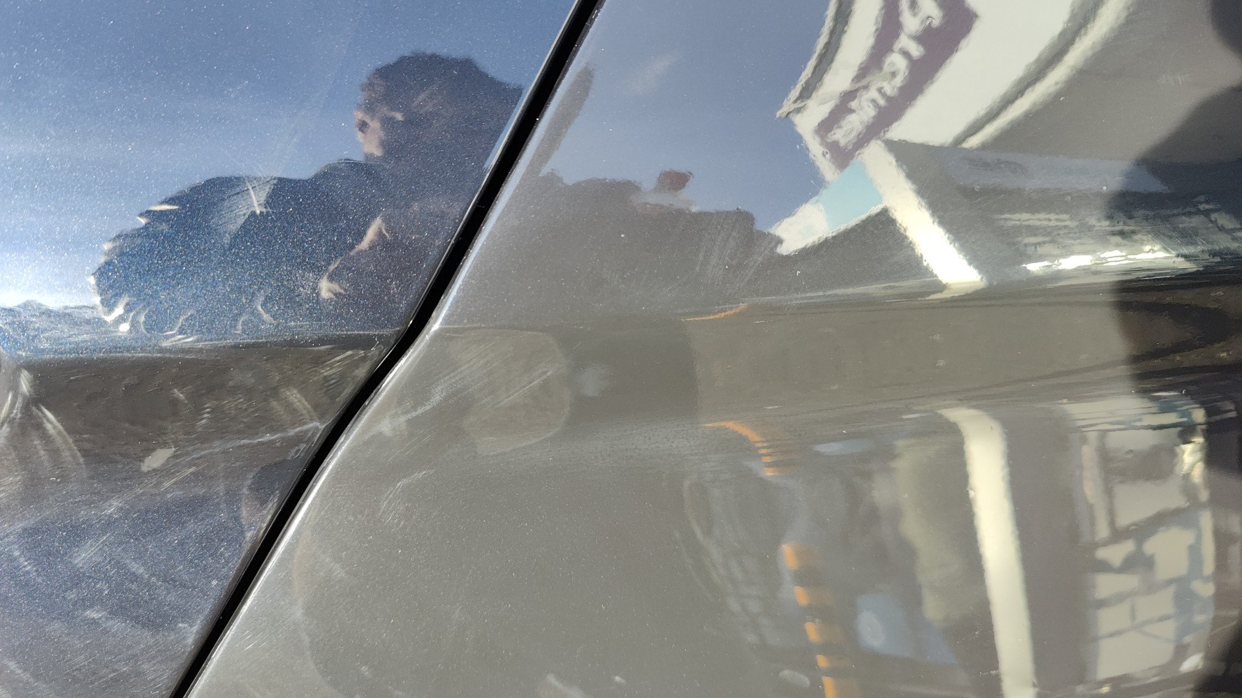

look at the mess they did on this poor fellas car , bet its all 1k clear coat too
Finish on the door not great though. Peeling off alreadyfeck me.. i regularly do a better job than that in my garage....
That is correct. I think it might be a weeks training though.Are these Smart Repair blokes franchisees?
Iow, pay some cash, get a two-day training course and a bit of toolery and let loose without a clue or any history or knowledge of what a good job entails.
in the dark lolThat is correct. I think it might be a weeks training though.
They work outside in the cold and damp too, so its hardly surprising it doesn't work out. Yes I know they use tent things and heaters, but its not the same as being indoors, and if you were going to DIY, you would pick your day, not do it in the conditions that I have seen these guys working in.some of the pdr guys are bandits too , hard to find a good one
with the smart repairs what i would fear is they often use substandard materials , so it might look ok on the day but age faster than the other panels , due to 1k primer and clear
id guess he was trying to mix up a thimble full of colour for that job and when doing small amounts a slight error makes a massive difference
