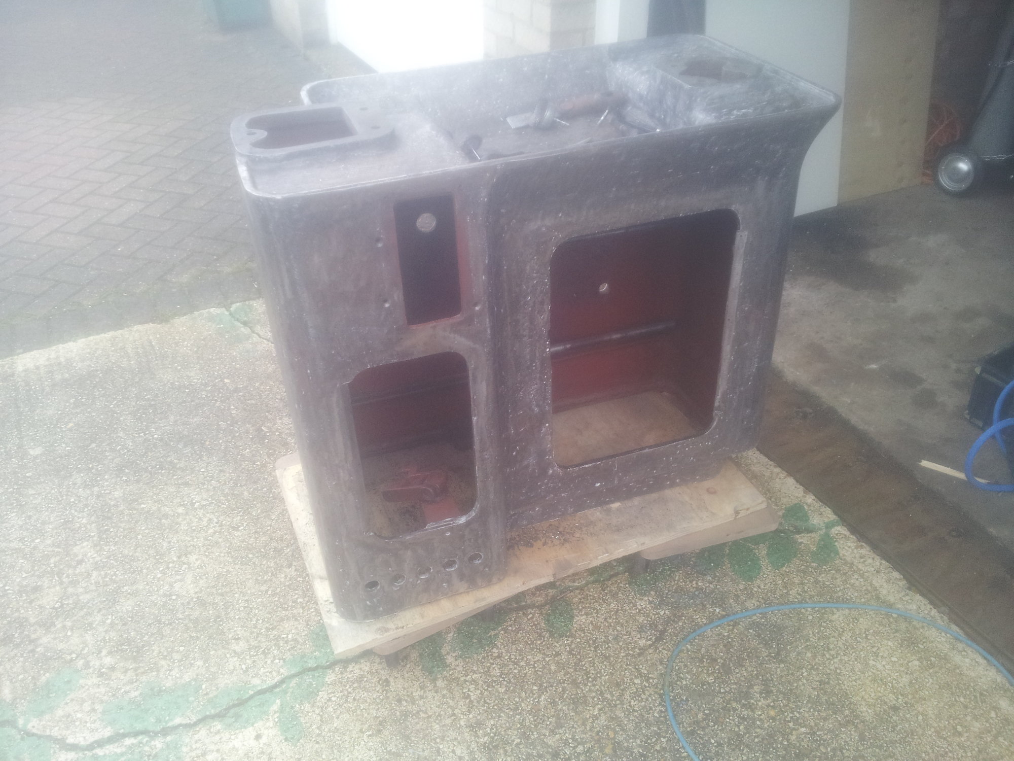

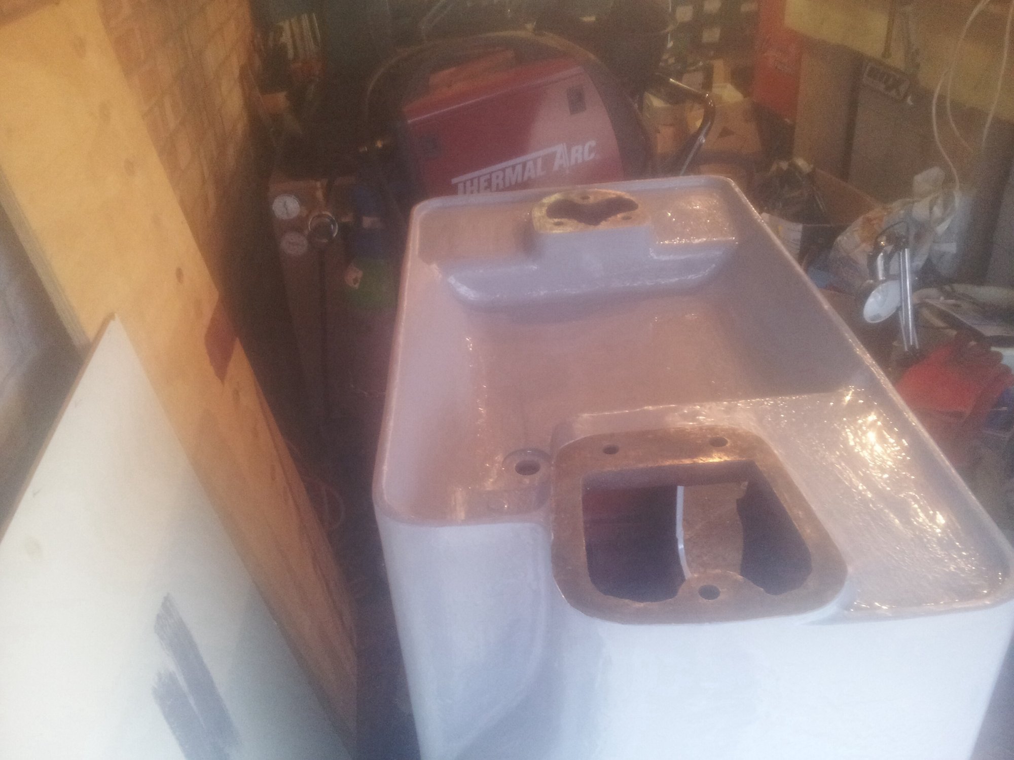

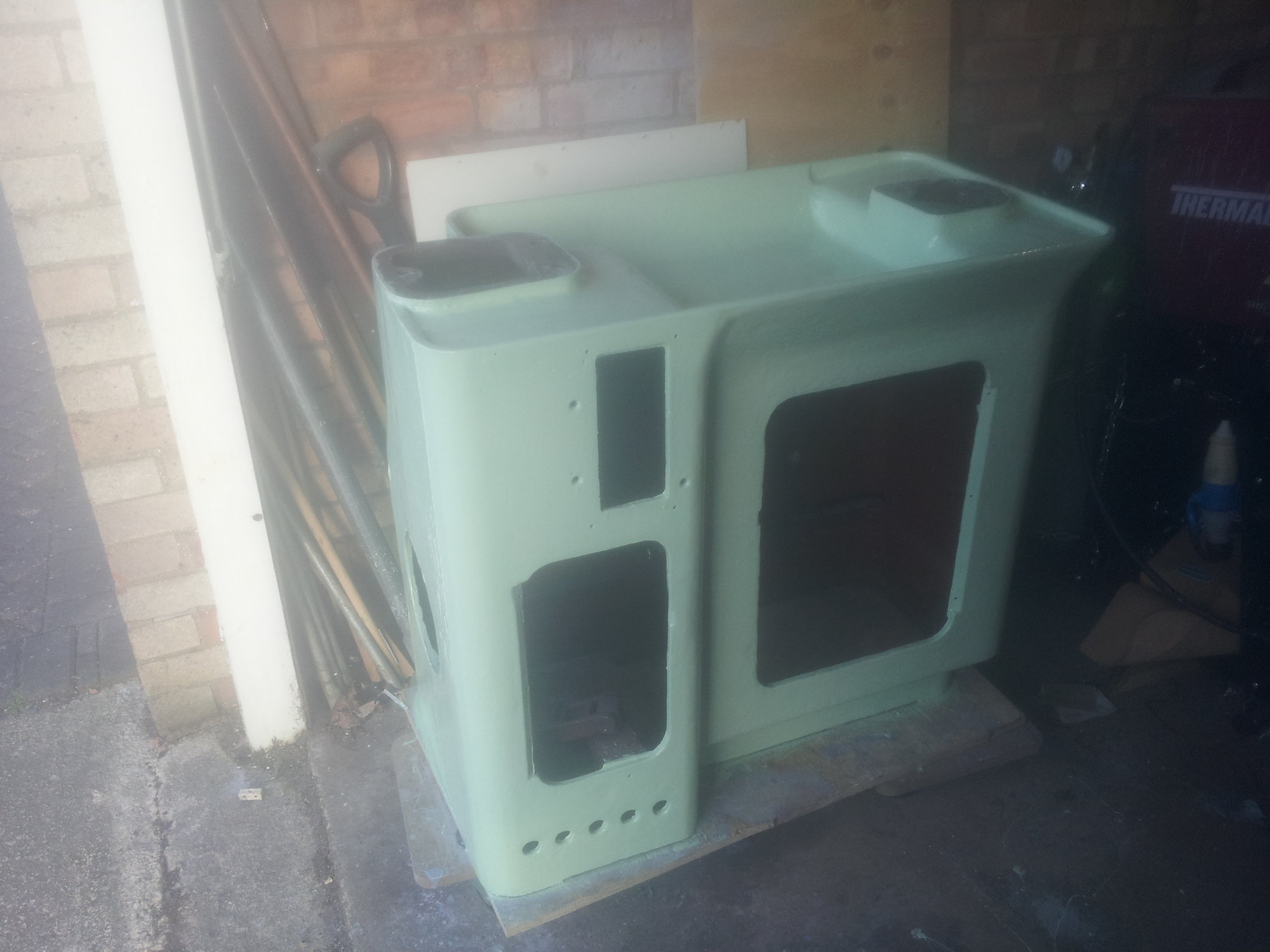

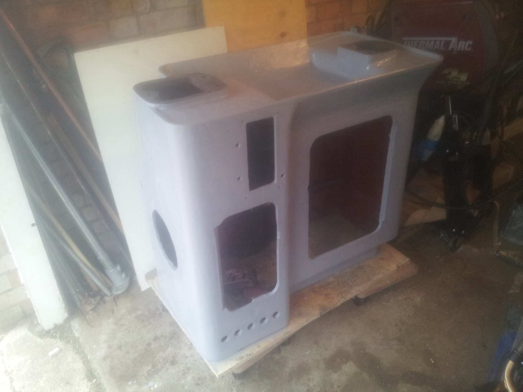

The tractol I'm using fills very well to be fair. A quick rub and a second coat with a bit more care and its good for topcoat.Good to see I’m not the only one who does the ‘one thick coat’ of primer. I find a squirt of this stuff works wonders before you go applying topcoat. You get it from automotive shops, Halfords will probably have it
https://www.supercheapauto.co.nz/p/sca-primer-filler---400g/288527.html

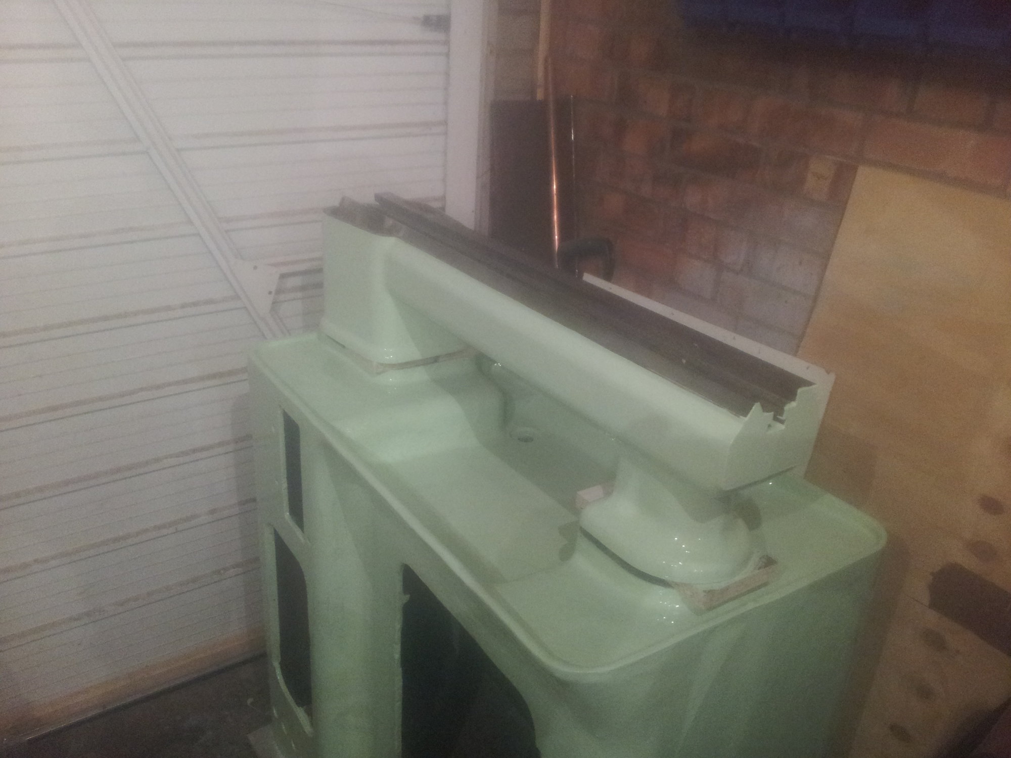

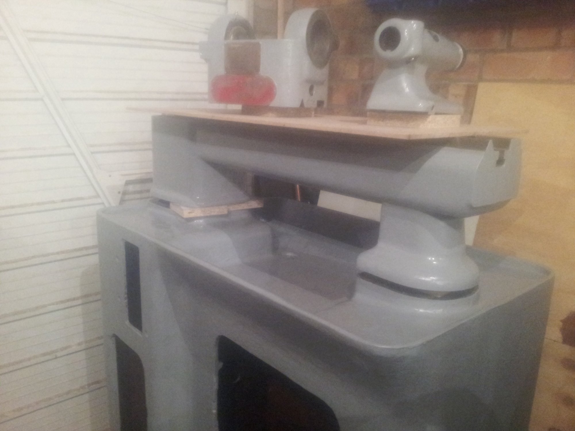

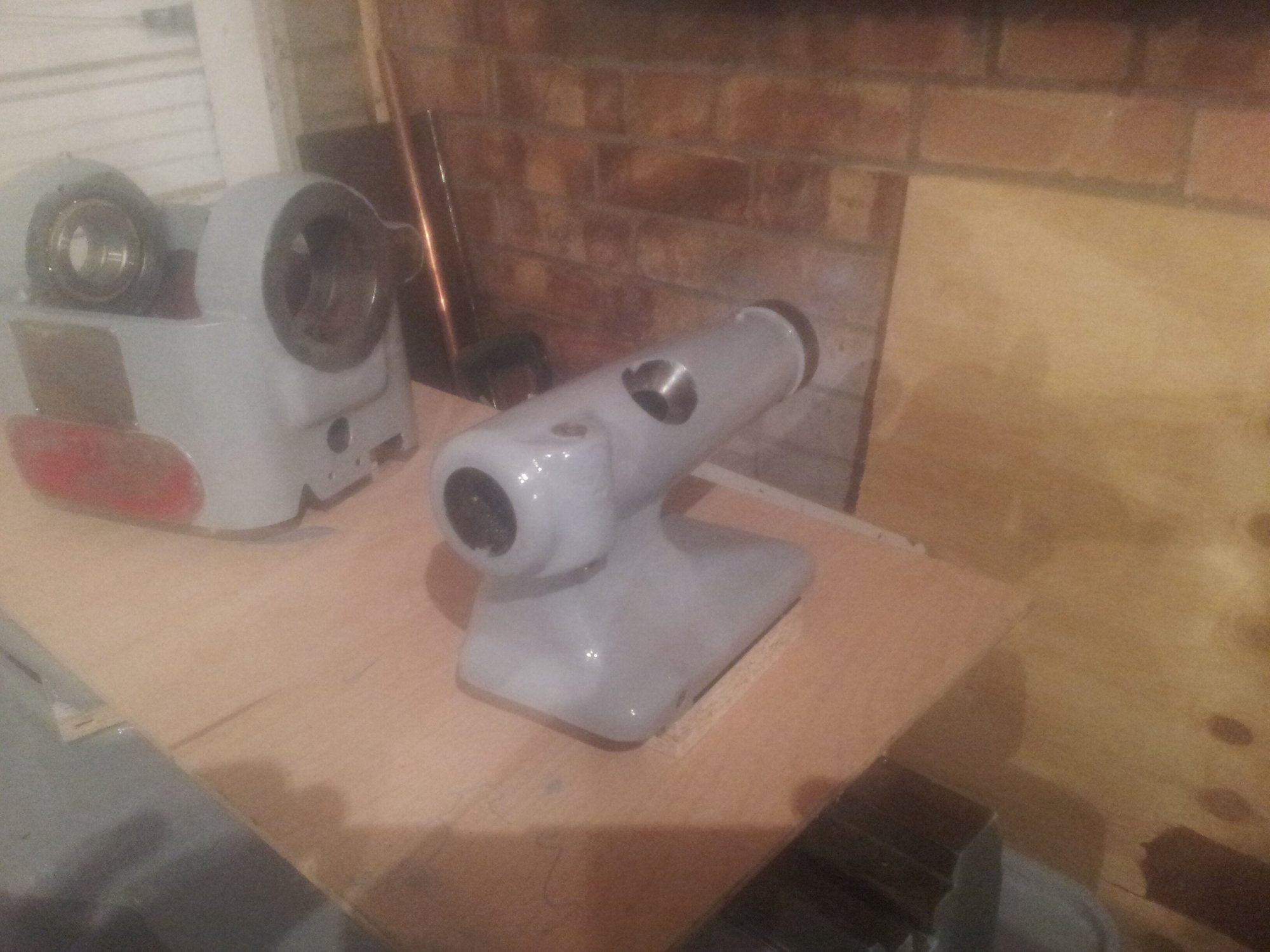

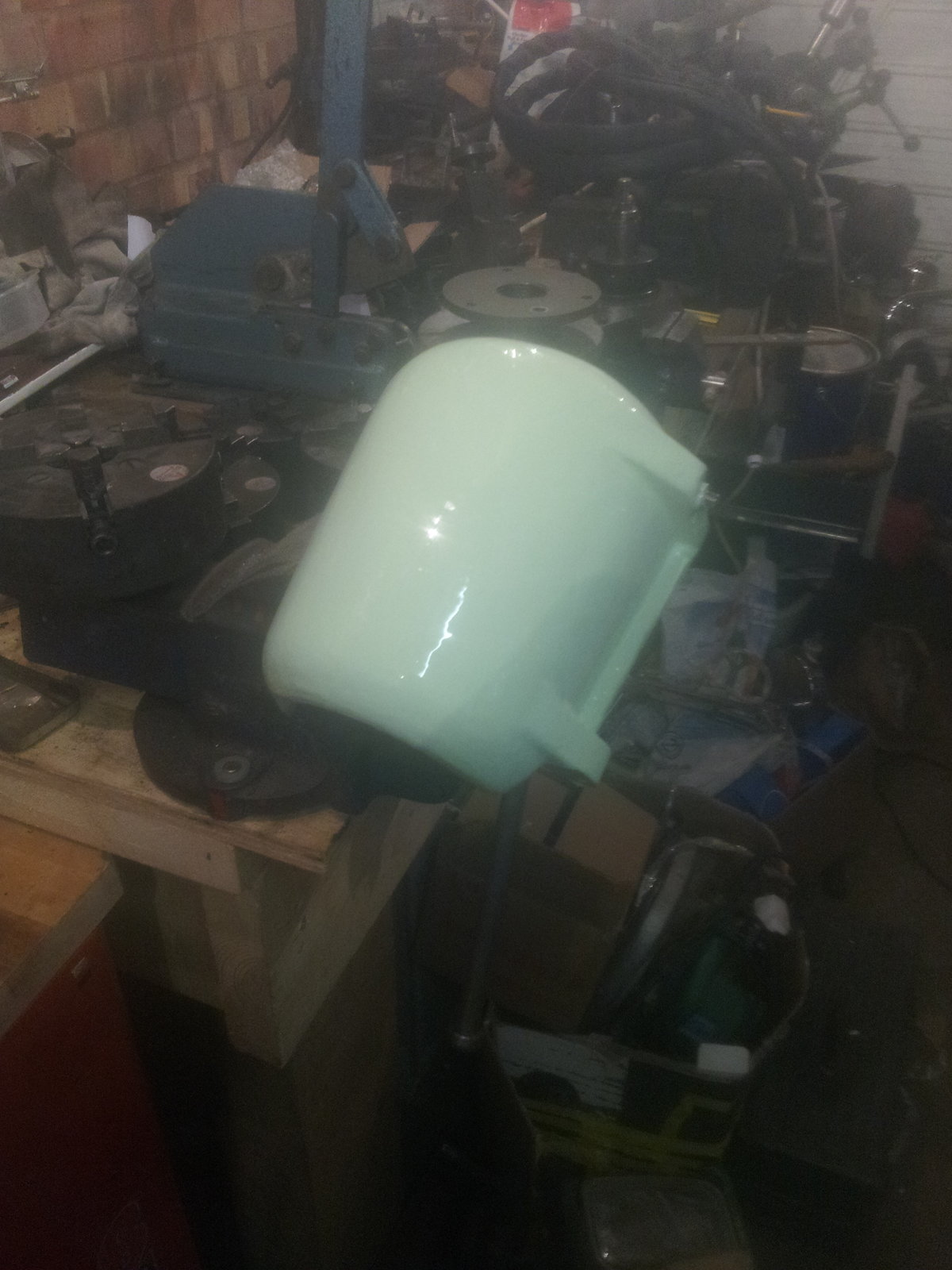

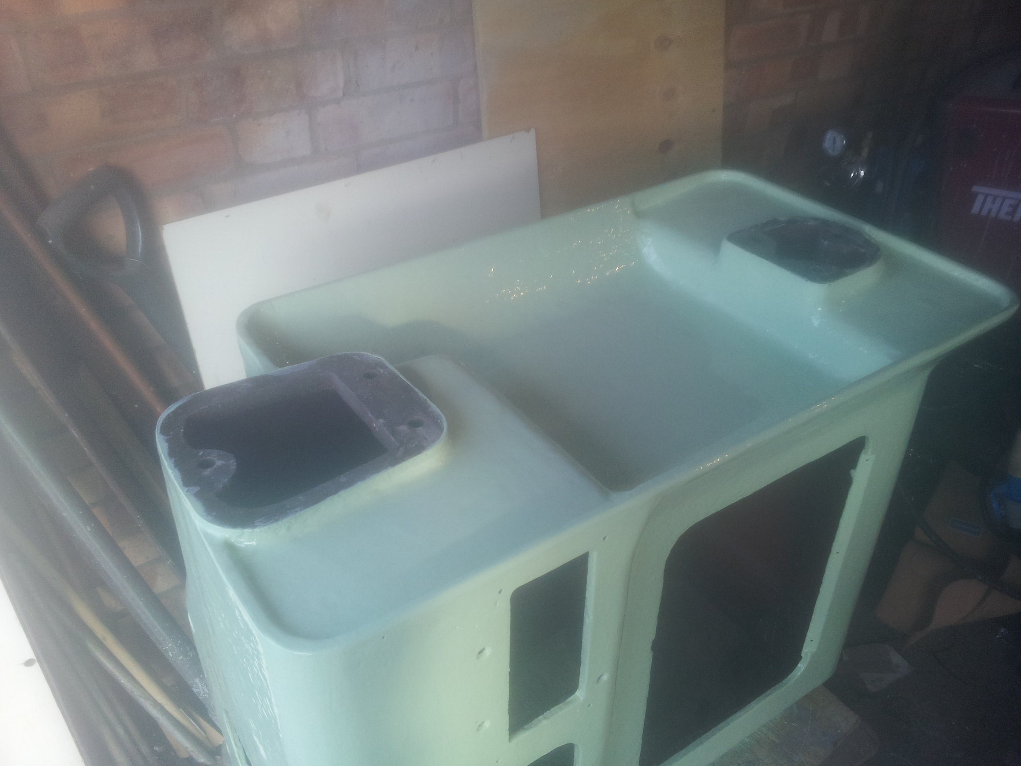

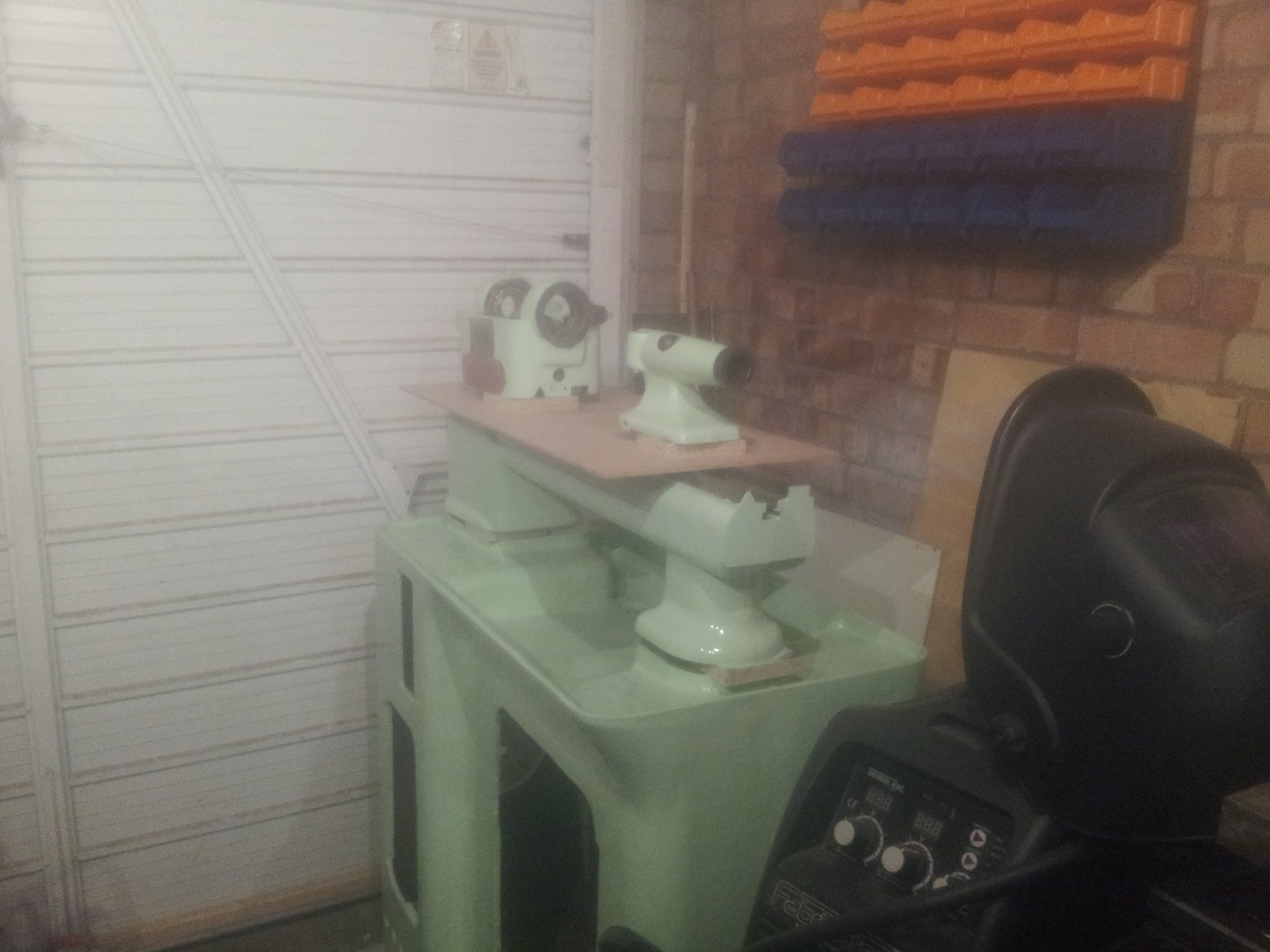

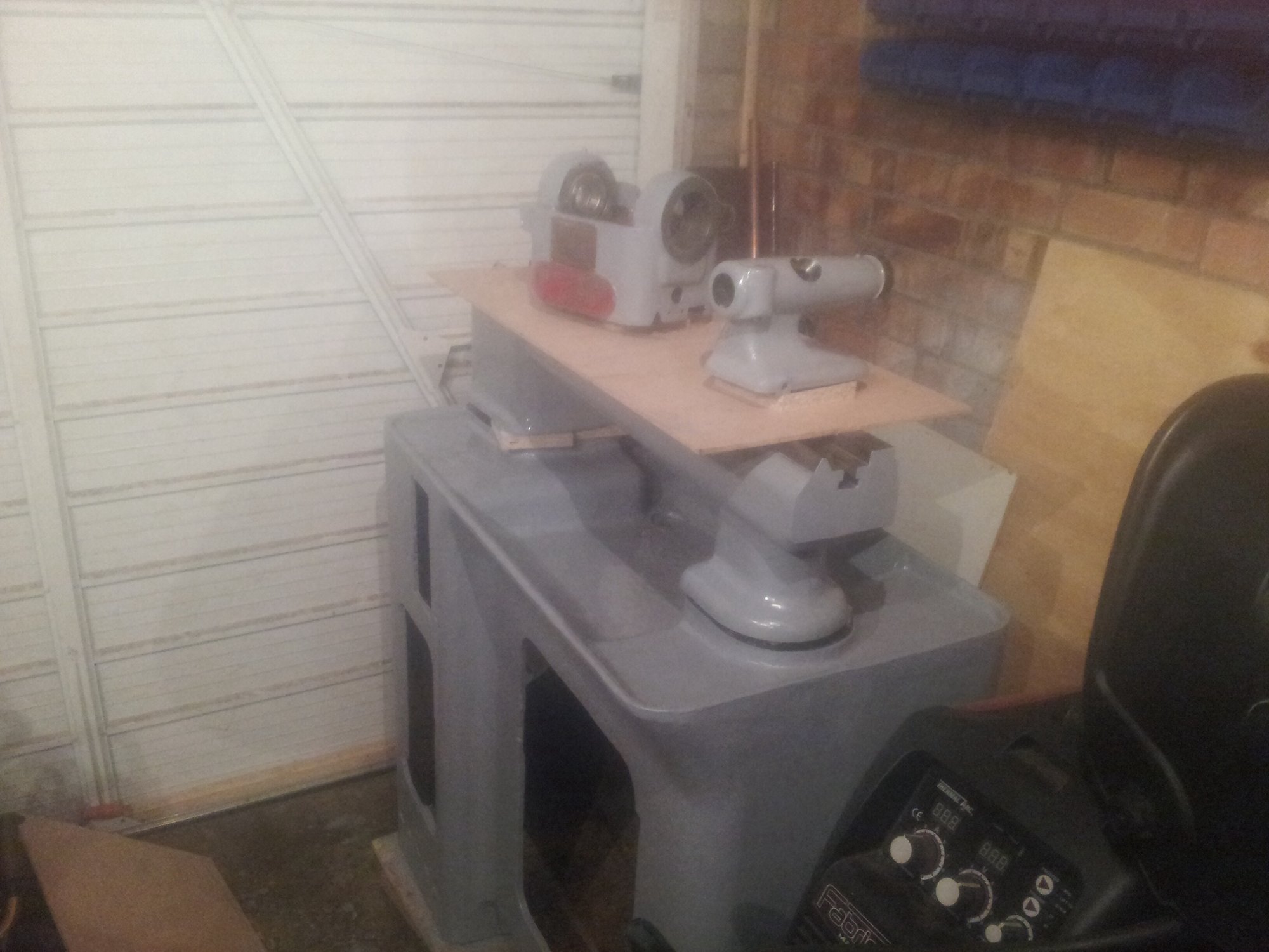

Coming along nice mate.Managed to sneak out while the wife's putting baby to sleep.

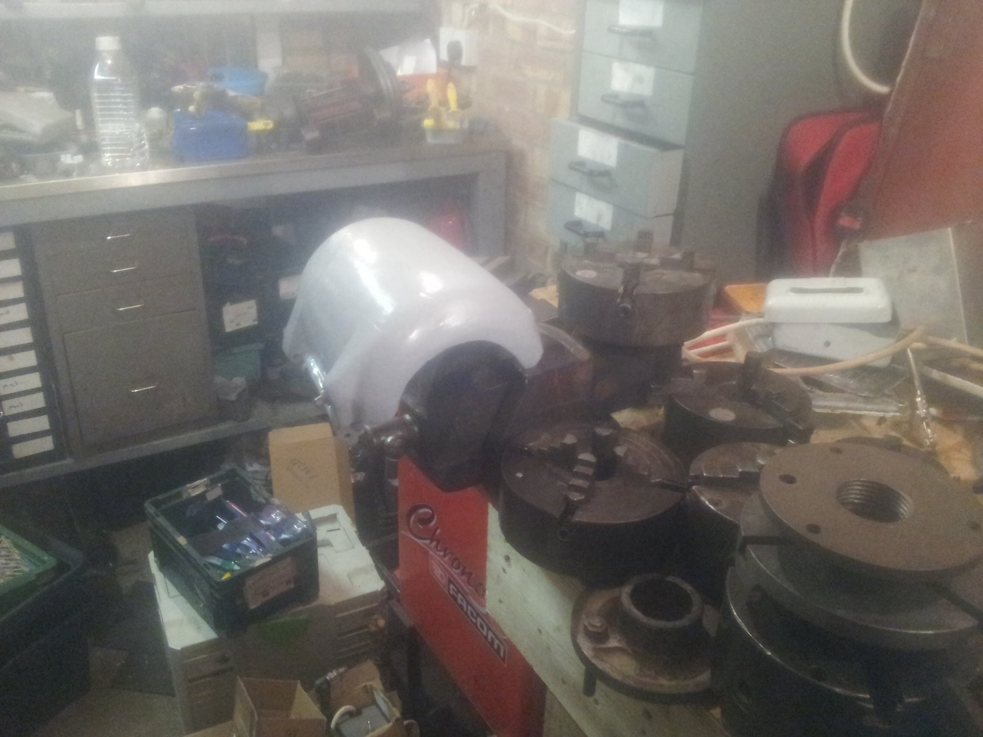

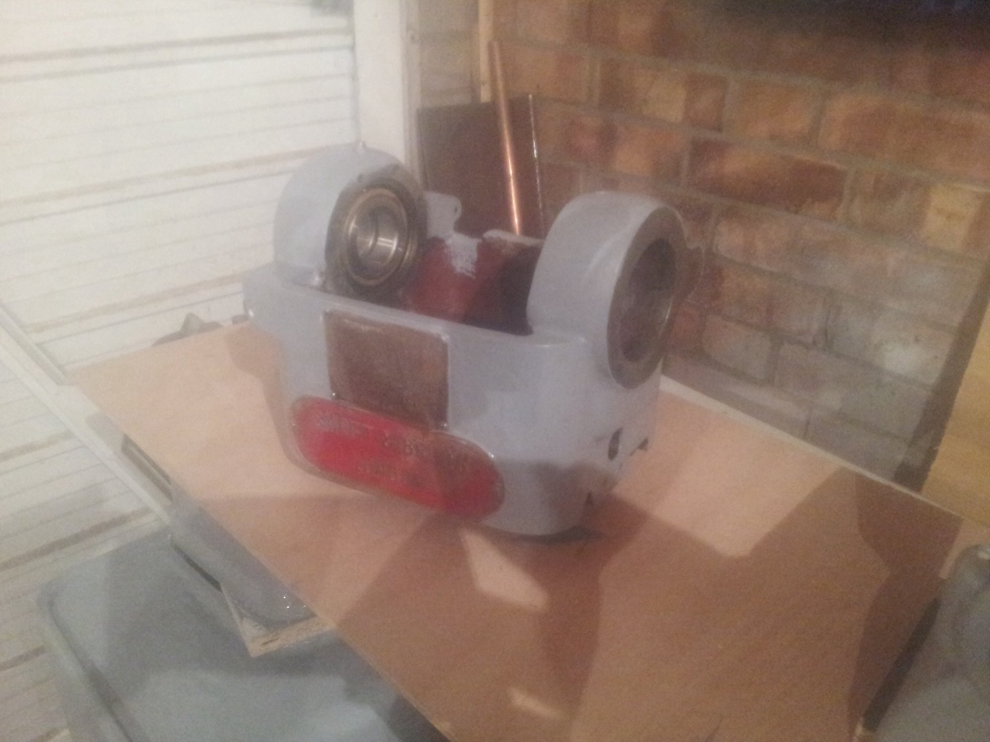

Still have some cleaning to do on the working parts these bits but put them into primer for now. Been bare long enough.
Thankfully the boiler in my garage serves to keep it at a constant reasonable temperature and I don't suffer from surface rust on any bare metal in there. New roof last year helps too.
Name plates refused to budge and were close to ripping. They can stay in place and il deal with them there.
View attachment 172374 View attachment 172375 View attachment 172376 View attachment 172377 View attachment 172378
gonna be a quick one now mate,Coming along nice mate.
