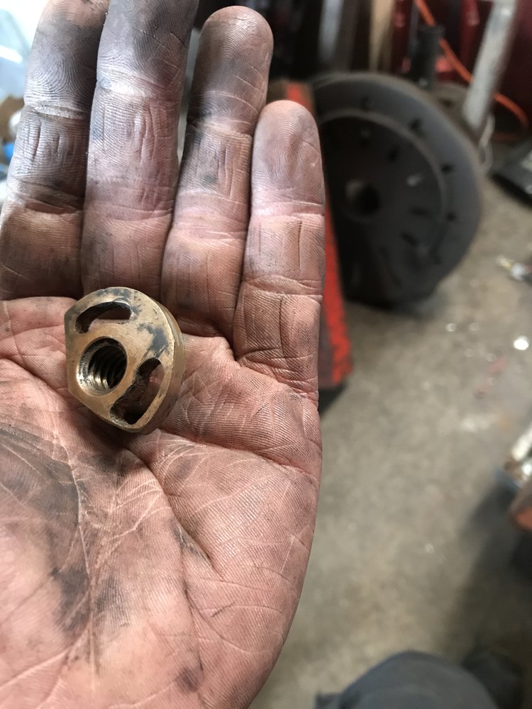

Is it a single start left hand thread
Single start right hand thread, at a guess I'd say it was 3/8" but I'll measure it tomorrow.
The bottom slide bar is left hand thread.

Well that is doable. I would have to screw cut it but that is where the challenge lays and the reason I offered! Again, I will see if @doubleboost is interested if not we can go to PM and sort sending it over. I have brass not bronze in stock if that will be acceptable?Photos of the measurements.
That was my thought too. You aren't planning on continuous production from what I recallUnless any lathe experts think otherwise I don't think it'd be under enough load for brass to be an issue? It would wear quicker, but given how much use I expect it will get it's likely to outlast me.
so it should be ok!That was my thought too. You aren't planning on continuous production from what I recallso it should be ok!
I am sure I have a 3/8 acme tap got some bronze as wellWell that is doable. I would have to screw cut it but that is where the challenge lays and the reason I offered! Again, I will see if @doubleboost is interested if not we can go to PM and sort sending it over. I have brass not bronze in stock if that will be acceptable?
that looks like 1/2 inch in that case I have a right hand acme tapLooking at the dia measurement it looks more like 7/16" 10 tpi.
If you (and @My Old Landy ) are happy with that I can post the bar and nut to you. If you PM your address I'll get one of those postage tubes to drop them in, let me know what I owe you for it and the return postage then when it's done you can re-use the tube to send it back.that looks like 1/2 inch in that case I have a right hand acme tap
