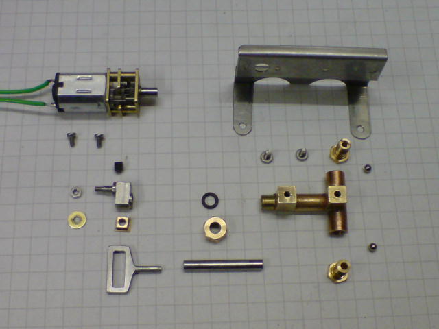

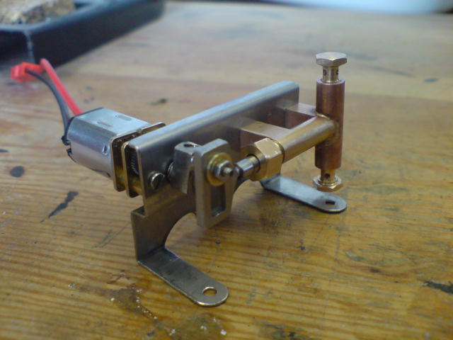

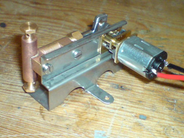

now I have the linkage to drive the pump, I needed to make a pump, its one of those jobs that at first doesn't sound to bad until you think about what it needs to do, keep the weight to a minimum and keep it compact. It took me a while to decide if I was best machining it from a scrap gunmetal casting or to make with the main body being made from flat bar and for the bits that have the one way valves being made from round bar, and sliver solder them together. I went for the second option as it would be better wearing if the part that has the one way valves were made from phosphor bronze with the main body being made from brass.

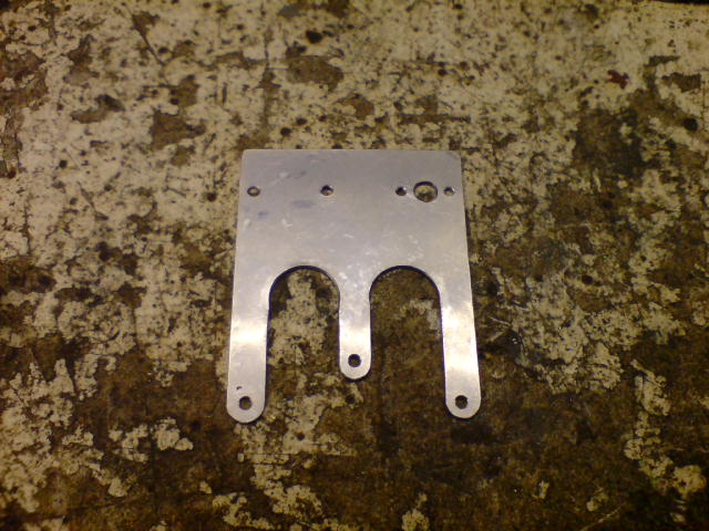

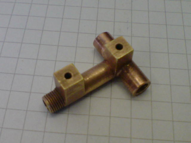

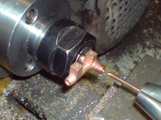

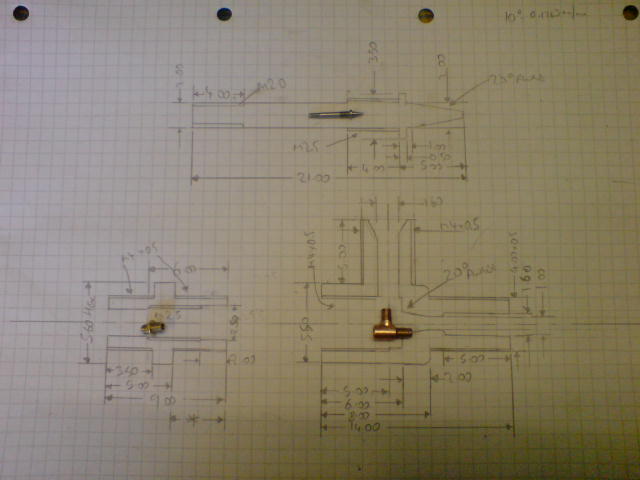

I started off making the main body, which can be seen with the drawing that I was working to. its a working drawing for me to be able to follow and understand, and easy to alter too. the body at this stage has the two mounting holes for the legs in it, and a hole where the valves would go though it.

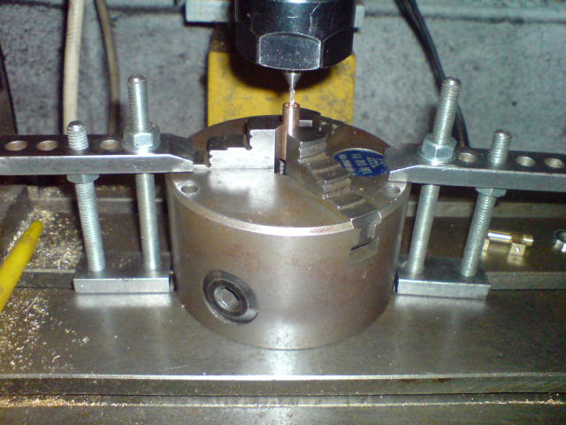

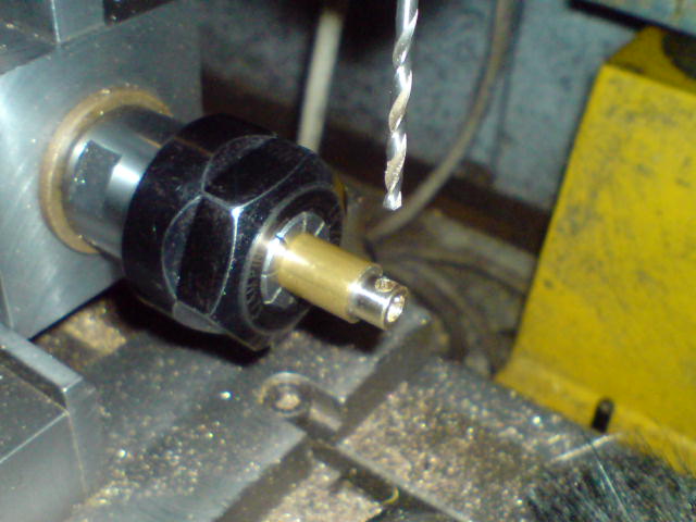

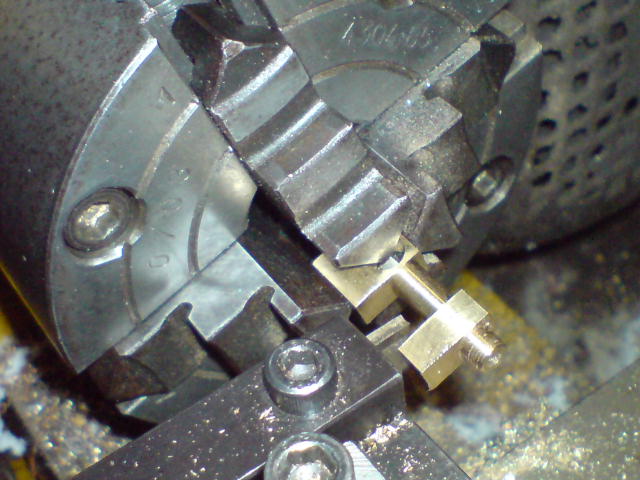

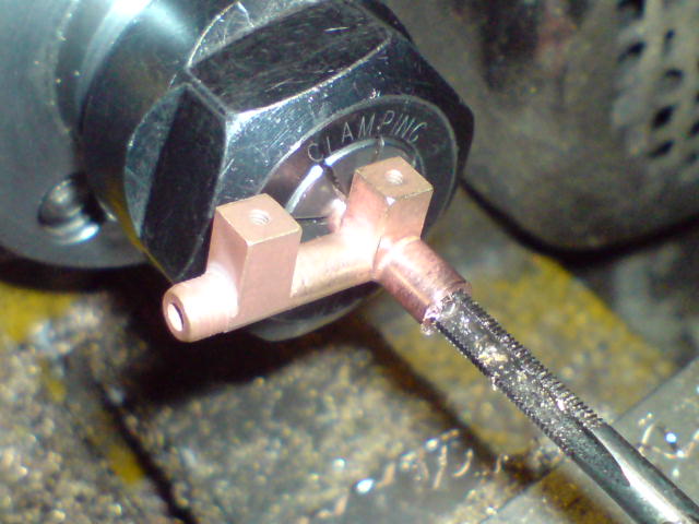

then its turned in the lathe to create the legs and create the round part of the cylinder and the end was threaded for holding the o ring that will seal the piston into the cylinder. this end was also centre drilled so that I could finish the bore off later in my milling machine, as I though that would be the easiest way to hold it. this was machined with a parting tool with very little overhang.

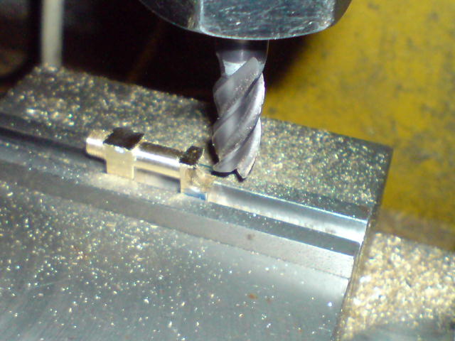

the sides of the main body were then milled down to the finished size, and the top of the cylinder were then rounded over with a file

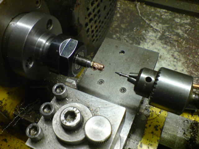

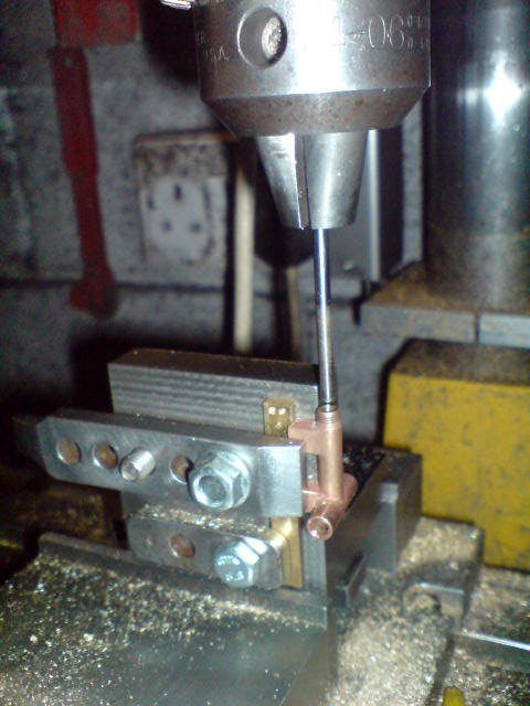

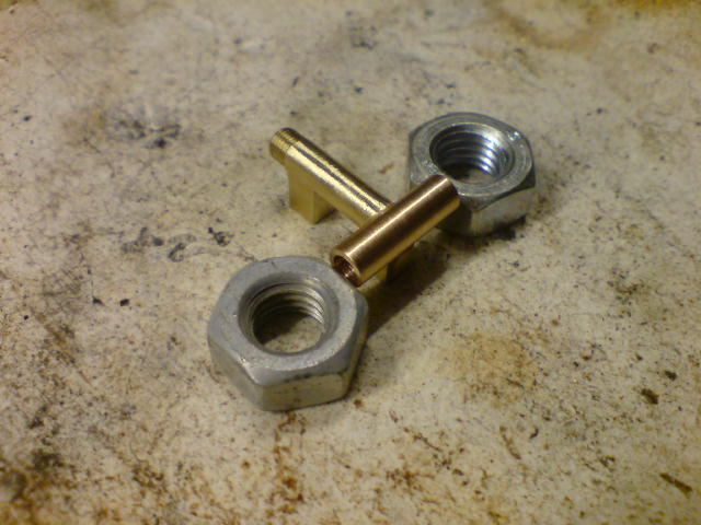

the part that becomes the one way valves had half of it machined, this half didnt need to be as accurate but needed a small notch milling with a 1/16" milling cutter to allow water past the ball when it was lifted off the valve seat. this was done on the milling machine

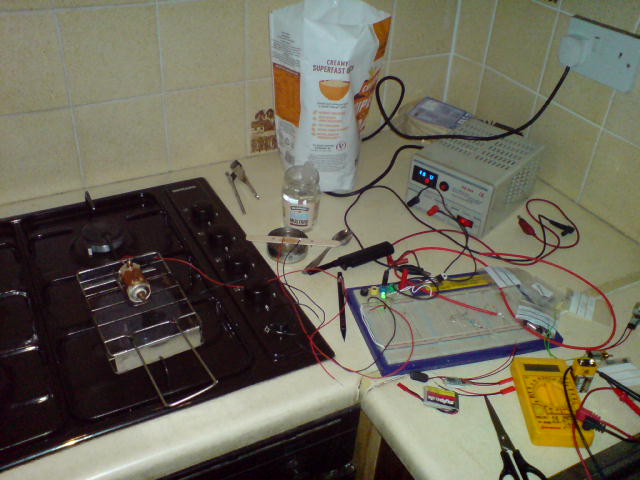

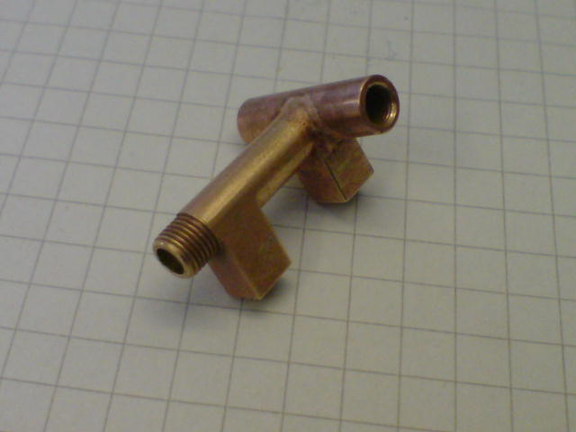

and the two parts ready to be silver soldered together, the M10 nuts are just to keep the two parts in place

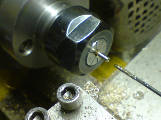

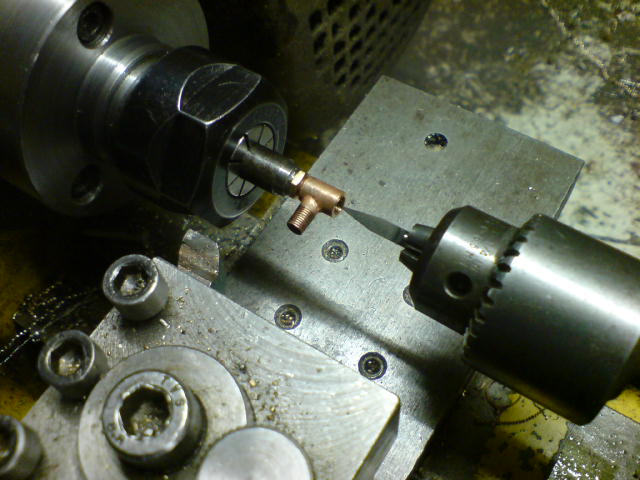

the other valve part being machined, being threaded to fit a union or banjo bolt (Im going for banjo bolts as it reduces the height.)
and creating the seat for the ball using a hardened steel ball (on the end of a 2.4mm tig rod) gently hit with a hammer on the tailstock. if this was done before silver soldering the oxidation and pickling would have affected the accuracy of the seat for the ball

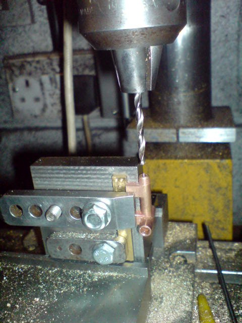

the cylinder bore was then drilled out I did try a reamer on some scrap brass but the fit was better with with a drill as the stainless rod I'll be using as a piston was slightly undersize. this would have been easier to do when in the lathe for the first time, but could have distorted slighty when silver soldering, and silver solder could have gone in the bore which would have ruined it.
a bit of oil on some stainless rod and the bore was "adjusted" to have a nice sliding fit
and the finished part
Im quite pleased with how it worked out and its a bit of a long post about such a small part, but its worth having a think about how you'll make things as with these things that the first option isnt necessarily the best. also dont be put off by things looking to be complicated, break it down into logical steps and it becomes easier to take on. if you look at the piece of brass in the first picture and the last one you'll see what I mean and they dont look they are the same part.
