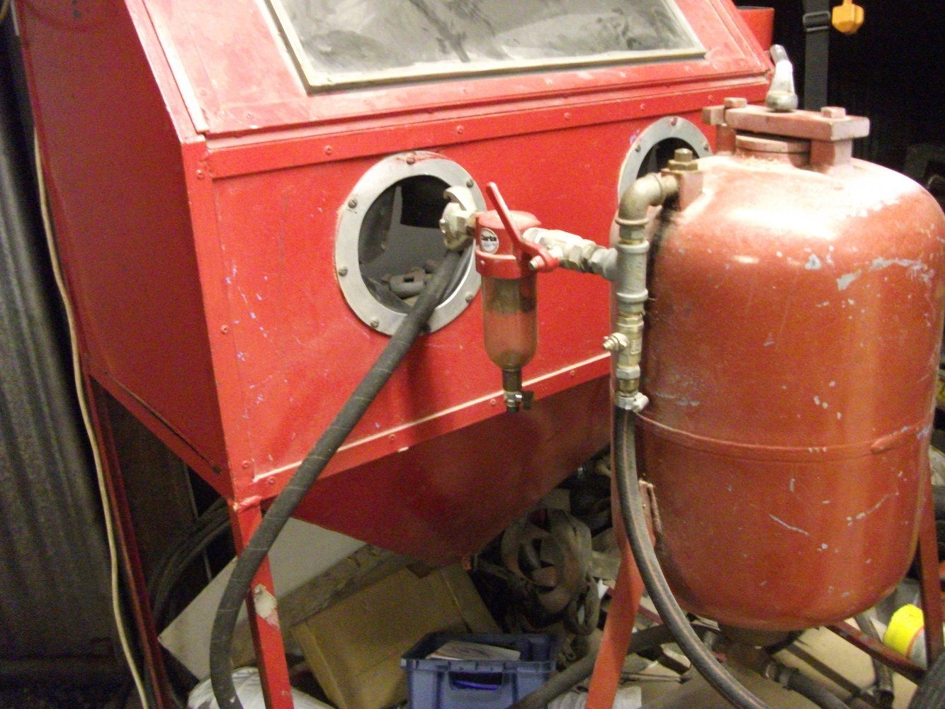

, if you want to take it to the next level I'd definitely recommend going with a media mixing valve, it just works so much better than the pickup tubes.

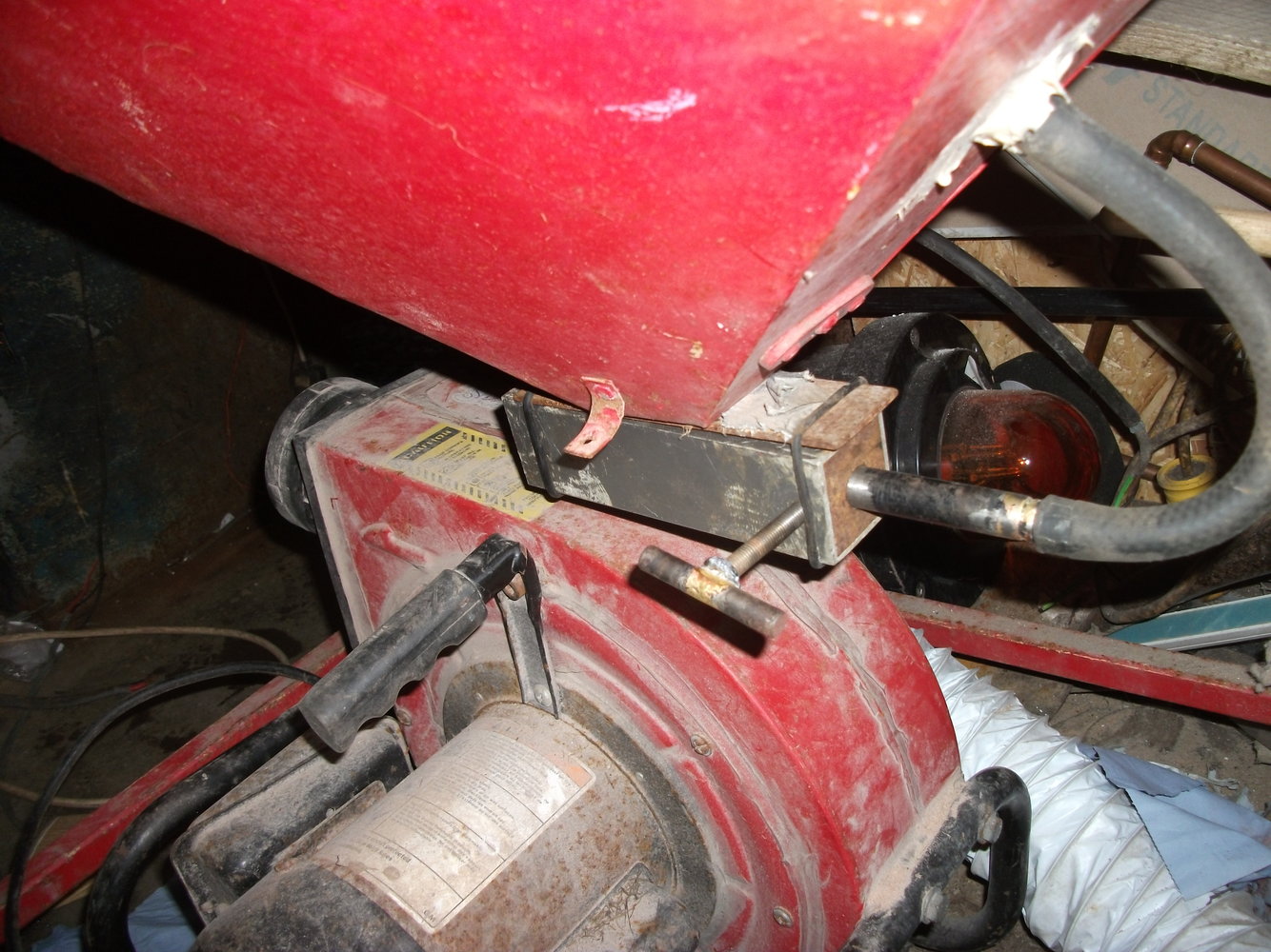

how do the valves work I have a similar wee cabinet I was just thinking of making something with some box section or tube and a lever 15mm valve Ted in to adjust to let air into the mixNice work, if you want to take it to the next level I'd definitely recommend going with a media mixing valve, it just works so much better than the pickup tubes.
like thisI got a mixer valve off of Flebay, works much better
like this View attachment 276135
I used a spare 15mm gas valve same ideaI just used a 15mm valve on my small blasting cabinet

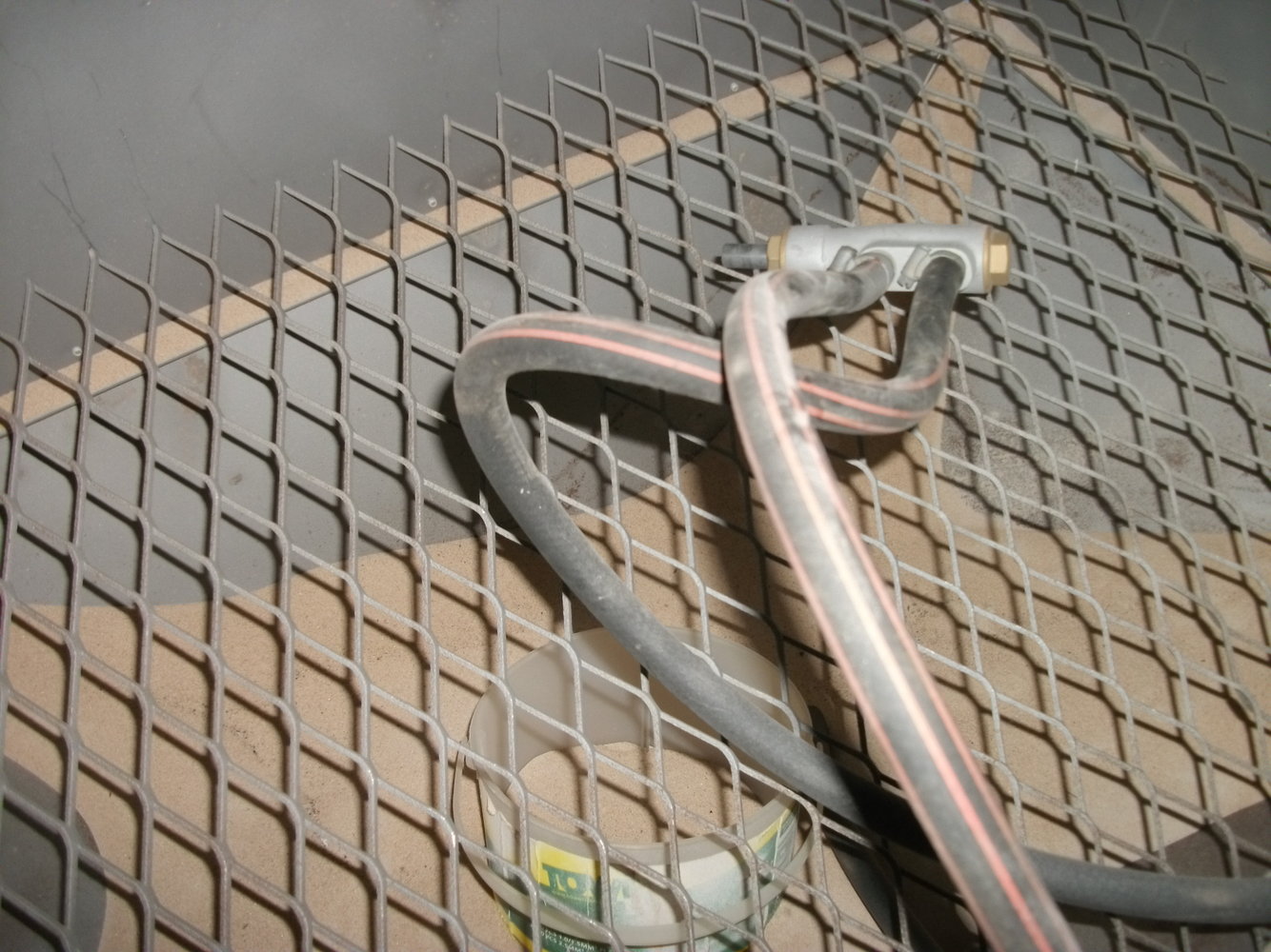

benchtop blasting cabinet modifications.
I've had one of these http://www.ebay.co.uk/itm/200472037005 for a while now so thought I'd best start tweaking it so I can use it for blasting small parts. for many years Ive been using one of these blast guns (originally from Anglo Scot Abrasives)...www.mig-welding.co.uk

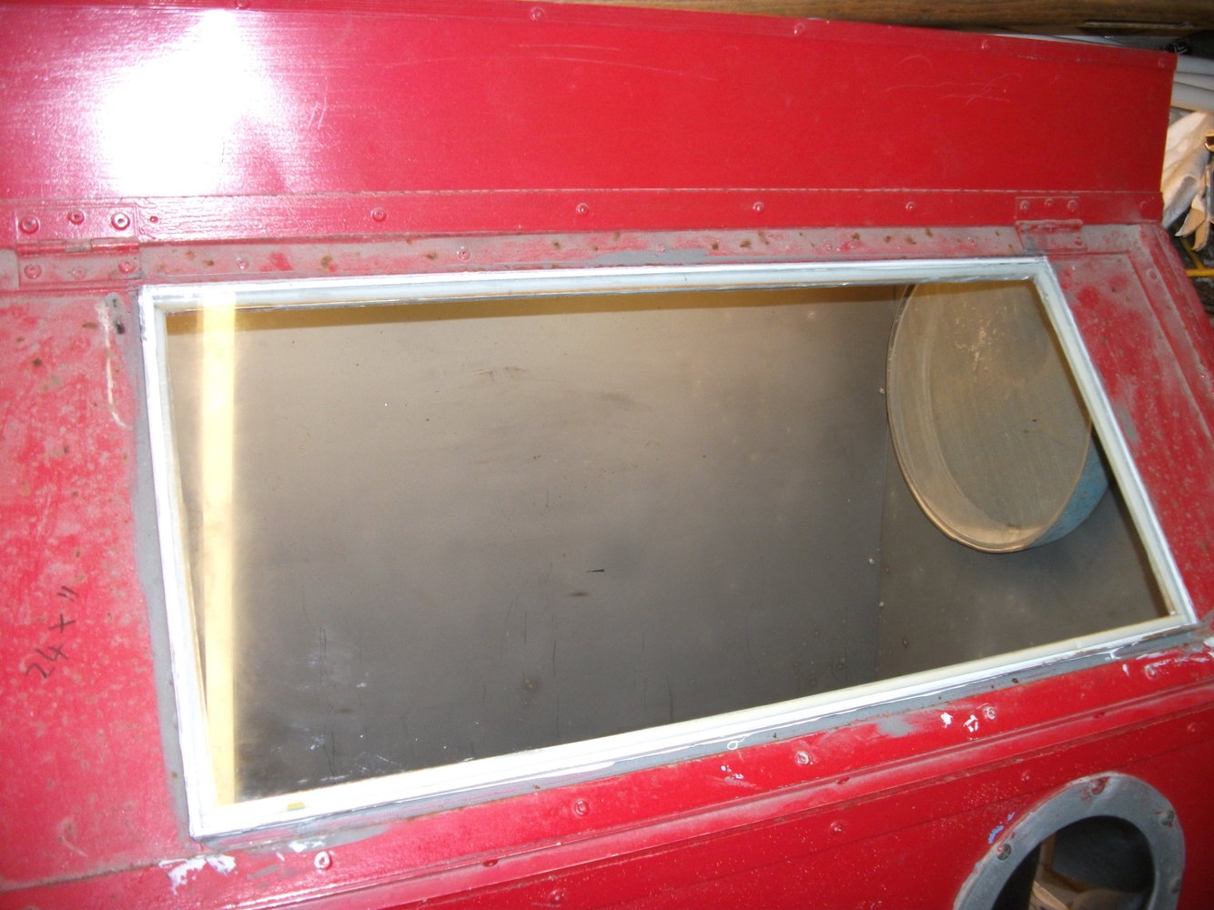

to be honest it would be easy to make your own completely if you were to alter the original and make it a larger sizeeasy to make out of a welded frame from some 1inch x 1/8th angle and sheet panels heres my larger one it takes car wheels
