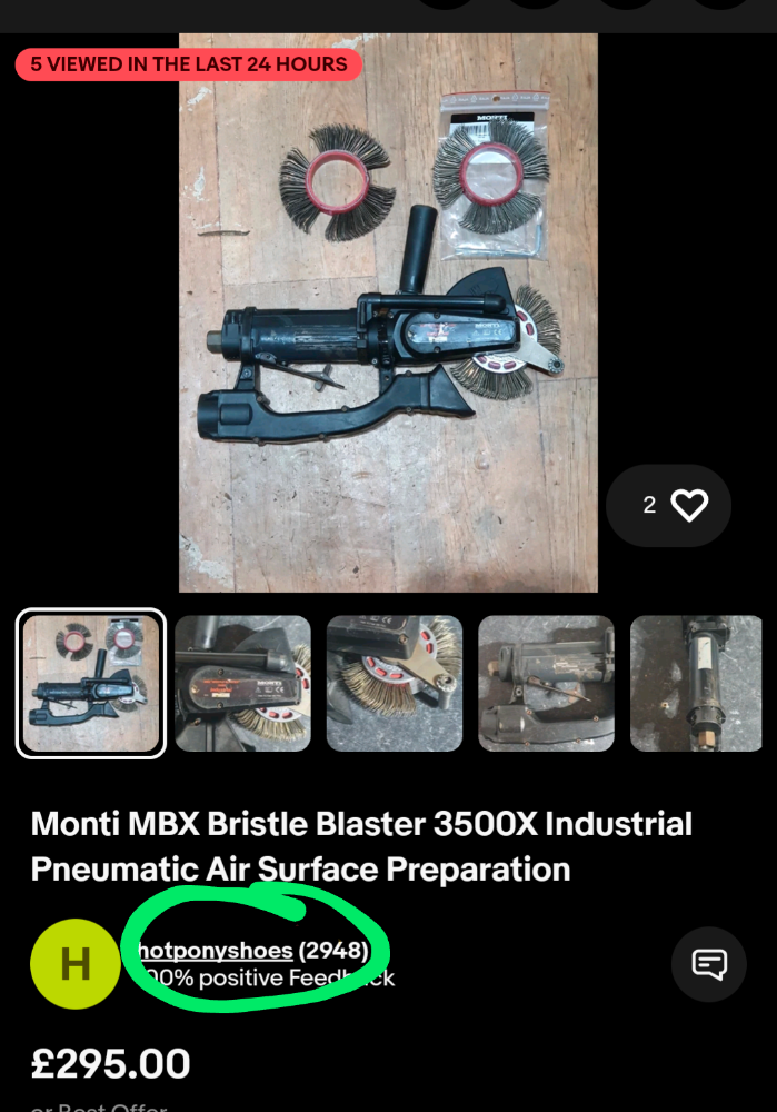

Monti Bristle Blaster?
4 variable speed, so it states.....

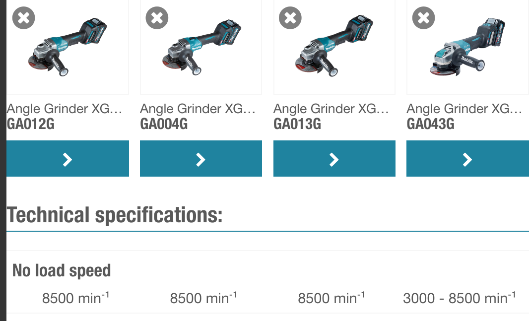

Incorrect. Many current branded cordless grinders are at the 8500rpm speed, where as 80m/s would be 13k rpm, quite a difference.Any machine designed or sold to accommodate abrasive wheels will run at roughly 80m/s (actual rpm relates to diameter). The only way you will get a slower-running machine is to buy either a variable speed one or one that cannot take abrasive disks.
Power = torque x rpm, so the only way any small spinny thing can have enough power to do its job is to run at a gazillion rpm.
Small, powerful and slow-running is one of those "cannae change the laws o' physics" items.

Guess what i bought
