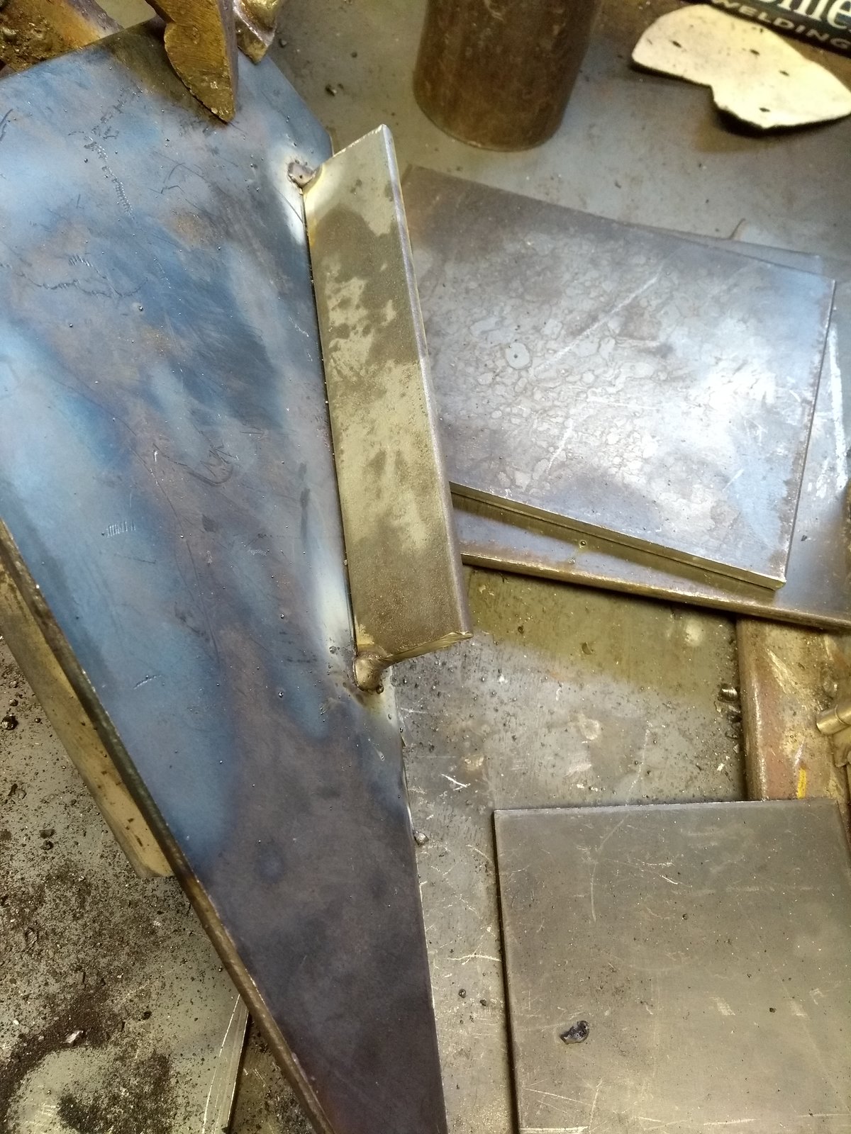

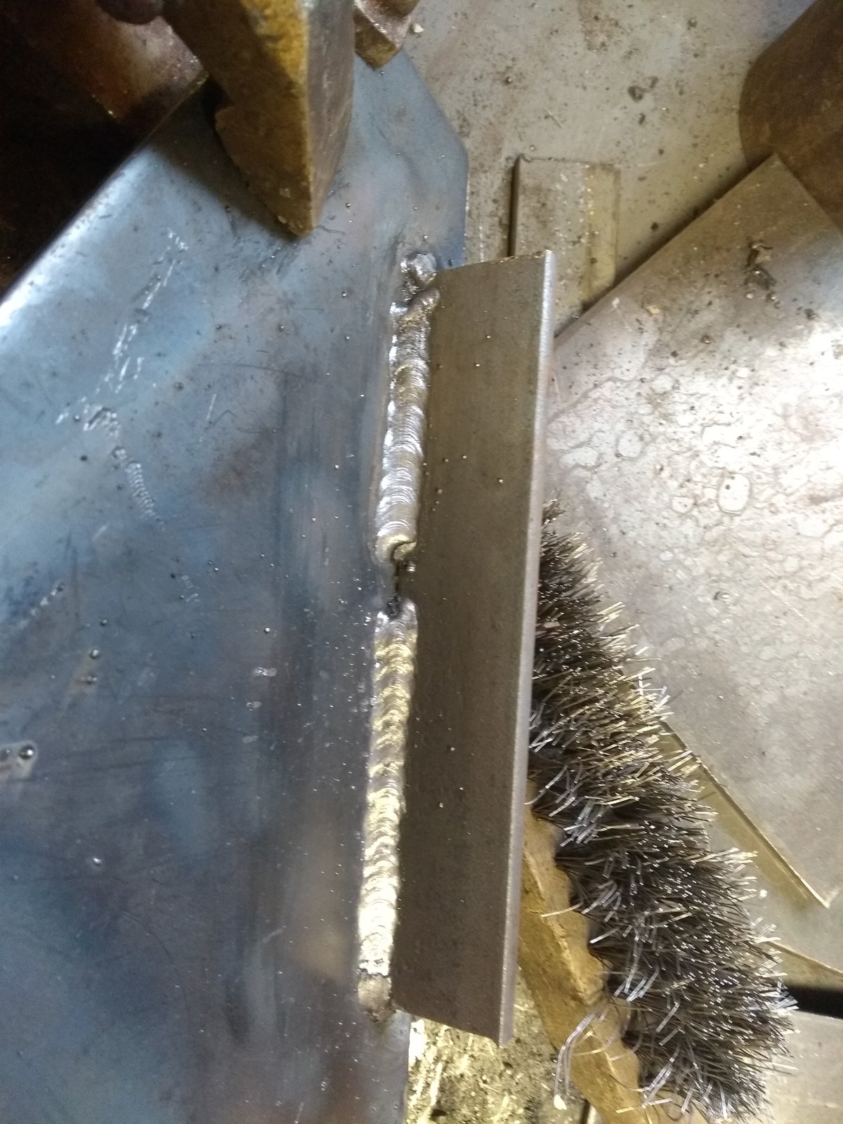

Four boxes .Brian have you got quite a lot of these rods ?? From my non pro eye I would of said the travel speed was to fast and the amps a little low and the possibility that the weld is not being deposited correctly down the joint and not taking both sides hence the slab were the arc has not made contact
I will have another go tomorrow , the amps on the little Clark inverter are full on AT 90, The other welder I'm not sure that the amp control wheel is doing anything .. The welds are glowing red hot after about an inch
The rods are 6013 '2.5
