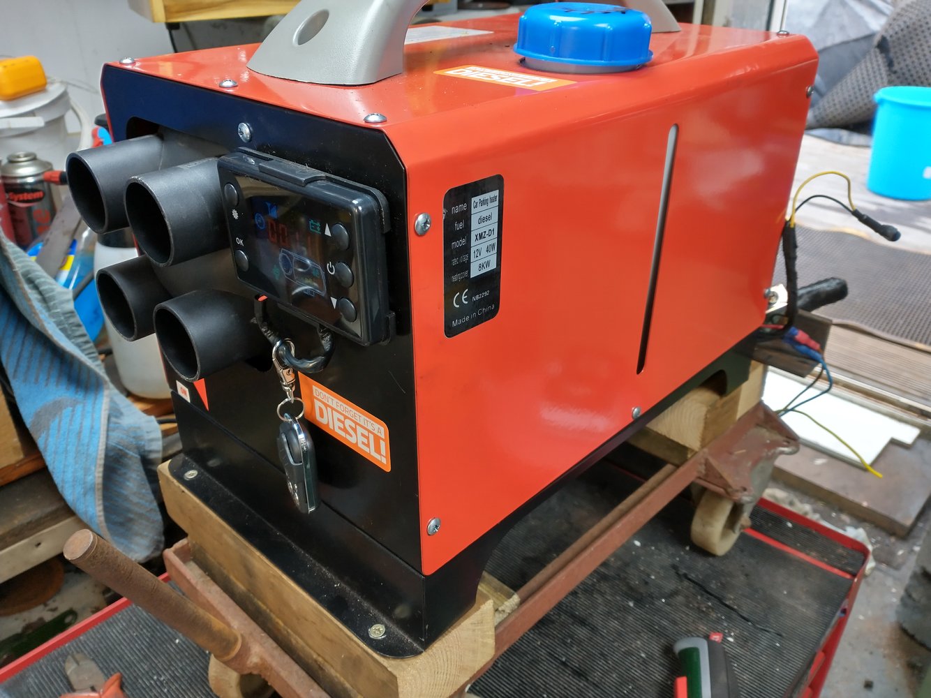

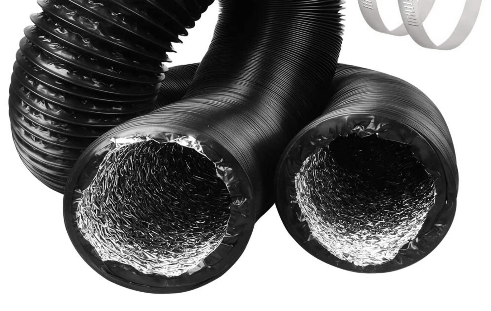

All the output ducts I've seen have been the corrugated aluminium type. I think the output can get quite hot so would depend on what the tumble drier hose can cope with.Having bought @skotl‘s other heater and now fitted it in my conservatory, I have a wee question. Is there any reason I cannot use a tumble drier insulated vent hose as my heat output hose.
The reason being, the heater is mounted quite high up to keep it next to the exhaust exit point in the conservatory, and I’d like to extend the heat ducting down to floor level, where it should be more effective.
I've measured mine at 110C which seems a little hot for plasticHaving bought @skotl‘s other heater and now fitted it in my conservatory, I have a wee question. Is there any reason I cannot use a tumble drier insulated vent hose as my heat output hose.
I wouldn't risk it. You will lose loads of heat unless it's in the same room anyway?All the output ducts I've seen have been the corrugated aluminium type. I think the output can get quite hot so would depend on what the tumble drier hose can cope with.

It’s not the exhaust pipe, that’s happily vented outside, but the heating vent pipe I want to extend. Being fairly short, is great for heating my head, but carp for cold feet.All the output ducts I've seen have been the corrugated aluminium type. I think the output can get quite hot so would depend on what the tumble drier hose can cope with.
Yes I understand that. My heater came with thin corrugated aluminium ducting for routing the hot air.It’s not the exhaust pipe, that’s happily vented outside, but the heating vent pipe I want to extend. Being fairly short, is great for heating my head, but carp for cold feet.
Apologies, must have misread your post.Yes I understand that. My heater came with thin corrugated aluminium ducting for routing the hot air.
Like this
42 Mm / 1.65 Inch For 2KW Diesel Heater Ducts Pipe Hot A/C Conditioner Ducting | eBay
Find many great new & used options and get the best deals for 42 Mm / 1.65 Inch For 2KW Diesel Heater Ducts Pipe Hot A/C Conditioner Ducting at the best online prices at eBay! Free delivery for many products!www.ebay.co.uk
Note this is the smaller diameter stuff - my heater has four small outlets.
That's okayApologies, must have misread your post.
The listing looks a bit more suitable. It has to be better than slotting 3-4 standard diesel heater ducting pieces together. My feet thank you.
