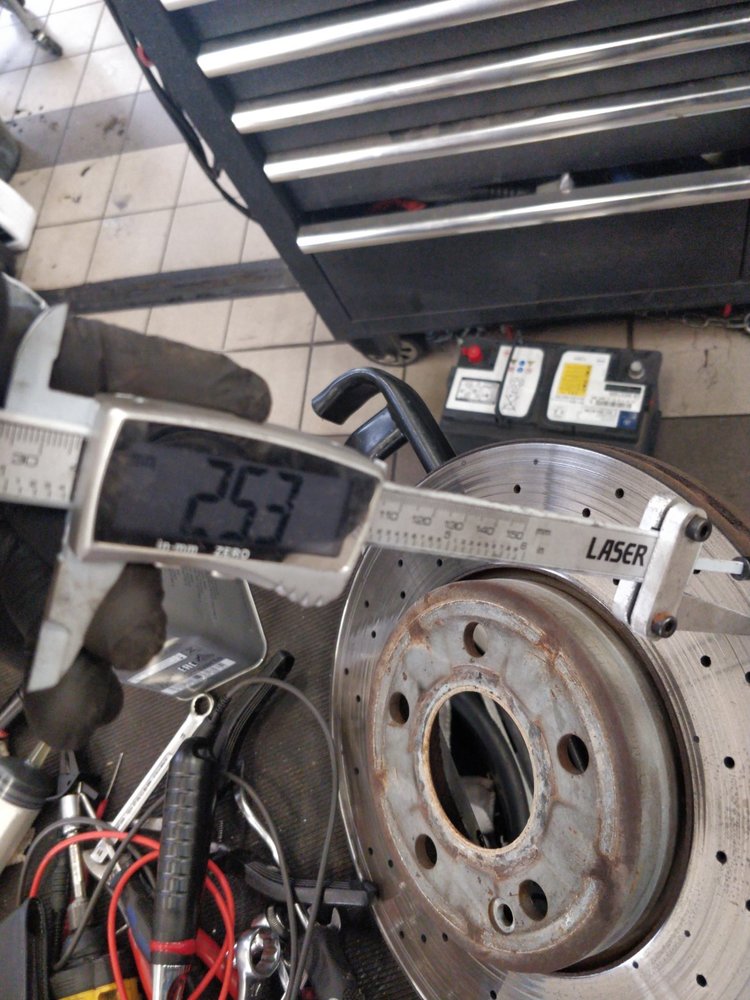

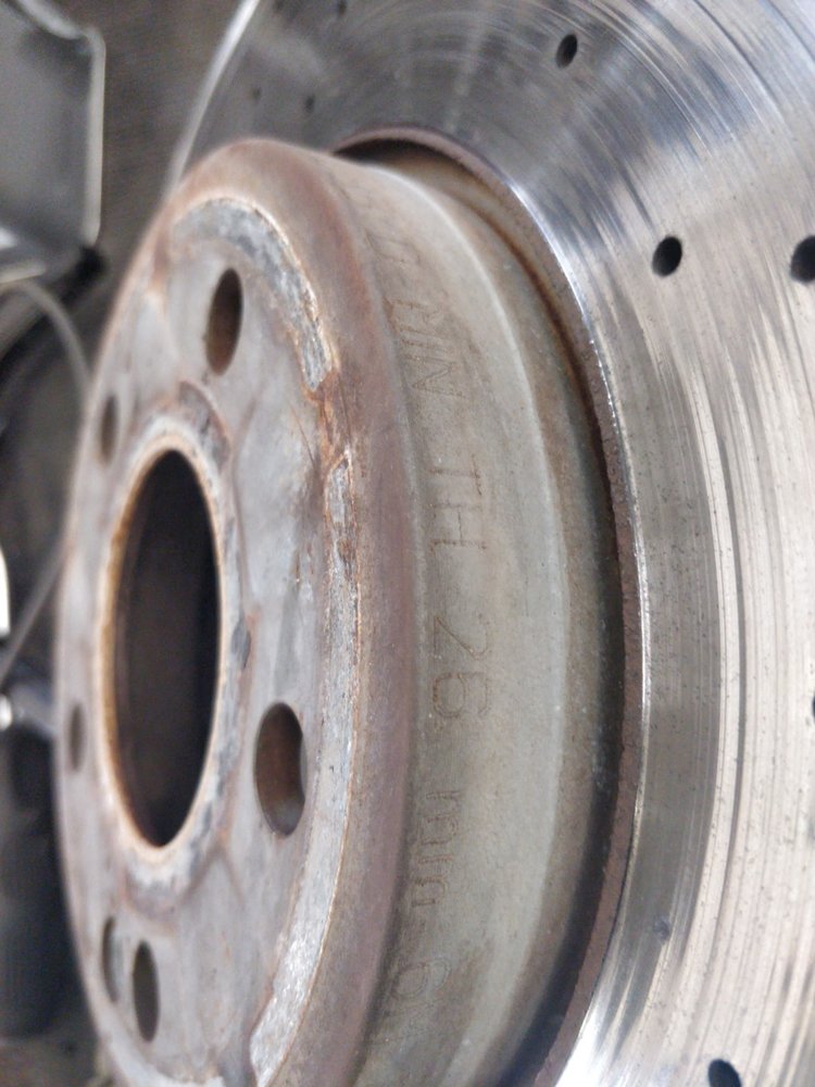

The runout I have on the discs are from 0.06 to 0.11 mm so within reasonable tolerance. Visually they all look fine - no gouging or uneven wear pattern.
However, I do have a thickness discrepancy of 0.06 mm on one disc. I'm not entirely convinced this could cause the significant juddering I experience while braking so I guess I'm going to have to investigate further...
