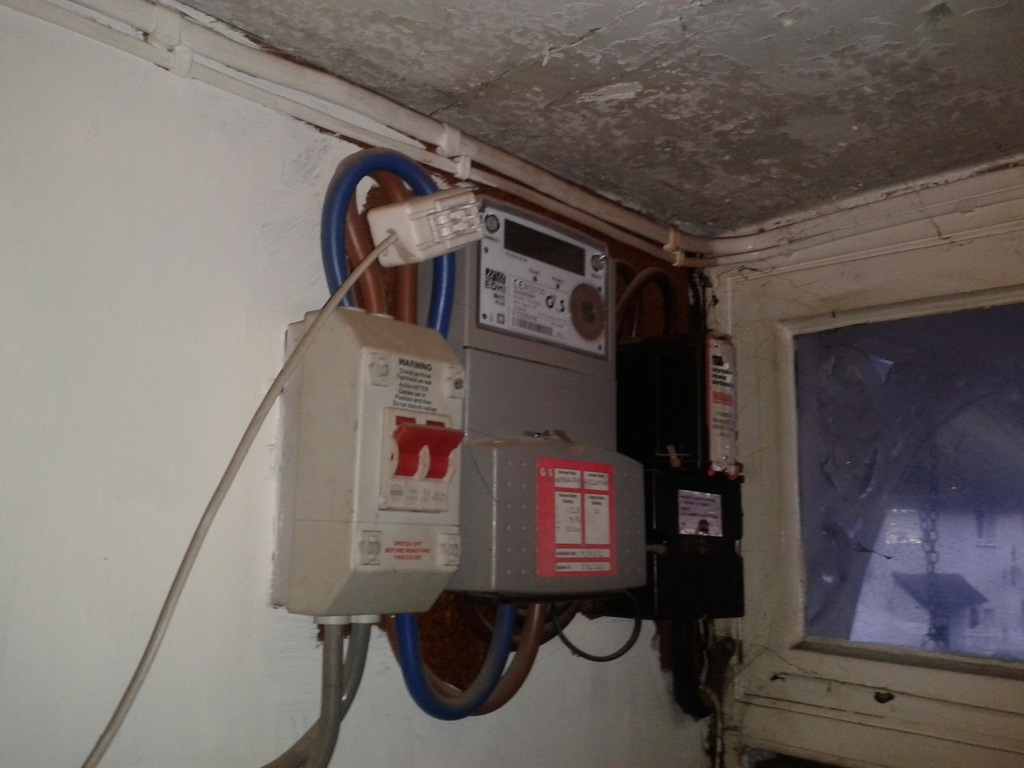

more info needed on the supply. have u a new db with a spare way in house to connect to and what are the earthling arrangements . tt overhead supply 2 wire no earth or underground and the electricity board supply the earth or pme
only the op can tell us the information. no point in speculating![]()
I'd cut the tails after the isolator, add another fused isolator and run the 16mm to the garage with its own consumer unit
That cutout could have any fuse from 60-100 amps inside

Thats the way to go but unless the workshop feed is either swa or in metallic conduit (or surface mounted along its entire length) To comply with current regs it still needs rcd protection.(no RCD to trip) and the 63A MCB is the feed to my garage's consumer unit.
