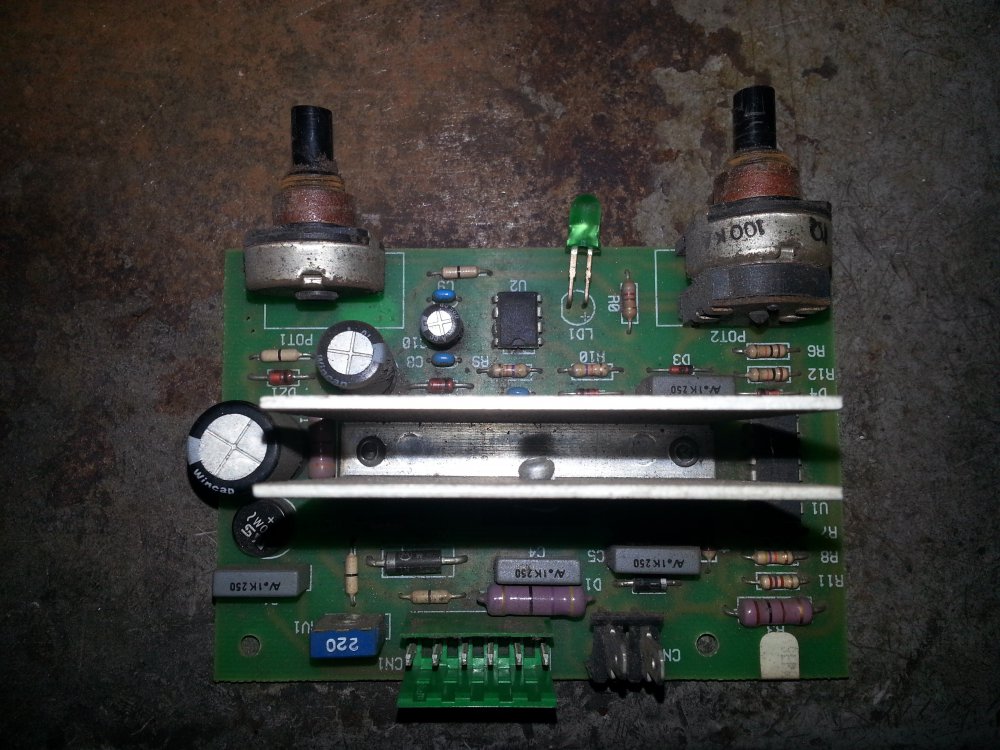

Here are the pics of the PCB. I hope it helps. Seems there is also some sign of trouble on the relay. See post below.Can you post a pic of underside of pcb (makes it easier to say where to meter).
Can you confirm the pcb has the number CSX E01 on the under side ?
Think you will find this is the diagram for machine

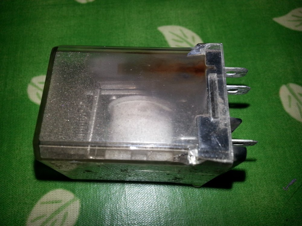

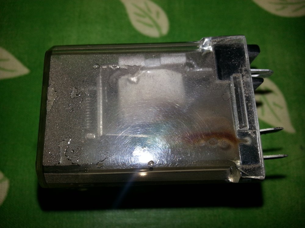

I have inserted some pics of the relay. Seems there might be some burn marks on the inside. See what you think. Is this relay a standard piece of kit? I know now that it isn't the original. Anyway can I test it off the machine?There should be a relay, the only question is whether the one there is original or a replacement.
If it works, it doesn't matter. If it's broken, it doesn't matter![]()
I did this the other day and didn't get anything. Can't remeber whether I was on AC or DC though as I was rushing. Dumb, I know! I forgot to add the the original post that the cooling fan spins merrily away.Or, connect your meter on dc to the torch tip and the ground clamp then pull the trigger - first check and you don't need to delve inside for it.
That makes sense. I wasn't sure if the other contacts were for other purposes or voltages! I will give it a go as soon as I can. Does it look burnt to you?Connect the relay back up put low voltage wires back on the coil and swap the other 2 wires to the spare contacts as they won't be burnt as they wasnt used
Yes it has scorched the case I've had them fail the same wayThat makes sense. I wasn't sure if the other contacts were for other purposes or voltages! I will give it a go as soon as I can. Does it look burnt to you?
I'll pop it back as soon as I can, which won't be today and get back to you with the results. Is it worth buying another even if it works?Yes it has scorched the case I've had them fail the same way
I would replace it with one that can handle at least 30 amps at 230vI'll pop it back as soon as I can, which won't be today and get back to you with the results. Is it worth buying another even if it works?
Fair enough! I like your style.If it works using another pair of n/o contacts then there's no point replacing it until it fails again - unless you need an excuse to spend the money?
That relay is originally made to plug into a socket, if you want reliability, replace itI would replace it with one that can handle at least 30 amps at 230v
Yeah I know max rating is 30 amp it would be better to go bigger to cope with the inrush currentThe one in there is rated for 30A @ 300v...
So what do you recommend? Happy to buy a new one, but I would like a make and serial number if poss? I have a very good electrical shop near me but don't mind going online.Just looked up the specs for it, you can't use the other pair of contacts unless you want the trigger to work as an off switch![]()
Fine, I will pop into the local lx shop on Monday. Thanks for that.Any relay with a 12v coil and minimum of 30A@230v switching will be fine.
Getting a bigger one would be fine - just don't go mad getting something massive or tge coil might overload the little transformer/pcb.
Good advice. I will try that first.Before you buy a new one, connect the wires together (as detailed before) to check the rest of the machine.
