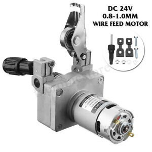

    AA549A60-DAEC-4F31-8AC1-E5E78A44C131.jpeg Well, the new wire drive has arrived. Seems very good quality and all for £24.99 inc post. Pity I actually finished welding the van today ! I’ll need to source a wheel for 0.6 wire, but it looks a very familiar type
    So looks like this’ll be another ‘round to it’ project. Perhaps someone else will bea me to it and I can follow what they did he he

    Note that these replacement wirefeed assemblies are metal, as opposed to the original plastic ones, and so they will have to be fully insulated from the metal case of the welder.

    They do come with insulating kit (Basically some plastic bits) and fixing bolts as photo, also they use these
    https://www.ebay.co.uk/itm/MIG-Weld...-Wheel-0-6-0-8-Kit-30mm-030-035-/273777278965
    Or you can save money n buy from China for £2-40.
    They are fixed from the base so you’ll need to cut a 50mm hole for the motor to poke through and 85mm deep the other side. Bit of 25mm angle should do to fit it.
    The unit is 140mm high by 80mm wide and 55mm deep when fitted, but you’ll need to leave a gap between the unit and the welder or insulate it. Also the wire feed is 35mm from the rear of the unit.
    Hope that’s useful.

    Still not fitted the drive motor, but it does look smart on the shelf !
    Anyway, been more successful with the welder since I discovered that the bloody screw holding the wire spool on kept tightening up. I clamped the screw head with a spring clamp and it has welded much better since. I’ve also moved from Co2 to Argon mix. I’m still getting used to the new gas but at least it does work better now
