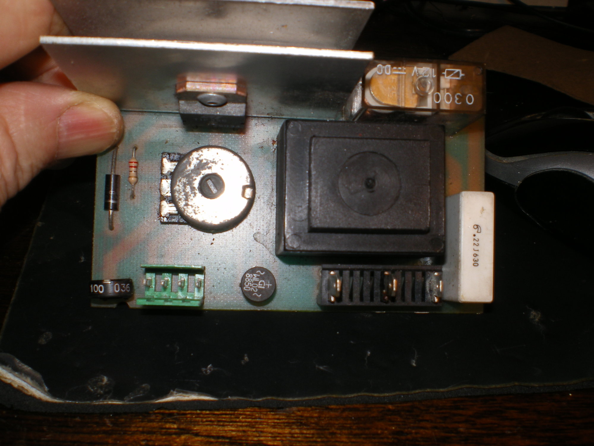

I've just done a conversion on a SIP Migmate 130 and have not used the board so it is going spare. In all honesty I didn't even check if the board worked before I dismantled the SIP but I imagine it would be OK as the machine's push button switch bank was the problem. Eddie will know if it's suitable for your welder but it certainly looks the same from memory (it's out in my shed at the moment but I'll check tomorrow). If you need it just let me know and I'll send it to you. Don't want anything for it but it may do you a turn.

Great thanks Eddie...John has been so kind and offered me his old pcb do you know if it would that fit my machine.? Thanks KevYes, on the underside of the board, at the transformer, the left is 12v AC out and the right is 240v AC in.
Before the 12v AC goes to the relay, it first goes up and to the right. One track goes to the green plug & socket, off to the trigger switch in the torch, then back to where there are 4 pins in a diamond pattern. That is the rectifier - AC in, 12v DC out. On the component side of the board the rectifier is a black circular plastic tub. The two 12v output tracks from the rectifier go to the coil of the relay.
Right so have just ohms tested it and I have O.L on meter so no readingNot sure ... yours is an Autoplus and John's is a Migmate...SIP have often "upgraded" their PCBs and changed the layout even in the same model.
This shows a Migmate, and the board looks the same as yours:
https://www.mig-welding.co.uk/sip-wirefeed.htm ( click on the internal photo to enlarge it )
but the blue wires are not quite the same... but probably would work OK.

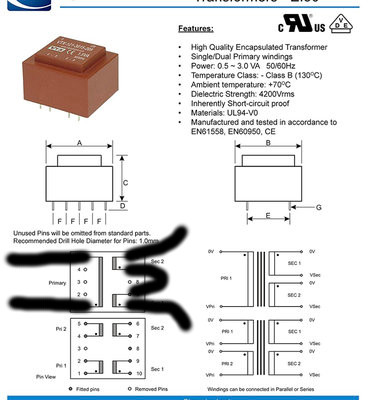

That means the primary of the small transformer is blown - open circuit, which often happens. Typical replacement:Right so have just ohms tested it and I have O.L on meter so no reading
Do you know if there is one on Amazon Eddie?As far as I can tell, the two boards are functionally the same, so a straight swap will solve the problem !
https://www.ebay.co.uk/itm/0-12V-2-Output-Through-Hole-PCB-Transformer-2-25VA/124297145609
The pin spacing may not match yours exactly, may have to use short wires to connect it to the tracks.
Not sure what I type in to search for the right transformerI replaced a failed one 'off board', recently, with fly leads.
Salvaged from a dead battery charger.. but I then proceeded to blow that one (due to another serious fault)!
These transformers are 'easy' to test safely, resistance-wise, which has direct correlation to the 240 to 12 step down.
So if it doesn’t fit on the pcb do I just run wire from old holes to this transformer? When you say in series do you mean join the two secondary pins on one side together then add wire from that to old hole in pcb and do the same for the other end (same side ) secondary pins ?The search term could be "encapsulated transformer", such as
https://www.amazon.co.uk/Vigortroni...ncapsulated+transformer&qid=1611185423&sr=8-1
That one has two outputs, 2 x 6 volts, you would join the two secondaries in series to get 12 volts.
