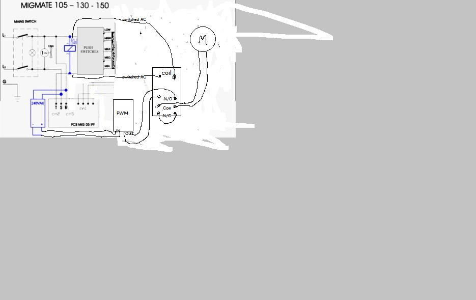

I have the two 8 pin relays one is 12vdc and one is 240V how would I wire the 8 contact on each one ?The two connections at one end will be for the coil. A circuit passes current through this coil, and the magnetic field generated by that attracts the metal lever - the armature - which operates the contacts. The coil can be wound for 12v DC, or 24v DC, or for 240v AC mains.
The small transformer on the PCB produces about 12v AC on the secondary, and this goes through a diode to run the 12v DC coil of the on-board relay. So the replacement relay, on-board or off-board, will need to have a 12v DC coil.
The other end of the existing relay on your board may have 4 pins, because it has two sets of On/Off contacts, but only two of them will be used and connected to printed tracks. Maybe the two sets are wired in parallel, to share the current across two pairs of contacts so they don't burn so much.

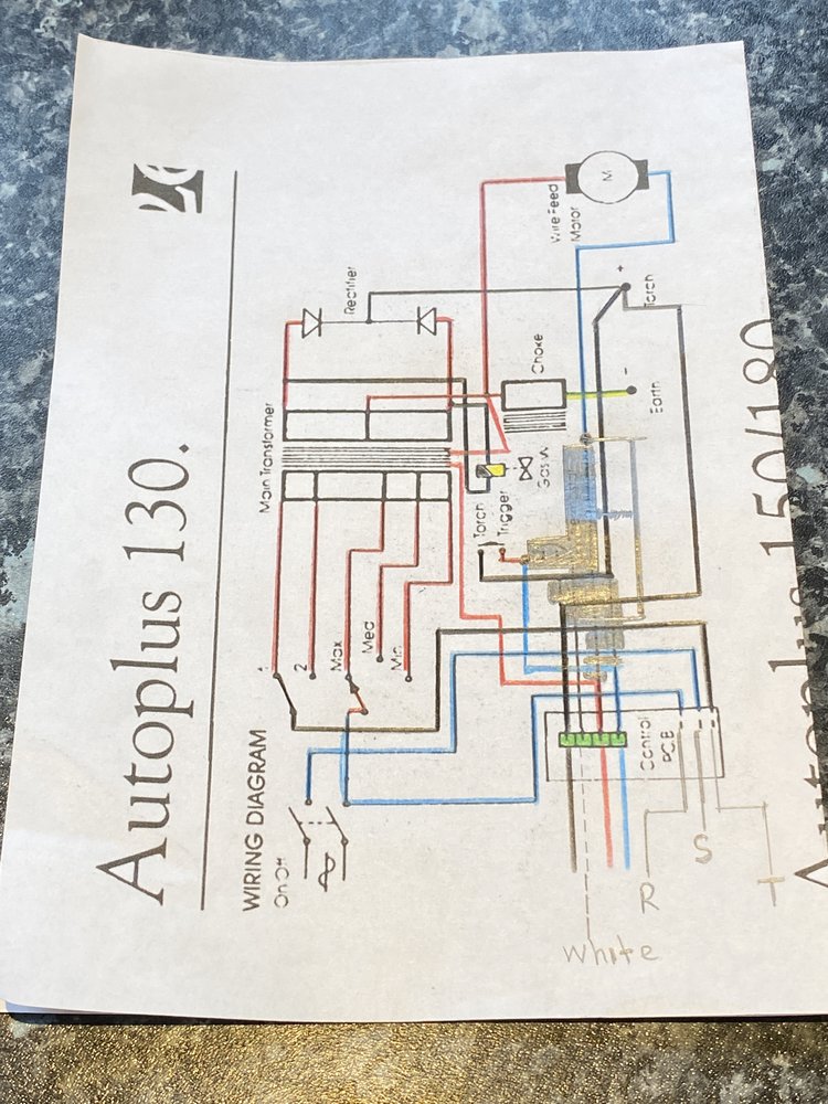

The circuit diagram linked in post #4 shows that the relay on the PCB just opens/closes one of the mains wires going on to the main transformer ( via the 1/2 switch ). That is shown as the bottom 2 pins entering the PCB. So only one set of on/off contacts is needed.

You would need to select one relay: 8 pins, with base, 12v DC coil - to replace the on-board relay, and also ( if you decide to go ahead with the wirefeed power modification ) one relay, 8 pins, 240v coil.
