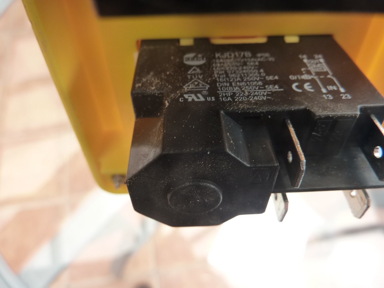

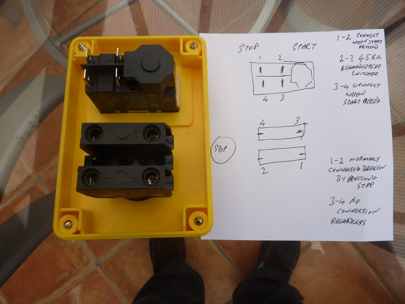

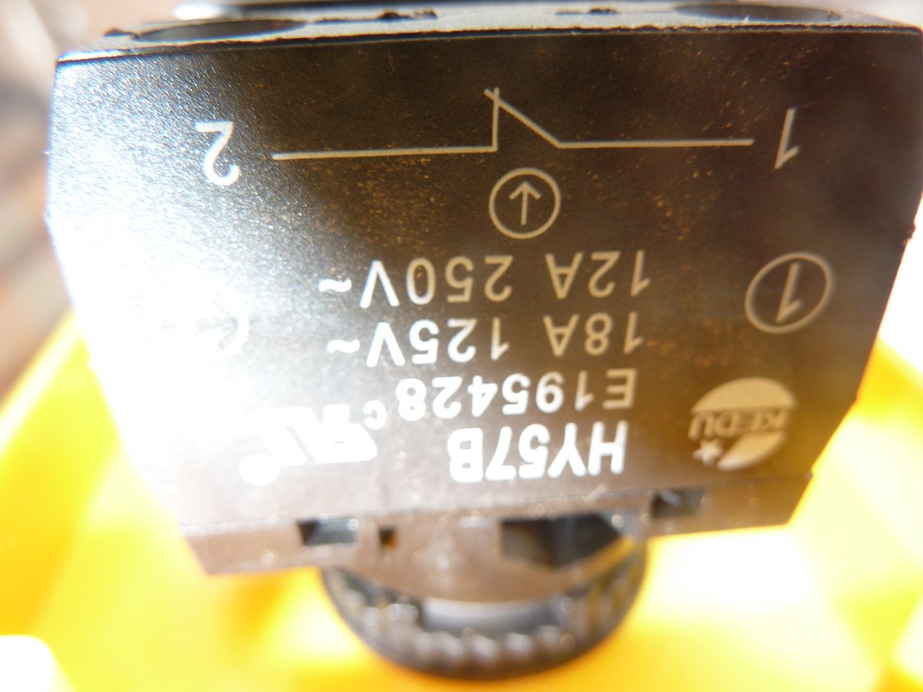

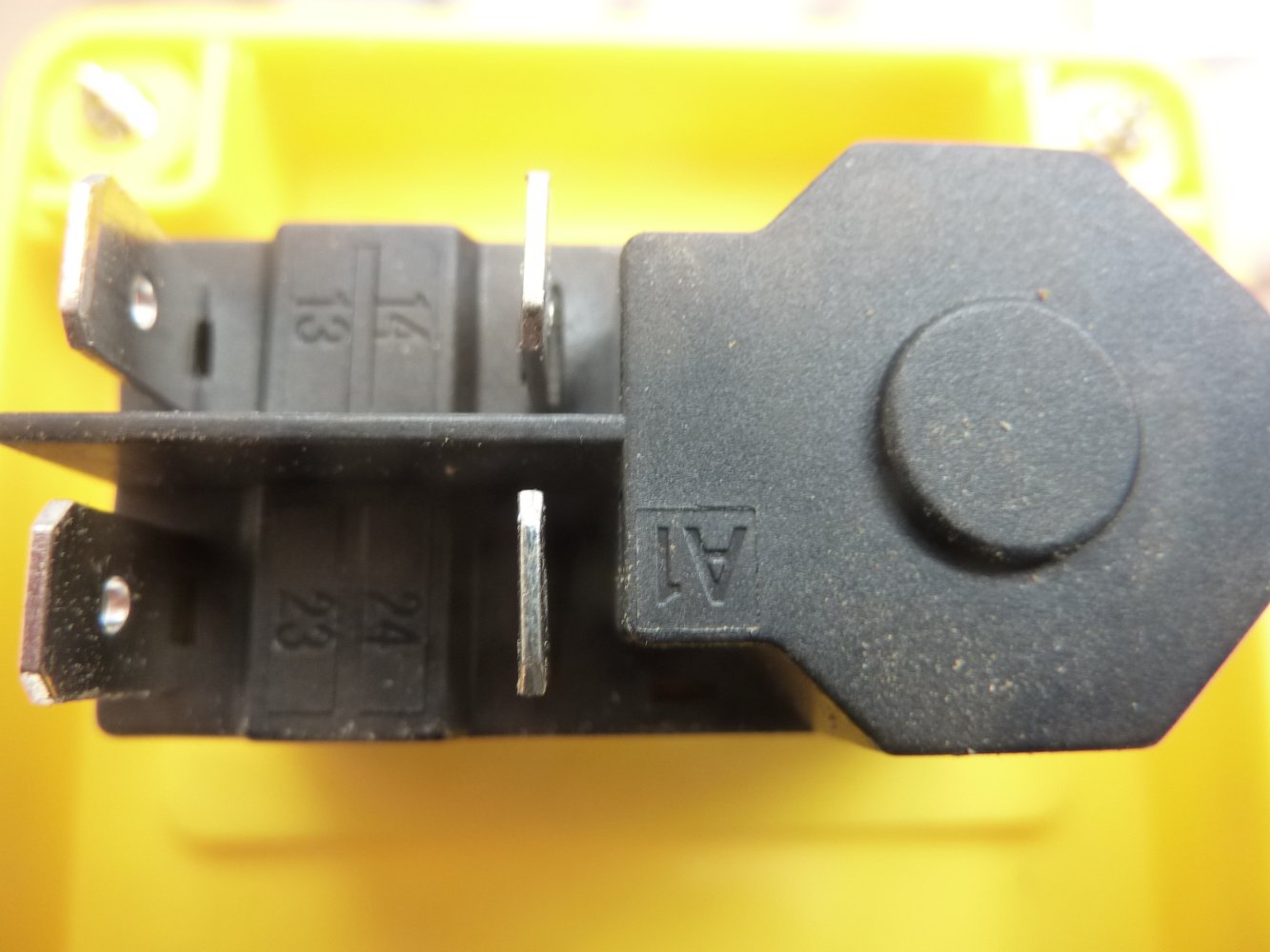

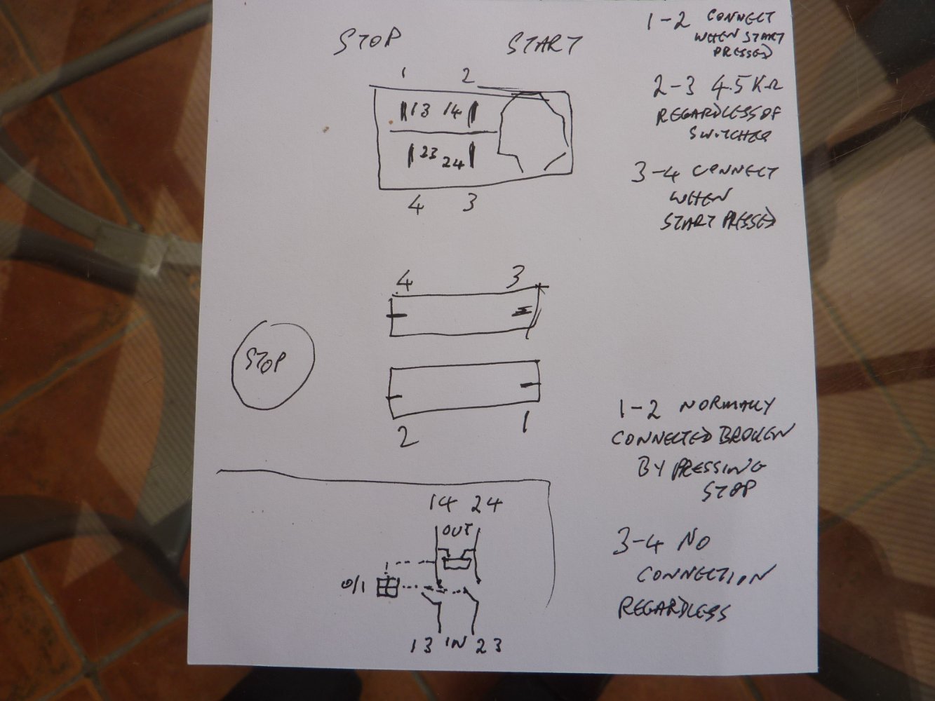

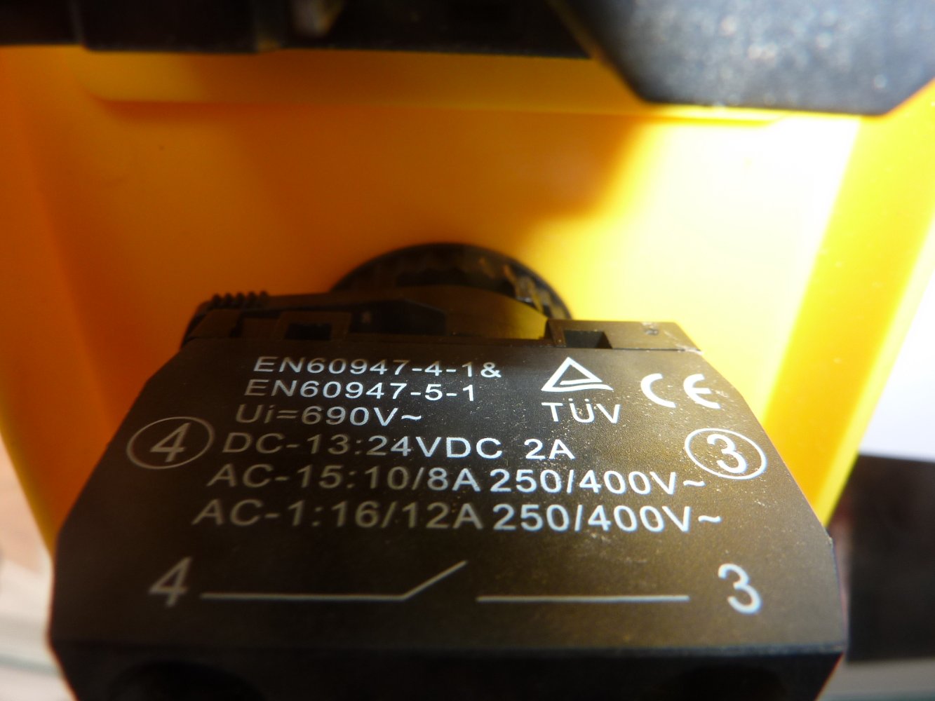

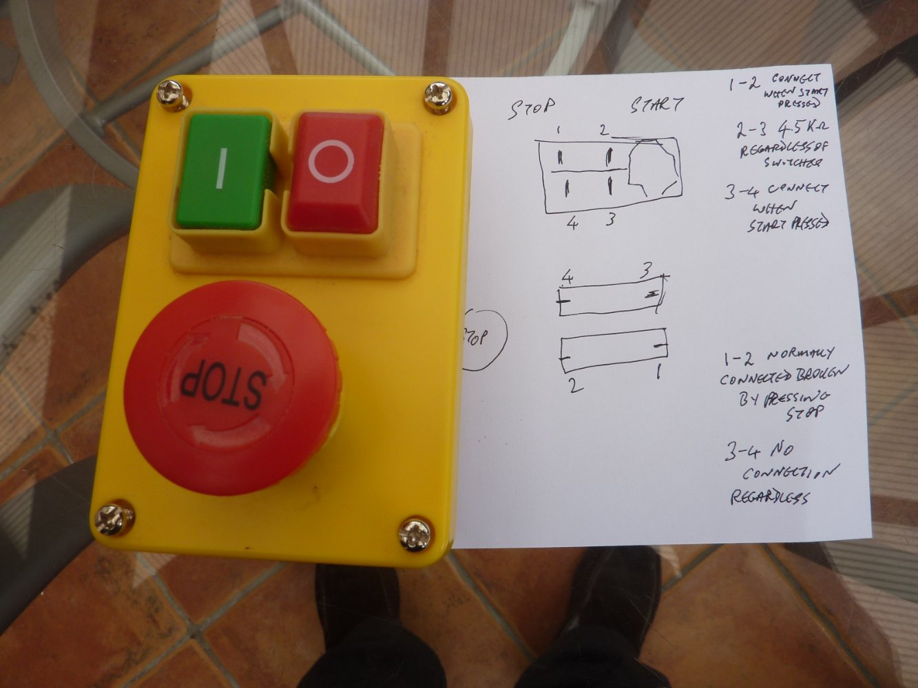

Quite some time ago I bought a NVR switch and am only just thinking of fitting it to a "temporary" set-up I've been using for 40 years... There are no wiring instructions and 8 terminals! I think the mains lead in should go to terminals 13 & 23 ( I've marked 1 & 4), and feed to motor should be from 14 & 24 ( I've marked 2 & 3), but am not sure where the connections to the emergency stop should be. 3 & 4 on the emergency stop don't seem to do anything, so am guessing 1 & 2 need to be wired in - but where?
