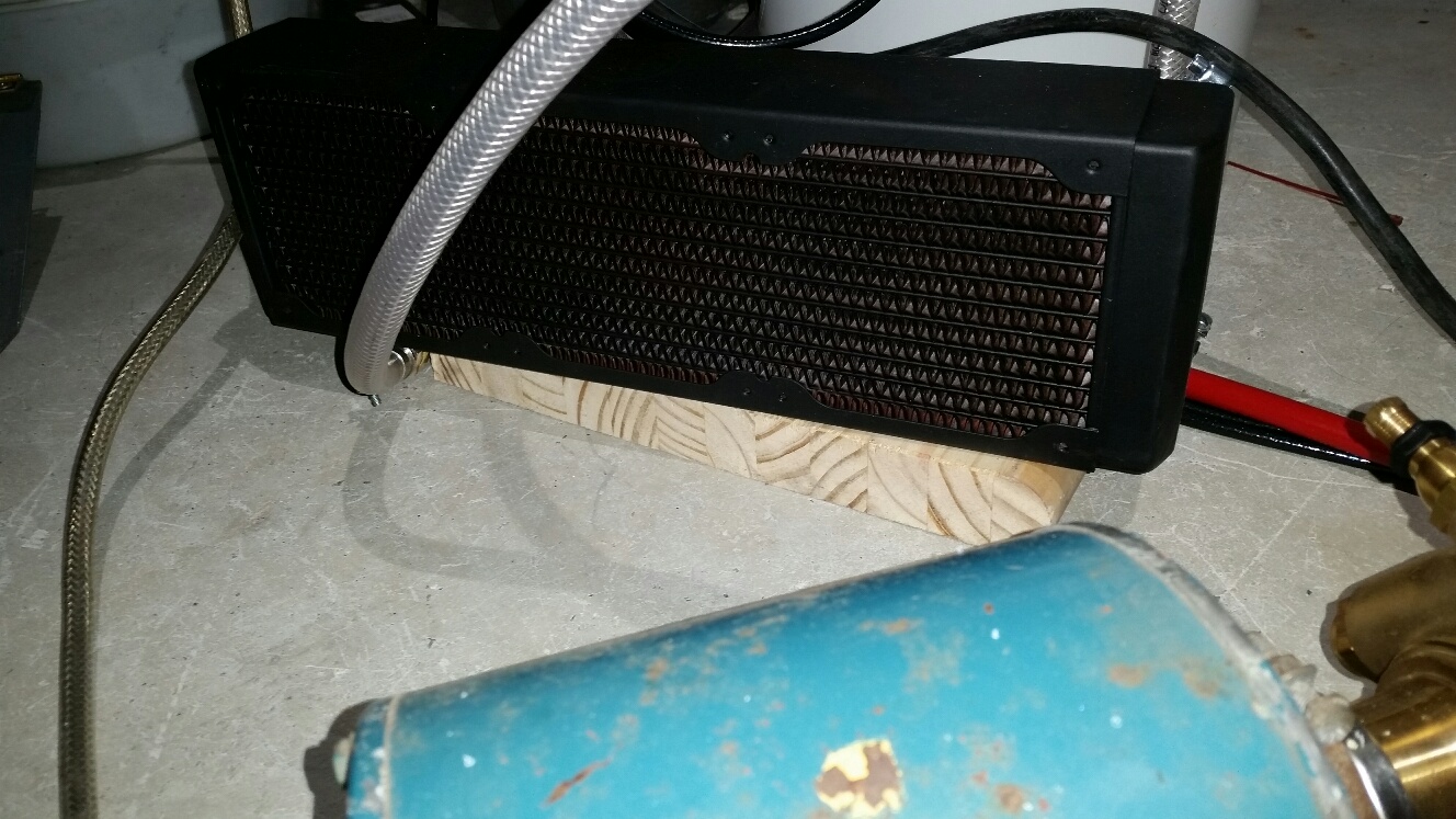

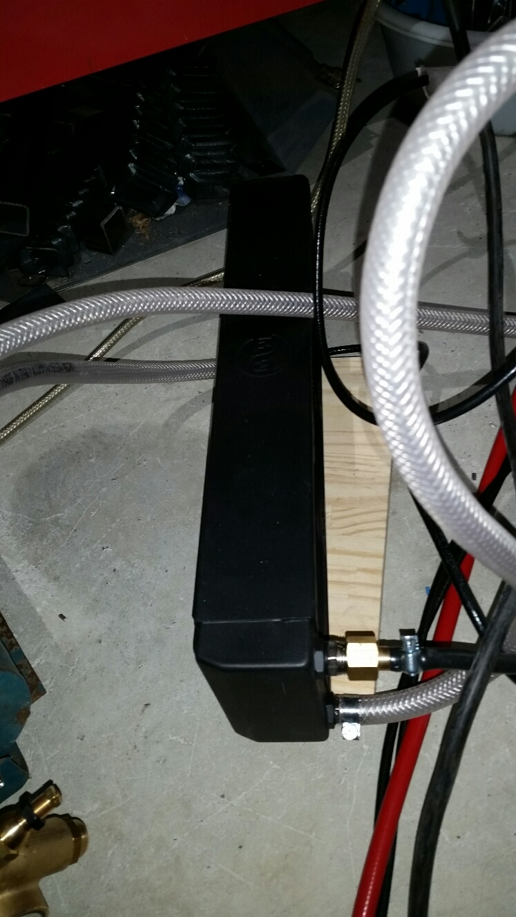

What's your heat exchanger Daz.
Have you thought about making your own. I've experimented with it and had some sucsess with some.
My general thoughts are the pump type causes more heating issues of the coolant than the welding.
Procons been the worst of all. The motor is designed to get to 70°+.
I made this one a while back which is a design that works really really well. I spaced the gaps in the tubes by a couple mm each to allow air flow right between them and take heat straight off the tubes
It's also 4mtrs long in total so it holds a fair amount of water infront of the fan.
Computer rads are ok but just don't hold much volume. Your motor is gonna get hot and you need to keep that heat away from everything containing water.
Last one I made was a procon and I boxed it up. Needed 3 powerful fans in there taking the heat out to work.
360mm. Wow that's gonna be a big cooler. Should be plenty mind with 3 fans. Yes the auto stop will help. Just ensure you have at least 1 minute of after run time from welding stop to properly cool the torch.That looks interesting.
I have a 360mm pc fan, planning to have 3 fans on the rad blowing out the side and one blowing in from the back.

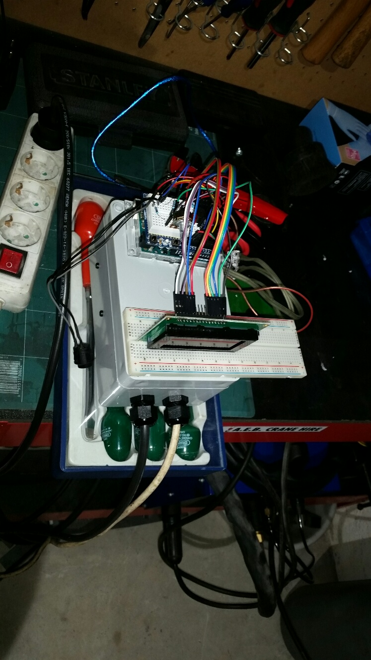

So far the auto start has worked perfectly so i'm hoping less running of the motor = less heat, as the fit-up takes me ages the pump would be running for hours.
