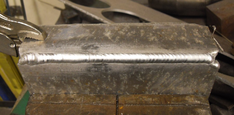

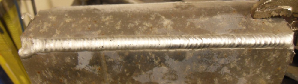

Found out my issue with the tank the last day, when I was doing some welding earlier I discovered the cleaning was set way low, not sure why but must have inadvertently done it at some point. So when I discovered that I decided to cut a couple of bits of the exact same material the tank was made with.
First test I never cleaned at all, straight off the plasma.
Some contamination but certainly less than on the tank.
Next I wire brushed like I did with the tank and result was pretty good, well excepting the crap tacks in both tests
Probably never would have bothered even wondering the last day until you scolded meJust thought it was the nature of the beast with corroded Alu that you would get some contamination.
BTW Dazza, sorry for hijacking your post a wee bit.
Personally I'd always clean up a plaz cut edge as the dross can cause issues but that doesn't take away the fact your Alu tig welding on those outside corners looks very neat.
Hell knowing what you can do with it I'd suggest you throw that tank away and do it like that.
