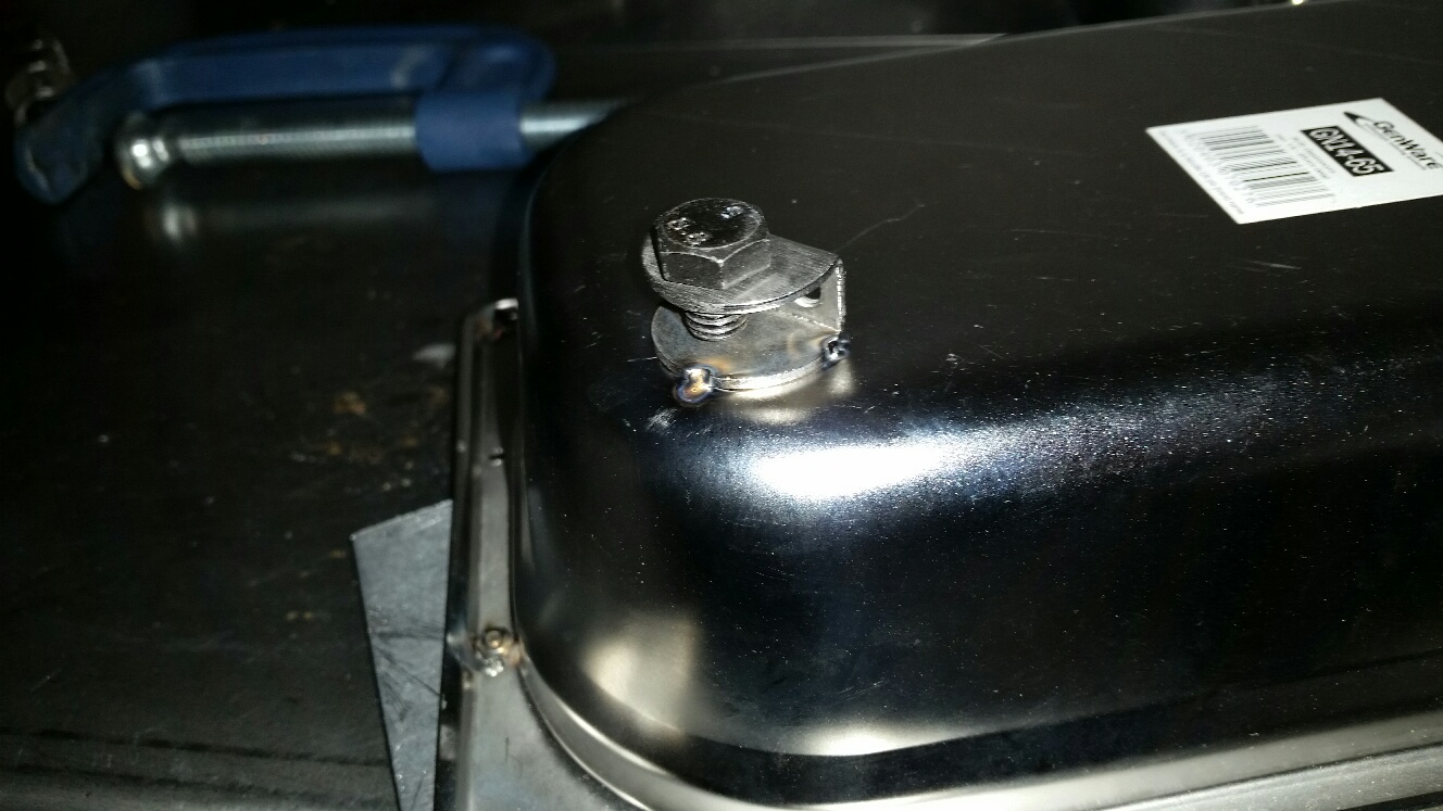

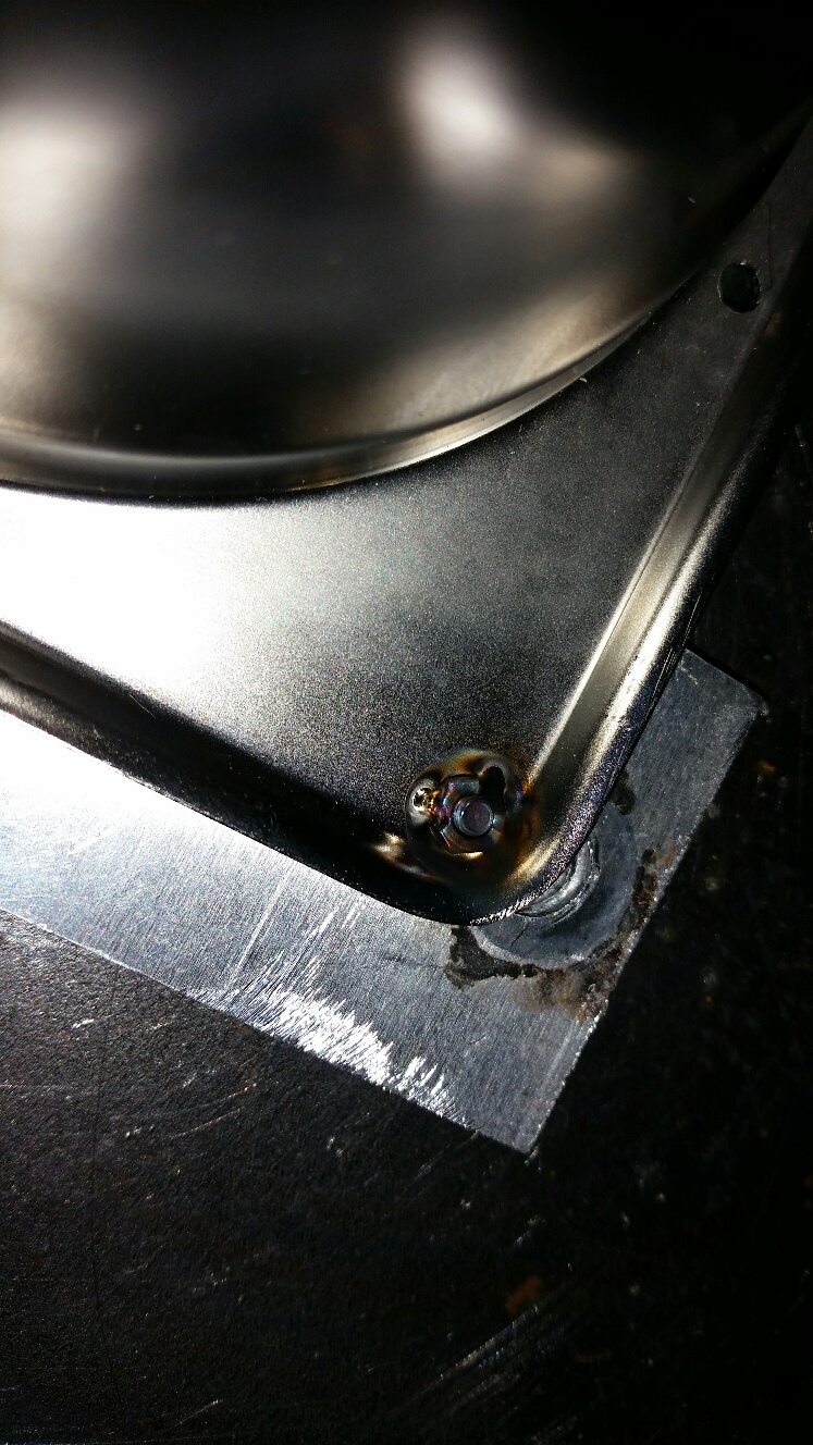

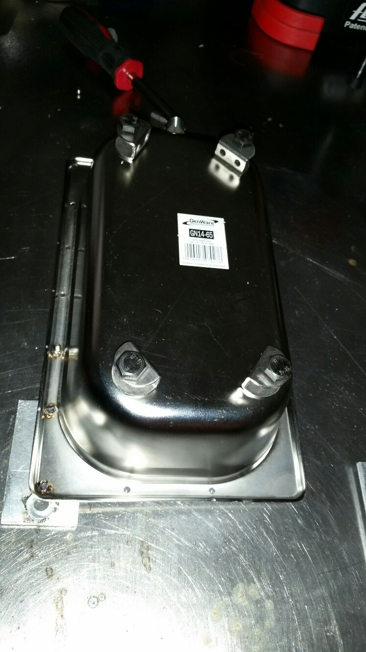

Will get the place i buy the metal from to fold it for me. And build a folder another day.nicely with a tight radius? I think you will struggle.
Do it another way mate.Any tips for welding these on?
First tack went perfect the rest not so much. 50amps too much??Jeeze dazza what you done to that?
It only wanted a little tack. Direct the heat on the nut and wash it down.
I was thinking about 3/4 tacks. Whats the worst that can happen. I'd just have to start over.Do it another way mate.
No not too much if you focus your heat in the right place, keep things sharp and tight.First tack went perfect the rest not so much. 50amps too much??![]()
. The recessed lip does not help i cannot get in there.
Why can't you get in there.
Looooooooooooooads of room from what I can see. Stick more electrode out.
Thanks eschen going to make a fresh start tomorrow.Have a break Daz. Grab a brew, relax and tackle it tomorrow on a fresh tank of fuel. If you're not in the headspace for it then have a wee break. You're cocking up something you've demonstrably shown you can do better so it's just a mind issue![]()
It would have been handy to have captive nuts but its not essential, i'm not going to do any more welding on the tank as i don't feel like starting over.Do those nuts really need to be captive, if they do then a hank nut would be a better solution, as handy a process as it is, welding is not the answer to everything.

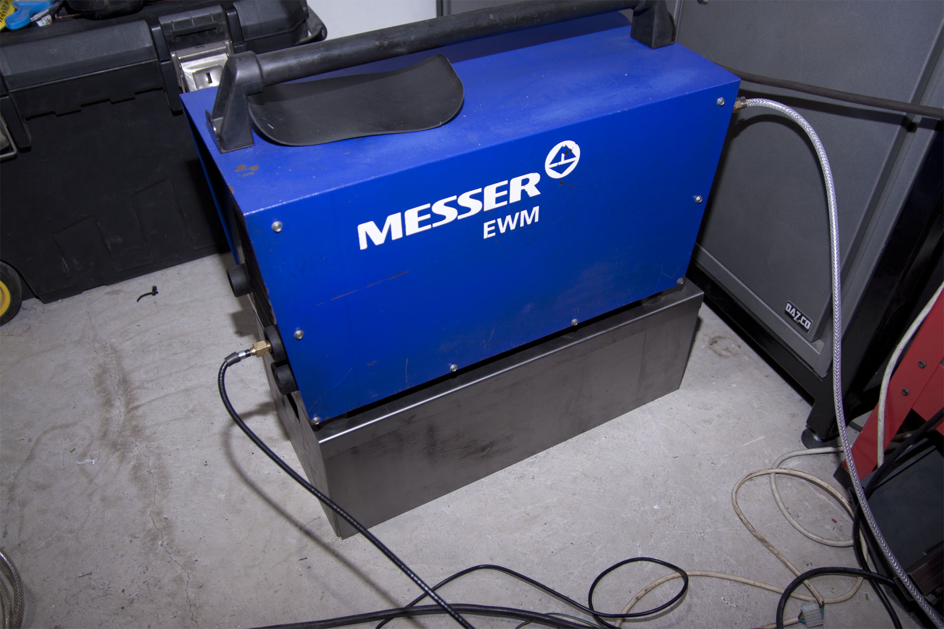

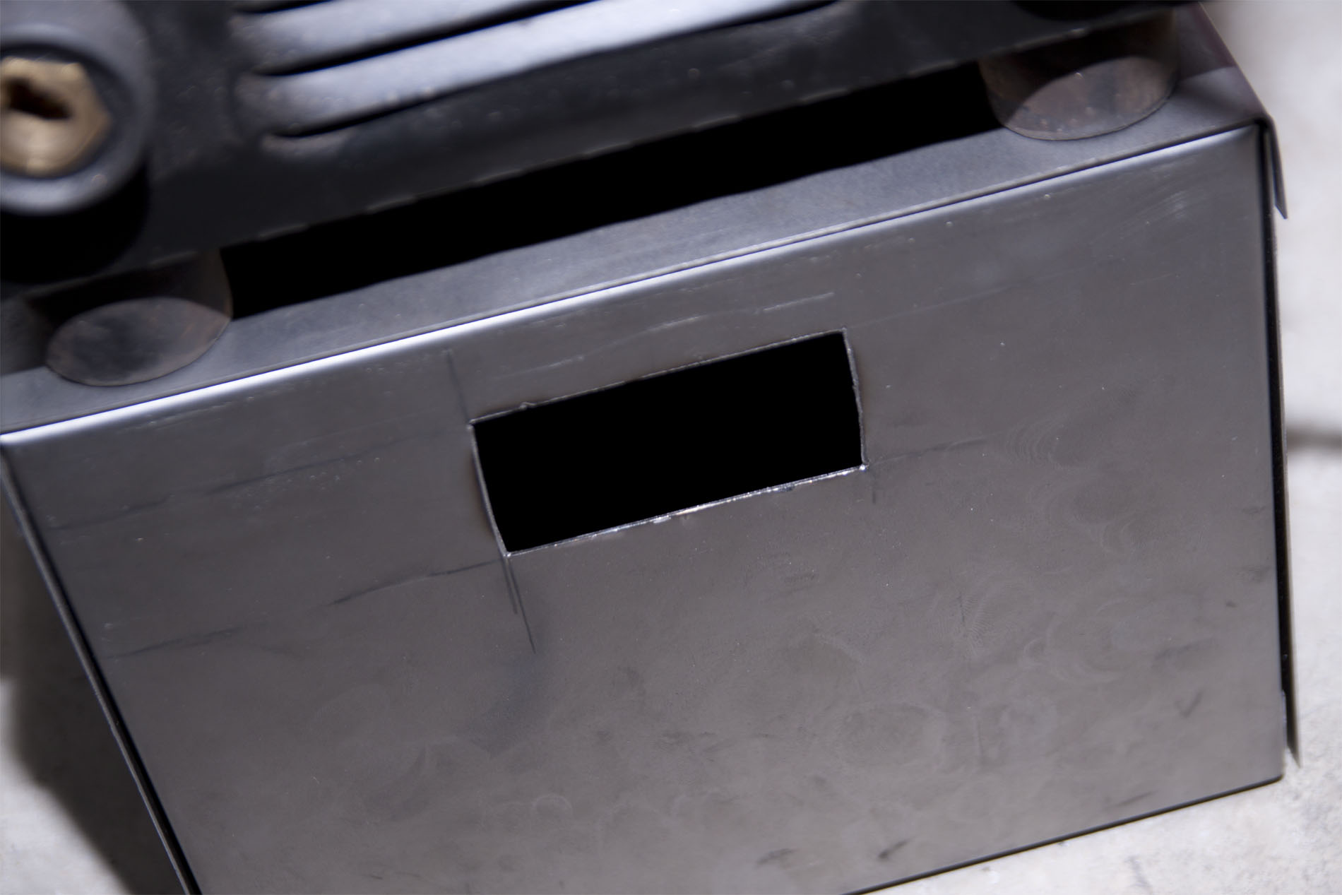

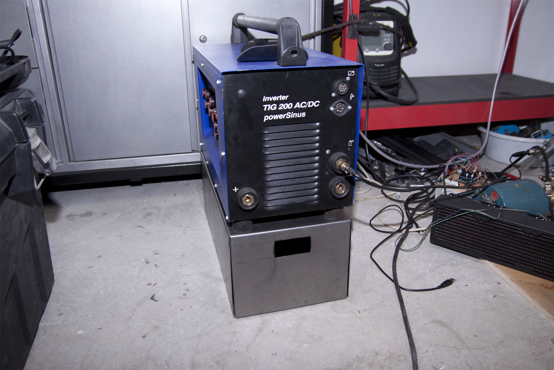

Working well though as far as keeping the torch cool and the fan is keeping the motor cool as well. Today I was welding for maybe 3 or 4 hours at about 130amps doing some stainless and the torch was stone cold
Not so good about the interference
I have not had a chance to even get started on the Mk2 cooler. Using the original one with the procon stuffed inside and sitting on a cardboard boxWorking well though as far as keeping the torch cool and the fan is keeping the motor cool as well. Today I was welding for maybe 3 or 4 hours at about 130amps doing some stainless and the torch was stone cold
The biggest thing I have noticed with the water cooled torch is the collets don't get distorted, slacken the back cap and the tungsten will slide right out under its own weight, with the WP26 the collets distorted and often you had to remove the back cap to push out the tungsten.
