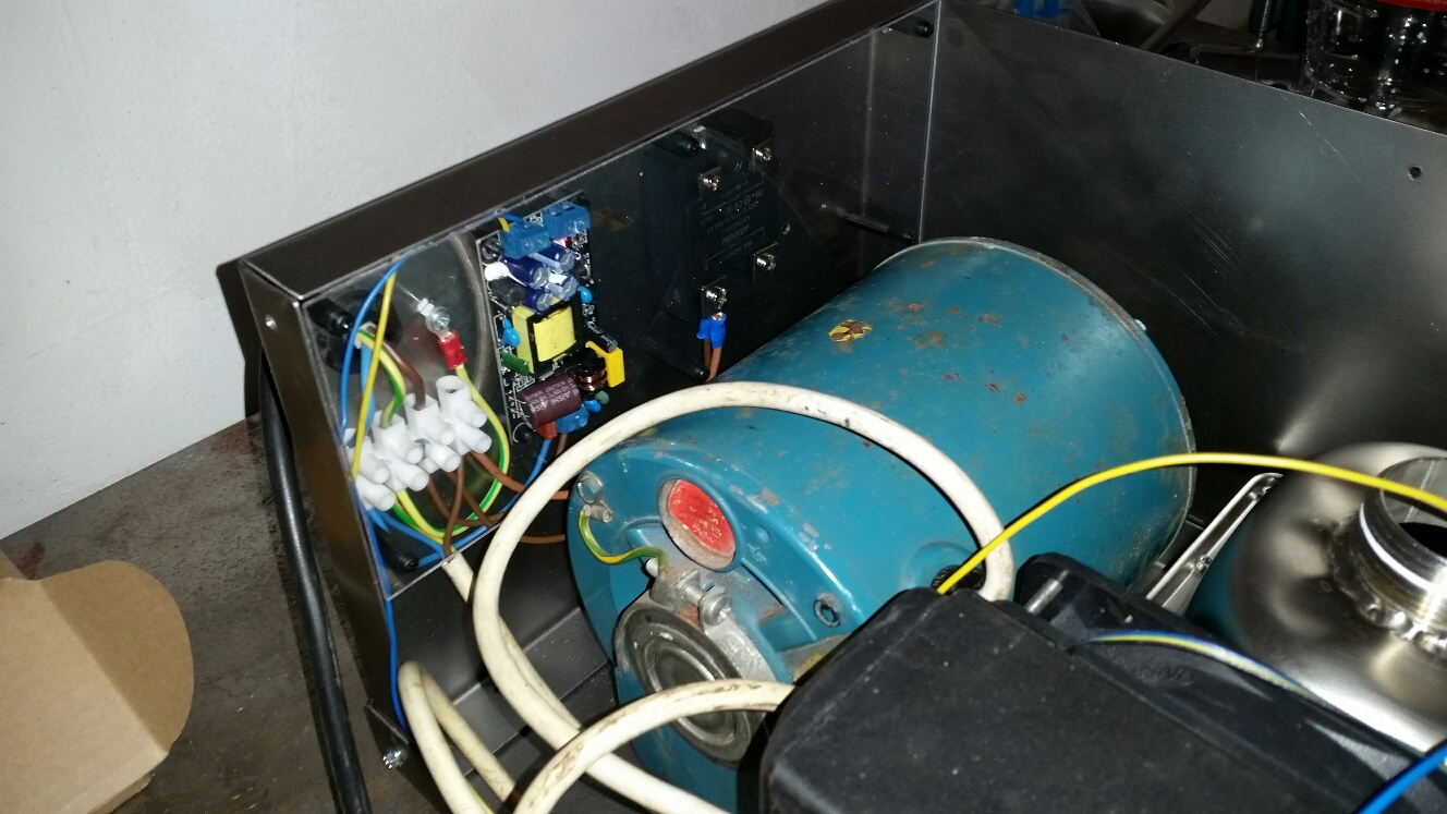

Had enough now wired everything up and none of the sensors are working maybe i cooked them also. feel bad for spending time working on this when i have so many other jobs to do.

Looks neat daz
The only thing I'd do as a change would be either change those copper pipes for hose or put some sort of cover over them. They look a bit vulnerable there but very smart.
Rather like the pipes, polish them . And protect by making your trolley slightly eider
Both?The trolley should be nice and wide as i want to get both gas bottles on there.
I bought small flexible mounts for mine although the one I am using at the moment is from the cooler I bought from Richard and it is noisy as I mounted it direct onto the alu base plate. One day I will get round to fitting rubber mounts to it as wellDo you guys put any rubber under the motor? The other worry about the pipes is the vibration we will see.
