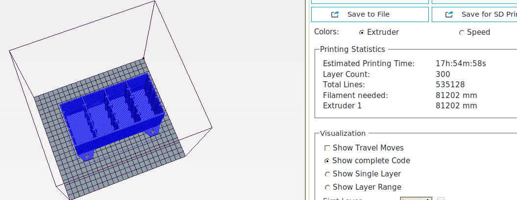

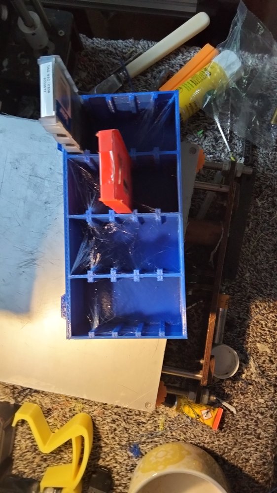

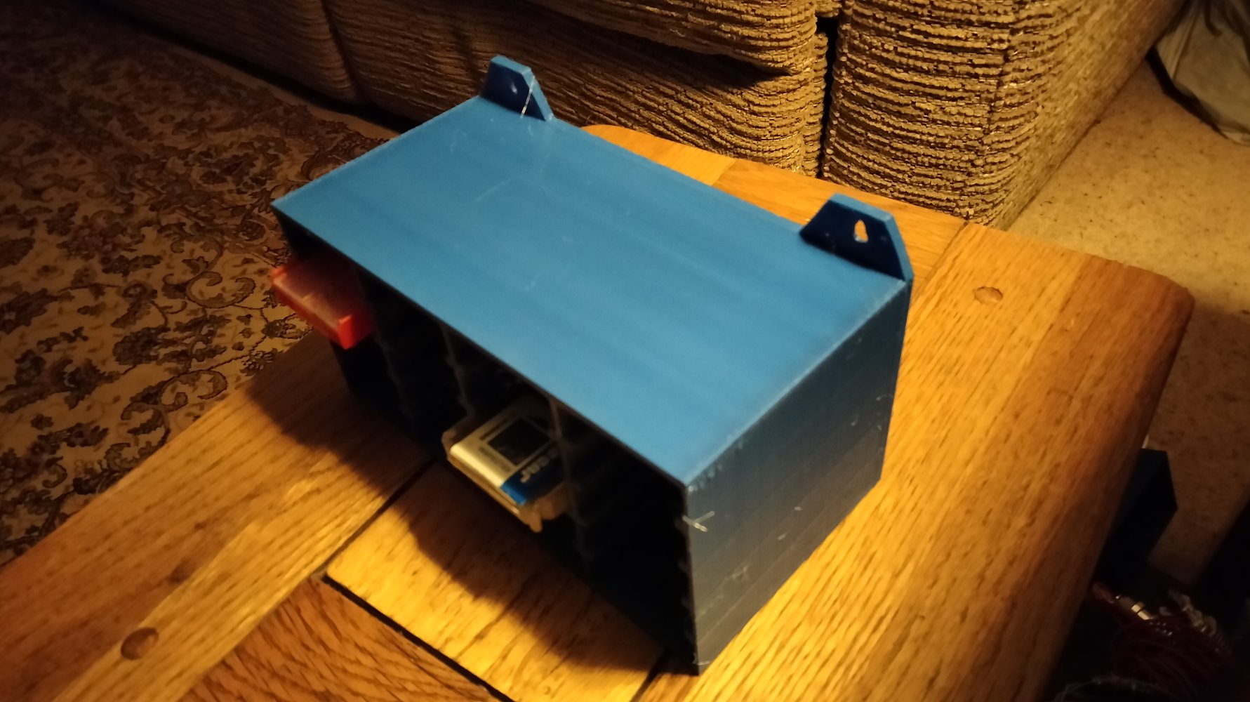

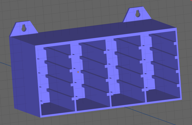

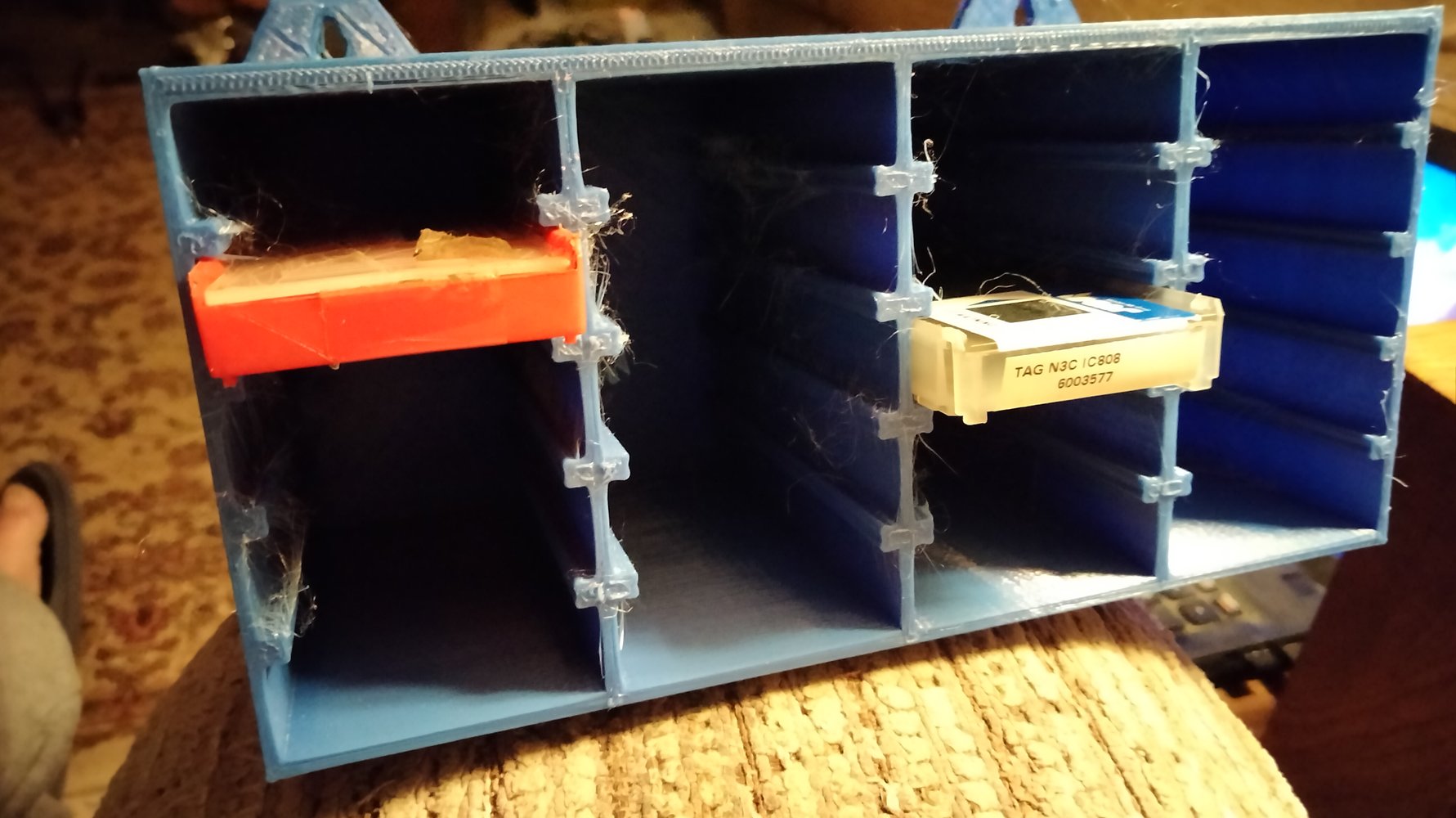

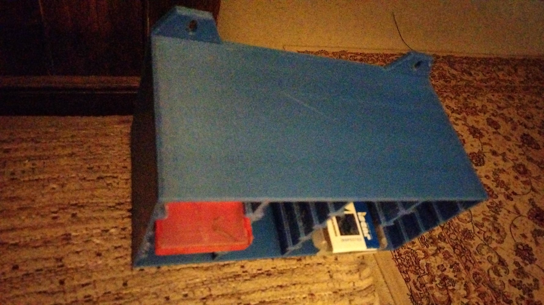

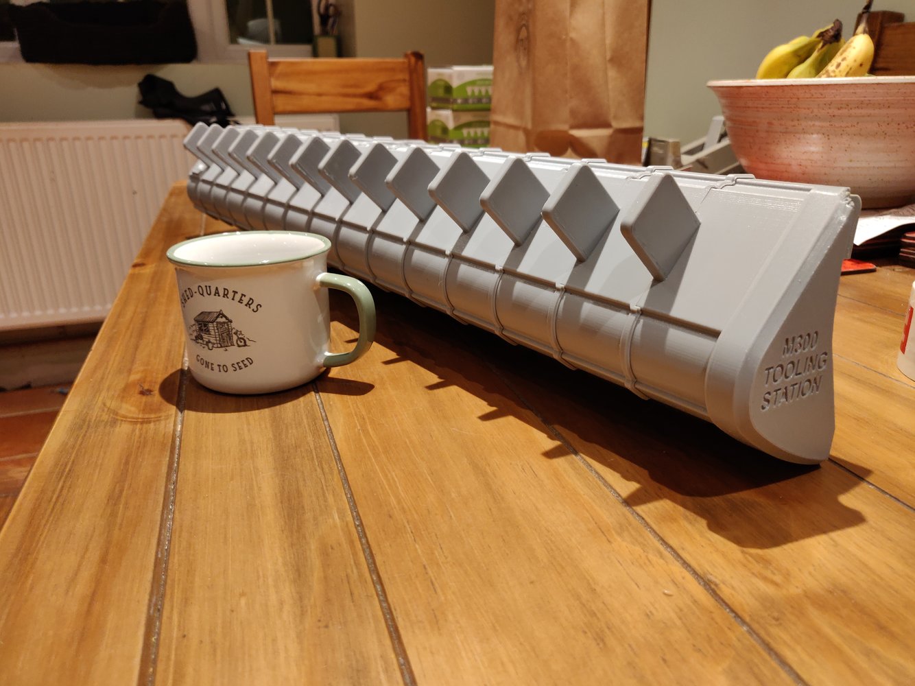

I think just under 2kg of PETG in the 14 position rack including end caps.

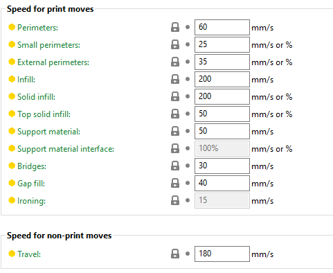

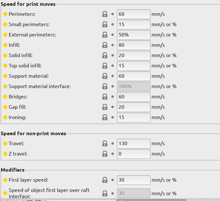

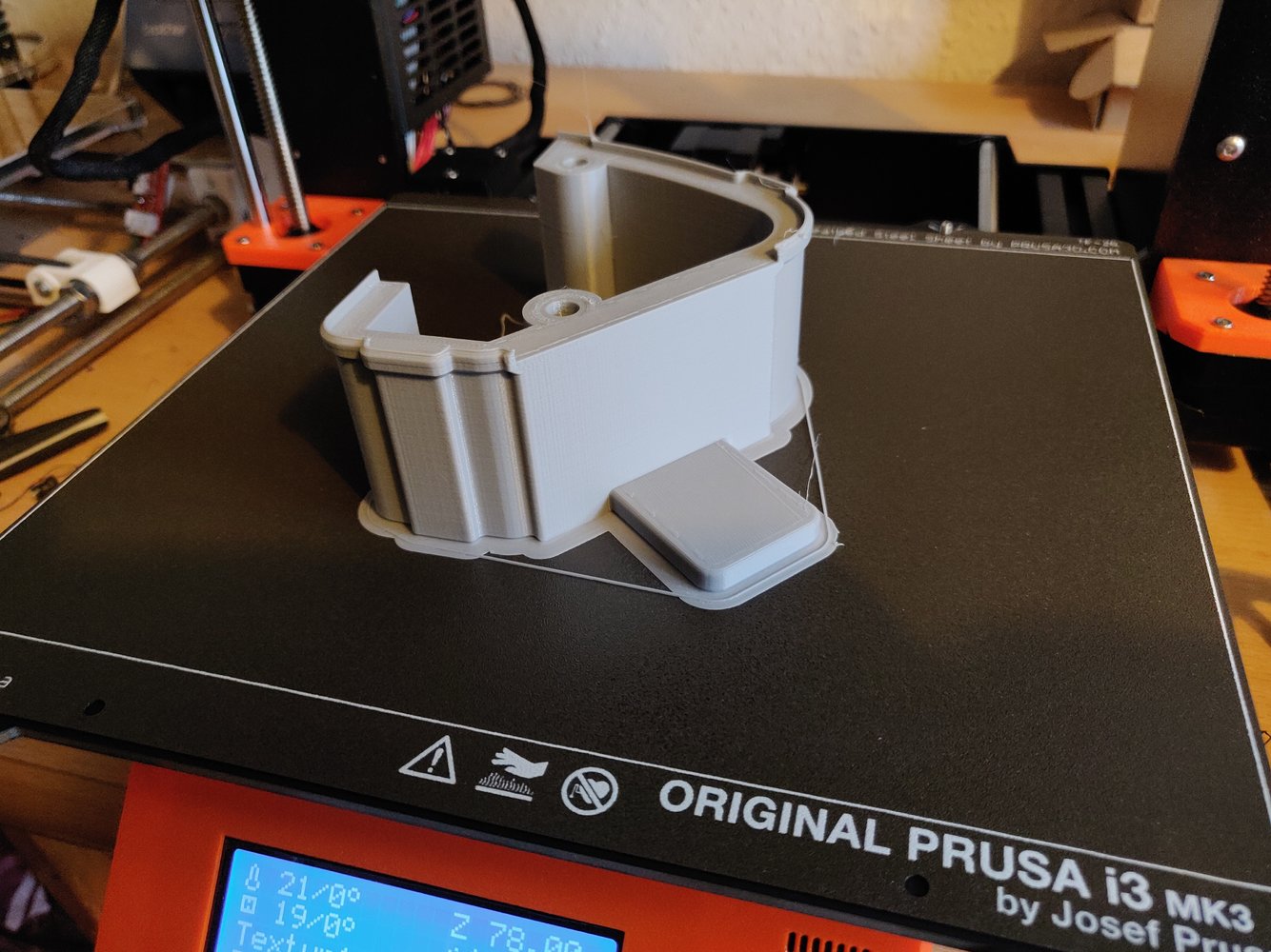

Difficult to quantify speed, the max filament speed is just under 7mm/s

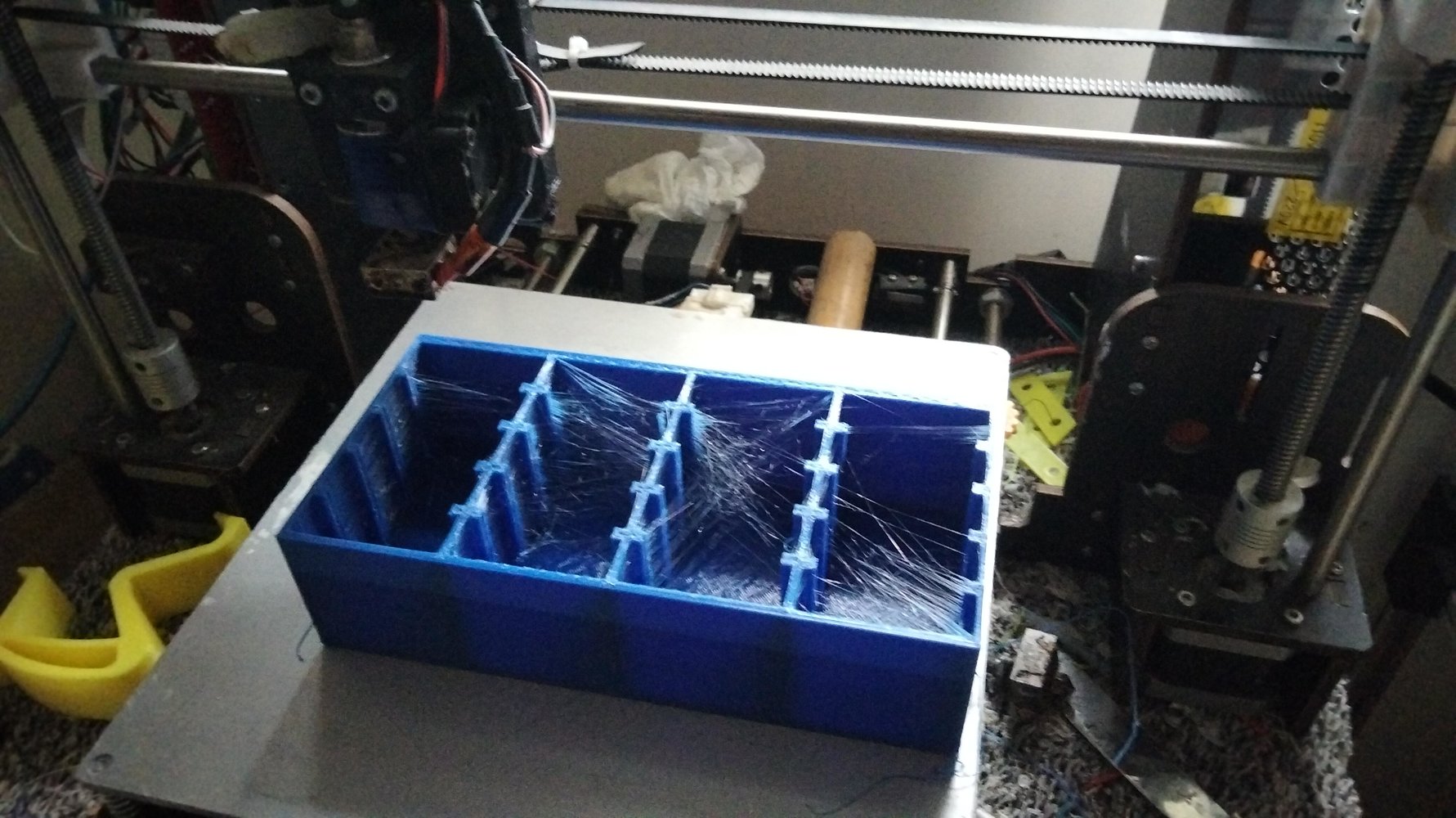

Need to resolve the ooze issue with retraction adjustments. Software update overwrote my previous settings.
