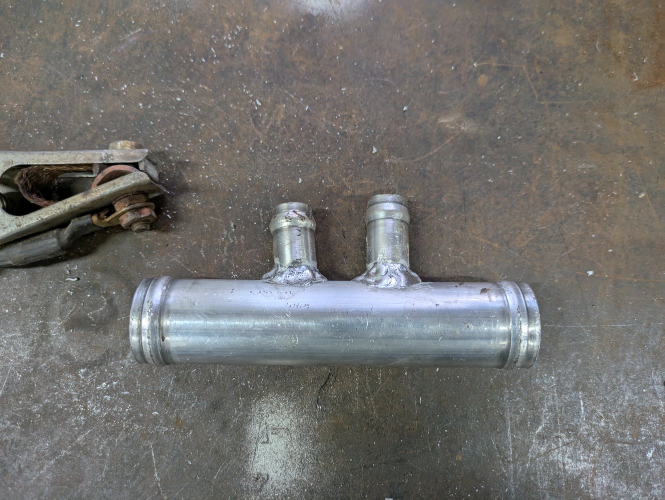

Iv conceded and bought some alu pipes and some bends, it’s for the Cummins so no off the shelf stuff available at all@8ob suggested to me ages ago when doing non standard layouts to do the bends and anything weird in either stainless or Ali, then you can use standard off the shelf items and they'll last forever.

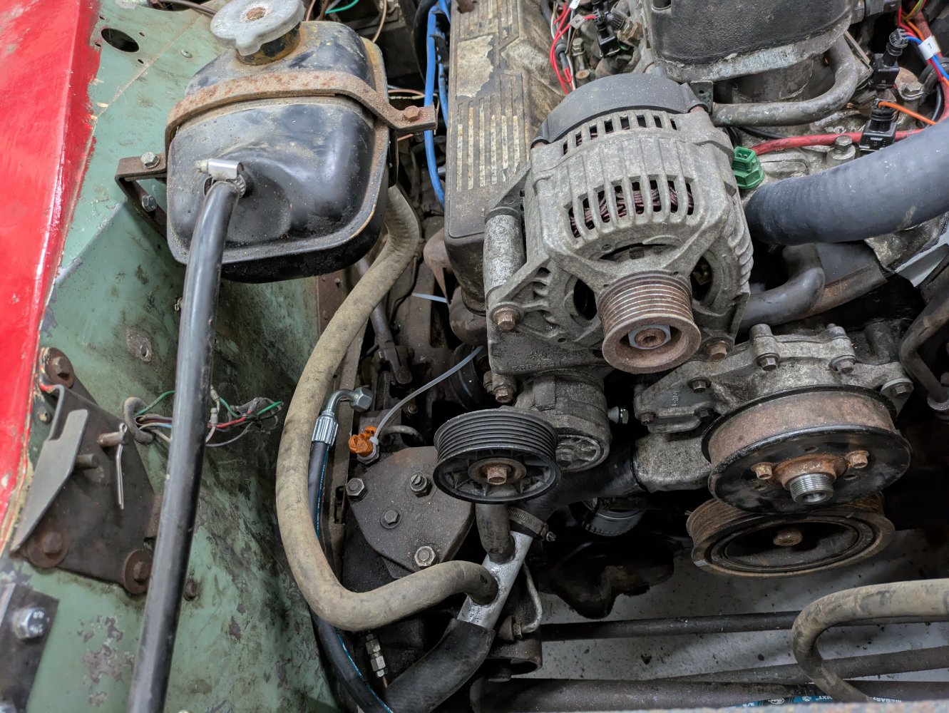

I've got gone that way with the 6x6. I've transplanted a GEMs 4.6V8 out of a P38 in it (was originally a Stage 1 so had a 3.5 so it makes sense). The P38 uses a plastic pig heart for the thermostat and has a quite high temperature setting (99C I think). So I've used some Defender V8 hoses and a custom ali T piece to make it work. But it means should a hose go somewhere silly I should be able to use something off the shelf to get me going again.
And installed
Way less faff I think doing it this route than making a silicon hose. Admittedly I've been trying to keep things fairly factory (well factory parts) so I know where I can get replacements in the future.
The bottom hose bends were a standard V8 top and bottom hose cut up but at a pinch any hose with slight bends and a 35mm bore would do.
