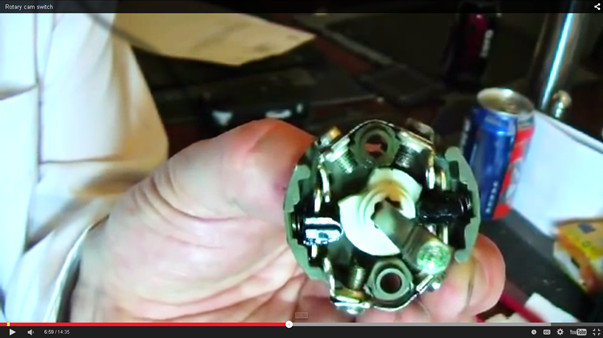

The code numbers and letters tell what type + rating + number of positions and more about the switch.
If it was just a power selection switch then it is much easier to replace but that one also has the power ON/OFF built in.

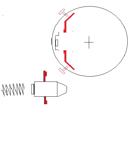

If the above test on the live and neutral were ok then after marking ALL connections it might be time to take switch apart. Be ready to catch any springs / detent ball bearings and broken bits. Maybe take apart on a washing up bowl to catch any parts. Before starting mark a line down the length of switch so as to align up the segments when reassembling.
