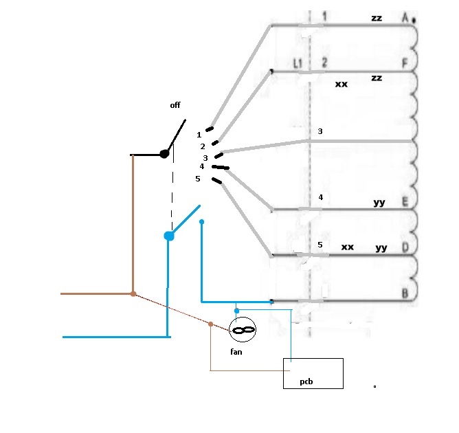

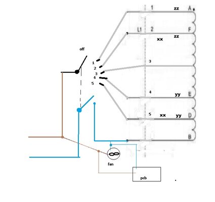

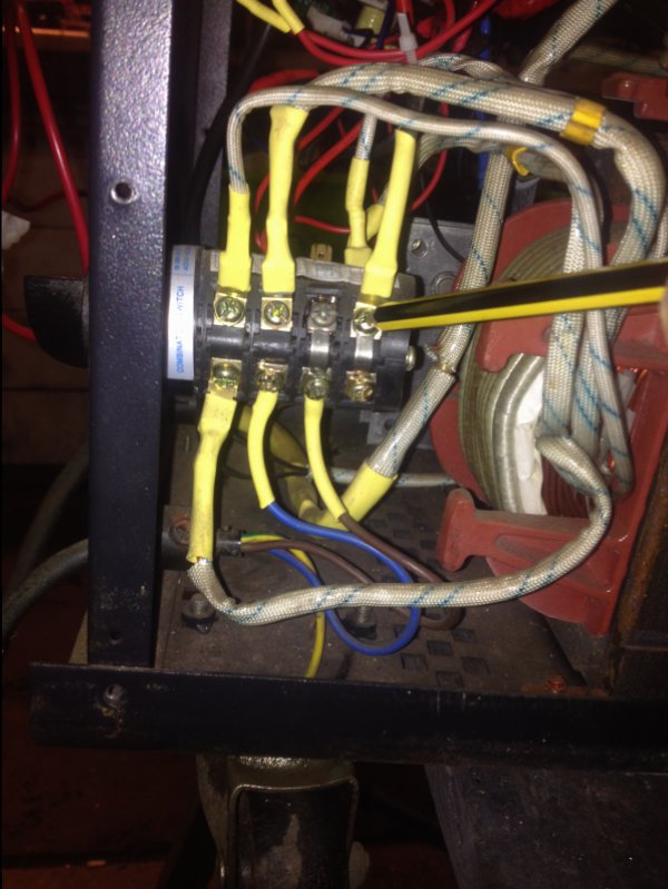

Is there no separate ON/OFF switch ?
Oh dear what a pain that is going to be. DON'T be tempted to take apart the rotary switch (there have been enough post of "well it took the switch apart and now I have a bag of bit" or "where do all these wires go"No separate on/off switch .Off is position 0 on 6 position rotary switch
and believe me trying to talk some one through putting it back together via post on a forum is no fun
does sound like your switch then if you get nothingHi Snooper,yes tried continuity on cable.Probing from plug live pin =zero on all connections(except live).Probing from neutral plug pin with meter on lowest setting to all wired connections= 352-355(except live)
Bit confused by theses reading (and where you are metering.Hi Snooper,yes tried continuity on cable.Probing from plug live pin =zero on all connections(except live).Probing from neutral plug pin with meter on lowest setting to all wired connections= 352-355(except live)

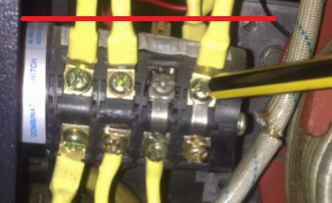

Brewers droopis it just the picture or is the switch drooping at the rear ?
see my pic im looking more from the sticker at front of switchBrewers droop
If you look at bottom edge of pic / bottom rail the machine is on a slight incline.
