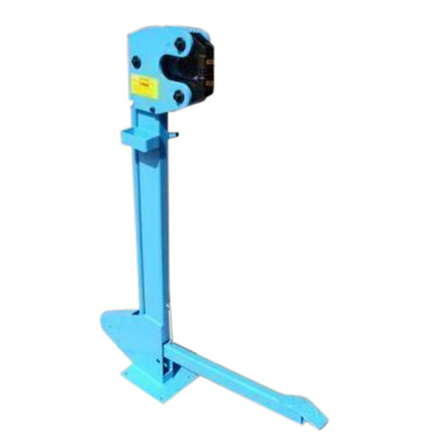

  7. hotponyshoes Member
    Messages:
    3,379
    Location:
    Somerset. Uk
    I have got the cheaper type like the pic above.
    Works fine on car body thickness steel.
    Has had a fair bit of use and not shown any signs of wearing out yet.
    For bigger stuff like car panels get the floor mounted version with a foot pedal so you can hold/feed the panel with both hands.
    Or make your own stand up and put a pedal on it.
    For the price of them it would almost be worth getting 2 just to save having to swap the jaw sets over.
    slim_boy_fat and MattF like this.
  8. Pigeon_Droppings2 Forum Supporter
    Messages:
    3,116
    Location:
    london
    Looks too good to be true....I'm tempted to upgrade.
    Throat is 216mm (sounds better than saying 8 inch!)
    Includes postage....will probably need fettling but looks handy.

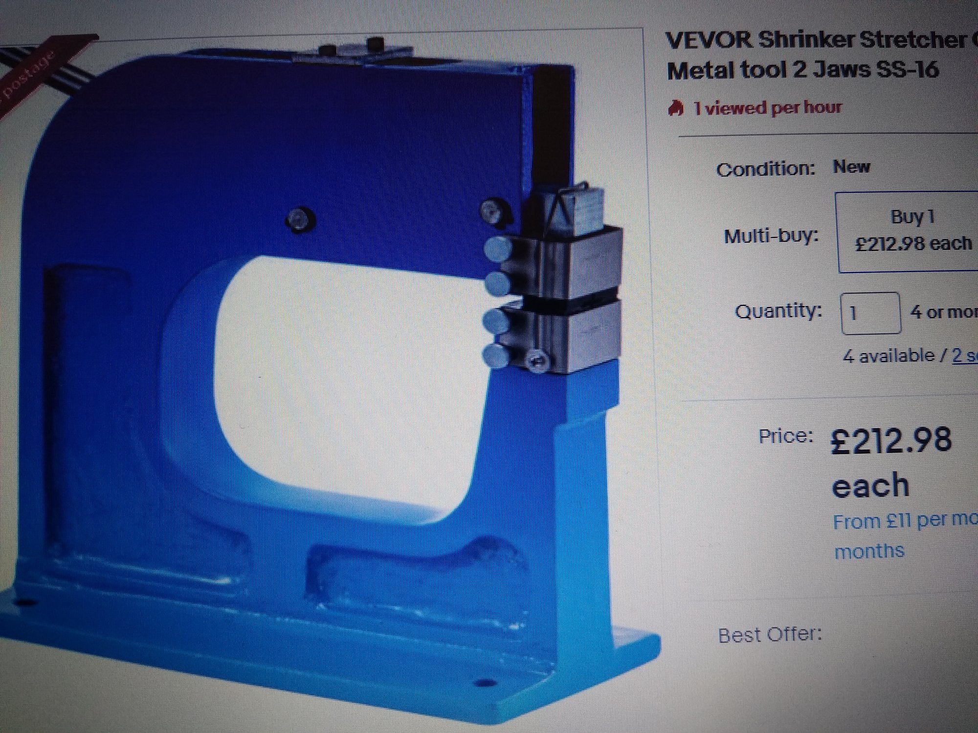

  14. Pigeon_Droppings2 Forum Supporter
    Messages:
    3,116
    Location:
    london
    Looks a lot like the eBay one I posted...well except the price is £60 more so maybe it's better somehow.

  18. Roger440 Member
    Messages:
    106
    Buckingham
    The only negative i see to the ebay/vevor one, is lack of spare parts, ie, jaws.
  19. Pigeon_Droppings2 Forum Supporter
    Messages:
    3,116
    Location:
    london
    With a lot of these things I find they are just churned out of the same Chinese factories. I guess it depends on the planned use...if you are going to use these a lot then you'd need to be sure about spares.
    To my eyes the casting looked identical...could be the same tool with £60 added?
    Actually the castings are different....and the eBay ones look rougher to my eyes!
