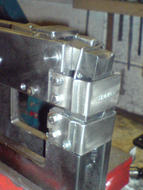

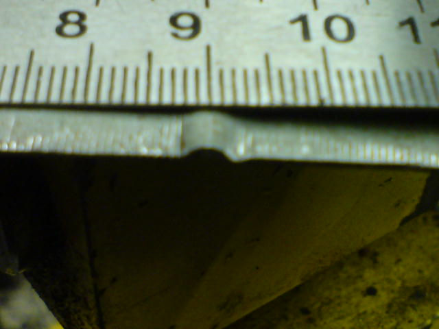

  9. optima21 Forum Supporter
    Messages:
    2,882
    Location:
    halifax, England
    the professional ones do cause less damage to the metal, as the seartions in the jaws are better quality. the shrinkers cause a ripple in the metal because of the way they work

  10. MattF
    MattF Member
    Messages:
    10,086
    Location:
    South Yorkshire, England
    It was the serrations which I noted. The shrinker obviously needs to distort somewhat to do its job, so I expected that. How do you handle the serrations left by the stretcher? Looks like they may need some fair work to clean up without serious filing/grinding?

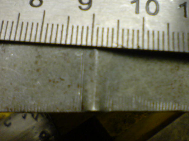

  11. optima21 Forum Supporter
    Messages:
    2,882
    Location:
    halifax, England
    I had read that you can put emery cloth between the shrinker jaws and sheet metal to give a smoother finish...I tried that tonight and it doesn't work with mine, it doesn't shrink.
    just for scale this is a peice of 0.9mm that I tried it on tonight, the ruler is showing the mm markings
    MattF likes this.
