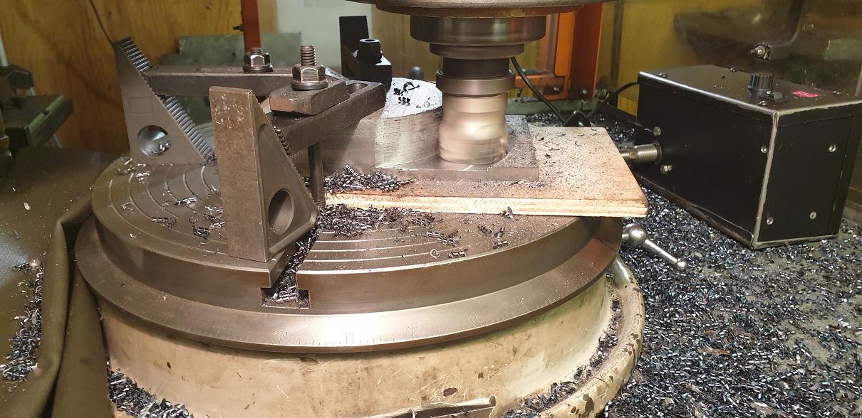

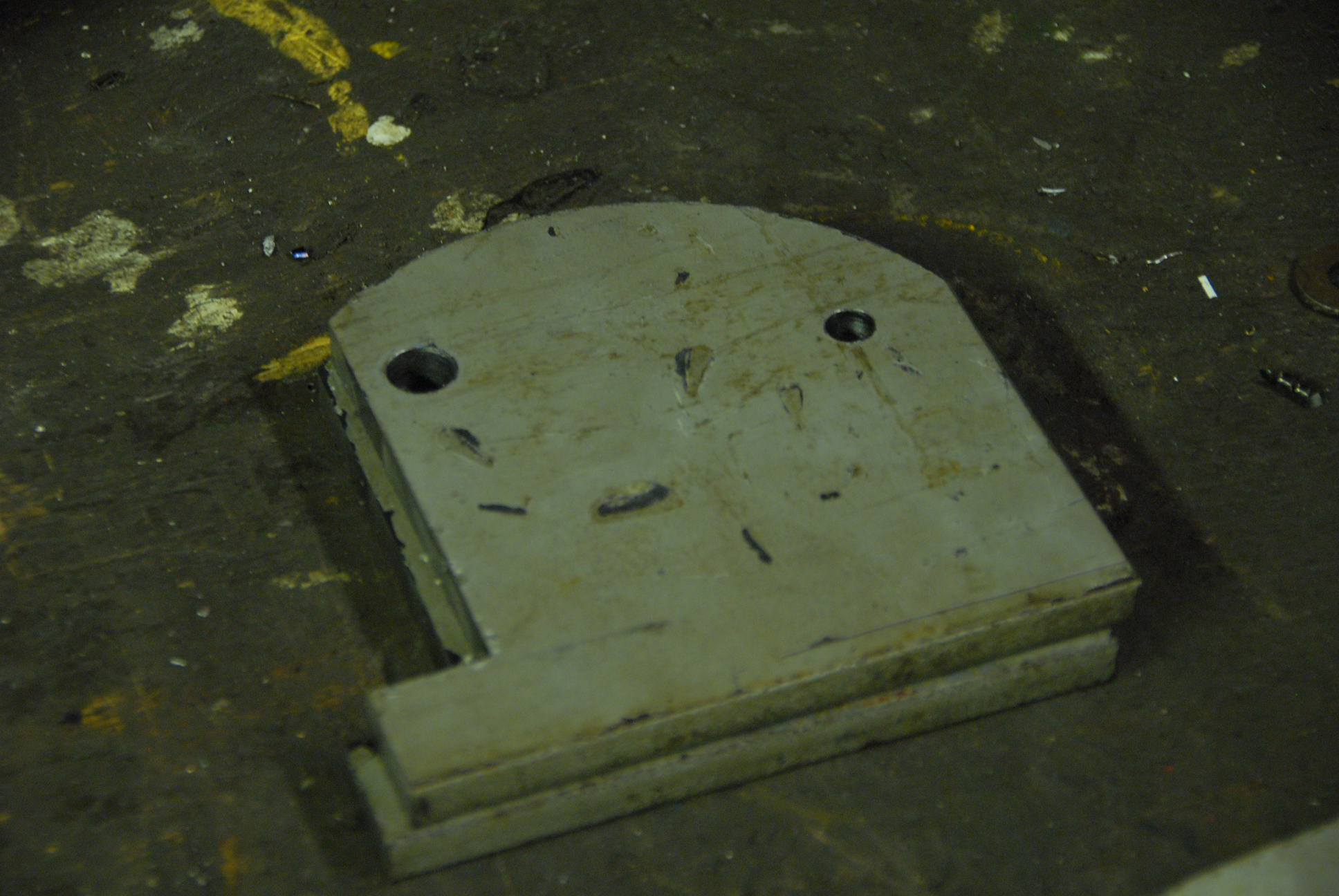

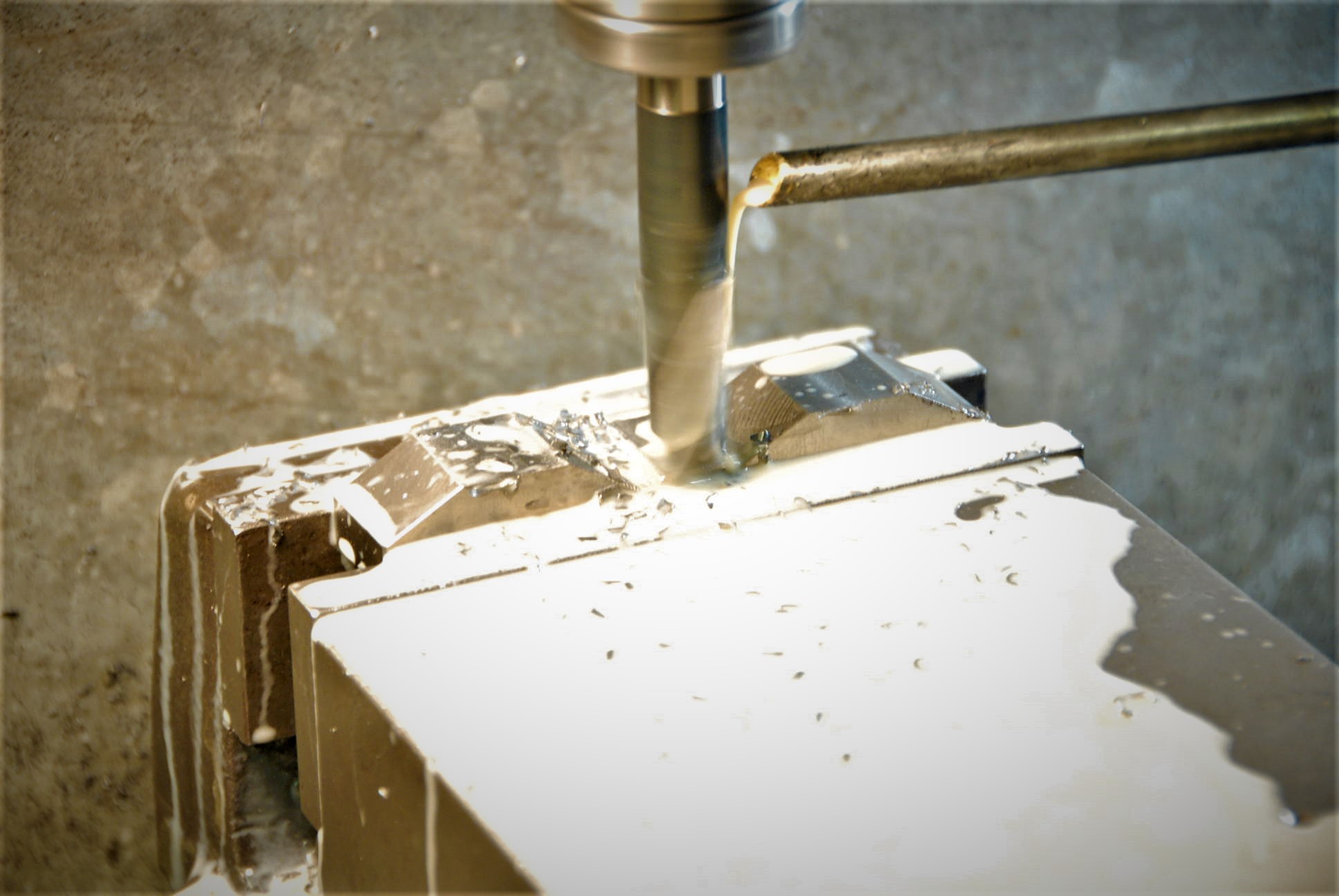

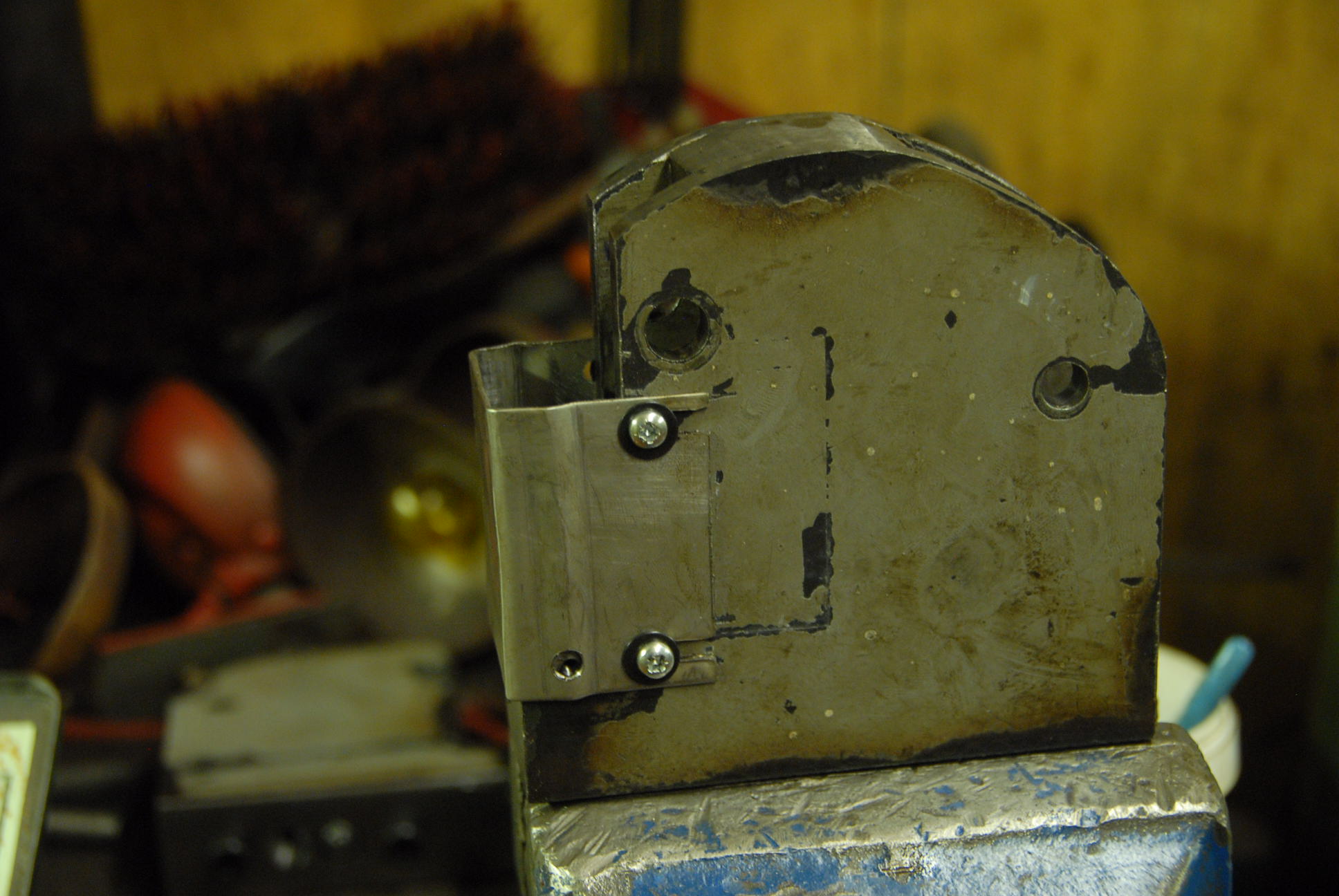

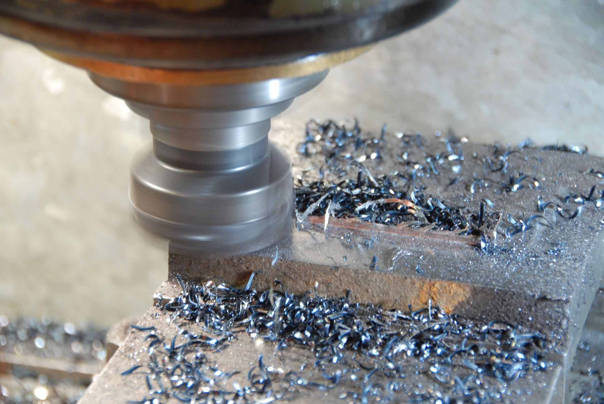

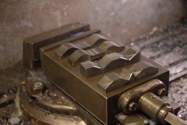

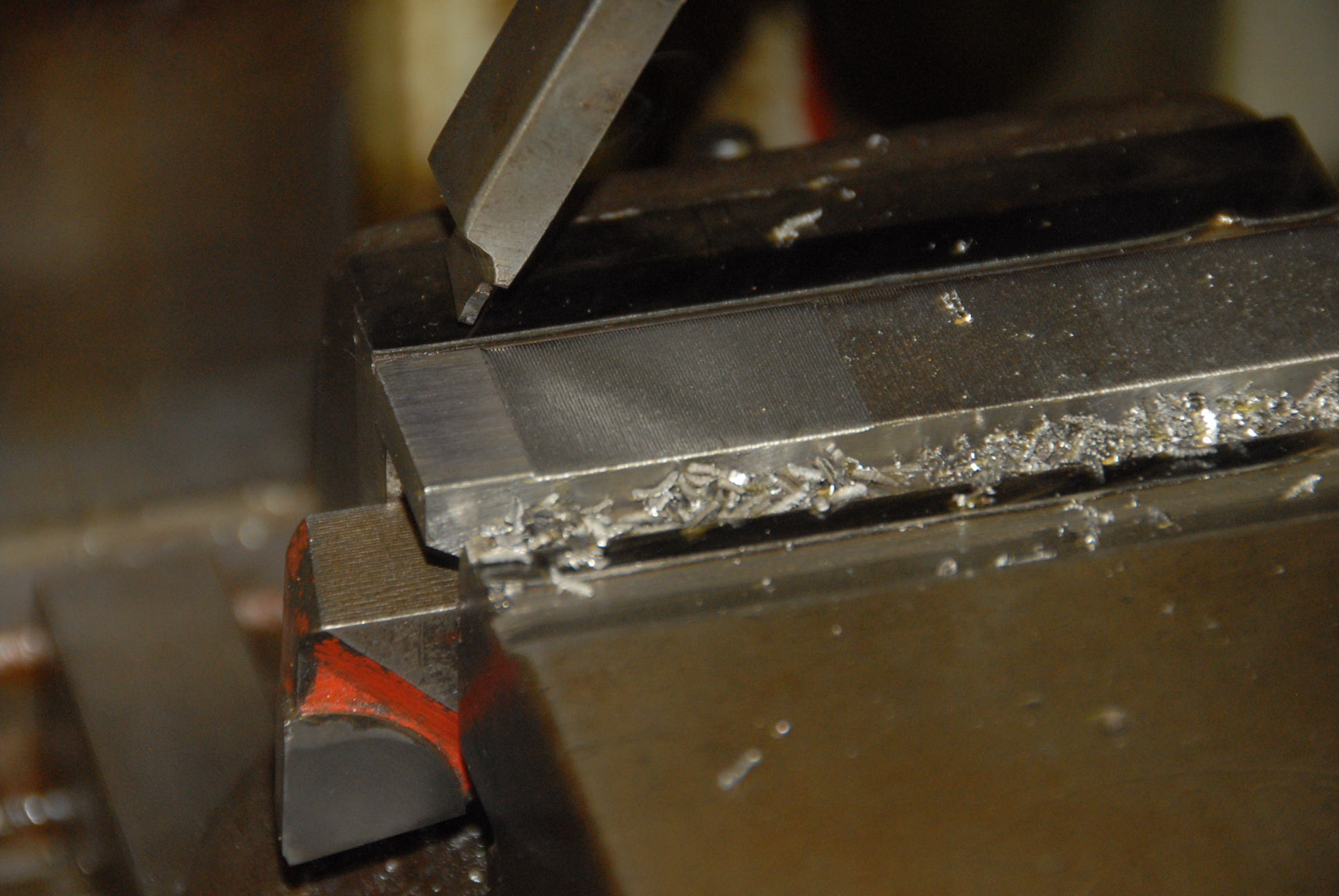

    This morning I made a start on my Shrinker and Stretcher build so thought I would post my first photo from milling the rounded tops. I shall be making 2 bodies and hopefully 1 set of shrinker jaws and 1 set of stretcher jaws save having to swap them about
    I will update as to progress as and when I have more pics
    Jord

    grim_d Forum Supporter
    Messages:
    1,867
    Location:
    Scotland - Ayrshire
    That is a giant rotary table!
  3. jordhandson Member
    Messages:
    393
    Location:
    Dorset
    Naa there a lot bigger out there, off the top of my head mine only 15 inches :D

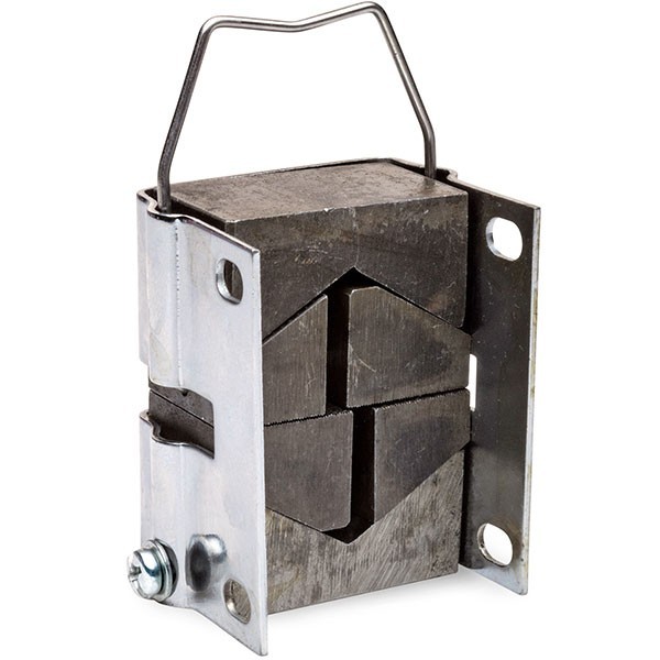

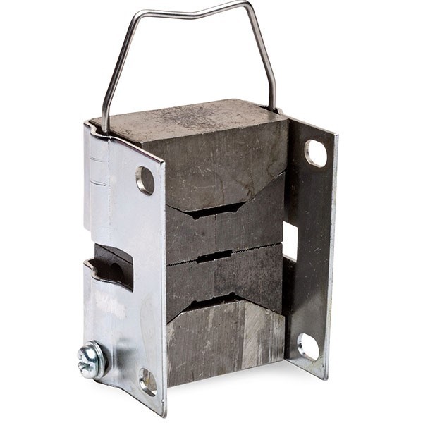

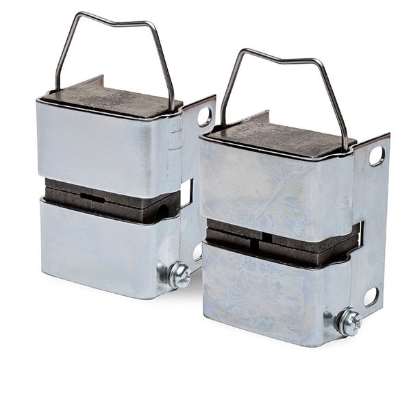

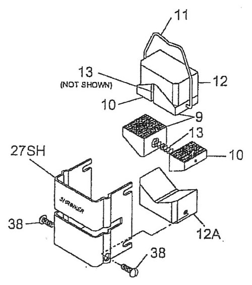

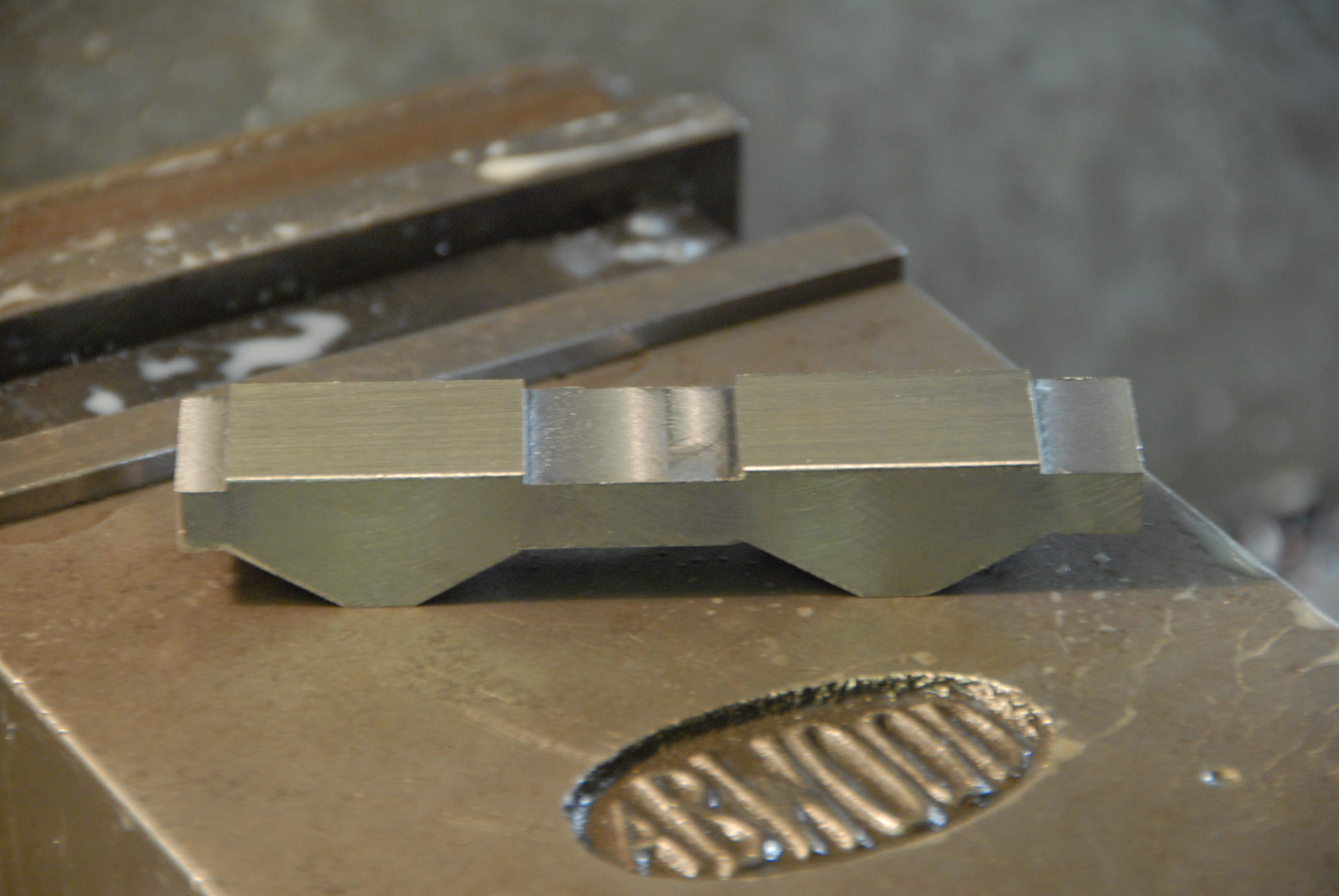

    What sort of jaws are you thinking of making?
    I had a chance to take an Eckold apart and they were very different to the usual ebay type.
    Really nice jaws but $1000 a set!

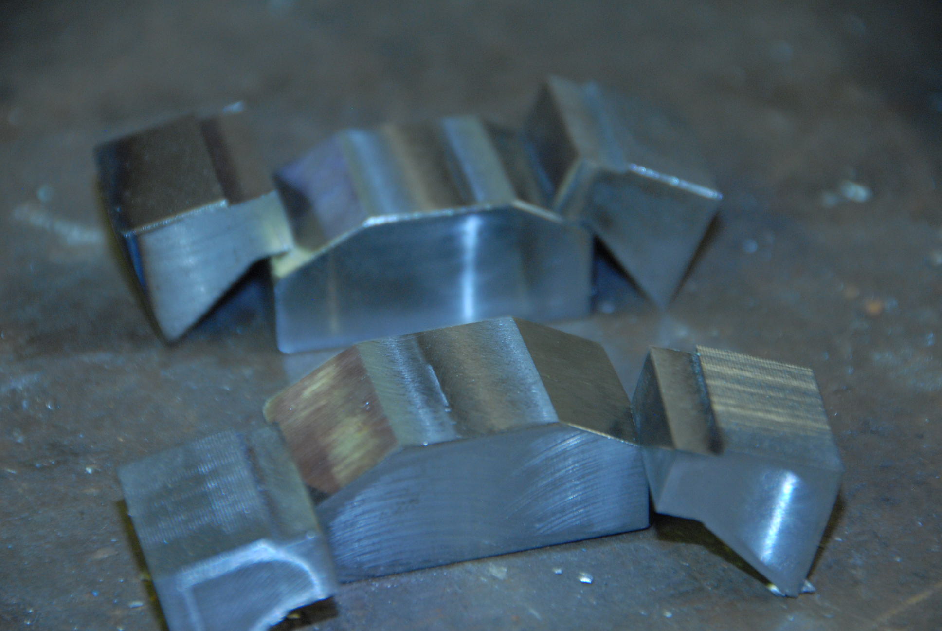

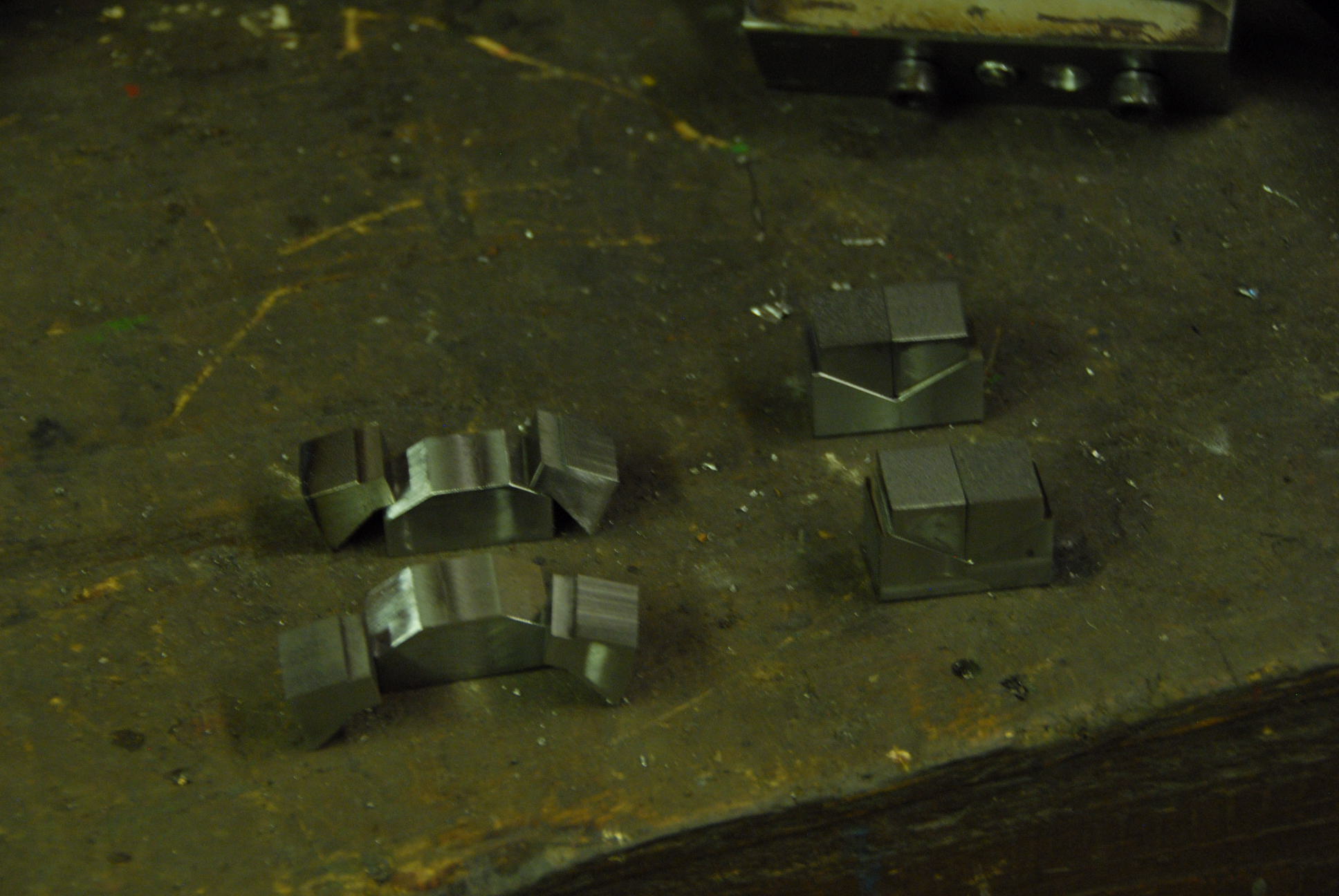

    Starting with something simple much the same as the ebay type jaws
    Jord

    I Just googled Eckold there's some interesting tools and expensive no doubt
  9. Dcal Member
    Messages:
    1,248
    Location:
    Antrim Northern Ireland
    That was on an American site and the only one that I found that listed a cost.
    Are they even more expensive over here?
    Seems a huge price for a couple of 40mm jaws and a bit of rubber.

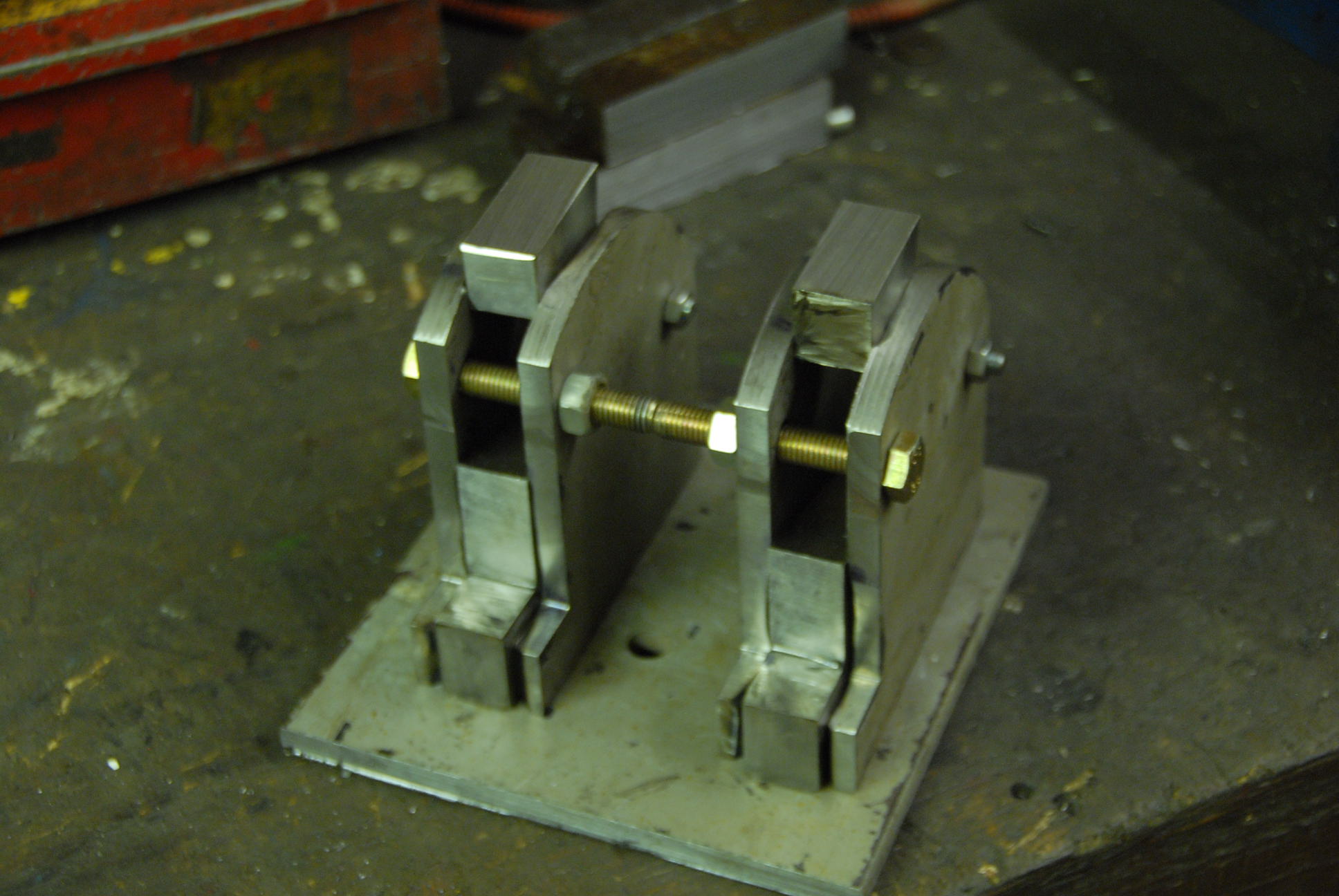

  12. jordhandson Member
    Messages:
    393
    Location:
    Dorset

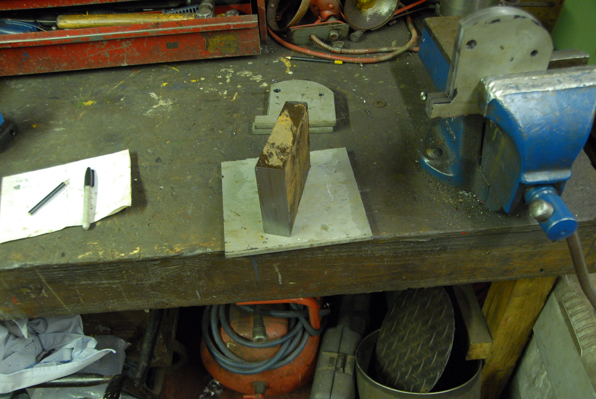

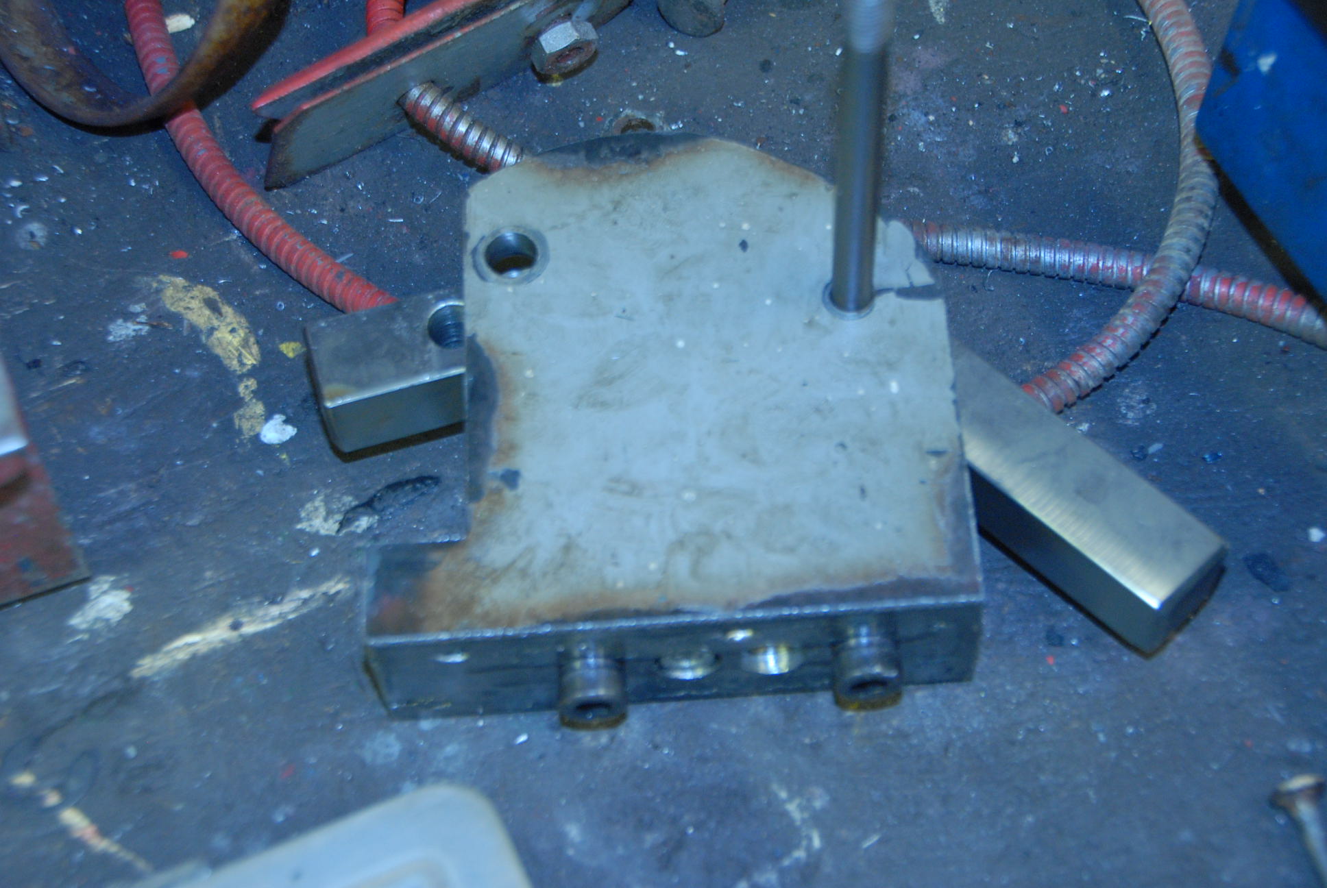

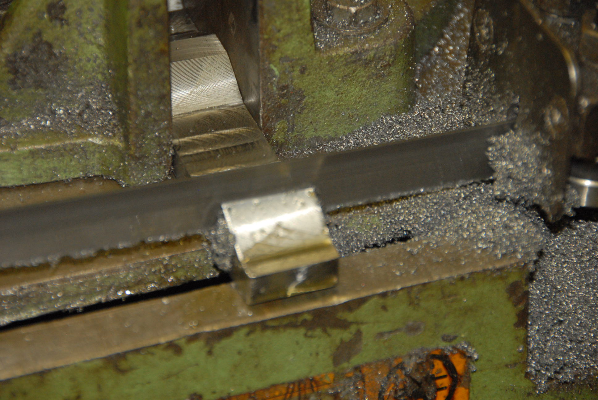

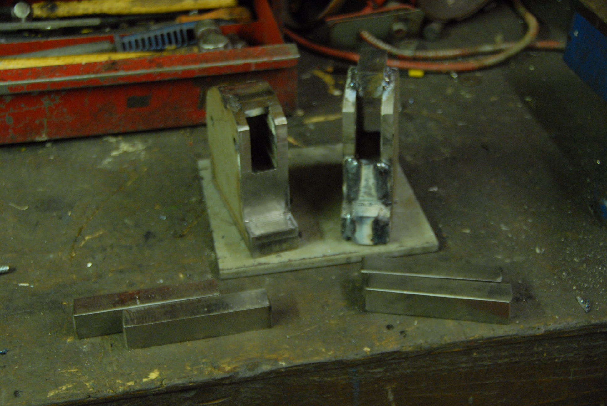

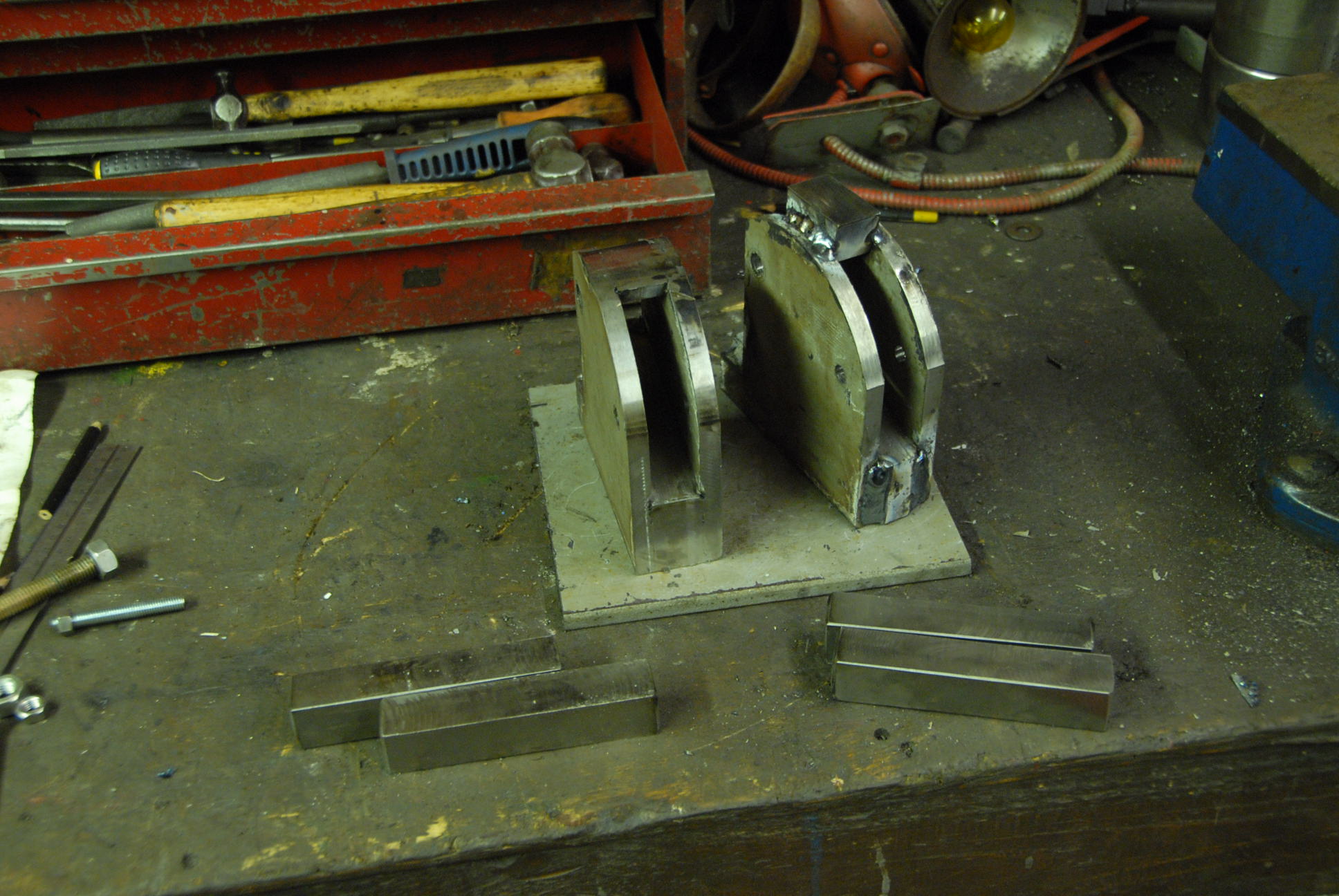

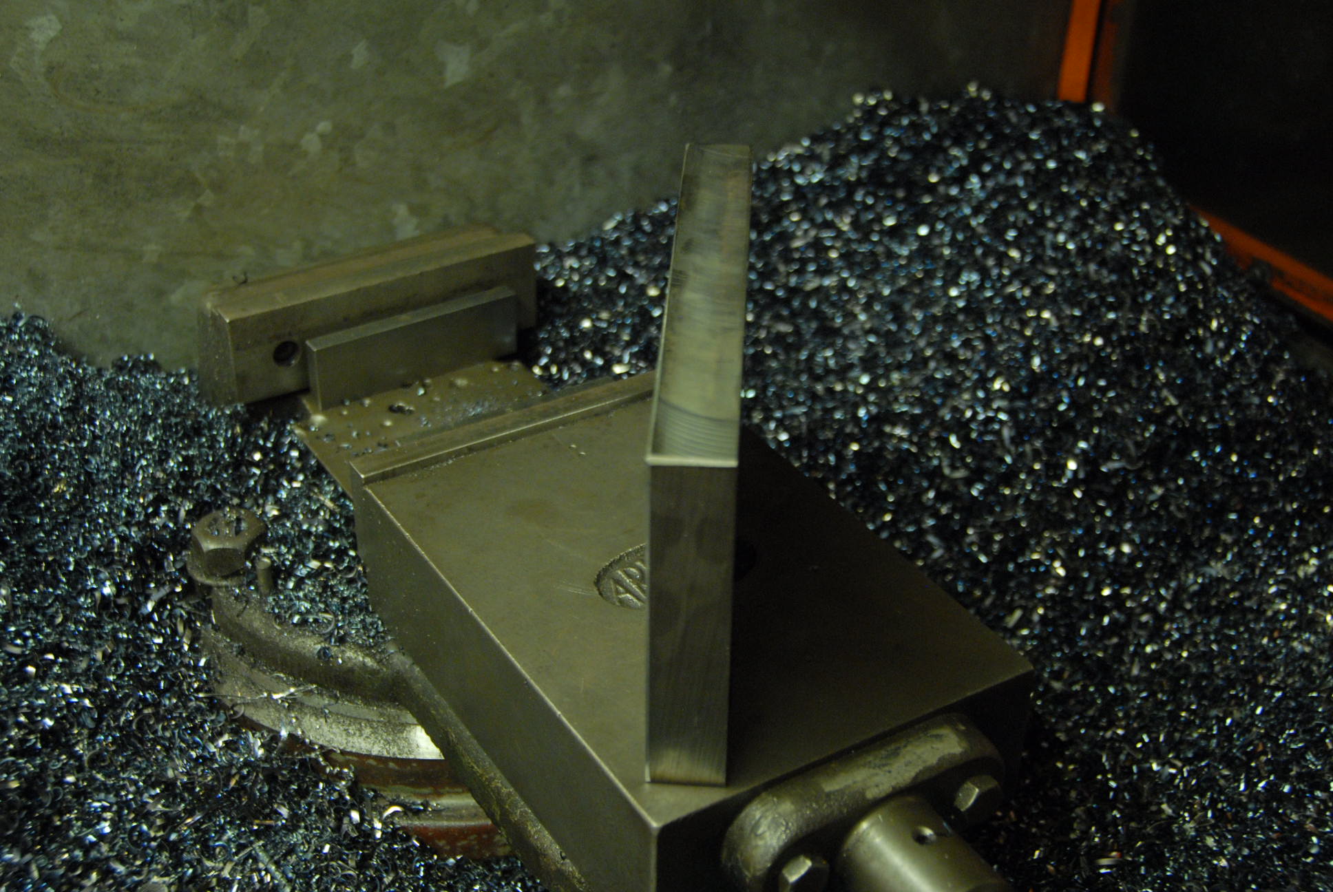

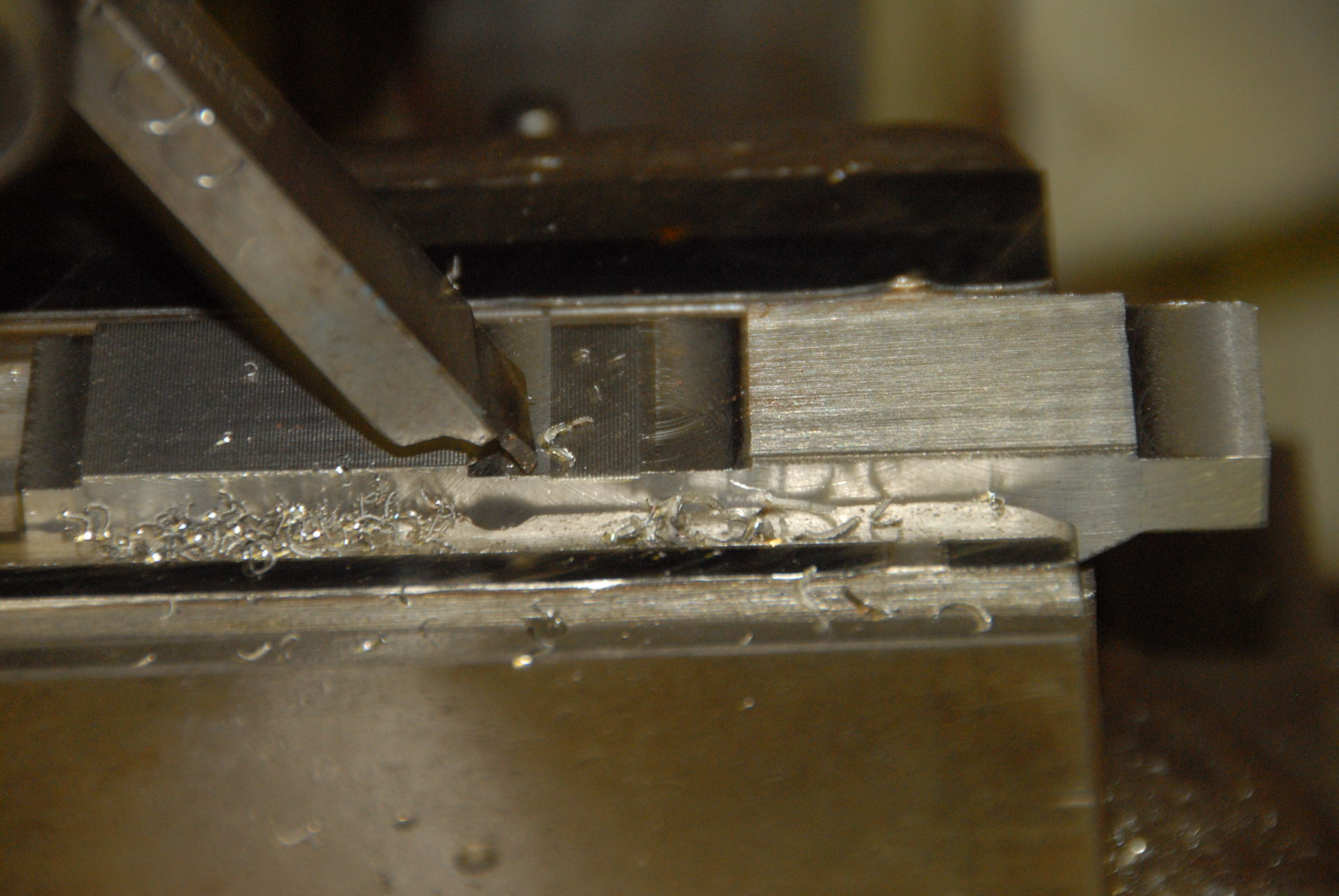

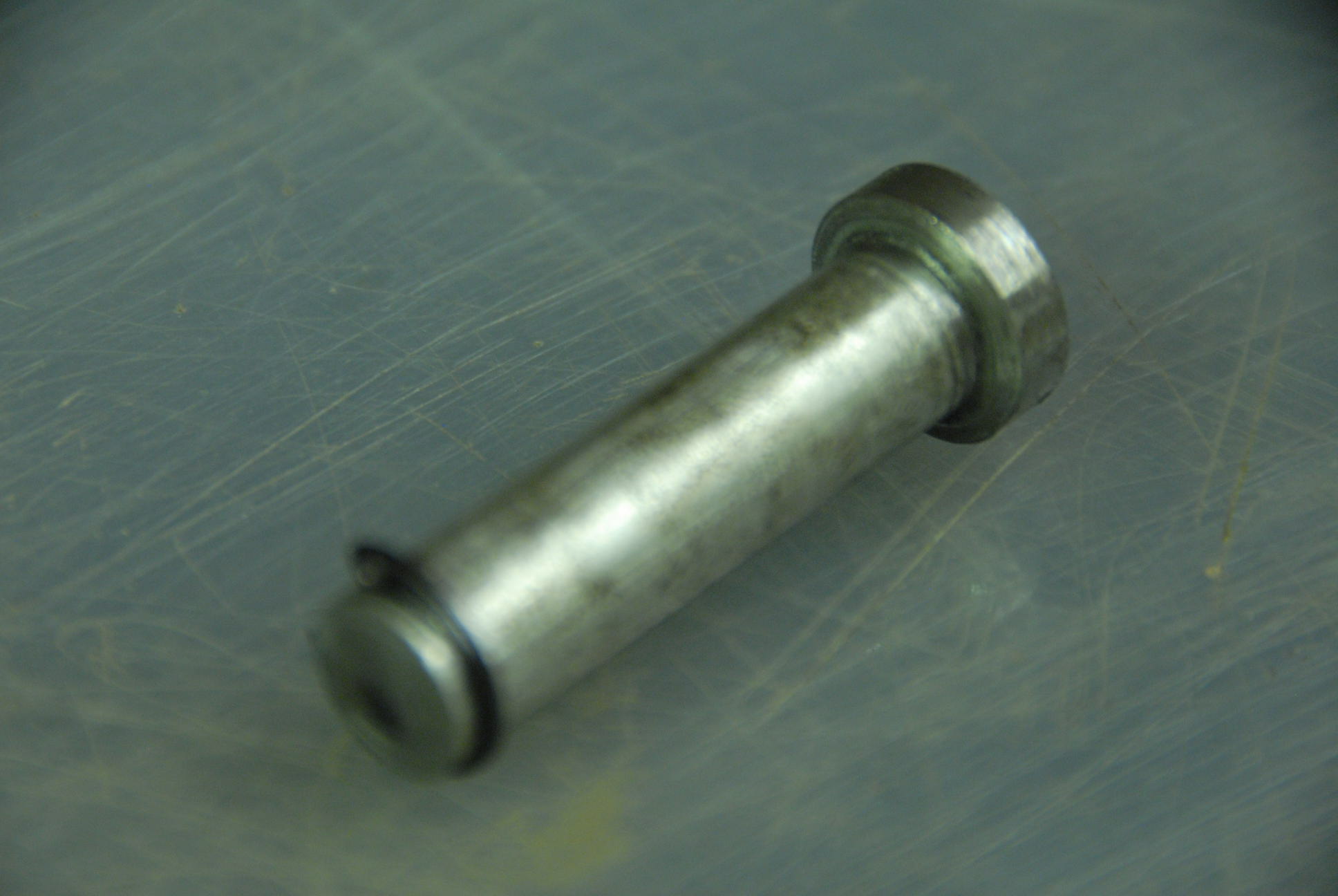

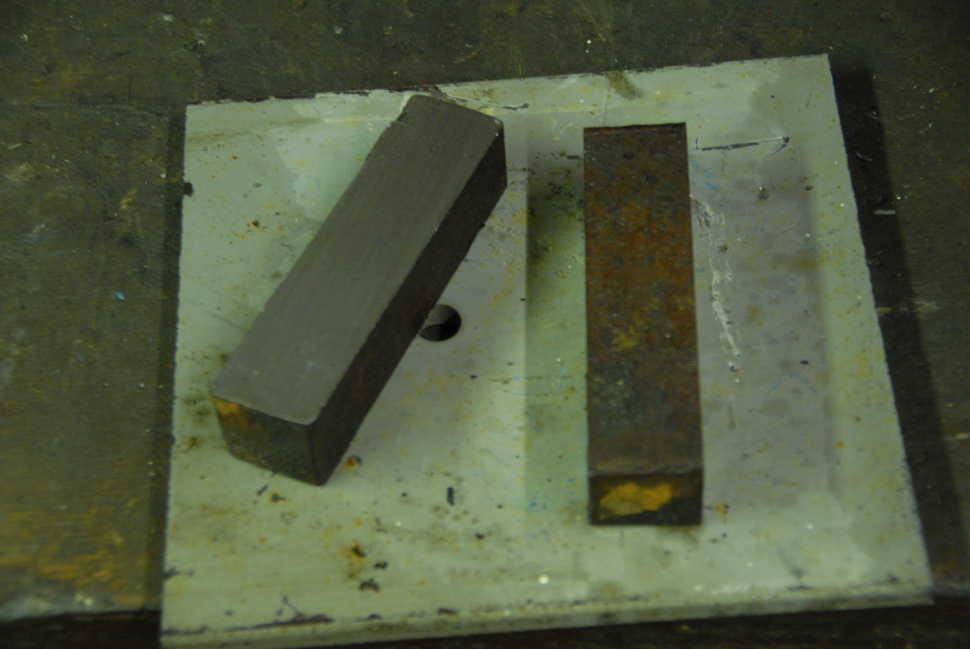

    Last night I managed to get a bit more done. I am using some 10mm plate I had spare for the sides
    For the centre piece I am still munching through the forklift fork I need to mill it down to size 25mm I managed to get 2 pieces out it.

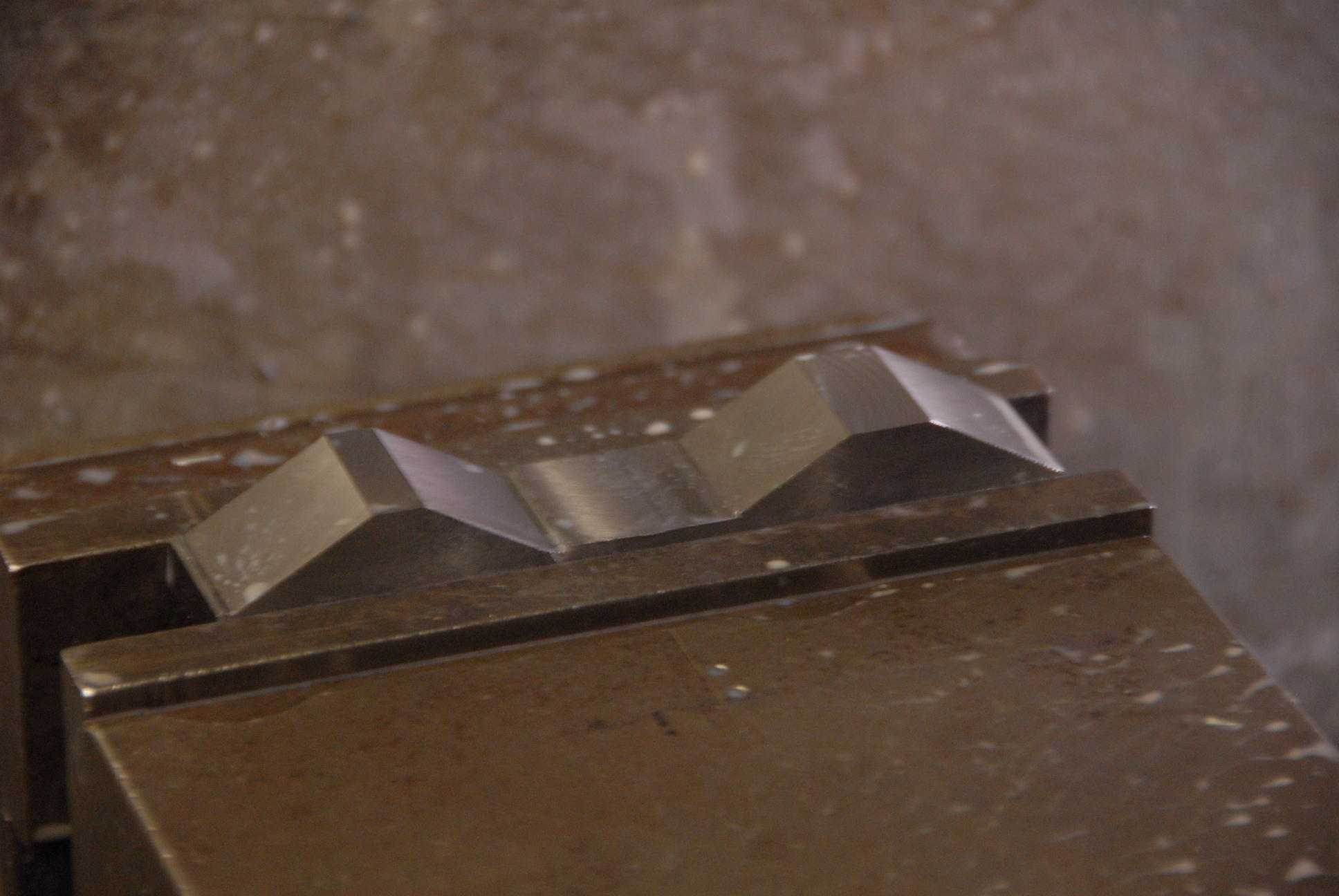

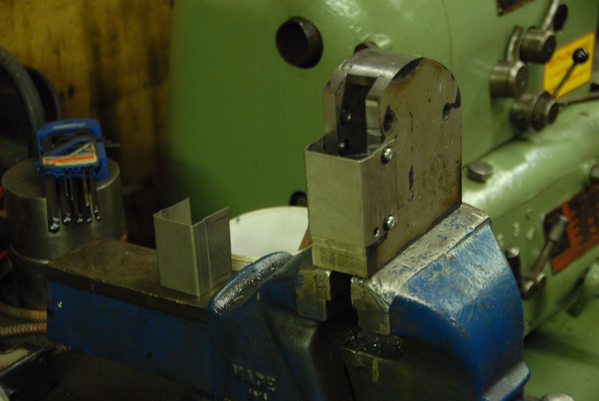

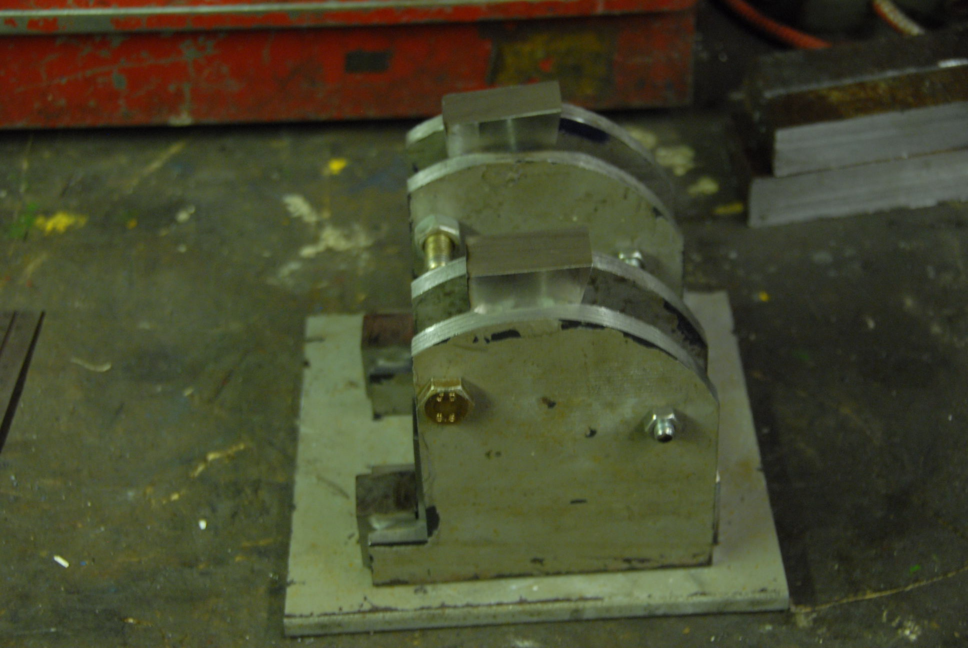

    I mocked them up for welding the centre piece in

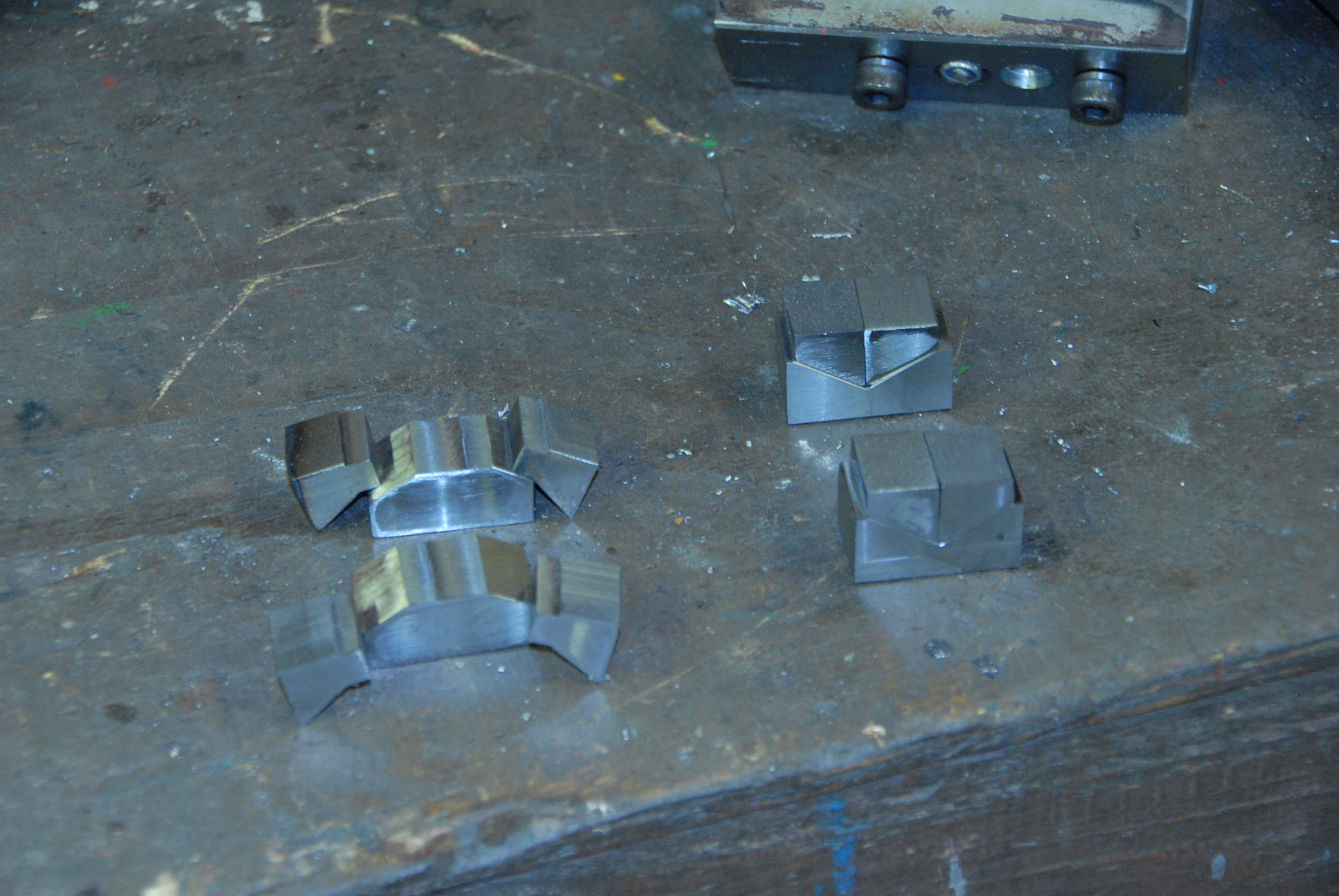

    I cut some off cuts for the lifter parts they will be milled to fit in between the centres.
    Once welded I then milled off the excess welds.
    Not looking to shabby hope to get a bit more done tomorrow night
    Jord
