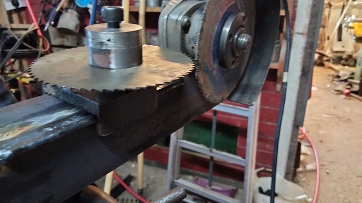

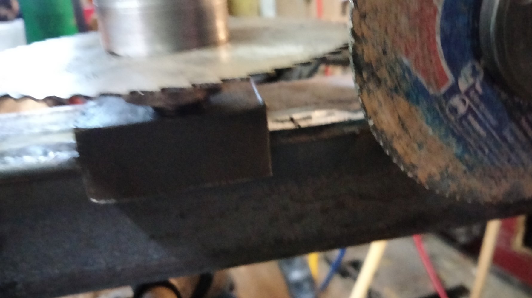

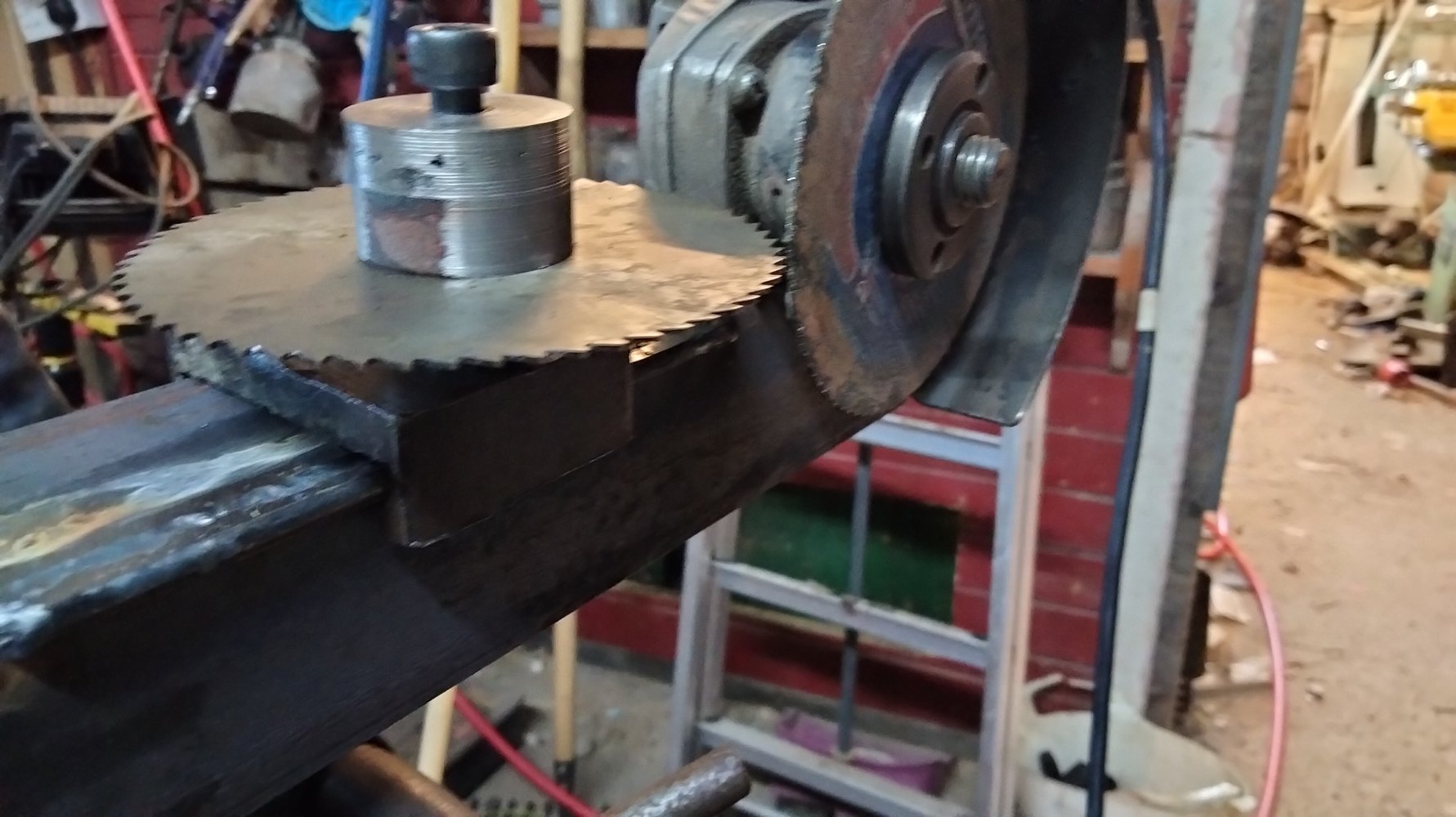

Sorry yes.....but coarse sawdust is what I meant large pieces 4mm or soYou mentioned course sawdust in your first post..
Having had a futile session trying to shred green stuff with the Hyundai shredder, which uses a paddle wheel blade array against an adjustable pressure plate, Which is not a good system. It resurrected my interest in the DIY jobbie. I think that if the blade teeth were all aligned in a row they it would act like a series of closely spaced chipper blades?
I think you would have much more success with that approach than your initial idea of trying to mimick the interlocking knives on twin-shaft industrial shredders (which, fwiw I don't think is a design that's well suited to what you're trying to achieve here anyway).Having had a futile session trying to shred green stuff with the Hyundai shredder, which uses a paddle wheel blade array against an adjustable pressure plate, Which is not a good system. It resurrected my interest in the DIY jobbie. I think that if the blade teeth were all aligned in a row they it would act like a series of closely spaced chipper blades?
I already have the oodles of blades....I think you would have much more success with that approach than your initial idea of trying to mimick the interlocking knives on twin-shaft industrial shredders (which, fwiw I don't think is a design that's well suited to what you're trying to achieve here anyway).
However at that point, rather than buying oodles of saw blades, wouldn't it be cheaper to buy an old planer or spindle moulder head (non-chip limited ones are cheap on ebay) that takes serrated knives (again cheap as chips and easy to resharpen)?
3hp probably won't cut it for shredding wood up to 4" diameters at any appreciable speed, a small commercial unit for that kind of application would usually be around 22kW...I have a spare 3ph motor (3hp) and VFD lying around. but would prefer to run off the tractor PTO. Want to avoid small petrol engines.
I know..I know
Congratulations, you solved your problem!Well....finally finished it...I know..I know
