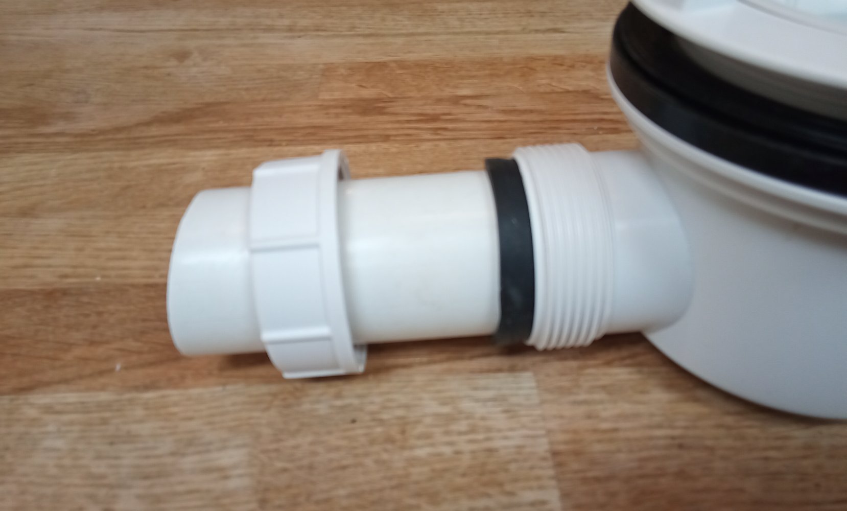

a wee sand of the pipe and the tappered washer will go in a bit more if you cant get the adaptorYes.

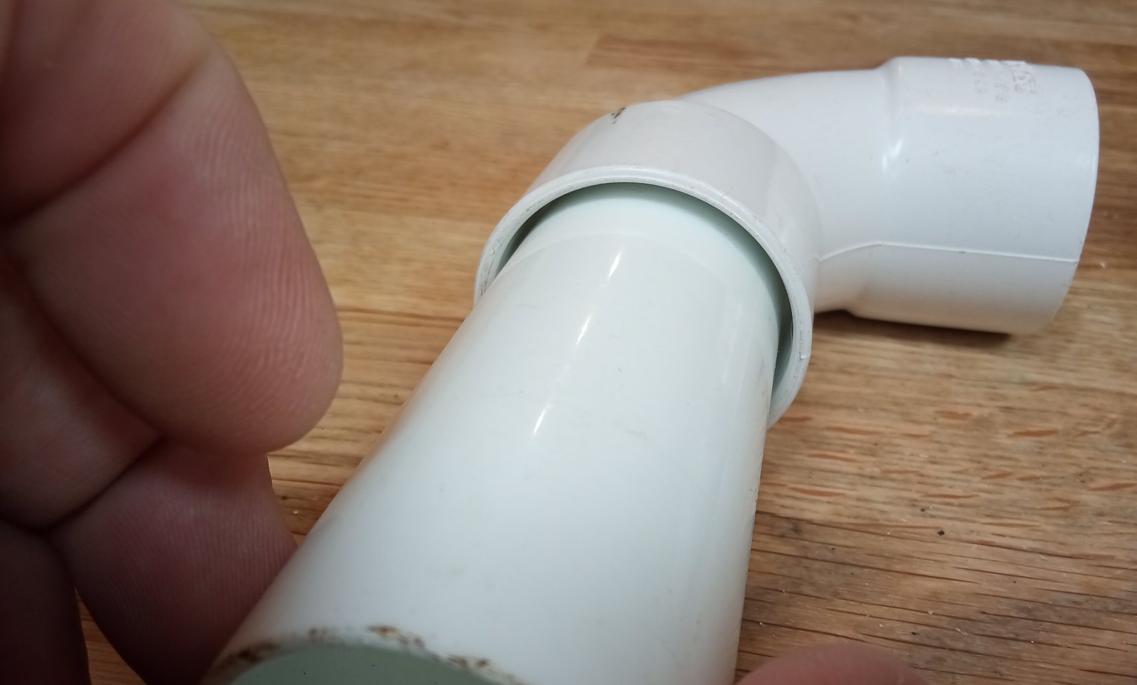

You are missing a section that comes with the trap , it is a piece with a approx 45 degree angle , it threads straight onto the trap and leaves you with a compression nut that 40mm solvent weld will fit into .No the push fit stuff is different again from what I can see and I definitely don't want it under a floor I can't ever reach again, that's why I want solvent weld pipe as much as possible as once it's in place it won't move much.
Here's some pics.
The trap with the compression fitting pipe, the seal fits well.
The trap with the solvent weld pipe, the seal doesn't fit well.
The compression fit pipe in the solvent weld bend, a very loose fit.
