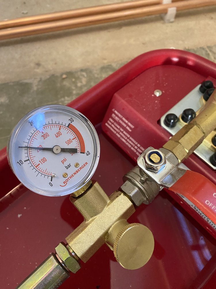

I get 9.5 bar now and again, average is about 4Mains water is only 2 bar max..your gauge is showing almost 14 bar![]()

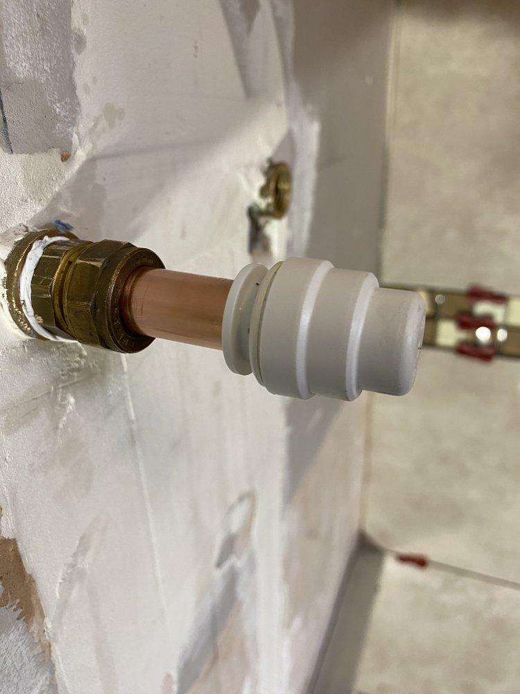

Yeah, they would have workedYep, have ditched those angle connectors when fitting my own showers. Have a look at these on Screwfix. 8669H . Bit late now you have plastered over though.

Have a look at B.S. EN 806 as this gives the correct testing regime.Thanks chaps, i'll give the 577 a try. It does say it's made specifically for sticking parallel threads into tapered sockets so we'll give it a whirl.
Not ideal but i can pressure test it again once the mixer is on.
Will avoid this type next time!
