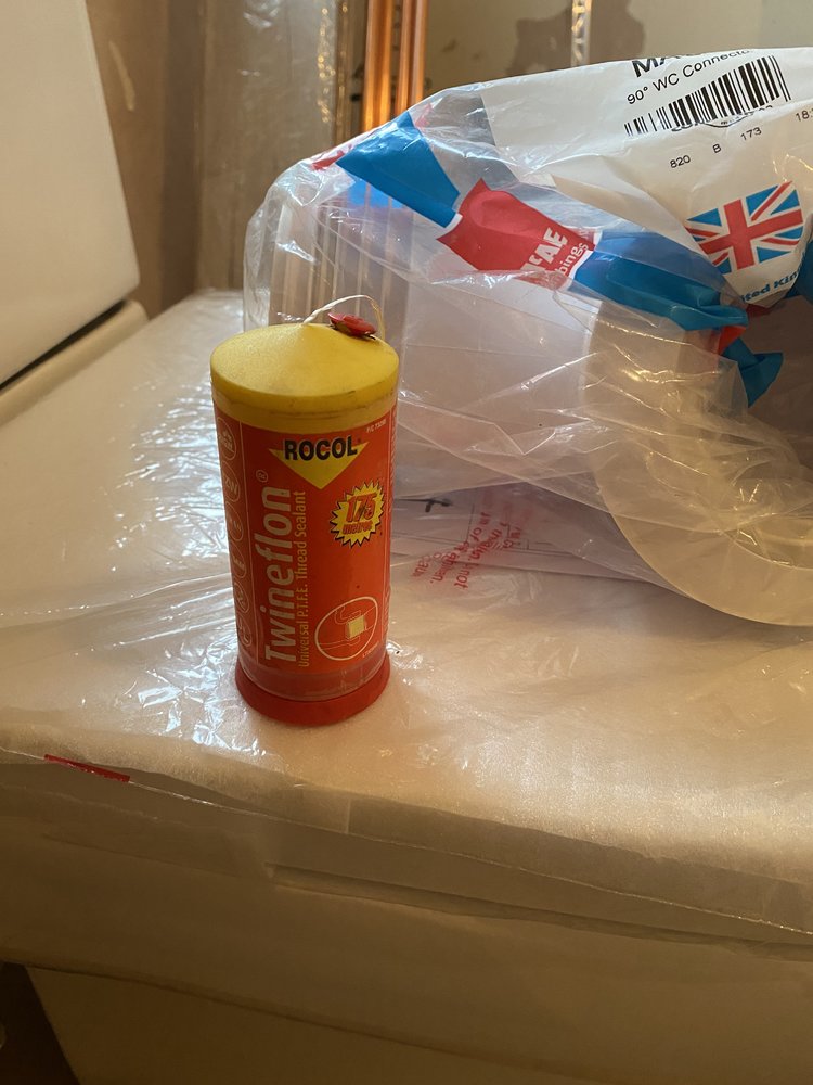

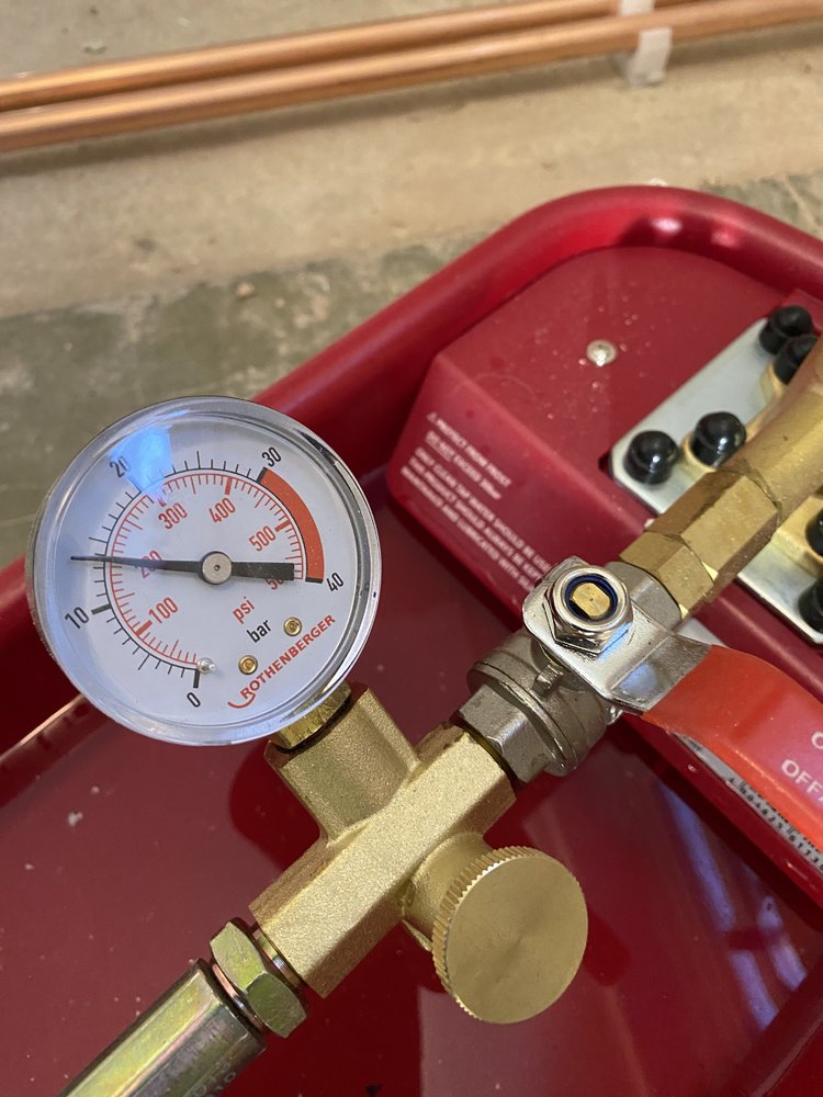

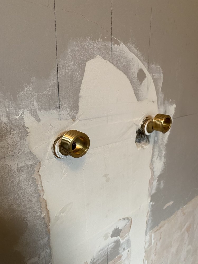

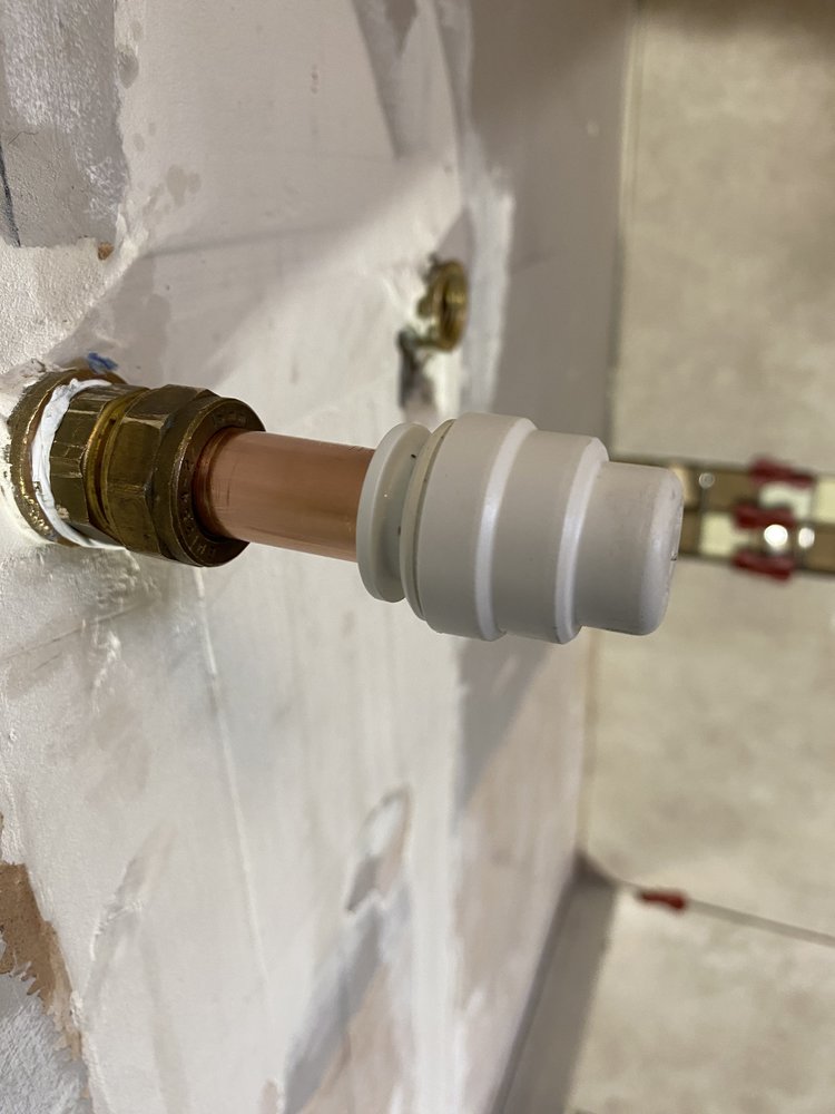

I’ve just pressure tested an installation and I’m getting a slight weep from a joint between the cranked threaded connection for the shower and the bib tap back plate I’ve used to form the connection. It’s got ptfe etc and I’ve made it off a couple of times and it still weeps. Any bright ideas?
) and use sealing washers on the mating faces and a decent (Loctite…) pipe sealant on the threads….
