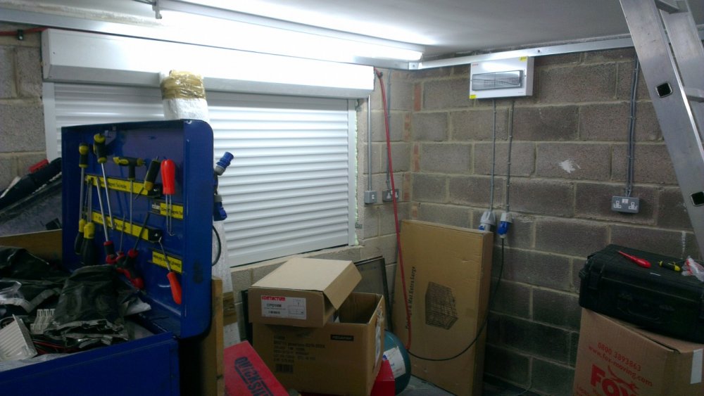

a 16 amp c type for the 16 amp socket and up to a 20 amp preferably a b type for your 13 amp socketsAhh great thank you very much. Thanks to all who have sent replies, just need to know what amperage of MCB I need to look for supplying the 16 & 13a sockets now.
Electrics are pretty much all done now, just finishing the alarm and data stuff (inc CCTV), so should have it all complete and tidy by the weekend!
