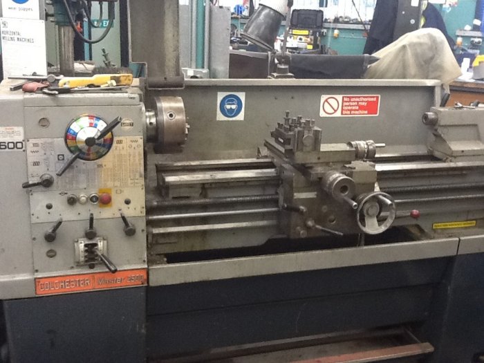

Blimey, I am a little embarrassed to post a picture of my little amdeal mini lathe!!
I am very much a newbie to using a lathe but it does all the little jobs I want to do like motorcycle parts which look nice and seem to fit just fine!!!
It also fits on my workbench just fine!!

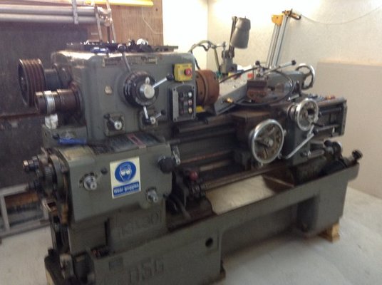

Small lathes are perfectly fine, and they don't take up shedloads of space. There's no point in having something large if you'll never need the capacity. I've been using a 3-1/2" for everything I need, upto just.How much did you pay for that one??this is my 5" Raglan lathe

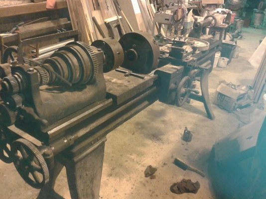

not really done anything with it at the moment, but the plan is to give it a strip down clean and repaint. I've just made some feet for it so its sat least sat level on the floor now rather than rocking back and forth as it had done previoulsy

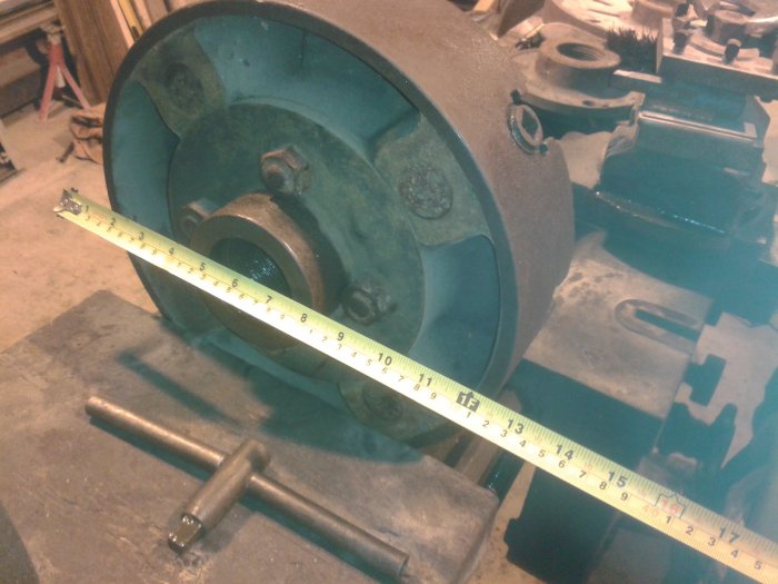

I carn't claim as mine as there works but never mindView attachment 27557
