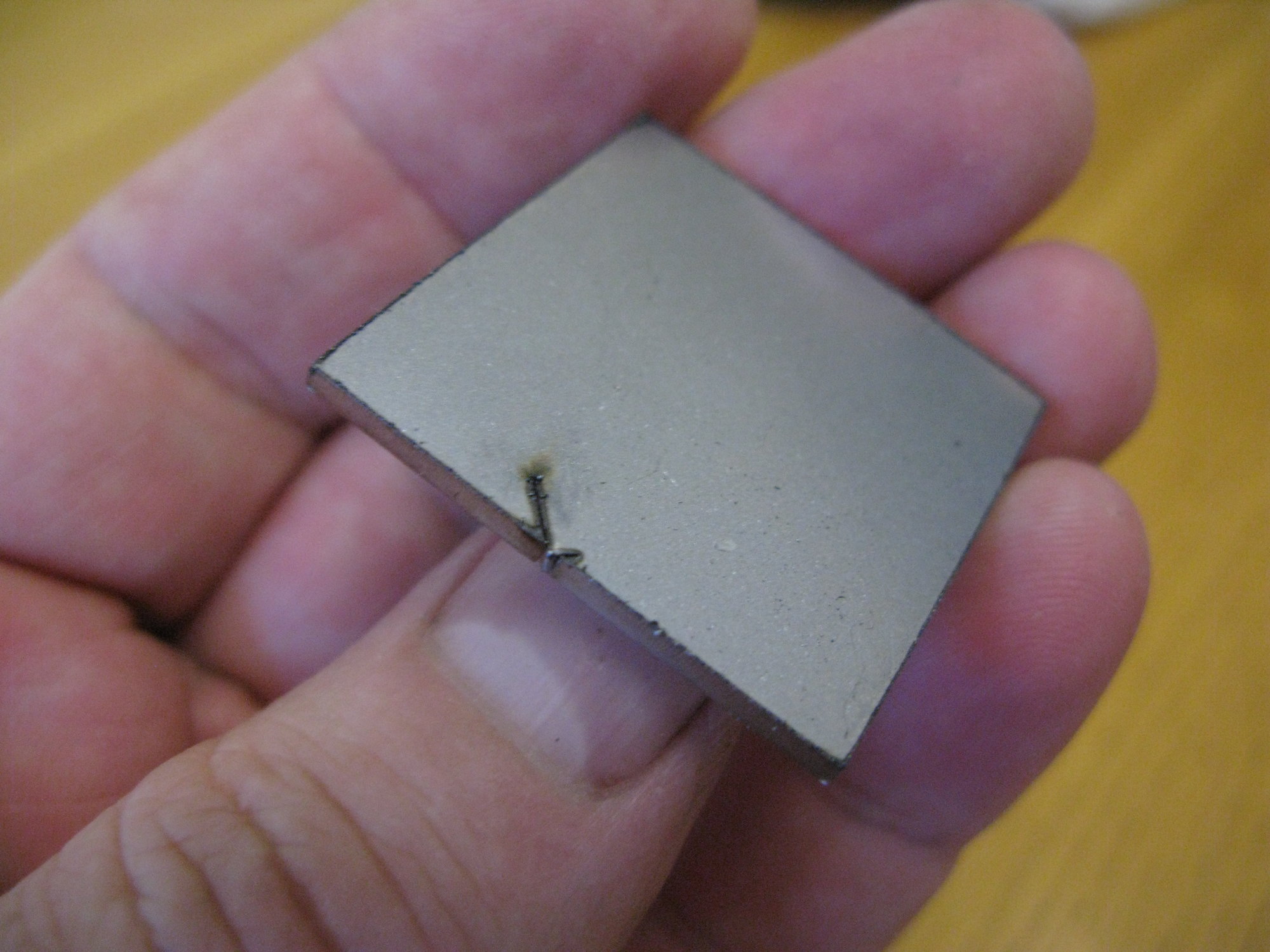

I know it’s just a mess about mate but alway use filler if your welding on steel.I know this thread has been running a while so to restart it it here is a tig fusion weld mild steel plate to bright drawn bar @ 100 amps done by a amiter
You still need to use filler, steel will crack when fused without, you need the deoxidisers in the filler, even if it's just a little dab with some thin fillerHi Richard. I had no reason to use filler as all I wanted was a very fine weld to hold the pieces together as it's part of a slide nothing that's going to to be under any particular stress![]()
Hi mate.Well i have done it now from searches done before hand there is arguments for and agains on metolagy grounds i know application dependant of course
Hi mate.
I haven’t seen any metallurgical arguments going for the welding of steel without filler other than the fact it’s cheaper and easier.
The filler contains deoxidising agents which purify the liquid pool from oxides.
You might find it does what it’s supposed to and holds out but the joint will be compromised
It’s likely it contains porosity from the lack of deoxidising achieved from the filler. This can quite easily crack and in your case even more likely because of the thickness involved meaning fusion will be lacking and thickness is weight so it’s under some force.
I’m not trying to diss what you’ve done but to save you the costly mistake of assuming it’s a sound weld and applying the same technique to something more critical. It’s always my advice if your tig welding steel to use a suitable filler material.
On steel that gage in your pic whether it holds or not I’m struggling to understand why you didn’t use filler.
