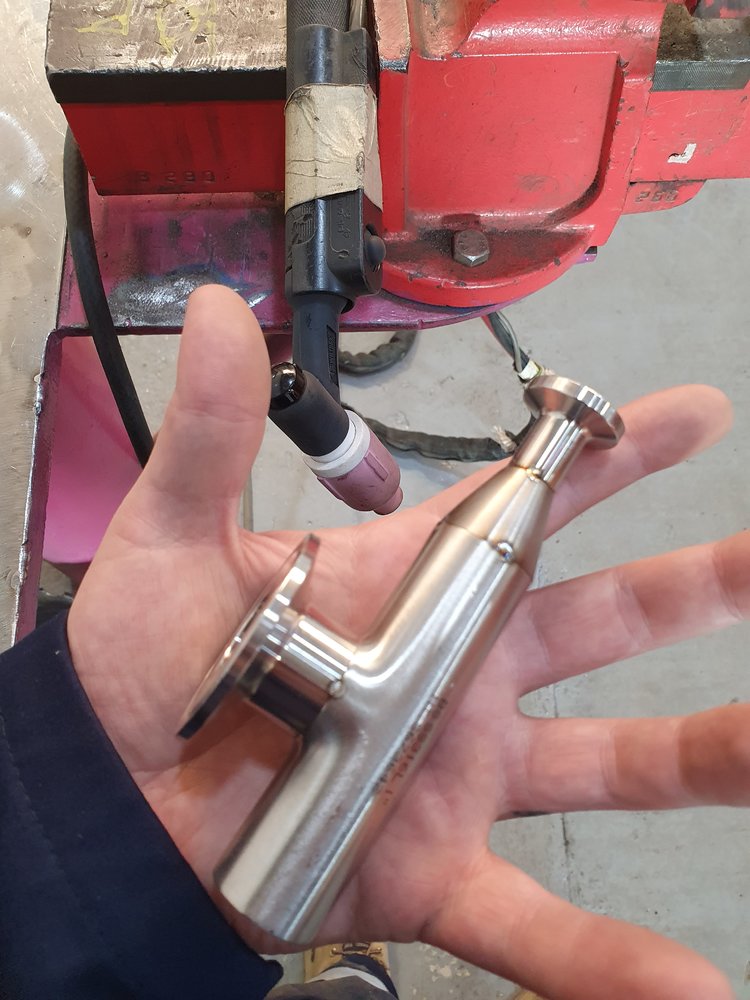

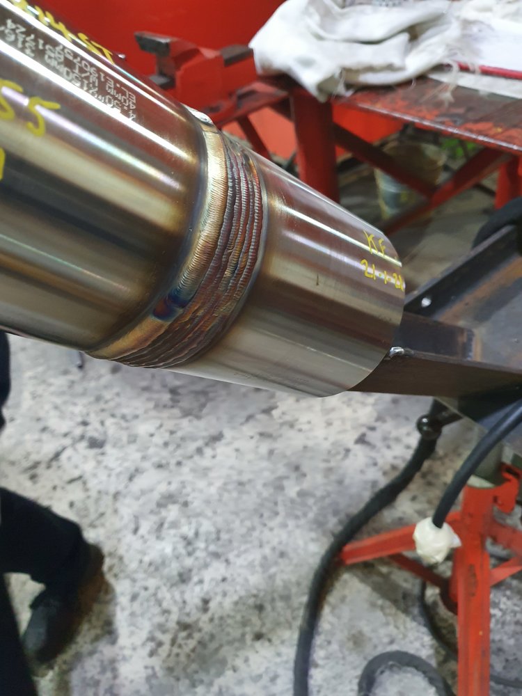

Then at a later date, only a couple of weeks ago actually, fiddly little bits like this lol
serious bit of pipe there , nice job .. the wee fiddly bits will look tasty done though .What is it going to be , if your allowed to say.Then at a later date, only a couple of weeks ago actually, fiddly little bits like this lol

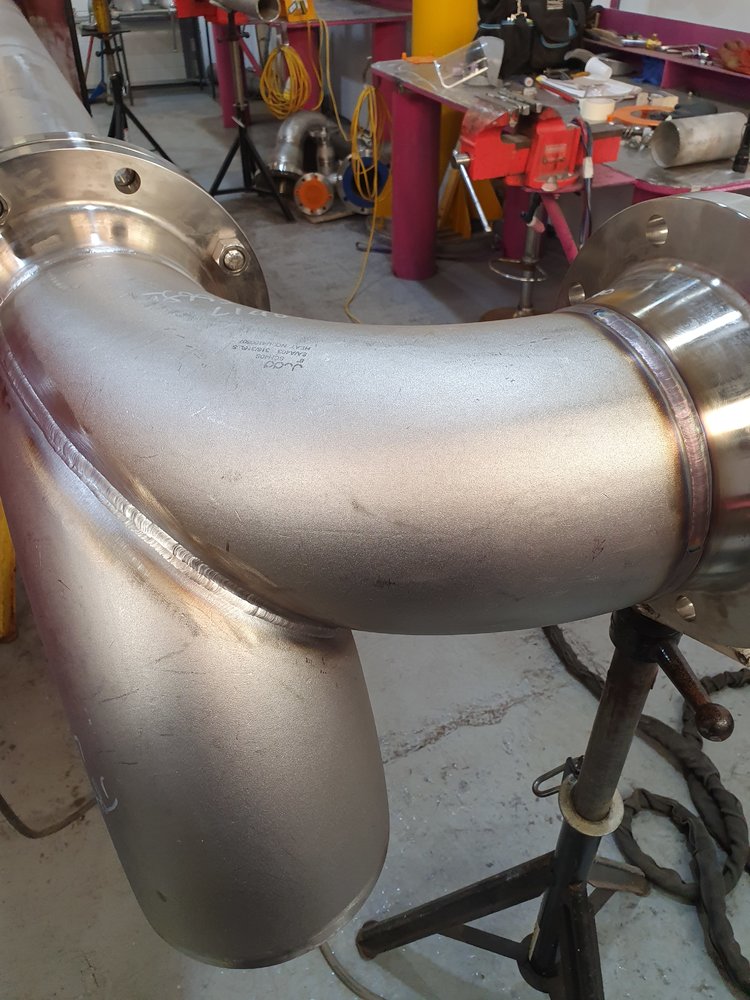

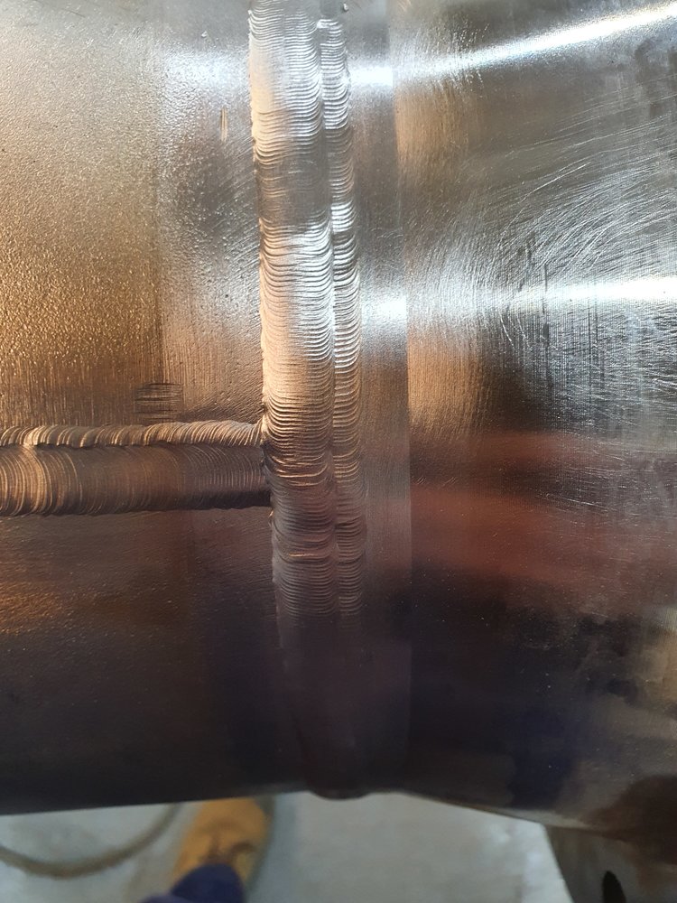

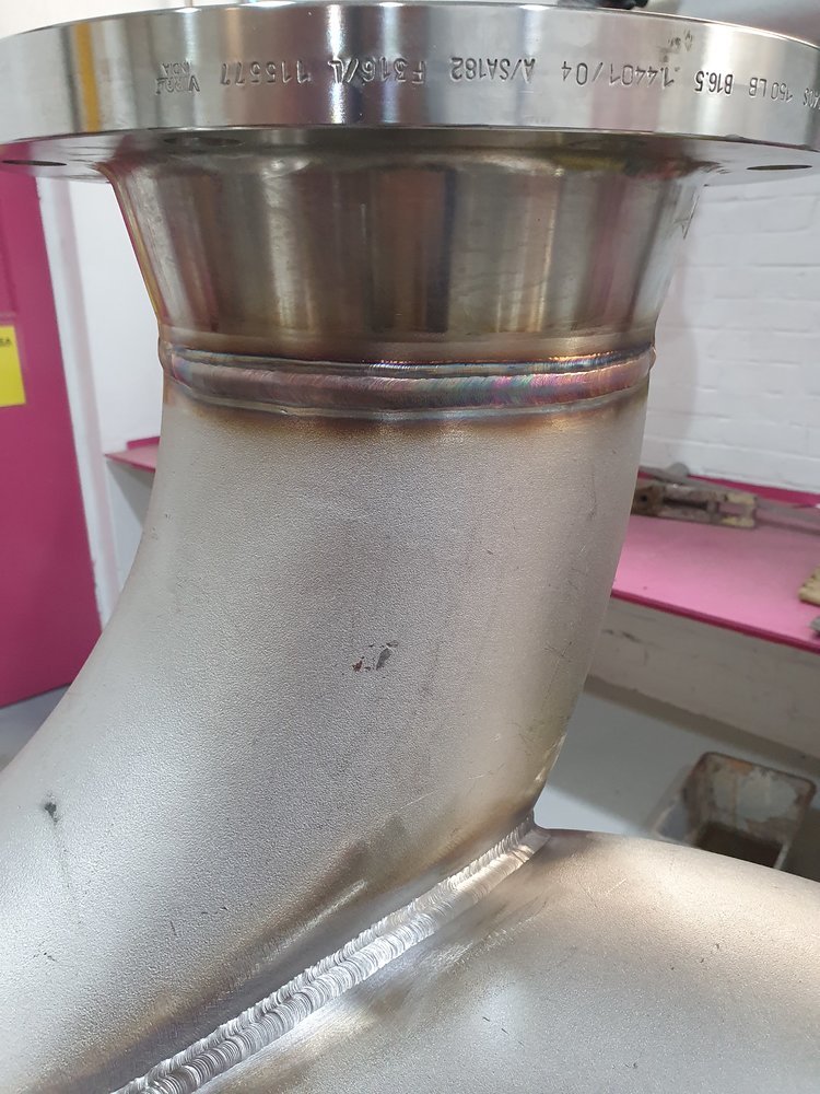

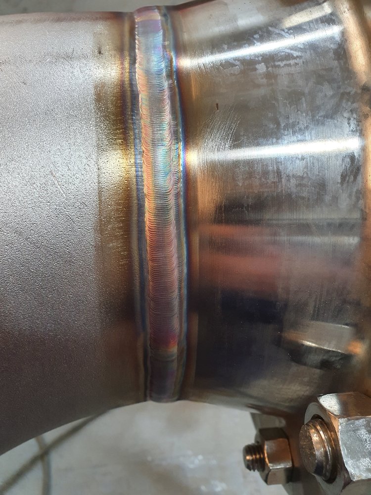

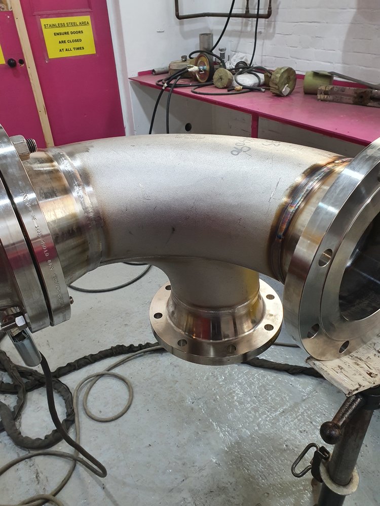

The little spool? Its part of a stainless system for a chemical plant thats all, shampoo, detergents, washing powders and that sort of thing. The job had a few dairy gauge spools like the little one along with a few 4" sched 40, but mostly 8" sched 40 like this double elbow 2 into 1 spool. Around 100 butts and maybe 20 slip-ons in all and was subject to 100% NDT, Dye pen for the slipons and all the butts were bombed.View attachment 298212View attachment 298213View attachment 298214
One flange capped...View attachment 298216
And the point where the butt between the elbows meets the cap around the bottom flange
Some of it was a proper PITA for the fitters when it came to marking out and cutting cutting it. The trouser legs for one, but also had a couple of spools with a 2" pipe passing through an elbow and then running centrally inside the 8". Not my area of expertise at all though, i just do the tacking and welding part lol

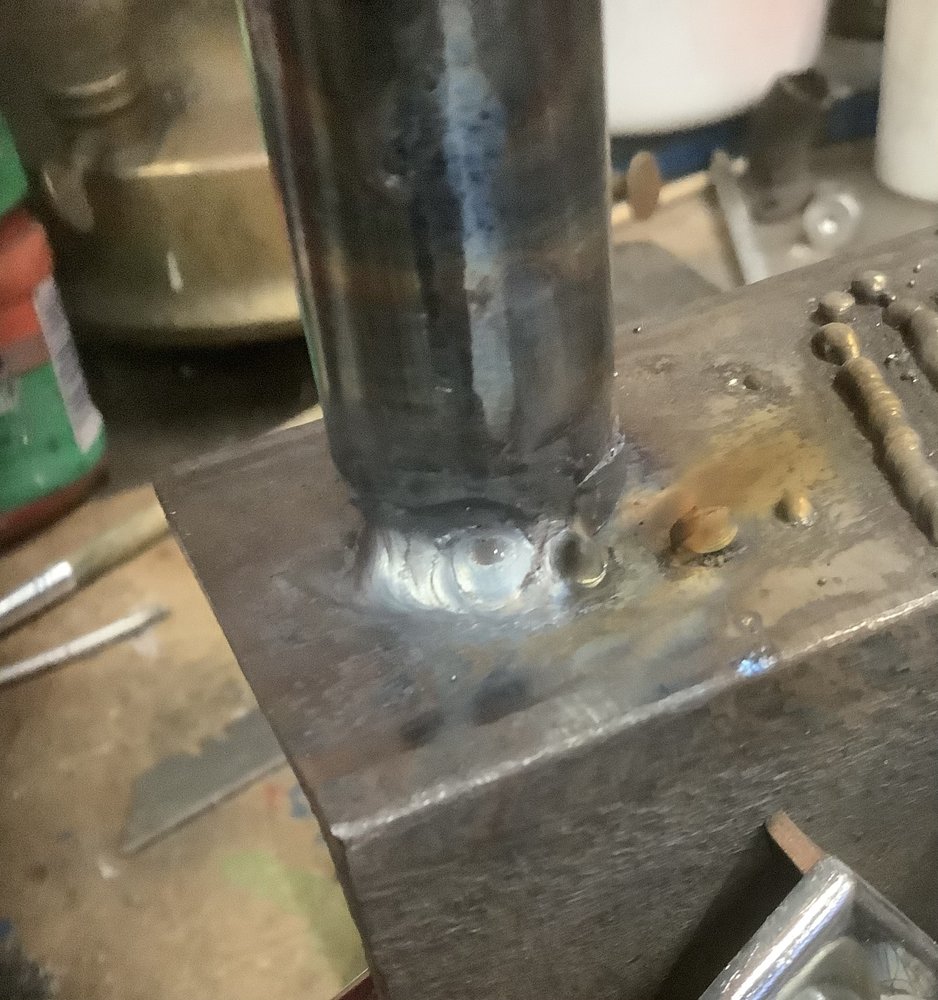

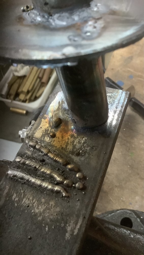

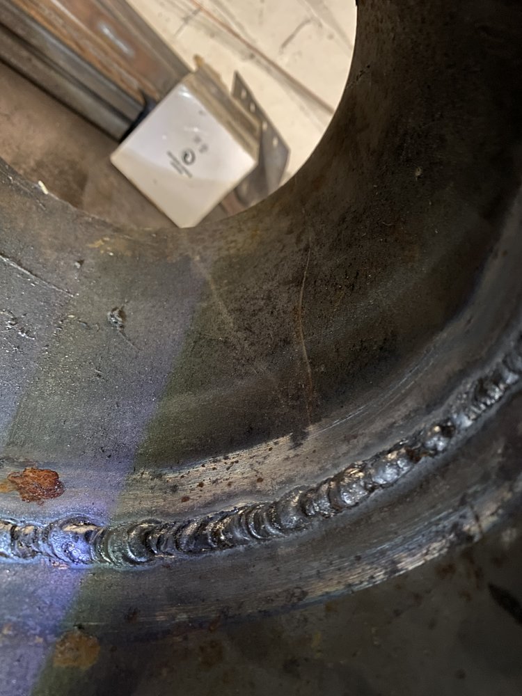

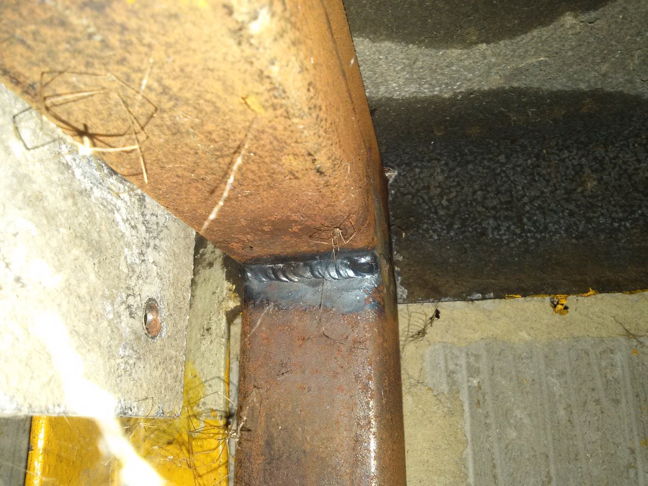

The legs weren't rusty when I done it. The bench itself is galvi, hence why I never stitched it upwards. Used to be a walking platform/gantry on the back of a low loader. Stand on it and stick Road cones out while the vans moving. Had a bit of box section kicking around give it some legs and made a bench out of it.is that from the latest boat
the TIGTANIC

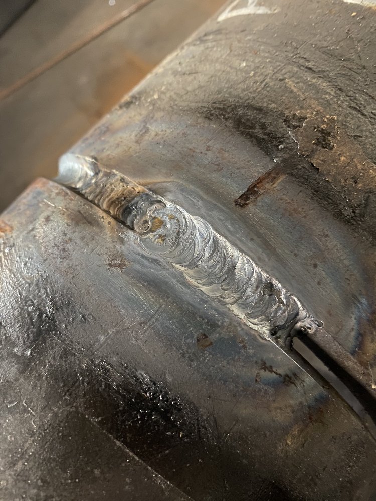

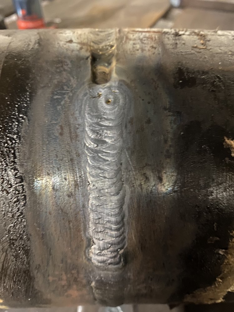

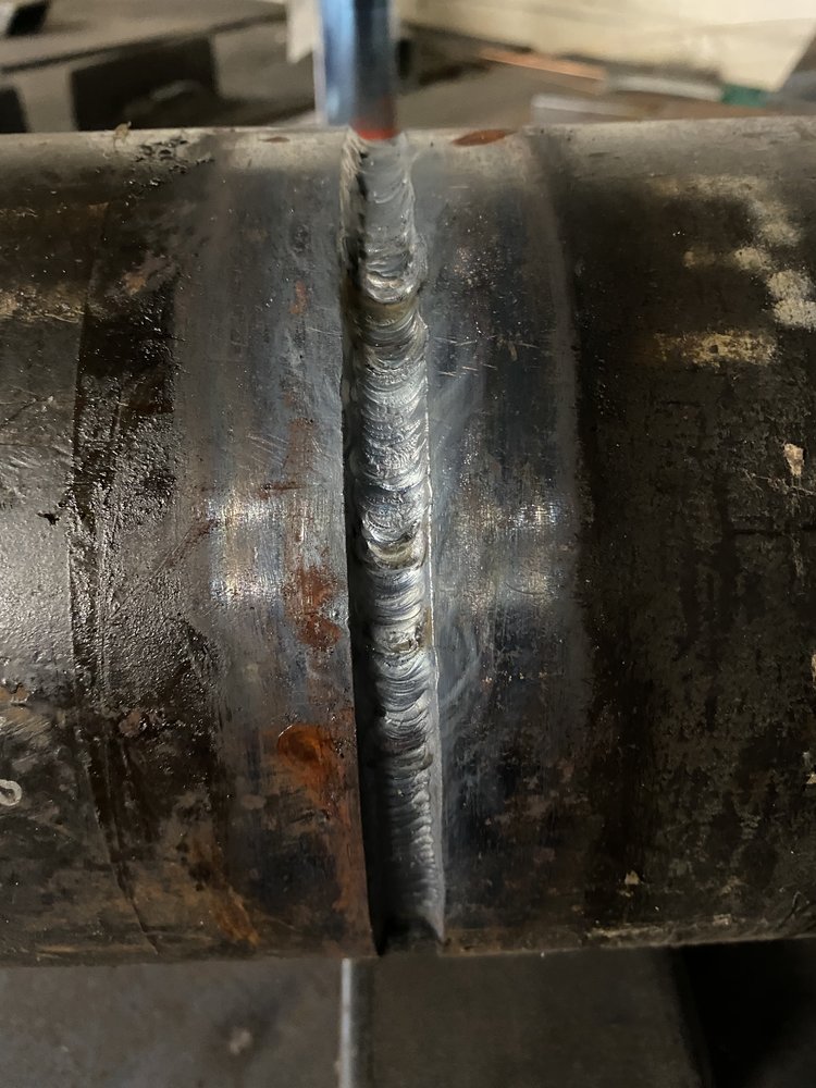

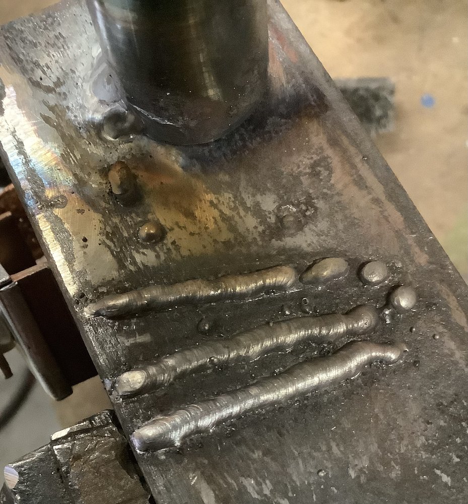

bring your fill pass/passes to just under the flush you may need additional fill over the top keep the cap tight just enough to cover the edges , multipass cap may be required eg 2 runs check procedureBit more practice freehand tig ,130A any feedback off any tig welders welcome (i know its no good but we all start somwhere)
Personally i would practice straight stringer runs until you can get them neat, that will help you with your heat/puddle control. And remember, weaving is not always permitted.Bit more practice freehand tig ,130A any feedback off any tig welders welcome (i know its no good but we all start somwhere)
i hate stick welding, it's like welding having one of your arms cut off. unless its half inch thick i wouldn't touch a stick welder with a barge pole.Oh, I just realised, those straight runs above, were stick weld with a 1/16 rod…not Tig! Oops…and sorry for the pigeon poop at the start…..it’s bin a while since I did any stick welding…
