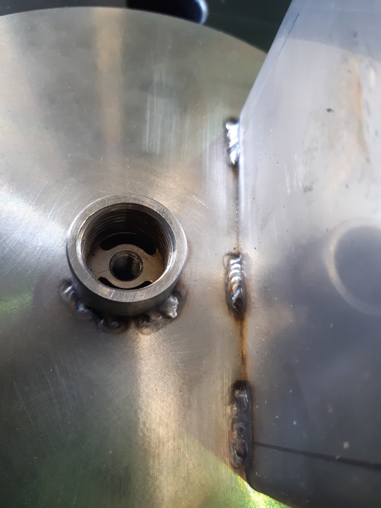

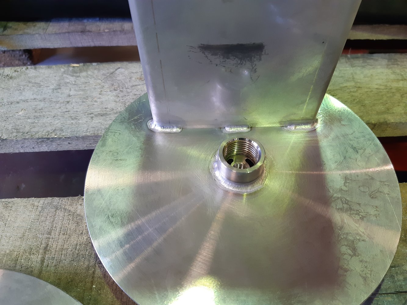

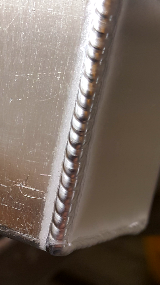

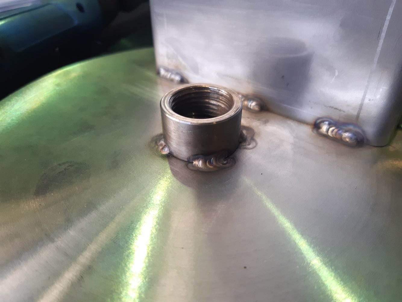

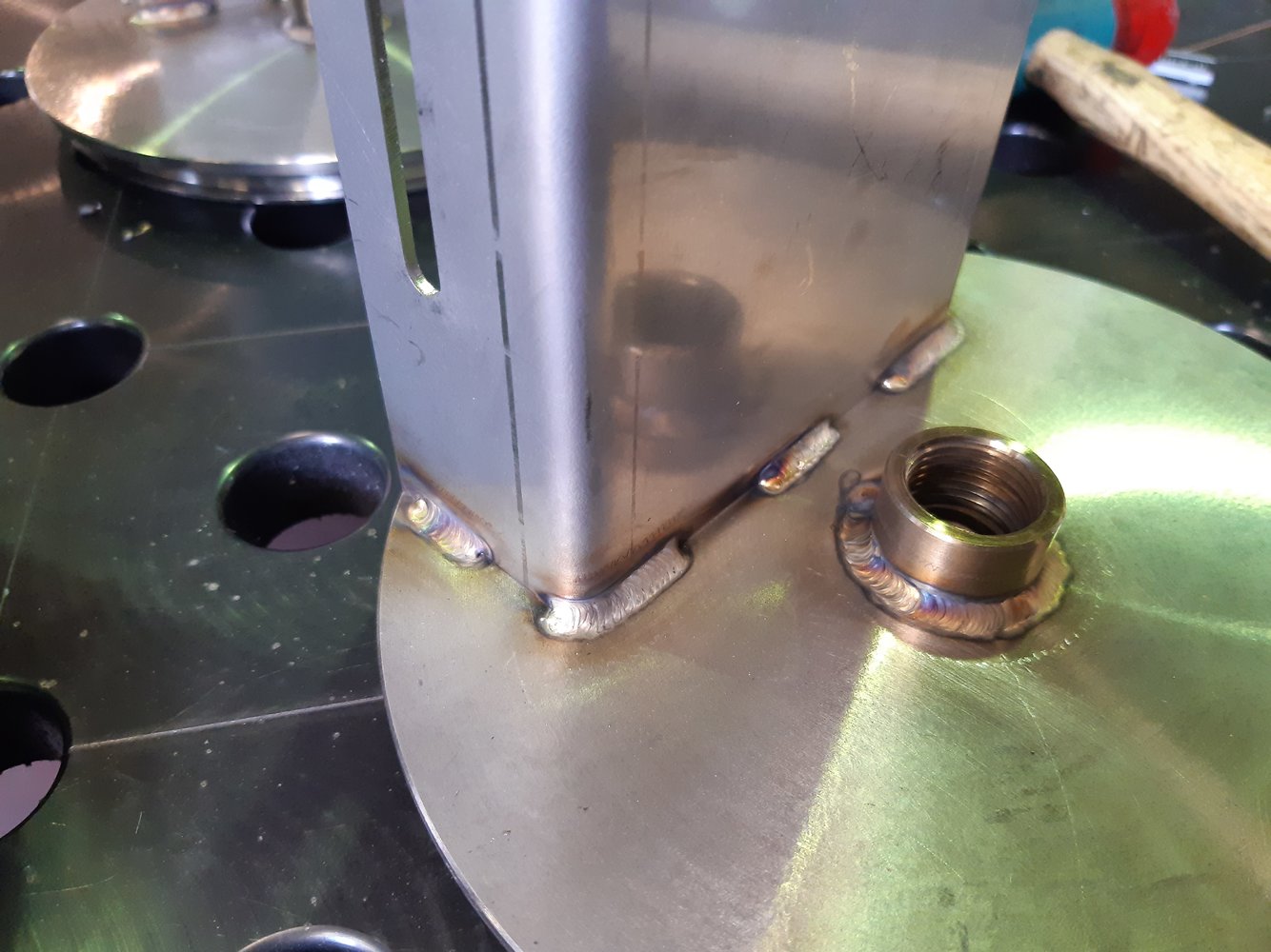

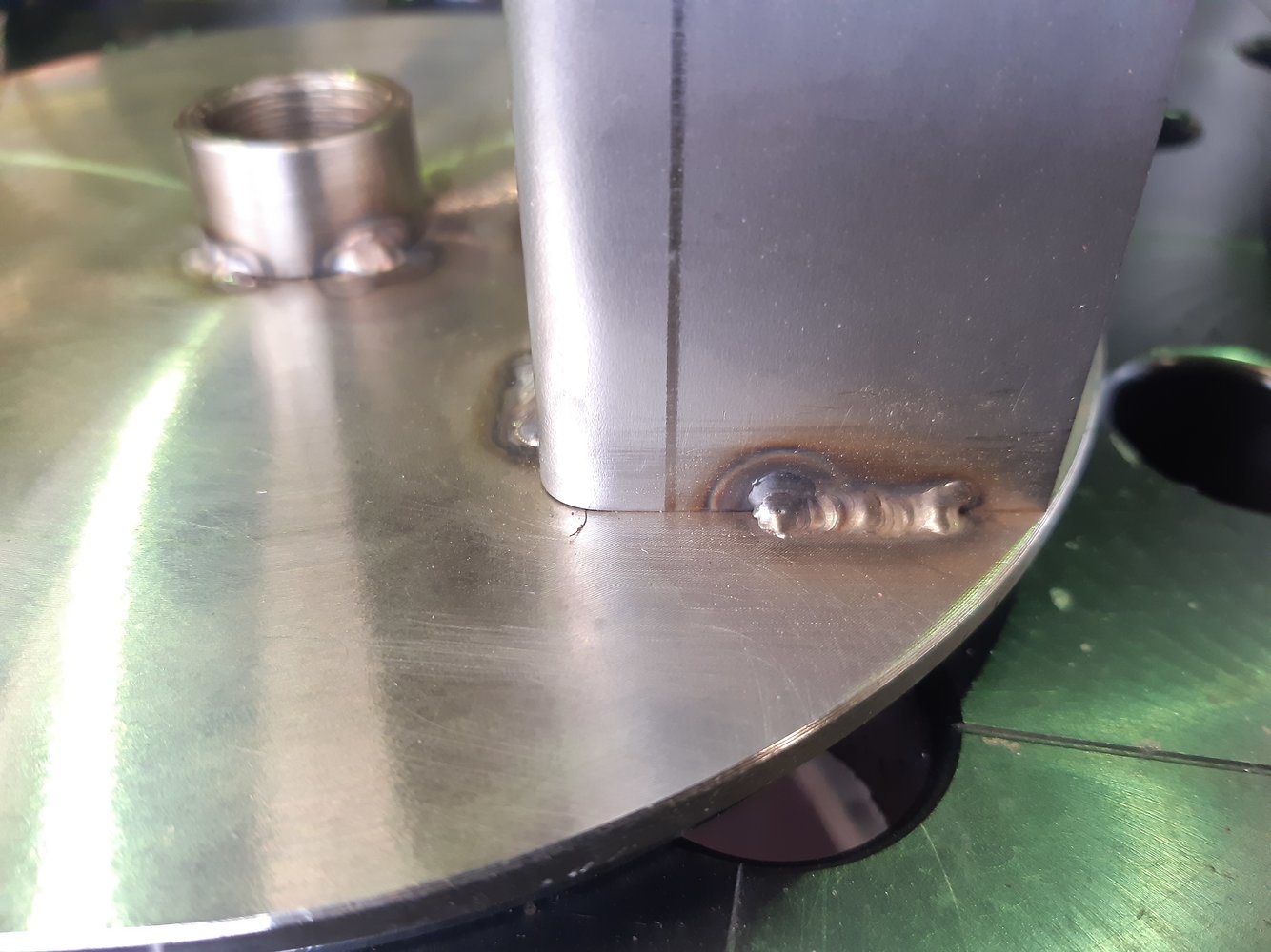

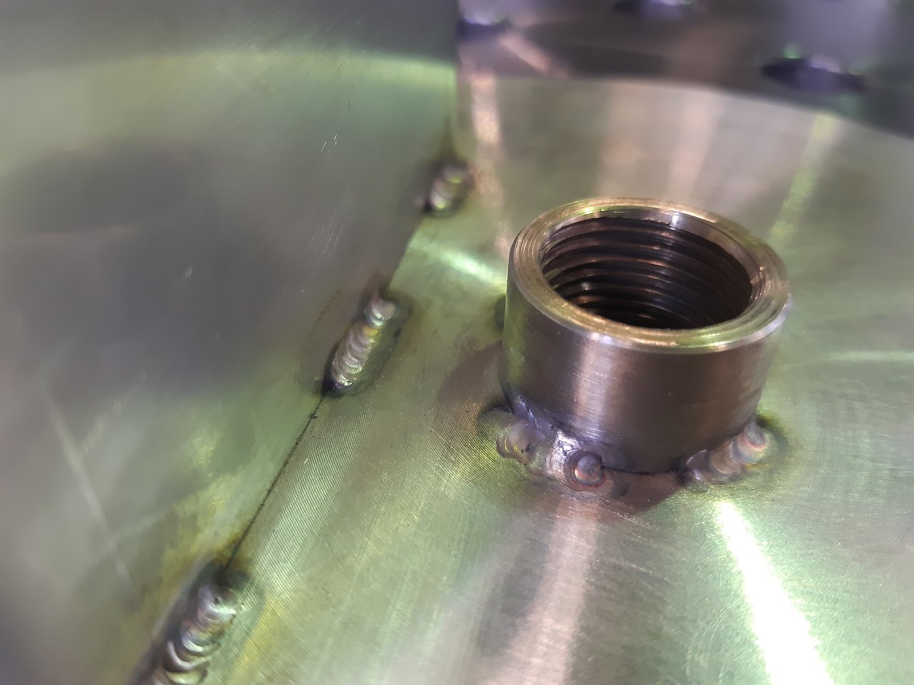

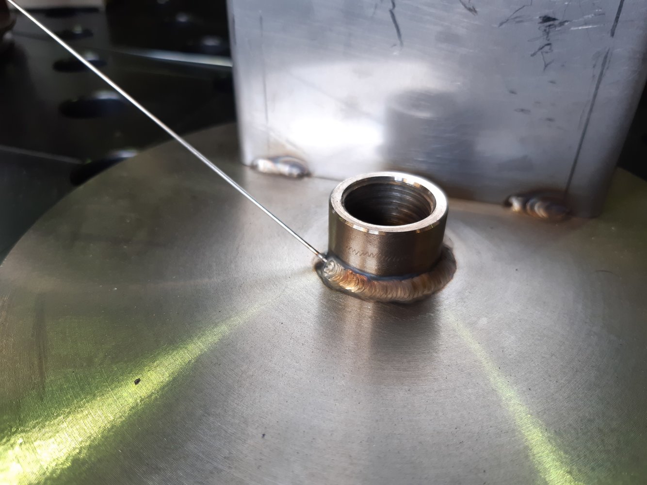

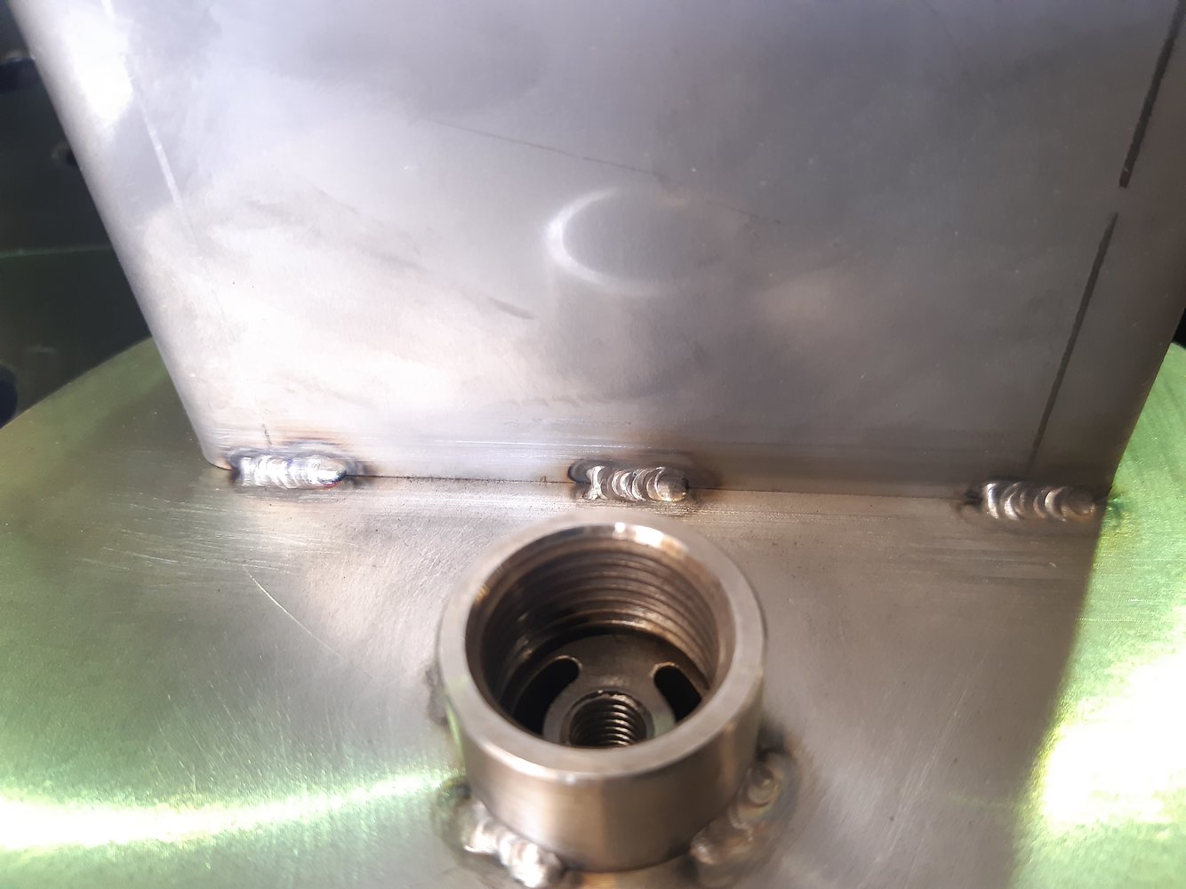

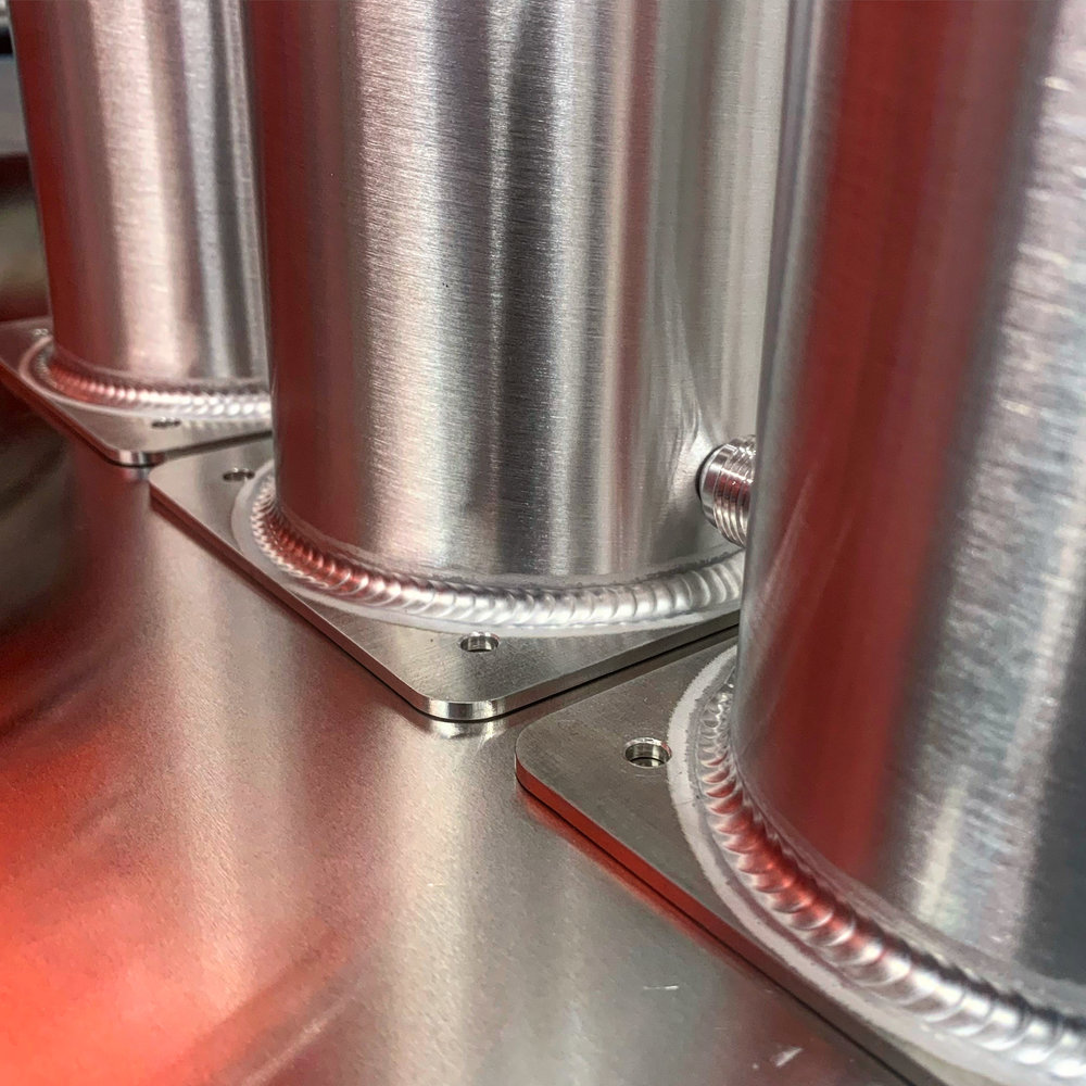

200Hz
Balance around 70-75% (older fronius machine balance is a range from -5 to +5, dont know why, personally I hate it. But I have it set on -1.5 which is somewhere between 70-75% EN
Standard no5 cup
No pulse
5356 filler rod
Base material is 5251, cylinder is 1050

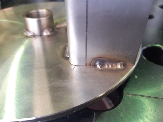

Standard no5 cup
No pulse
5356 filler rod
