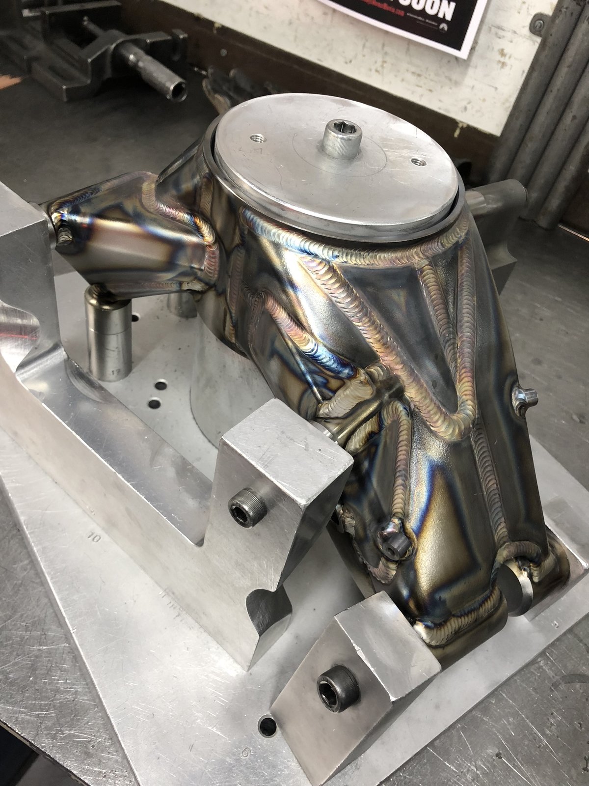

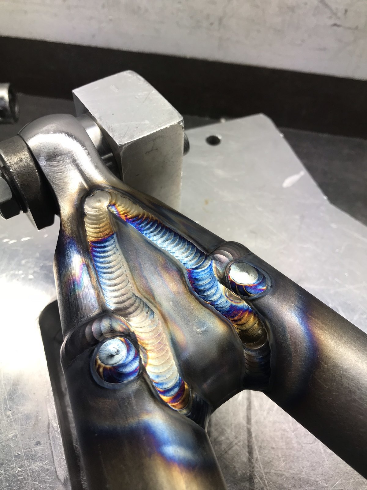

View attachment 164928 View attachment 164929

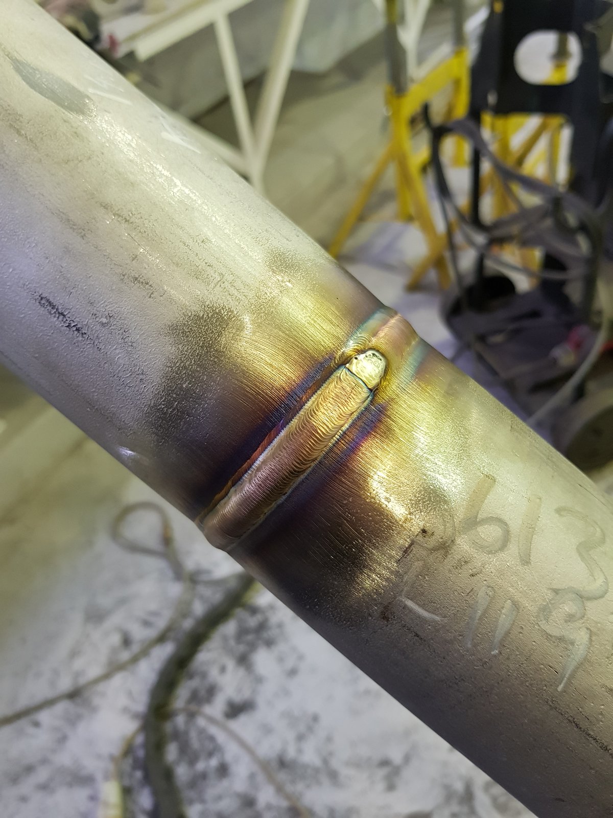

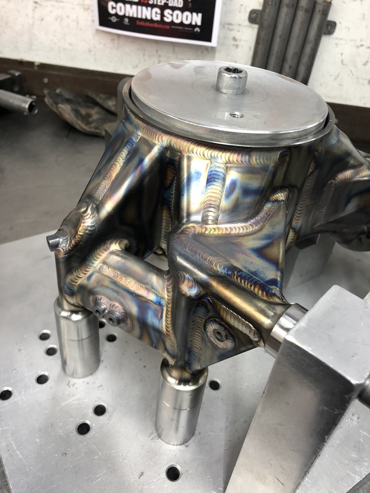

316 Stainless prolongation test this week, done on 3" sched 80.
10l/min purge, 3.2mm root gap no landing. 1.6mm wire 80amps freehand. Size 5 ceramic.
Filled freehand with 2.4wire both passes,
Cap passes were walked with 90amps, size 8 ceramic and 2.4mm wire.
Was fixed position 6g, as was a code prolongation test. I find it easier doing it on butts than fillets tbh when it comes to capping passes. Easy enough, just dont put too much pressure through the torch or itll just slip off.
Rooting and filling though i prefer to do it freehand. Feels like have better control, especially welding roots.
nice but why did you do the upper pass first on the far side ? we would normaly do the bottom run first then the top one or is it just a bit over fill that you going to wash in
I was wondering the same thing zep.
That doesn’t look a fixed position joint to me either as the stop meets the **** end of the start.
Lovely looking joint and the internal penetration is bang on but I’d expect to see the two stop points kissing
Was a straighter line to follow on the upper pass so i could keep it straighter. When i filled it, came up almost flush on the lower side when was filled, and thought would have struggled to keep it in a straight line. I know it wasnt done strictly correctly but was ok and passed testing anyway, so still jave a job lol

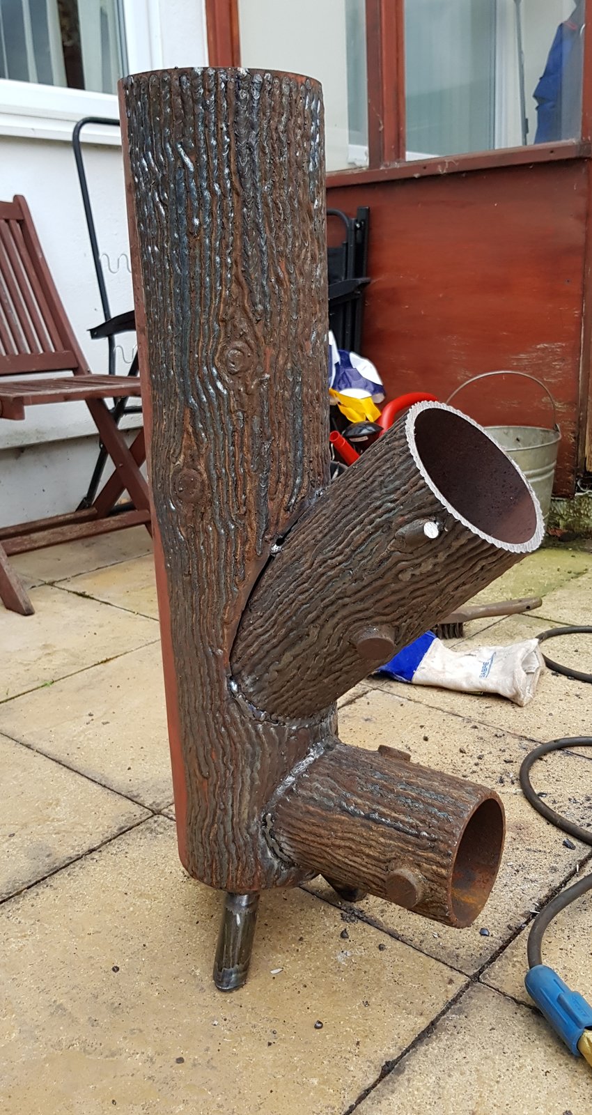

One pic i have got of something i was mucking about with a while ago though was this one. Cant remember if i posted it on here, might have done? Had a go at making a wood burner for the back garden out of some offcuts at work. Never got around to finishing it off though. Might do at some point though.
Forgive the whopping big gaps around the two branches though, marking out and cutting angled branches in pipes isnt my strong suit as can be seen lolView attachment 165128
Liquid metal, That tree effect looks spot on, superb!
I’ll second that. The bark effect you’ve got going on with the knots looks really brilliantRealised quite quickly at the time, it wasnt the easiest thing to do to run welds all over the place like that, not after spending 15yrs trying to stay in a straight line lol.
