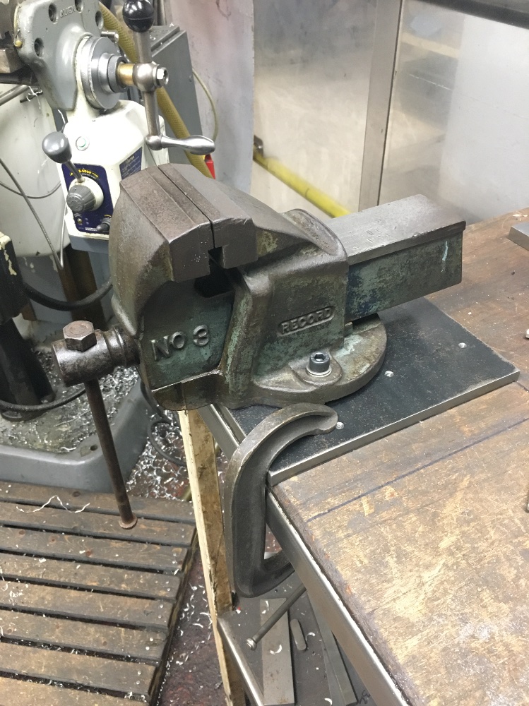

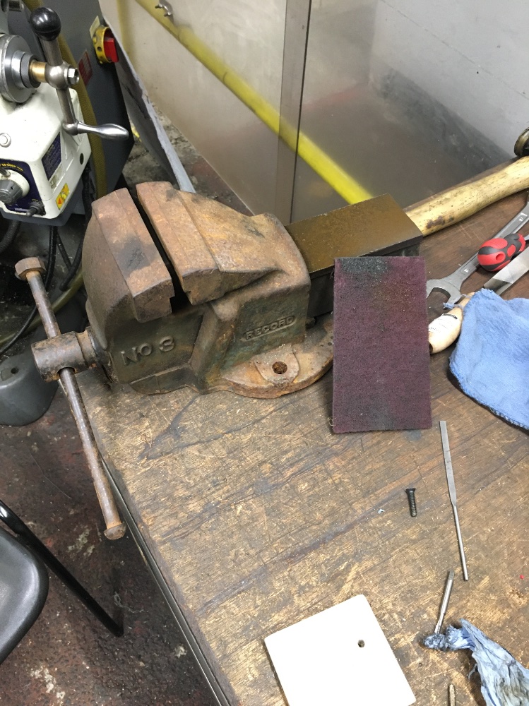

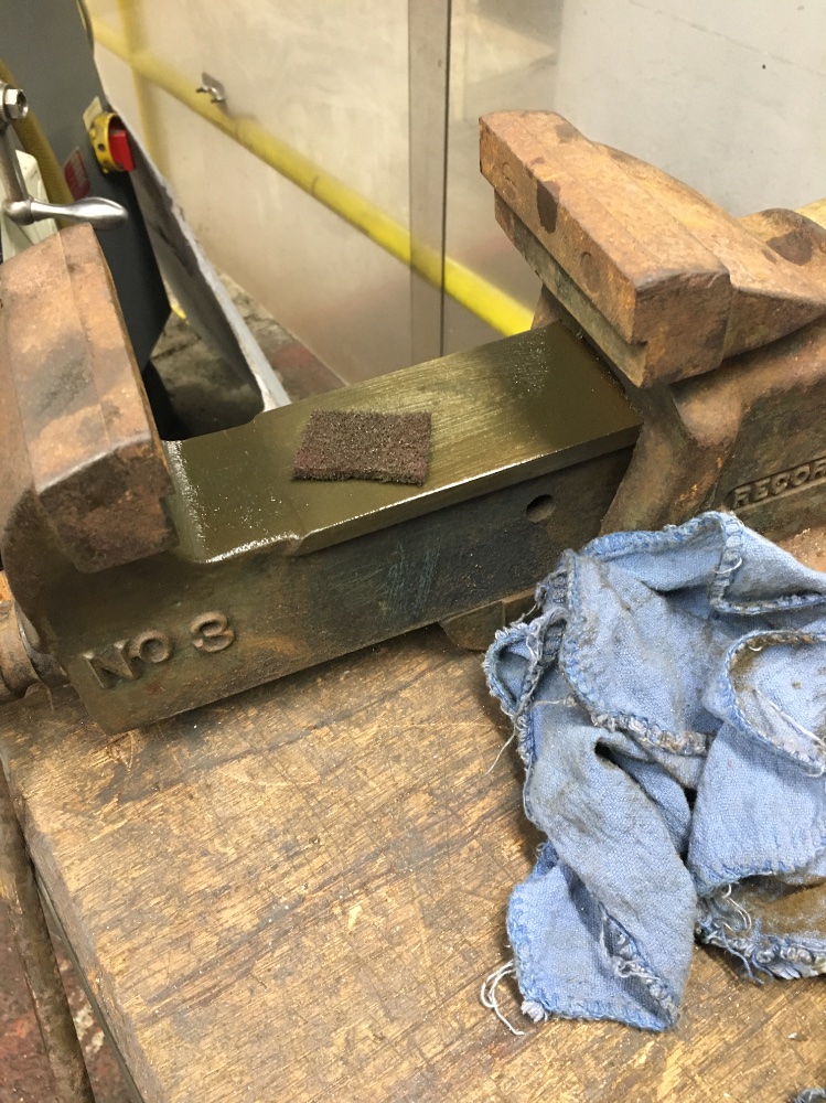

Citric acid wont touch the paint.
That's a blow!Citric acid wont touch the paint.
I'll be getting the Nitromors out then.Caustic soda will rid you of the paint.That's a blow!I'll be getting the Nitromors out then.
Do you think this is best done before or after rust removal?
Nitromors won't remove the paint either. Not unless it's a stash of the old formula. I'd just use a wire brush on an angle grinder. It will remove crud, rust and paint in one go.That's a blow!I'll be getting the Nitromors out then.
Can you share the method?Caustic soda will rid you of the paint.
One kevel table spoon per pint.Any suggestion as to dilution? As in, gms/litre etc?

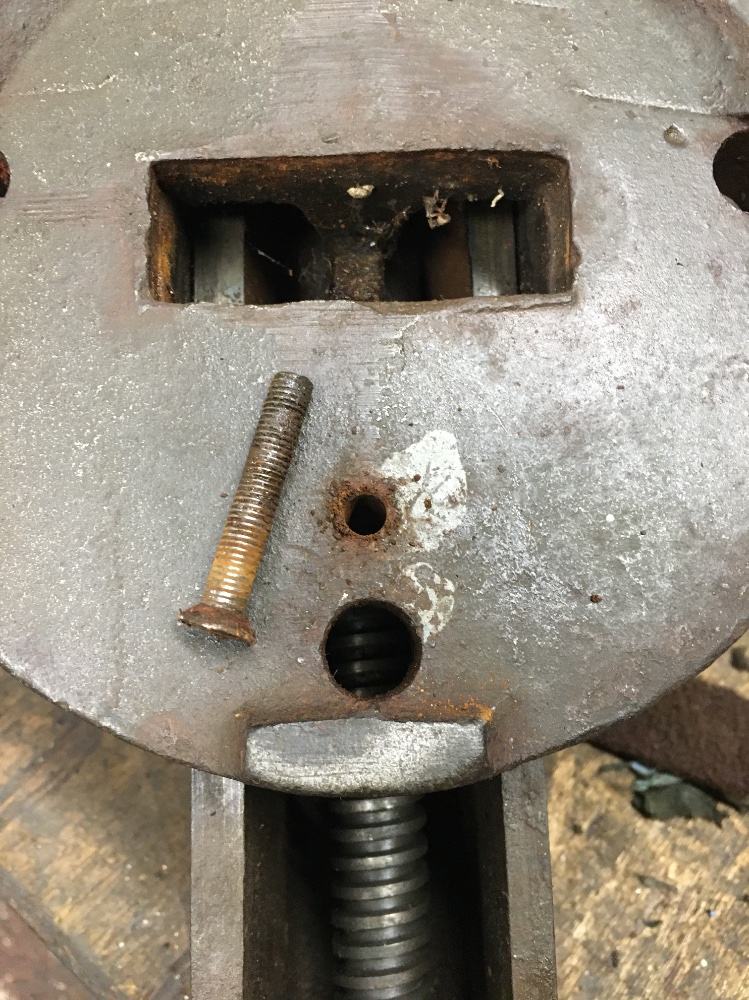

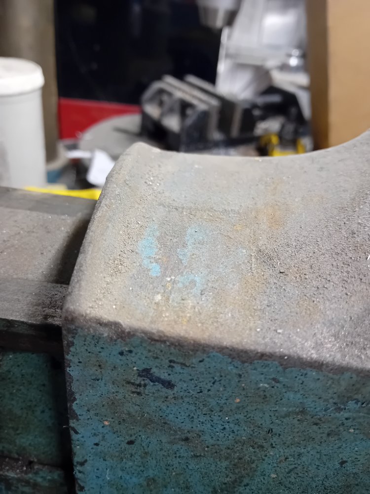

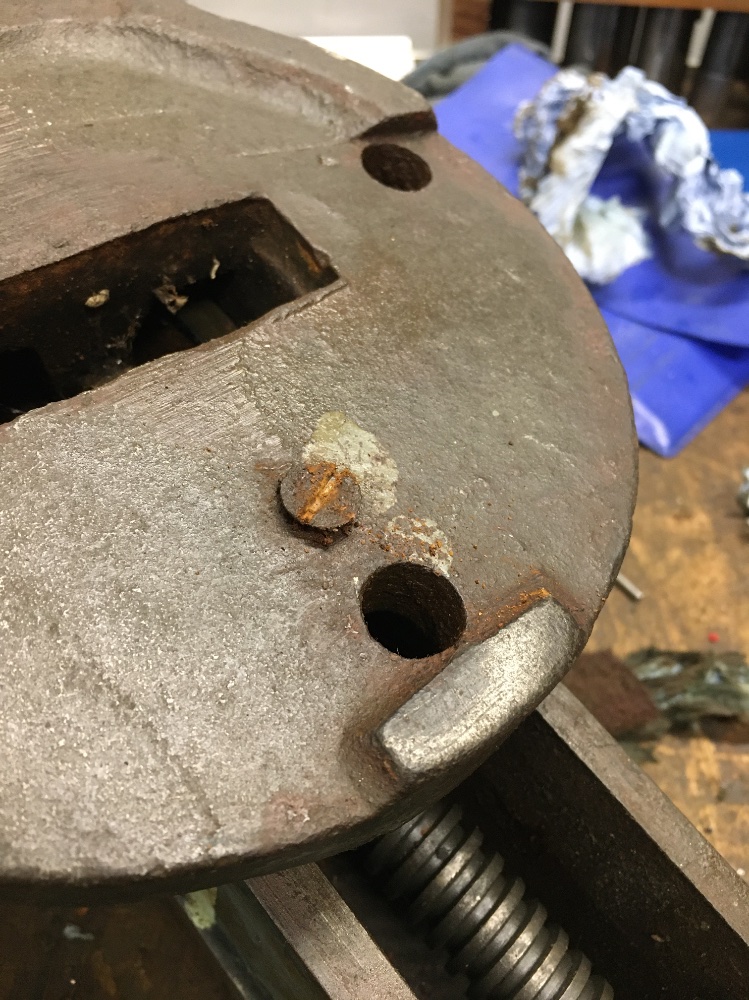

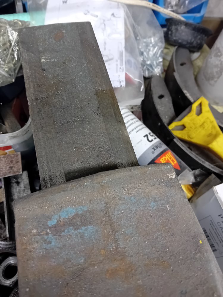

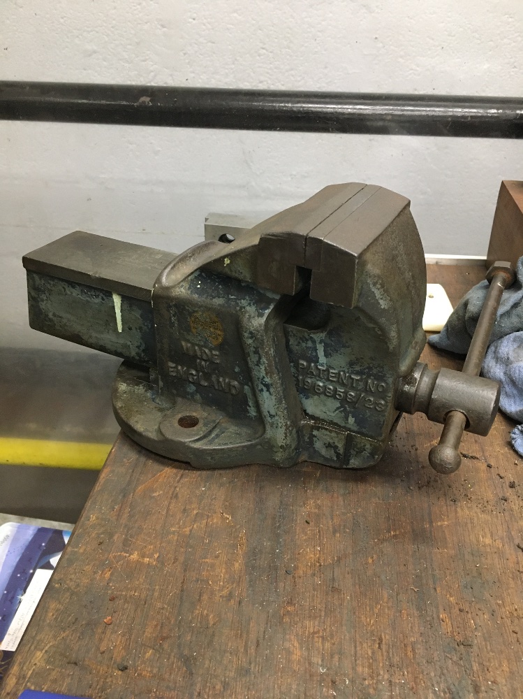

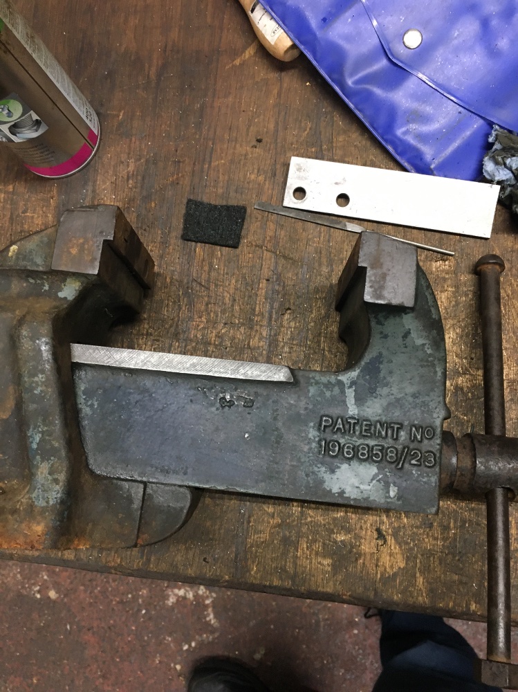

id not do that your making the metal part there thiner so if you lever towards yourself more easy for it to breakThe 'anvil' part of my Record 23 has a lip at the rear. Is this normal? Anything wrong with grinding it off?
View attachment 514325View attachment 514326
Is this normal?
