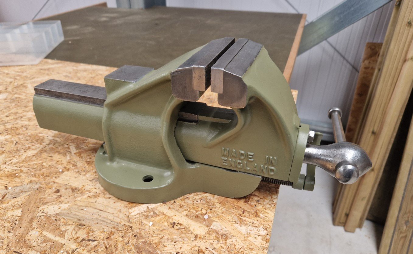

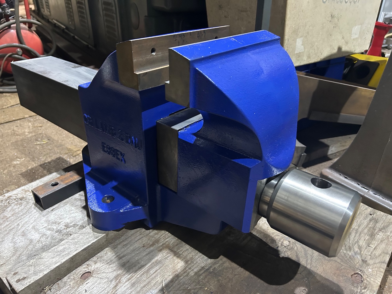

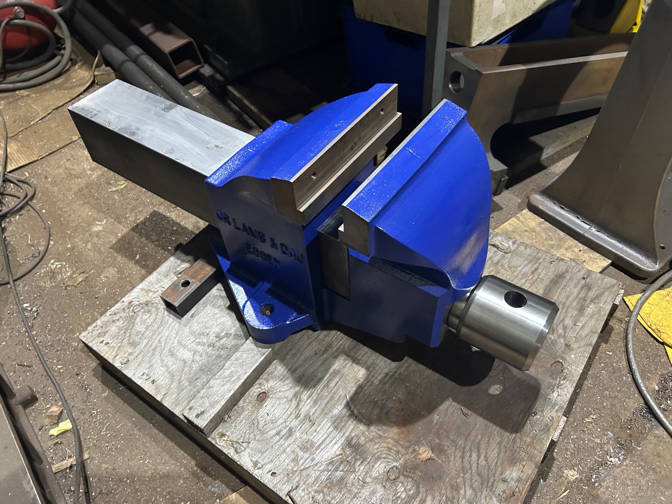

Nice ! The green is more appealing to me than blue. Good job, well done.OK, so a vice, and a question.
I really like the Record "Engineers" vices, the fixed and sliding parts have a lovely shape to them and give you more space under the jaws. Here's my current one, recently refurbed :
Forgive the very non-Record green, you can kind of see it's going into a barn workshop and I wanted a softer colour. hence this one. I think it shows off the bare metal parts nicely though.
Thanks ! I really like Paragon Paints, use them for all the machinery I do. The vice is RAL 6013 Reed Green, darkened with a tiny bit of black - they have a range of finishes from Gloss (very very shiny) to Matt, this is Silk which is in the middle.Nice ! The green is more appealing to me than blue. Good job, well done.
What paint were you using ?
Bottom been cut off?
Nope.Bottom been cut off?

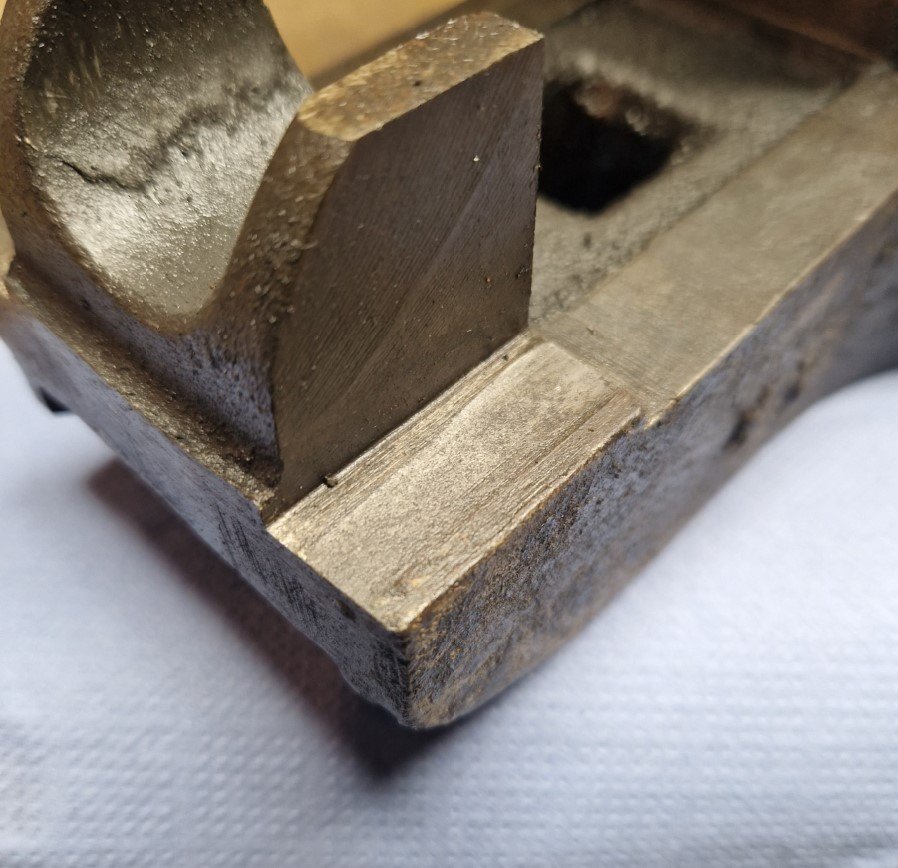

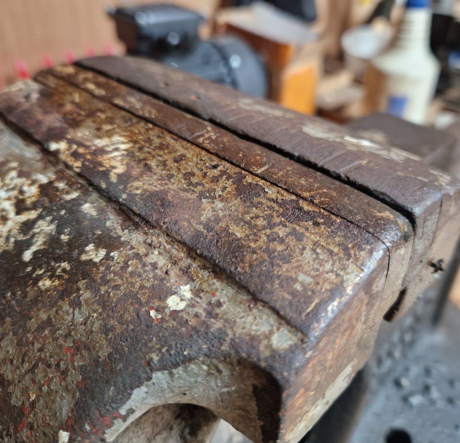

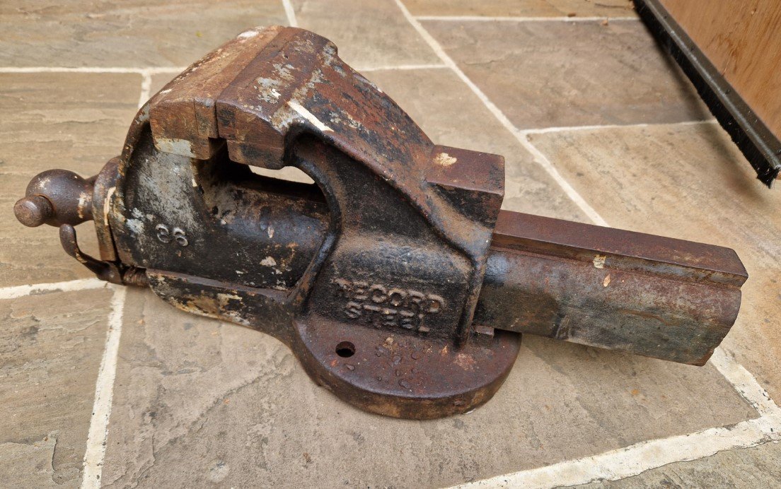

So the next one in line is this puppy, a 36, in quite a state but it will be fun trying to sort it out : steel one, this time.
In particular, the pads which the moving jaws slide on are quite worn, which means that the moving jaw sits slightly lower and the jaws don't align when they come together :
View attachment 509665View attachment 509666
I would really like to fix this. I got lucky on the first vice, above, because although it's pretty old it had only been lightly used with hardly any wear, but this one has obviously done its share of hard work, possibly without being properly oiled/greased.
I had thought, it should be possible to clean the pads up and deposit some weld metal on them and then mill them back to the original height, using the jaw cutout as a level datum. Has anyone done anything like this ? It would be a satisfying thing to fix, might seem like overkill but also a good learning exercise. Or flattening them and putting some shims in, but that seems like cheating and I'm not sure how you'd hold the shims in place given these pads take a lot of pressure when the jaws clamp up.
Thoughts appreciated ! Thanks.

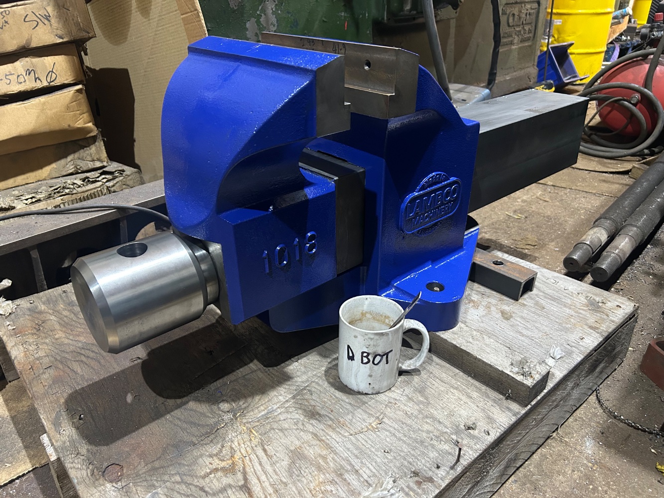

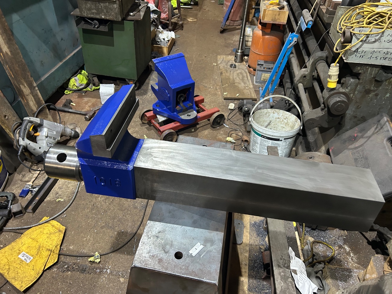

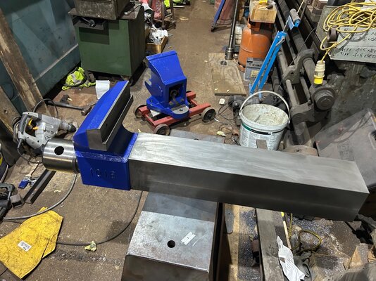

Please tell me that's a small mug......10-18 finished
Most definitely full sized!Please tell me that's a small mug......
But it's more than welcome to take the remaining paint off! Unless I should be paint stripping first?
