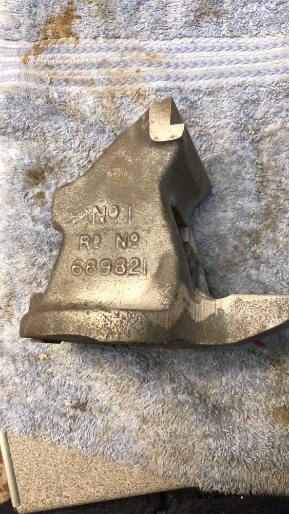

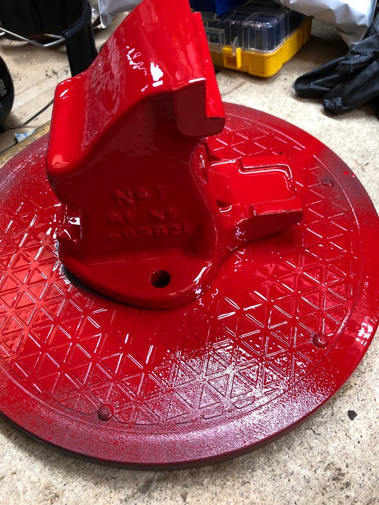

Yip it’s all complete, that one I won’t paint a funky colourWere you able to get the base plate unit for the Auto-Vice ?
What colour do you go for on that? Sticking to original or just a close one? I've recently refurbished a Parkinson Handy Vice no1 and used Cherry Red Gloss from Paragon.Yip it’s all complete, that one I won’t paint a funky colour

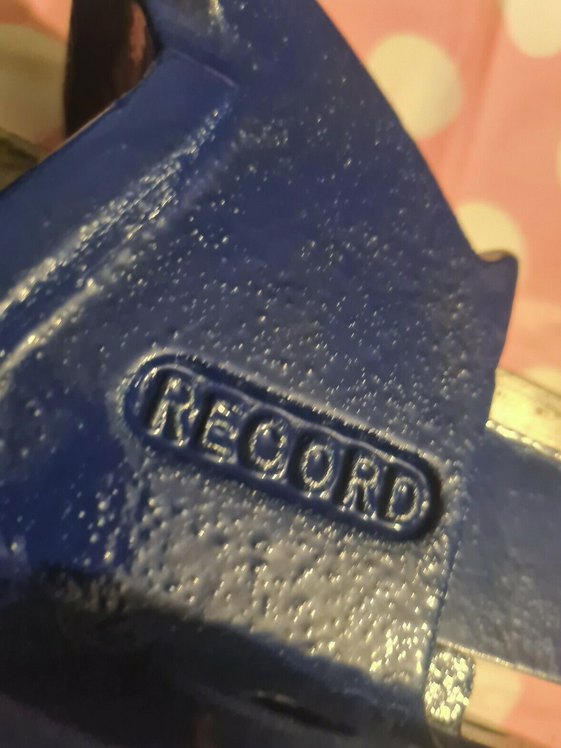

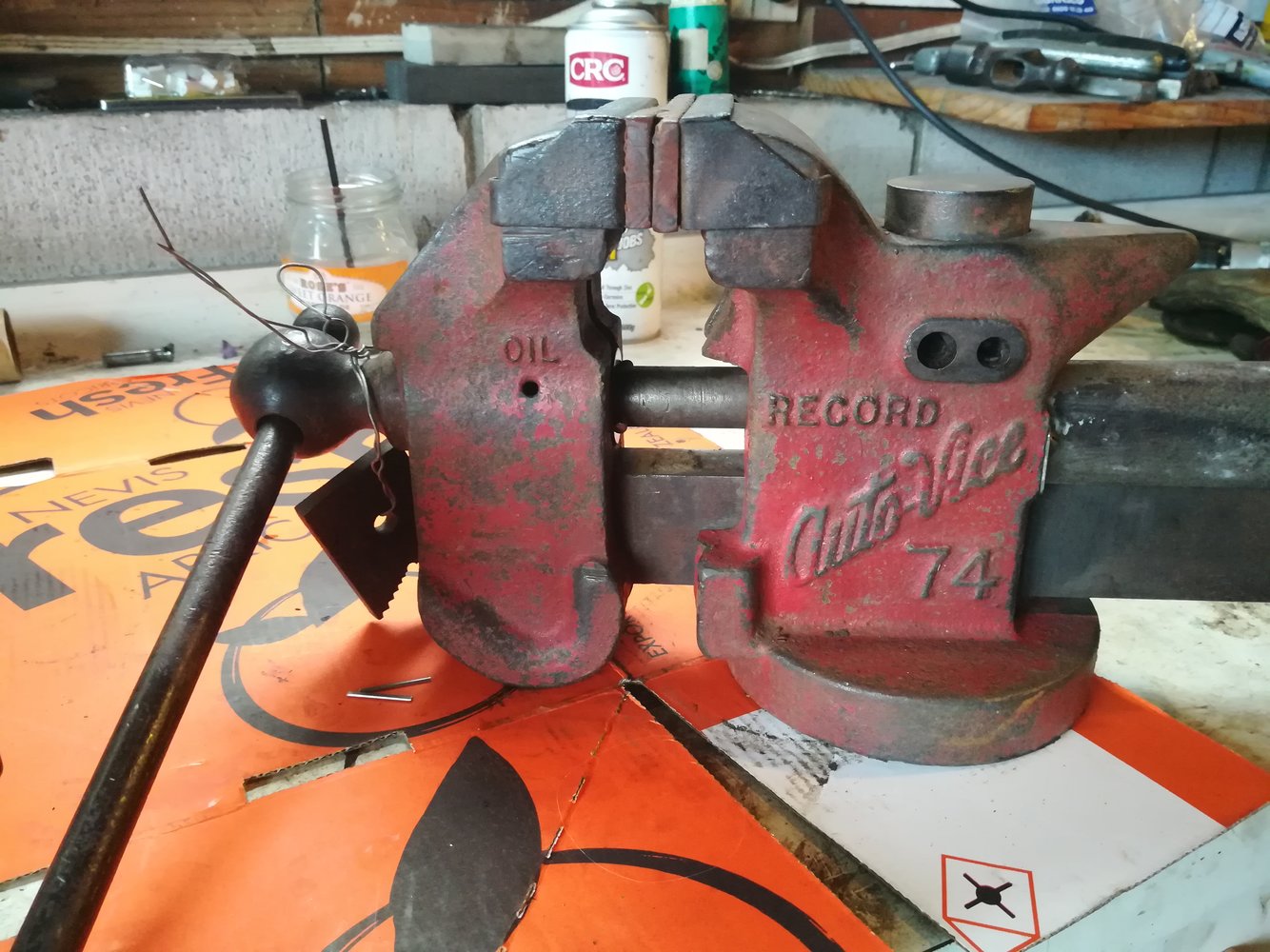

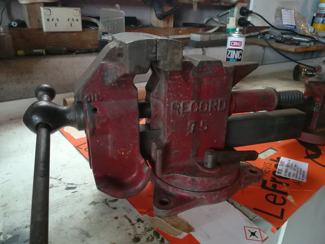

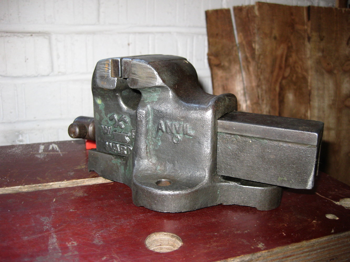

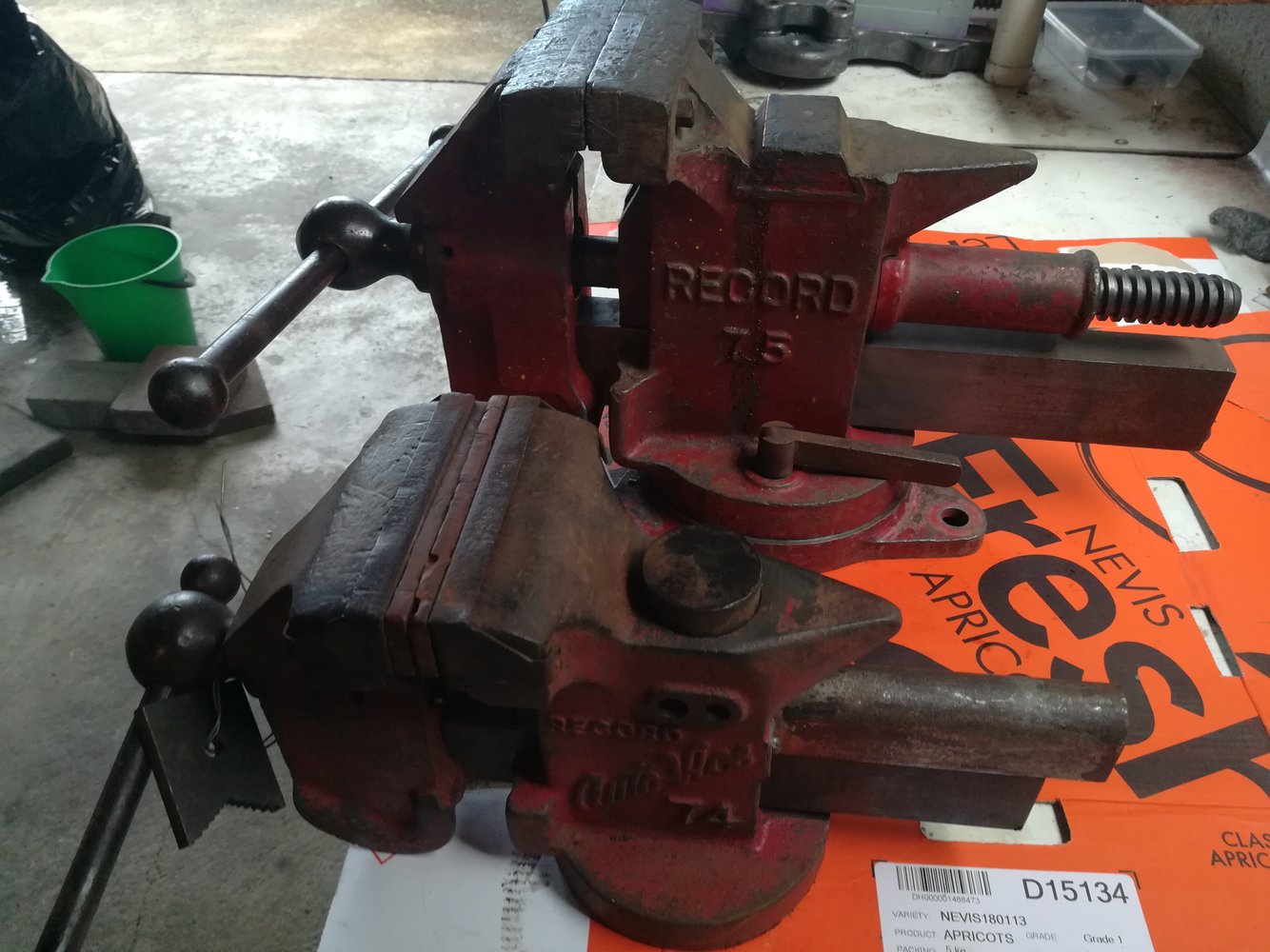

I believe yours to be post 1950 as it does not have the ‘All Steel’ legend as Record stopped all-steel production of the No.75 in 1939; most likely due to steel demands during WW2.two twin brothers turned up today, the 74 was the tightest 74 ive got complete with pipe jaws and fibre jaws, the 75 was almost perfect, straight to the pool room!
View attachment 338628View attachment 338629
Yip mine is a late model just before the square nose came out in the late 60s, it’s ductile iron and the anvil is part of the cast, threads were bsw, it’s been oil ragged and now looks impressive in the line up. Note the 75 had a very long handle compared to othe vices of similar sizeI believe yours to be post 1950 as it does not have the ‘All Steel’ legend as Record stopped all-steel production of the No.75 in 1939; most likely due to steel demands during WW2.
They are great vices, mine is earlier and in original gnarly condition. Don’t know about thread sizes there was no need to re-tap any when I stripped it. There was a guy on eBay who made the pipe vice jaws, I bought one a couple of years back, (I think £15, easier than making your own), mine is excellent. Had to file it slightly too fit but very good nonetheless..

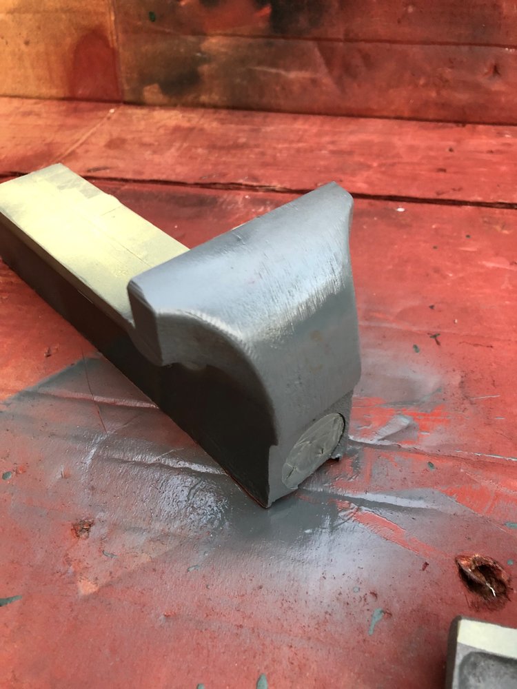

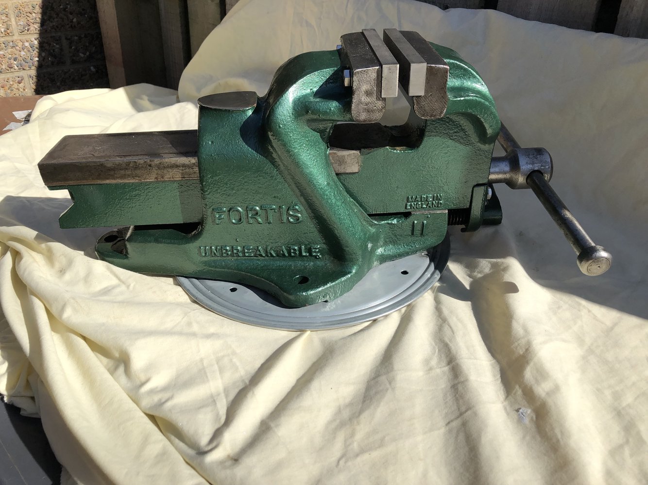

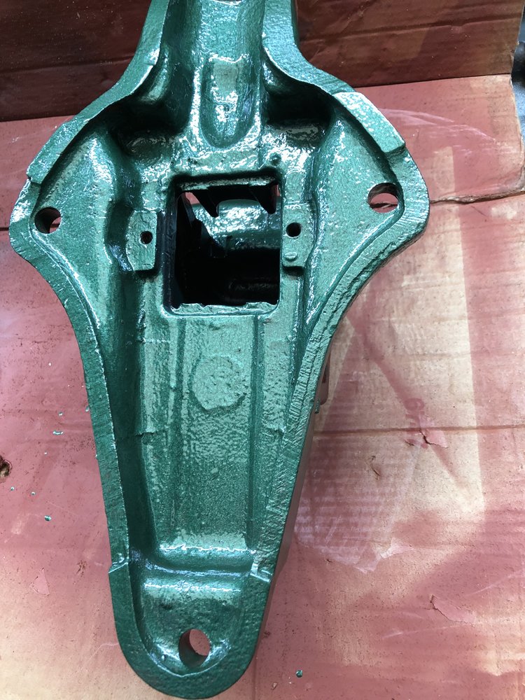

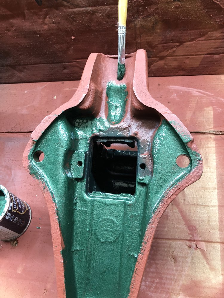

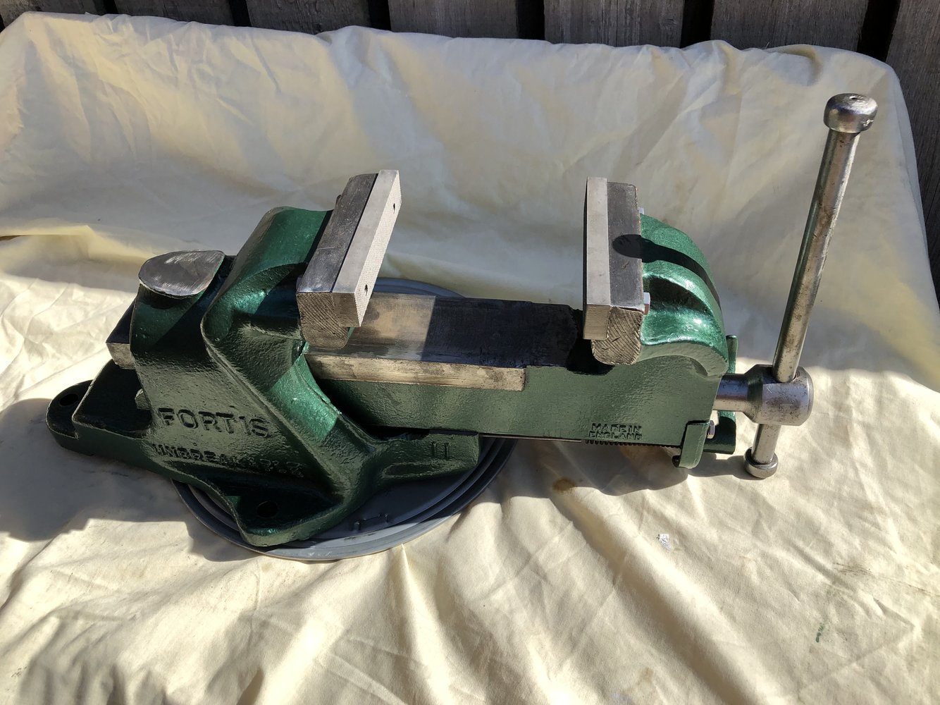

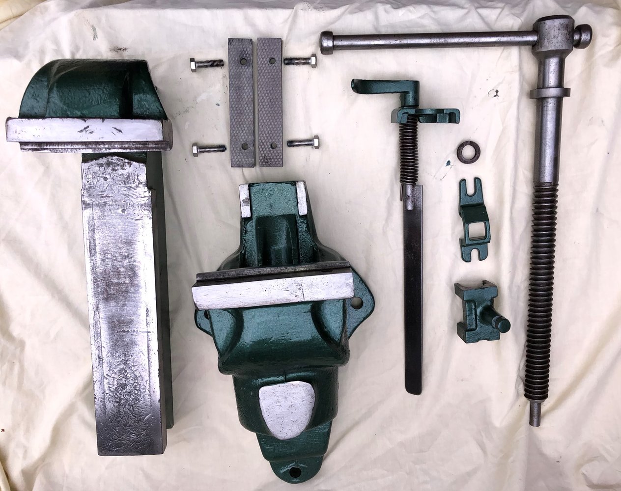

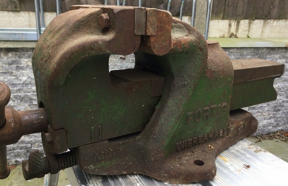

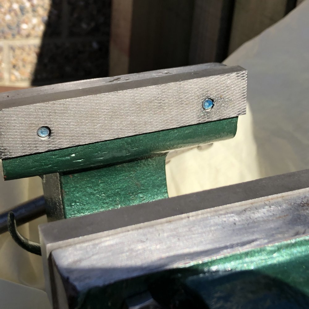

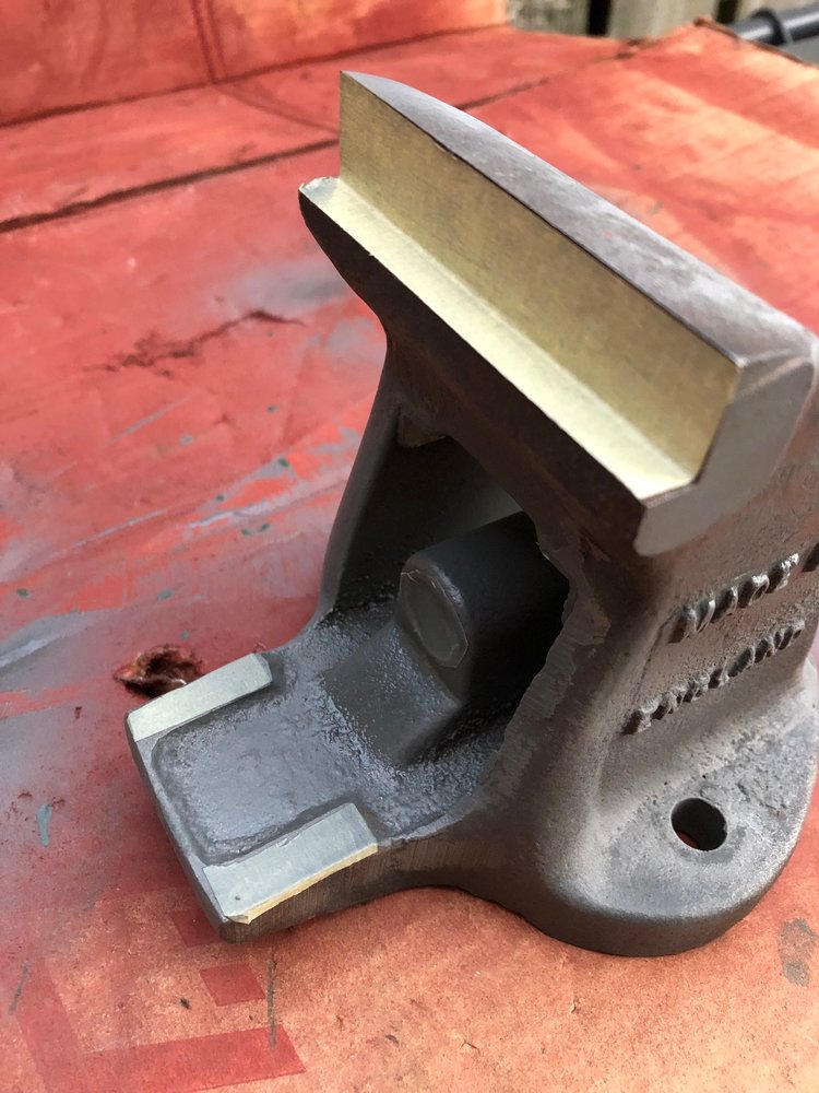

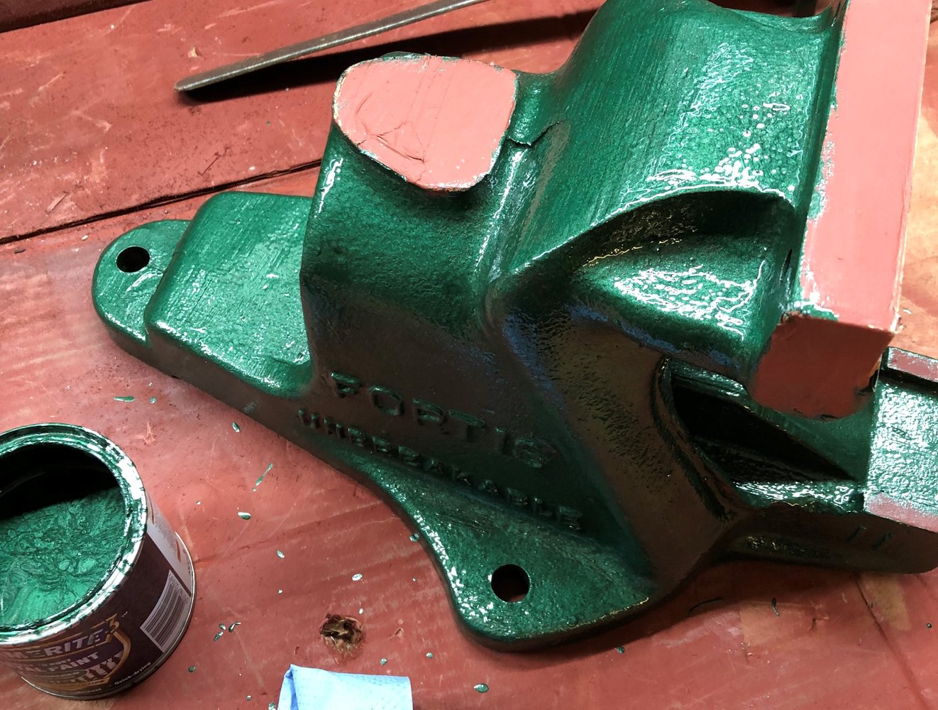

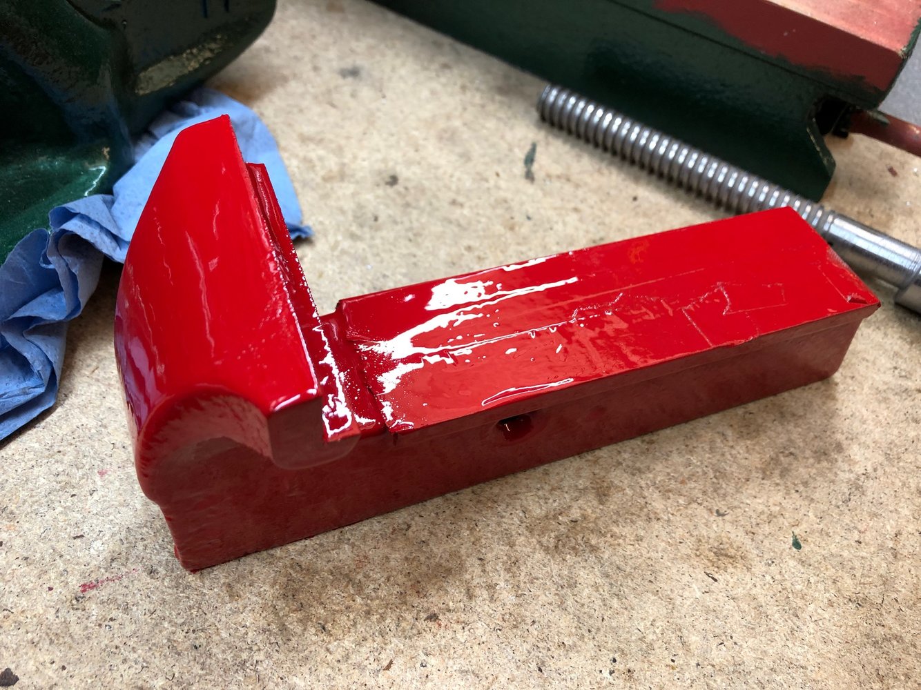

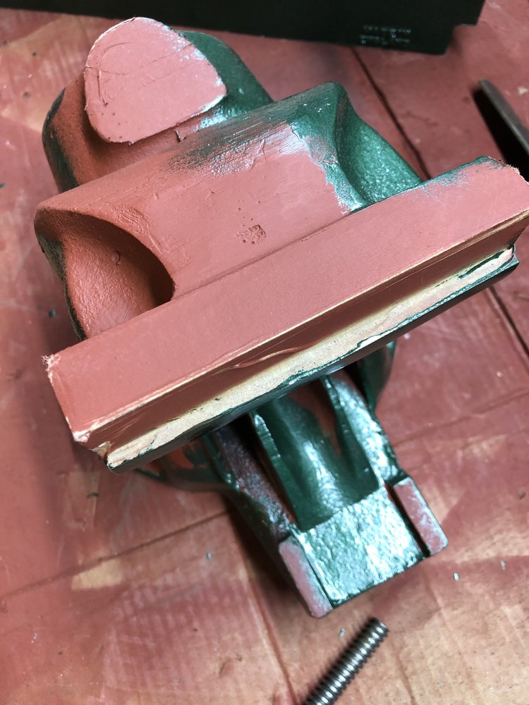

Thought I would post the results of my Fortis 11 refurb.
Started in October 21. Ordered new jaws but on arrival they were incorrect dims for the bolt holes.... eventually changed after I had to send old ones back and send the old jaws for copying.
Even then the jaws were wrong - the supplier (on ebay) missed a chamfer at the bottom of the jaws so it cuased them to sit high when assembled.
Just advertised the vice and sold in 24 hrs.
Anyway... here are the stages.
Purchase of original (in Fortis "Apple Green").
View attachment 338940View attachment 338941

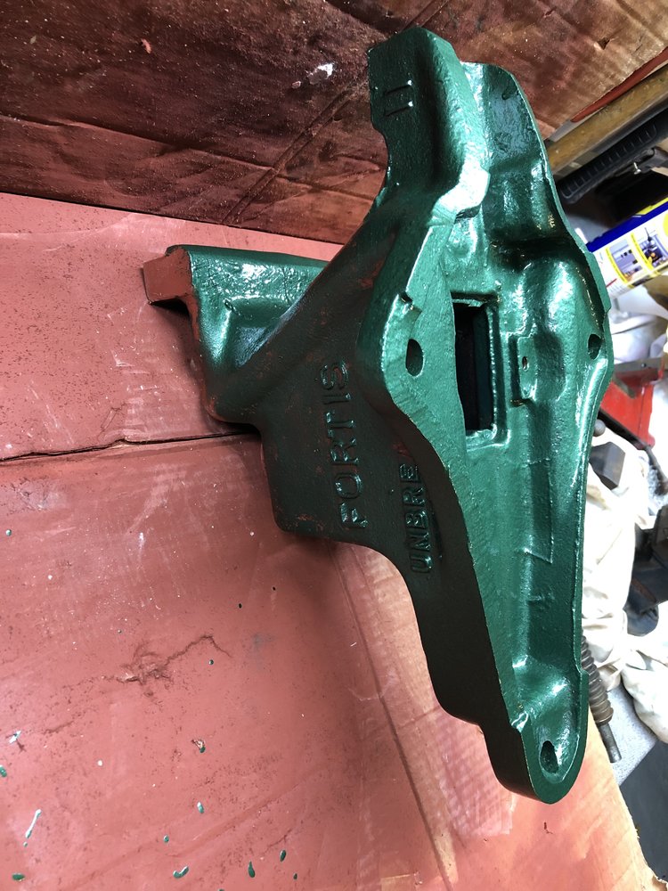

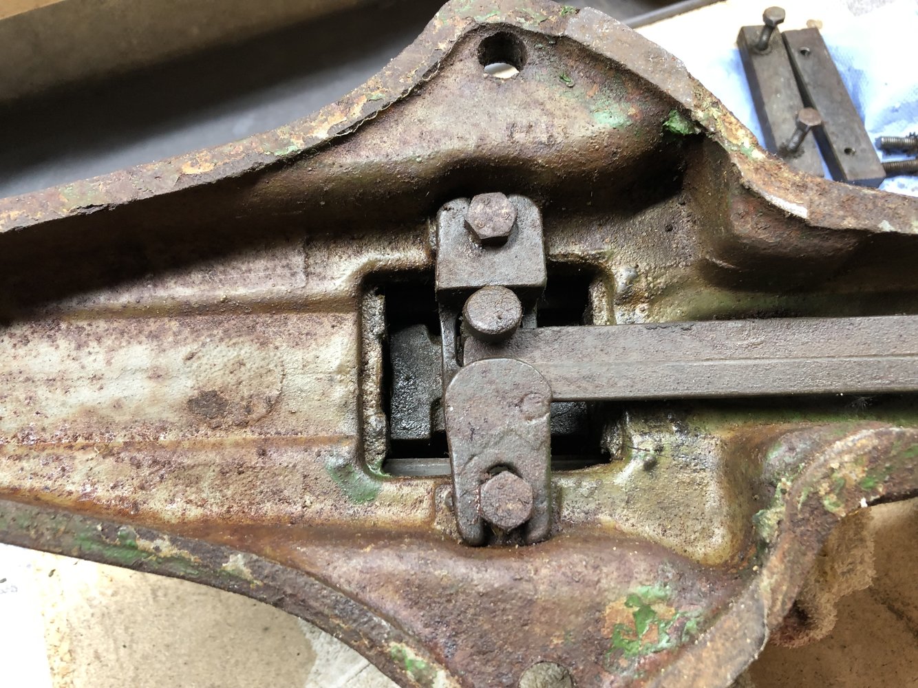

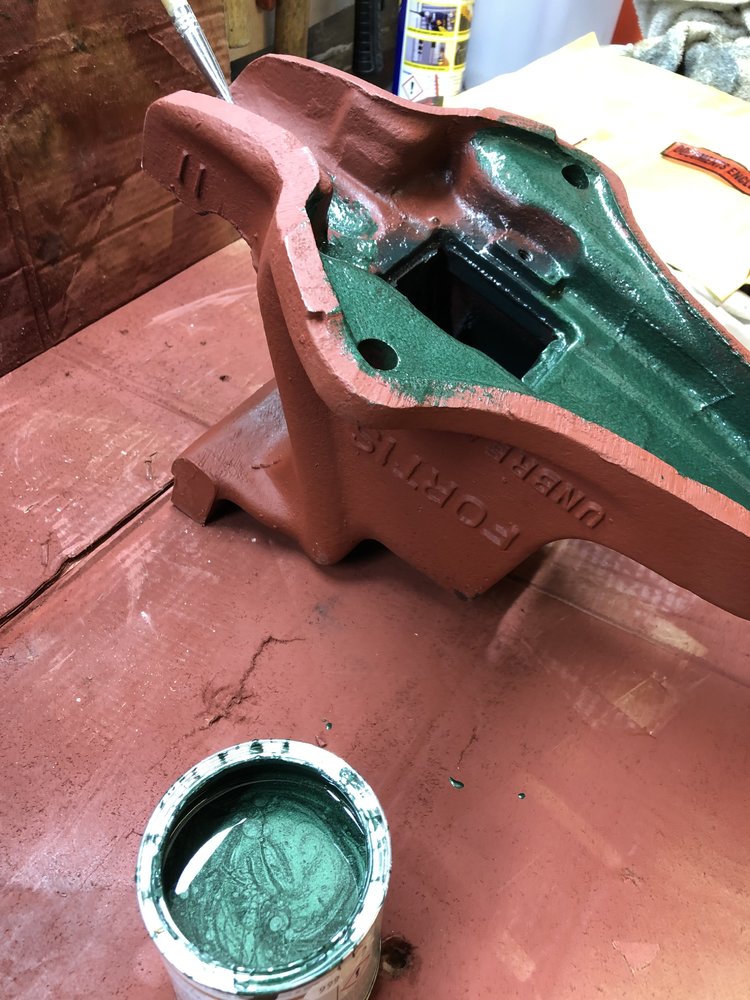

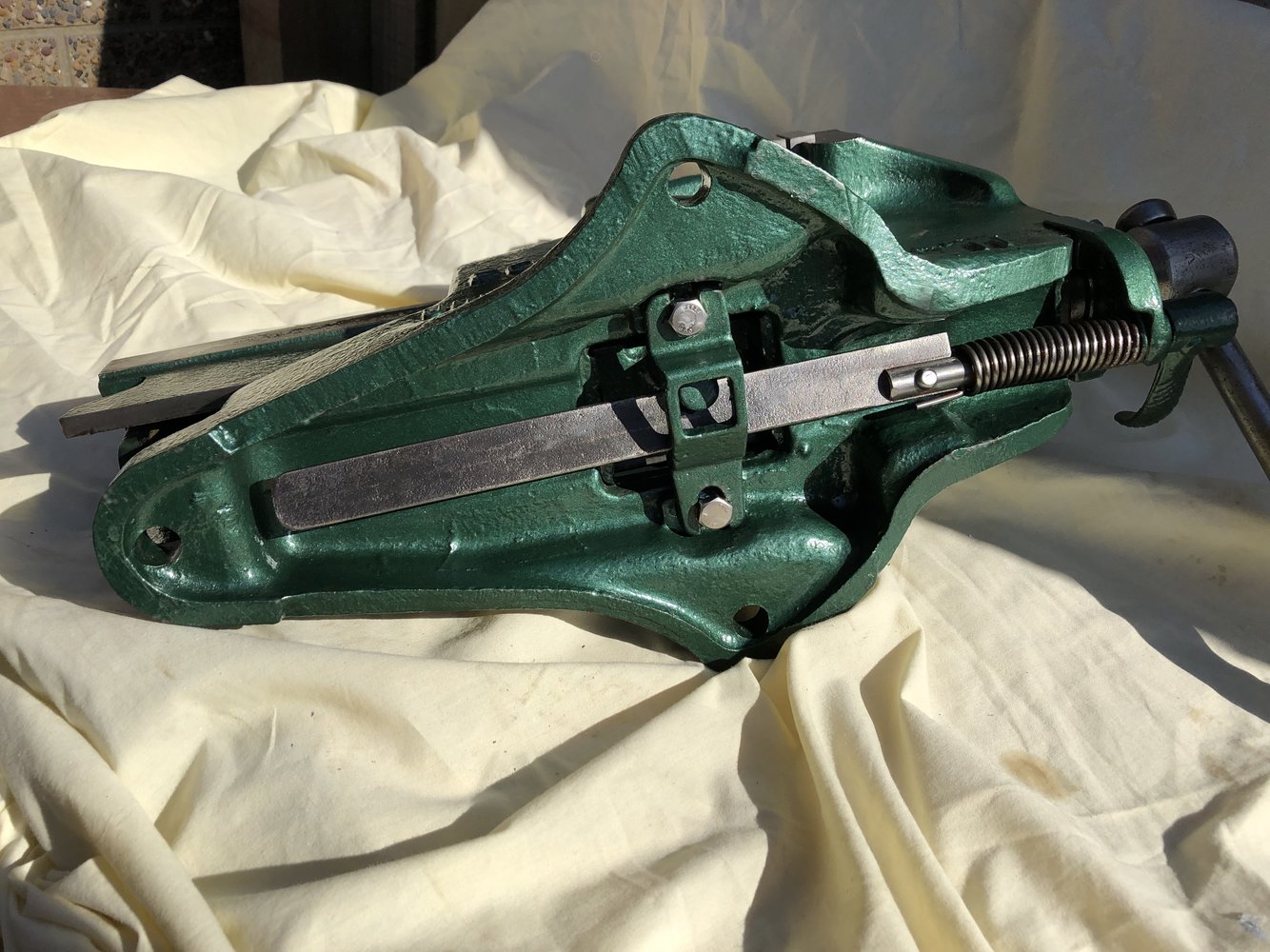

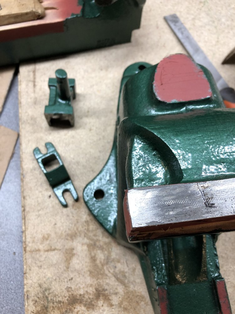

Full strip down with degrease fluid, then paint stripper, then wire brush back to base casting.
Then Red oxide undercoat. And I chose Hammerite Hammered Green for the finish.
View attachment 338943View attachment 338942View attachment 338944
View attachment 338945View attachment 338946View attachment 338947
View attachment 338948 View attachment 338949
See next post for balance of photos... (only max 10 allowed each post)
Lovely looking vice those, you did a great job, were those new jaws?, if so how much and did you get them from vice works?View attachment 338955
I love the flowing casting of the Fortis at about 70 degrees on the main body which curves up towards an EGG shaped anvil and joins a matching one on the moving jaw.
Real design and to me, stunning
Fortis Steel, from their "Unbreakable" series which looks like their last version.
PS... just sold !

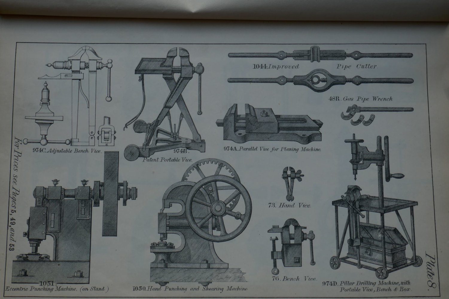

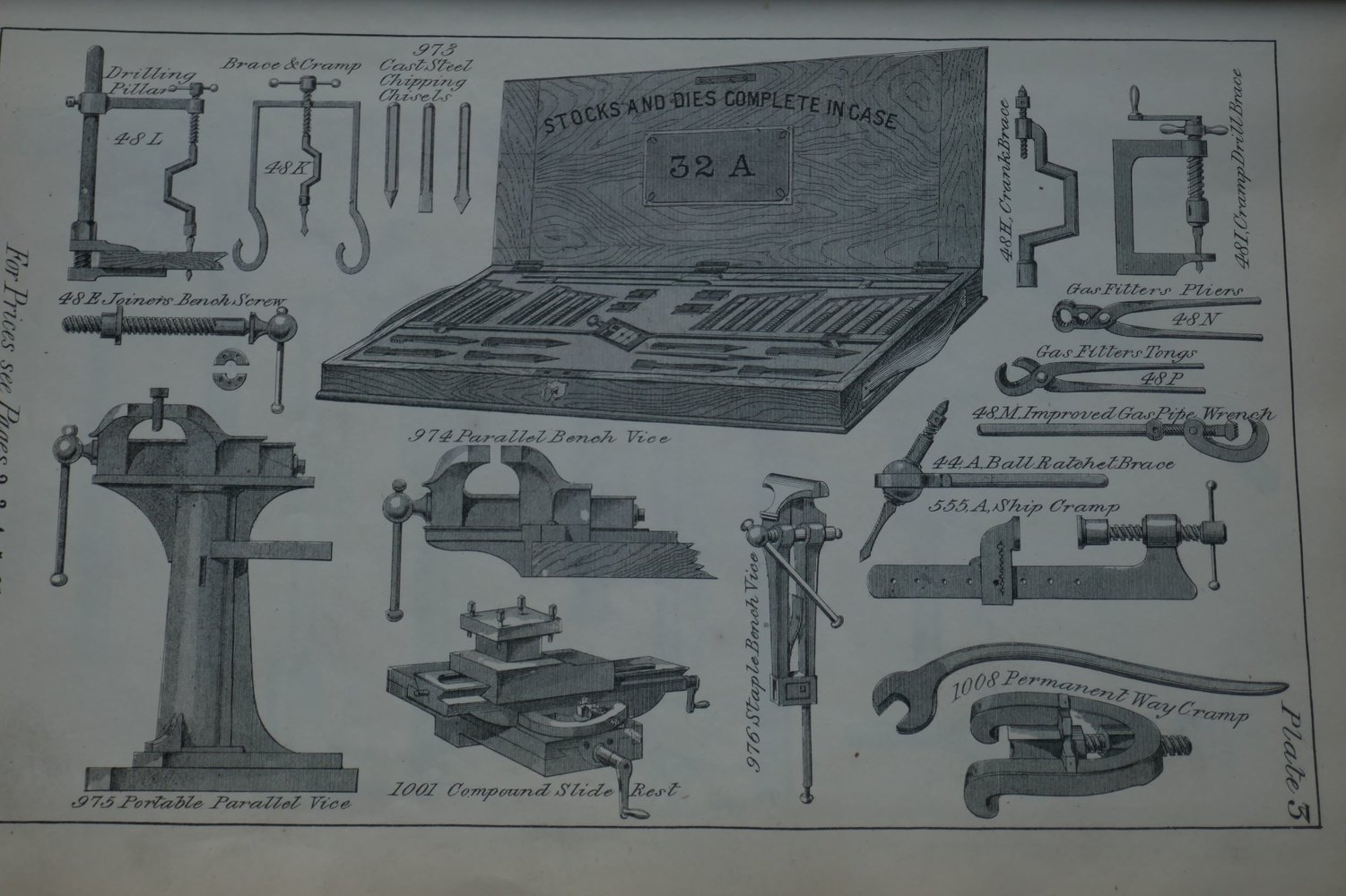

Beautiful pieces, love to have some of those in the house or workshop, works of art. I always buy what they call ship cramps if I can find them at the right price as they are the sort of thing you never know when you're going to need them.You may have come across the Sheffield List - this one (8/9th ed) is from 1869. It was a standard catalogue with prices, shared by Sheffield makers - they could only really price compete on volume discounts or delivery etc. (we'd call it a cartel today).
Here's a couple of pages with vices -the leg vice could be basically any size - priced per pound weight. The newish 'parallel' vices were from 4 to 8in jaw width, I'm guessing mostly wrought, but could have incorporated some cast parts, as later ones versions of them did - see also Wright of Brum.
I fancy that one on a stand.
Unfortunately there were no names on most, so difficult to fix date or maker, but likely a Sheffield source such as Mousehole or Wortley.
No metal woodworking vices, just the screw to make your own wooden leg vice. But cast iron ww vices were appearing from Bradford at this time - again without names except for Woodhead Cramp.View attachment 339243View attachment 339245
How about the 'permanent way cramp'? ie for straightening railway lines.
Anyone have any of these 'parallel' models of this date?
