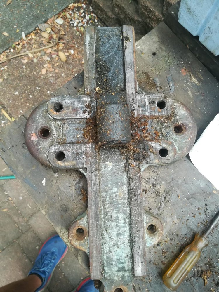

help please people of the vice world
i picked up this vice which looks victorian, however no markings what so ever, heavy duty 5 inch jaw
i thought it might be easy to identify with the 5 fixing holes however im at a loss at this stage
View attachment 337661View attachment 337662View attachment 337663
The very earliest small models of your type usually were held together with square head bolts, not hex, but I think the bigger ones always had hex.
there was a shim under one of the feet of the top rear jaw that didnt cast as well as the others and was not milledThe retaining bolts, screw into the base plate which has threaded holes, the hex look cast, will show photo tomorrow
the paint black over pale grey primer, the primer was very thick or was it the original colour?

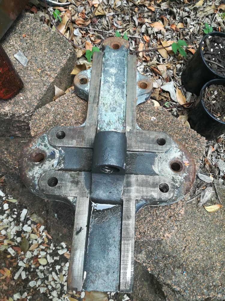

the only mark I found was a “0” stamped on the inside of the base plate by a “letter punch”
thick crud revealed black over grey
Degreased shows what I think was original black paint in the recessed areas
All degreased and even the jaw screws came out easily although they will need retapping
i Will try and find photos of original examples for paint schemes or I might even just bees wax the exterior

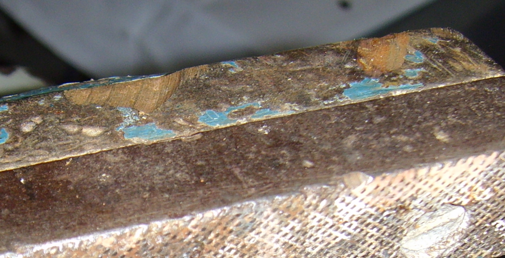

Good question!do i repair the hacksaw marks with weld or leave as is??
eave as is, IMHO. I like to leave usage marks intact. I'll merrily derust, paint etc., but I like to leave usage marks, (unless they're detrimental to operation), intact. It's a reminder what life a piece has had.
I had several small defects on a vice face. Just tiny pockets that didn't fill out in the casting process. I resolved the issue by hammering in bits of lead, then filing and sanding smooth. It worked a treat, and although I painted the vice afterward, I would think that if unpainted, the lead filler would soon oxidise and blend in with the colour of the bare metal.Matt,
on smaller individual scars, I'm inclined to agree with you to leave them as they are as a sign of real work and life.
One knows anyway that I'm more of a proponent of doing little and with @ranger08 's example above, you could actually keep it that way, those are "nice" scars.

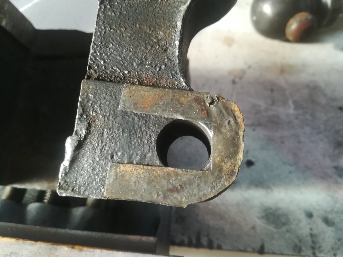

In the rare cases in which I want to make a vise really nice, as with the Leinen-new-acquisition and there are two really ugly remnants of grinder work, then I look for other options.
Almost everything else I am willing to leave, but that must go.
There are restorers I also watch like "my mechanics" who deliver really great, almost perfect restorations and I find most of them great - but in these places they would work with putty, which I don't want in any case!
Whatever I make nice again should work and never becomes an exhibit, so putty is out of the question - a small hammer blow would be enough ....
So how do I fill this damage solid again?

i would stick weld those and grind back flat, its a great vice that needs to function and take the hits. those wounds are too big and are in a sensitive area so "no" to puttyMatt,

If you were to use a small burr to undercut a defect on an angle, hammering the lead into the void would key it in to prevent falling out. Little undercut keys are are a method of how engravers apply raised gold adornments on firearms and such.................................. Arc T i will try lead as have a lot of it, not sure how it would stay in place however i like trying new things, .....................................

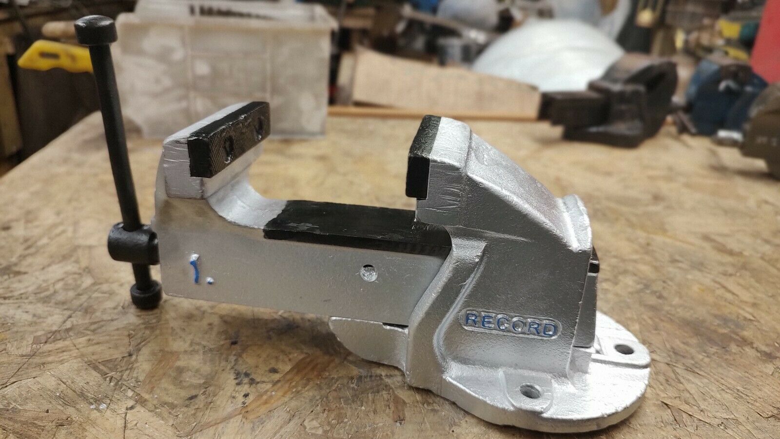

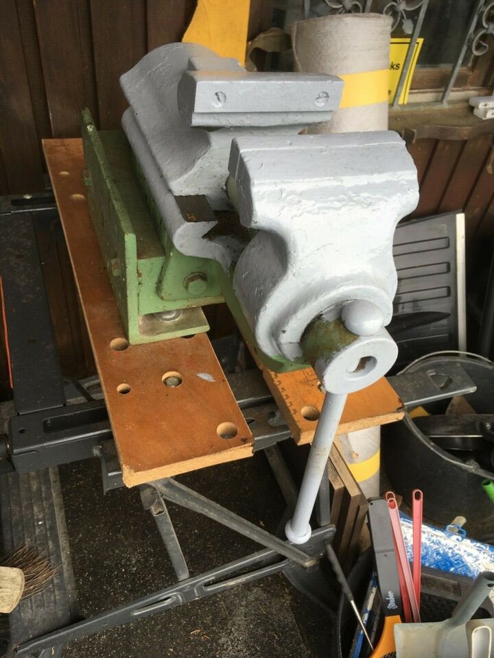

There's a currently a couple of these 'restored' beauties on a well known auction site.I also see very, very many vices and sometimes I get nauseous, what some advertises as refurbished, restored or in good condition ....
Then I guess it's about time that I offer one of the cream pieces from my creepy cabinet again.
If you look on YouTube you can even see some of these creative geniuses at work sharing their skills with the world. Fortunately, these artists don't limit their talents to vices, but armed with a can of WD40, a rotary wire brush, a 50mm paint brush and a tin of thick gloss they can restore almost anything.Then I guess it's about time that I offer one of the cream pieces from my creepy cabinet again.
The vice that is underneath has once started as a "Climax" and the degree of "refurbishment" is also in a class of its own.
Attention:
And this one also seems to be a replica of the famous Eikar patent by Breitenfeld & Scholz from 1920 and with about 150mm no small vice either .... once perhaps a proud piece of mechanics.
What I can't get my head around is that the guy obviously has enough sense and technical background to show many pictures and some important measurements, but on the other hand is not too shy to offer such a "work of art" in all seriousness.

the same seller also had this beauty
"How many times do I have to tell you: Apply the paint thicker!!!"
btw: Did you even sufficiently appreciate the unique brush stroke of the master at the Climax?
Never underestimate the lack of conceit of some people. or the height of the bar in others. No matter how bad someone will always post, 'Great restro mate.'has this one even a crack?

The top one has a you tube channel, he’s a tool collector I watch it sometimes it’s a bit of a hoot, he loves his colour pens to highlight lettering, well at least it’s just one of records cheapiesThere's a currently a couple of these 'restored' beauties on a well known auction site.
