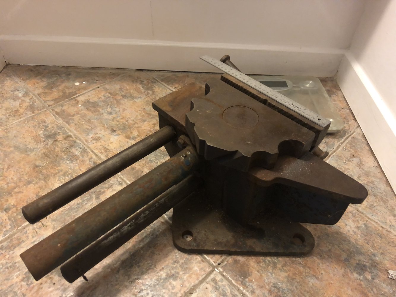

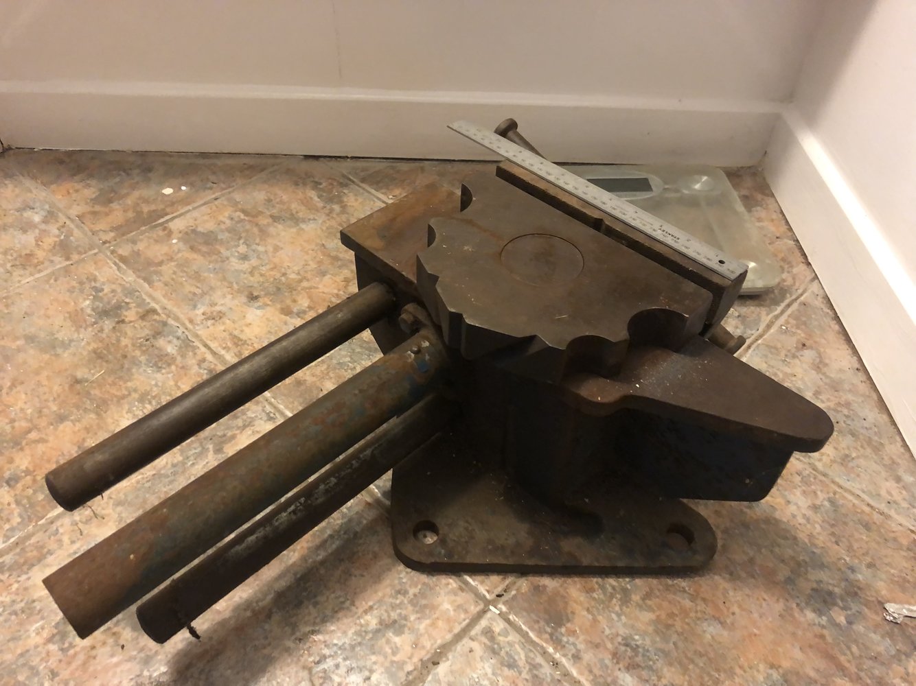

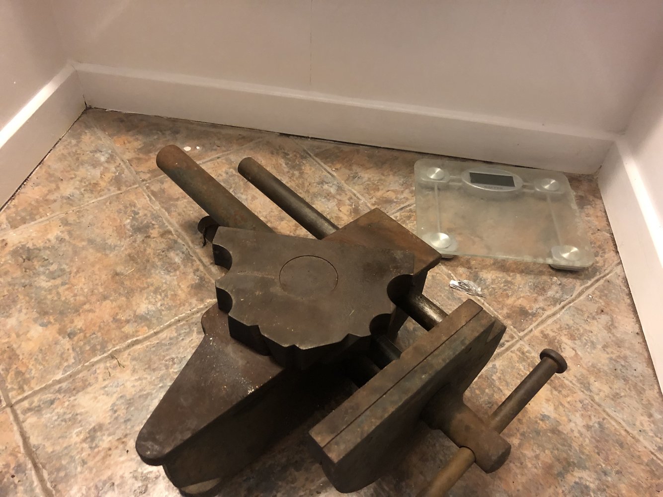

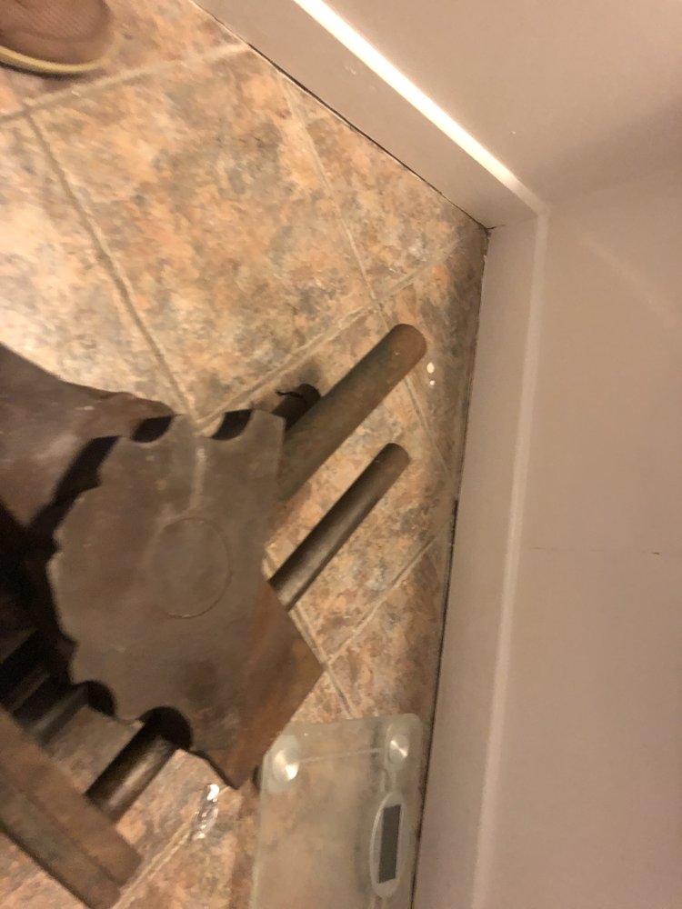

My new toy to restore.

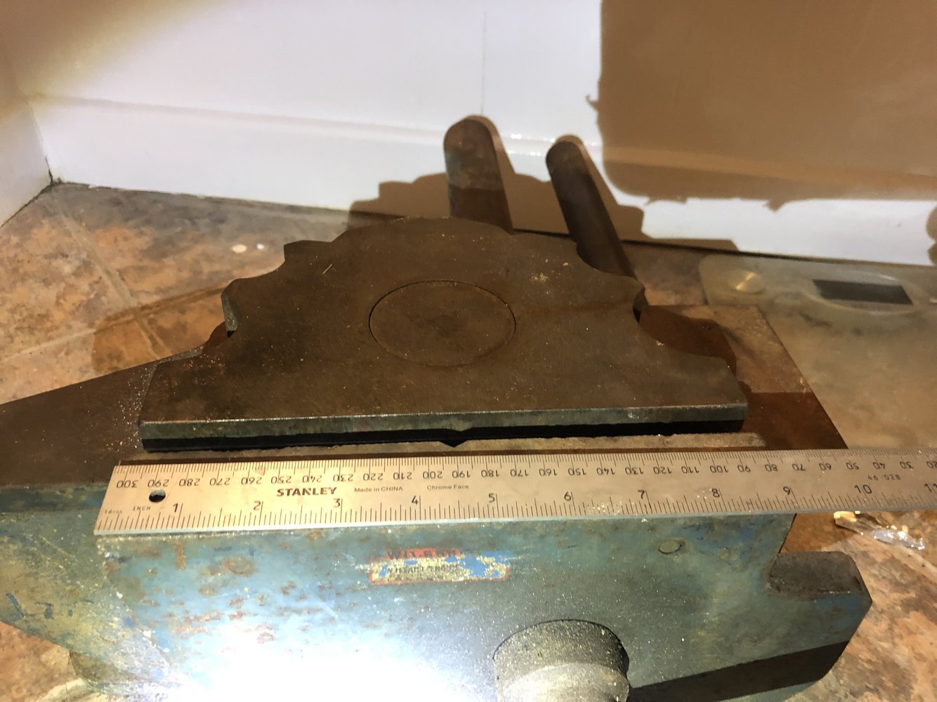

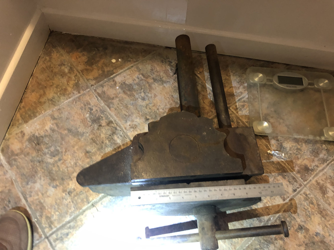

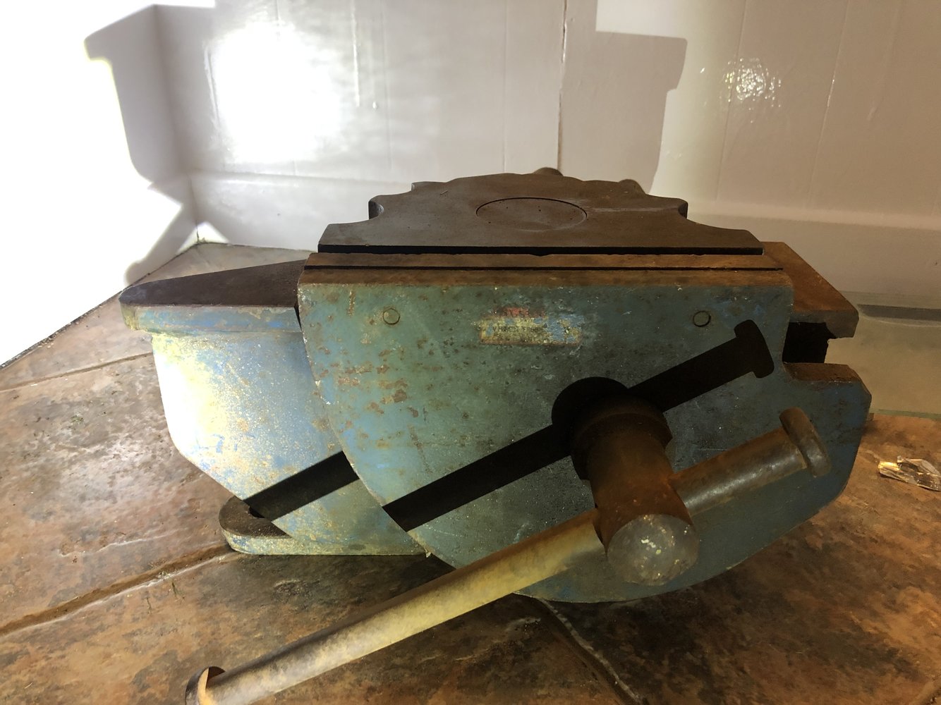

Hi. I’m new to this forum, but stumbled upon this site looking for info on a vice I just acquired. It is a Wilson type I think called a “Turret Jaw Vice”. I saw some pictures of smaller ones online which had a way of locking the rotating jaw by a latch at the rear or pin on the top of the rotating jaw. This has neither just locks so it is unable to rotate clockwise when the straight edge of the rotating jaw is parallel to the fixed jaw. Couldn’t see any bits missing but wondered if there was a way to lock the jaw I hadn’t figured out. It is a big old lump weighing in at 46kg with 9” jaws. Any info appreciated.
Definitely welded/fabricated steel construction. I guessed an anvil to the left (and the small we hit to the right?) as well.A 9in wide jaw is big.
I have a large Wilson of this type - but not as big as this. Not only a 9in jaw (on yours -- I'll report back on mine later), but that large triangular 'table' to the side -- built in anvil, I think.
Another major difference between the original Wilson and these is that I believe these are made by fabrication/welding, not castings for the main parts - would you agree?

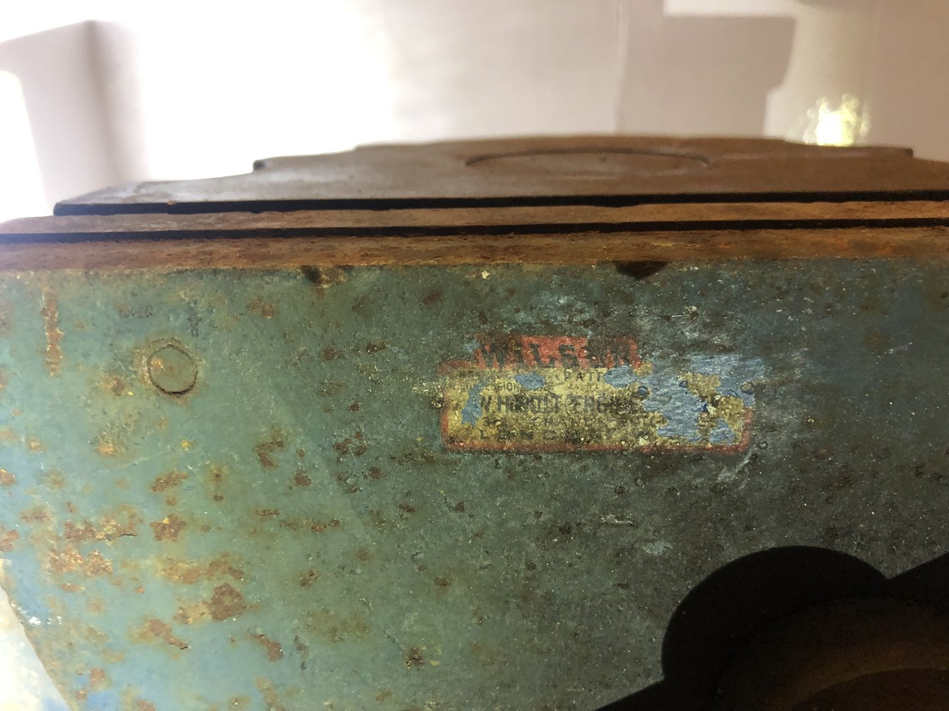

Can’t see a huge amount on the label. Looks like the word Wilson top left some thing indecipherable below that then the word patent/patented, below that W.H.Colt (Engineers) and then an address 312 Grand … LONDON.W-brum - what can you make out from the label? - there's only a letter or two visible on mine, but looks to be the same label.

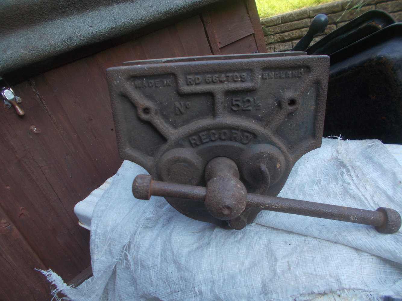

This one might go on an outdoor bench at some point if I ever get the time.

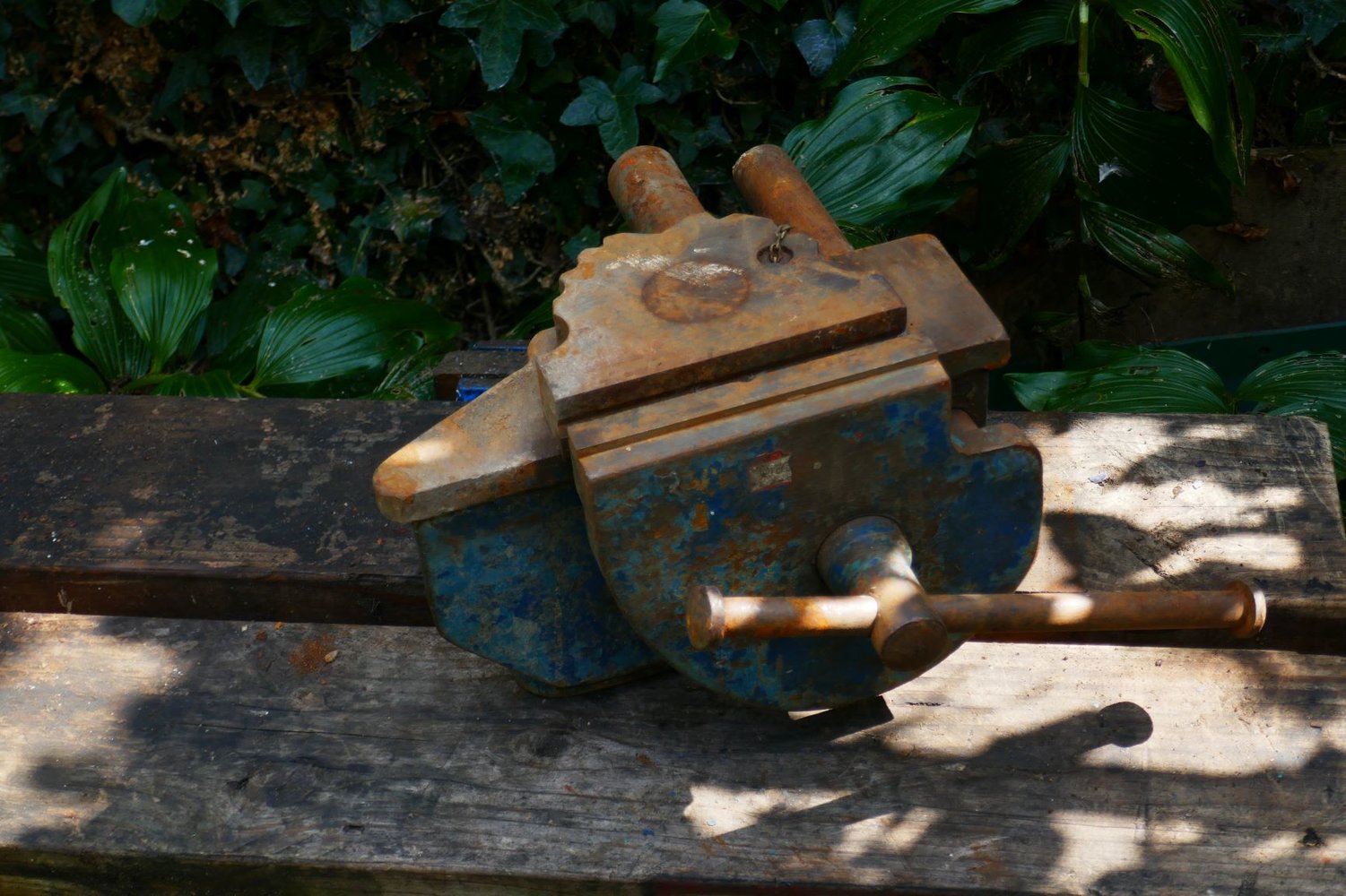

What cool things.Here's mine:
6in jaws, approx 25kg, fabbed from 12mm and 15mm plate, top piece 30mm thick. This one does have a locating pin to keep the rear jaw face flat - if angled or notched use not wanted.
If you lift off the rear rotating jaw you have a full anvil top.
As you see, also pretty rusty but not damaged -- was going to show after a modest refurb/paint.
------ anyone else got weld fabricated vices to show? - Record's Leaders and "The Herbert" Armoured are two I know. - I think I prefer cast iron/steel, but there's a lot to be said for these strength-wise etc.
I think someone showed a very fine complete re-machine/rebuild on one of these a few months ago and we also saw one absolutely battered with weld splatter, rust and miss-drilled holes (but I think it did have the remnants of a quick release) -- the cast body DOHM/Wilsons also had optional QR.
